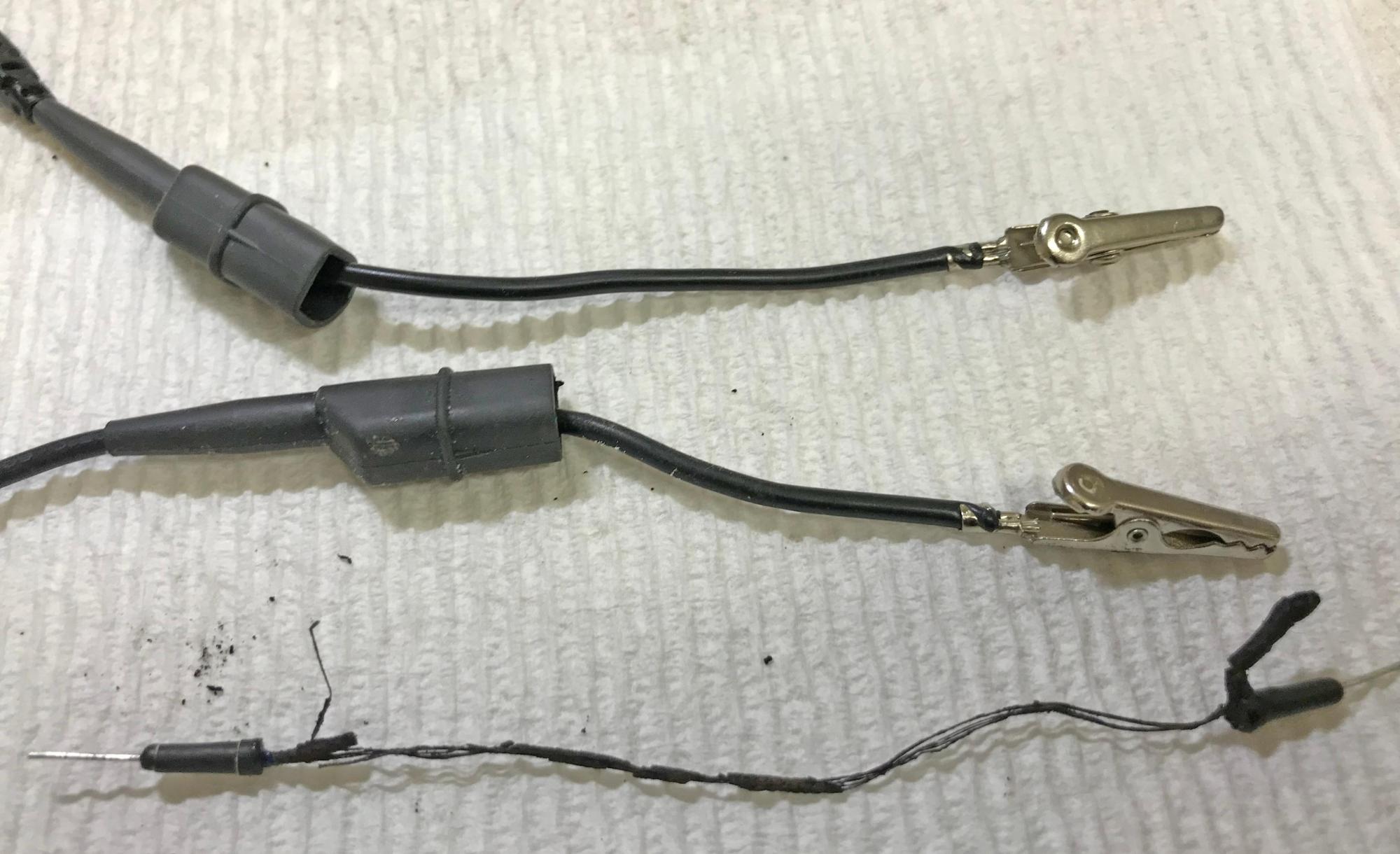

    I have a 40 volt AC transformer that I put a bridge rectifier on, and I wanted to see the input signal and the output signal on the same screen on my scope, so I set one channel up with the test lead on one side of the input and the ground lead on the other side of the input, then I used another channel on the scope and clipped the test lead on the positive side of the output then the ground on the negative side of the output.
    When I connected the transformer to power, the wire that was connected between the ground lead on the second channel and the negative side of the bridge rectifier literally caught on fire.
    Why did it do this? And is there any way to achieve what I want to see on my scope?

    In short the reason is that the ground clip is connected to earth ground, and all of the channels of the scope share the same earth so you shorted primary to secondary...
    To measure this safely you can use two probes instead of hooking up the ground clip: you will of course need twice as many channels to make measurements (i.e. 4x channels to take two readings).
    Please watch this video: EEVblog #279 - How NOT To Blow Up Your Oscilloscope!.

          That guy pissed me off once ... he did a video where he fried his Weller iron because he plugged it into 220 when it was rated for only 110... and in the beginning of the video, he fully admits that it was his mistake and he took full responsibility for the damage ... then as the video went on, he started bad mouthing Weller for not building in protection to the unit to avoid damage like that ... which I felt was very unprofessional.
          None-the-less, in the video you linked, his recommendation for taking readings from earth grounded equipment - was to purchase a $350+ device that isolates your scope channel so that it cant be damaged.
          What I essentially did was this here ...
          Which caught the wire between my scope clip and the rectifier on fire ... by shorting points A and B through the scope ...
          I'm lucky I didn't damage the scope.

            So basically, what I ended up doing by connecting the scope the way I did, was making this circuit...
            Which means that for half of the AC cycle, I created a dead short?

                Re: Reading input and output of bridge rectifier on the same scope?
                Yes, to get around that instead of using an isolation probe (the proper tool for the job) you can utilize two oscilloscope probes as I alluded to in my post above.
                What you do is simply hook one to positive, and the other to negative.
                Then you use the math function of the scope to subtract one from the other.
                This is also a trick you can use to look at really sensitive signals.
                But it is not without its caveats, namely that the waveform could be a bit off depending on how complex the harmonics are.

                          LOL yes, same as Tek scopes or whatever, all probe shields are connected together through the chassis and most likely the places that will fail given typical scope probes:
                          a) most likely as OP experienced: DUT dies
                          b) probe clips melt down
                          c) BNC connector explode
                          d) probe wires fry... this is very tough as the short path is through the braid which is quite low resistance...

                              The interesting thing is, that the probe wire (talking about the ground lead that's clipped onto the probe) wasn't even warm. The wire that it was clipped onto was just a thin breadboard jumper wire ... about maybe 30mm long. and it caught on fire right next to me ... when it did that I realized that there was nothing I could do about the problem cause it had already done whatever it was gonna do faster than I could blink.

                              Check the scope's internal ground did not melt open, I have seen that. The common BNC ground between channels can melt open because they aren't designed for many amps of current. And the internal connection to PE ground, should be OK but I did see a guy ground his scope to an old TV chassis and blow it. Just check continuity.
                              Are you saying I should take the scope apart and check these wires?

                                the scope groundclip was probably decent copper - your jumper may have been copper coated aluminium or steel.
                                that said, pull the rubber boot back on the groundclip and inspect where the wire joins the clip.
                                some chinese ones (owon comes to mind) are not well crimped - they should be soldered.

                                      Also, here are both ground clips with boots off ... and the cable / would-be fuse/oscilloscope guardian angel ...
