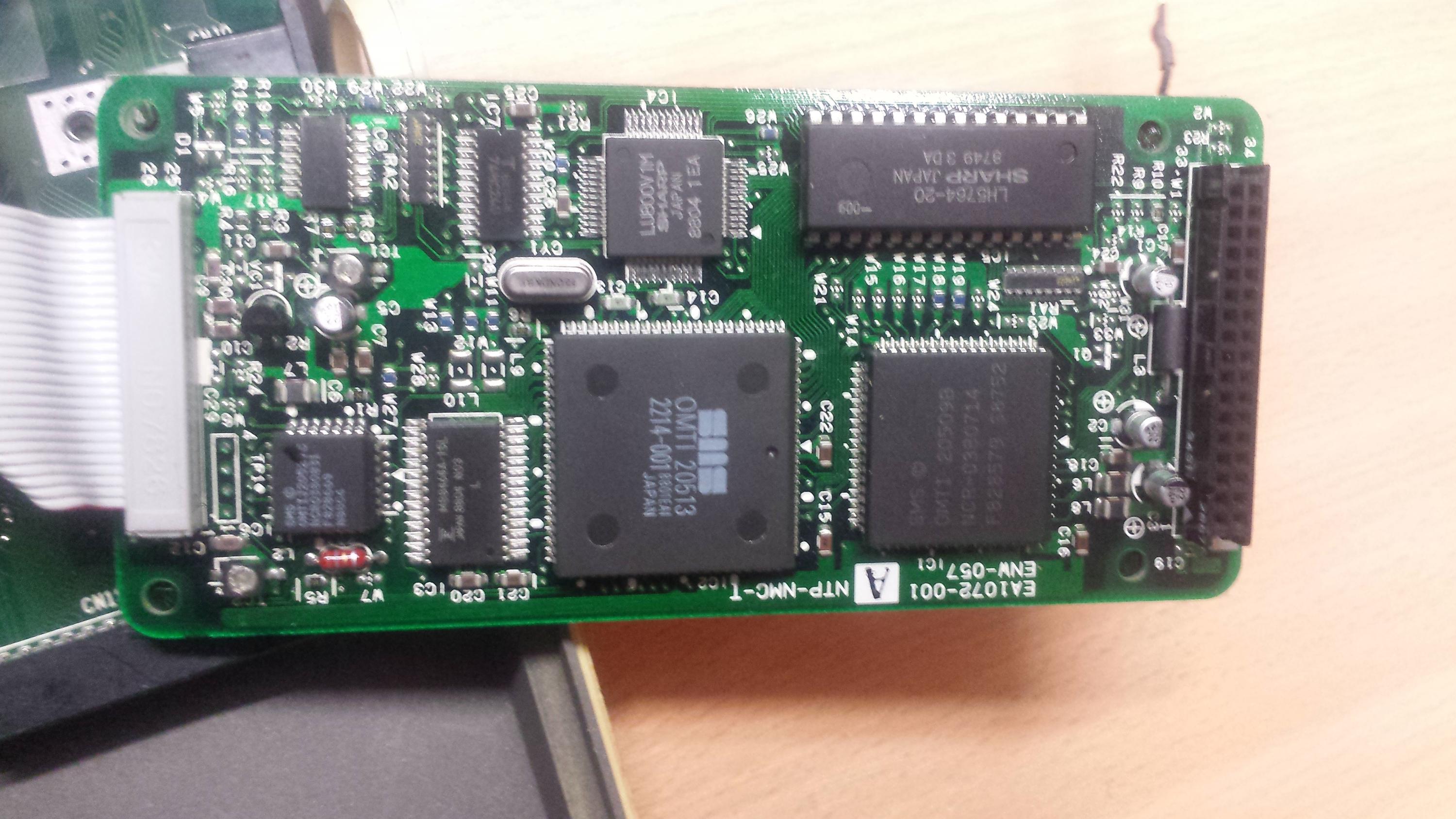

    I have a ancient hard drive out of a just as ancient portable computer that I need to test on the bench because its stopped spinning up in the computer.
    I managed to find a pinout for the 26 pin ribbon connection but I am unsure which connections to make from my bench psu to test if it spins up.
    The power and motor connections on the drive that I can see should allow me to test it are: GND, +12v, +5v, Motor on and drive ready. I am just unsure which to connect to make the motor spin.
    As well as the GND and +12v connections, which on there own do nothing, do I need to also take +5v or +12v to the motor on or drive ready at the same time to make the motor start spinning?

                My mistake its a Old conner 3.5" and its not MFM but IDE.
                You are right eccerr0r it should spin as soon as its connected especially these old ones as it takes a while for them to spin up to speed.
                I have a goos idea whats happened no though and I dont think ts worth trying to sort out now. The first time I had this drive spinning I had to help it by moving the spindle with long nose pliers because it was stuck. I had to do this a few times whenever I tried to use the computer. Ive just read that some of these old drives do get stuck when the heads get stuck to the magnetic covering on the disk platters and this is not something t;hat can be rectified so the drive is no use now. I am going to use a Ide CFcard adaptor to emulate a 40mb hard drive instead. Thanks for your help.

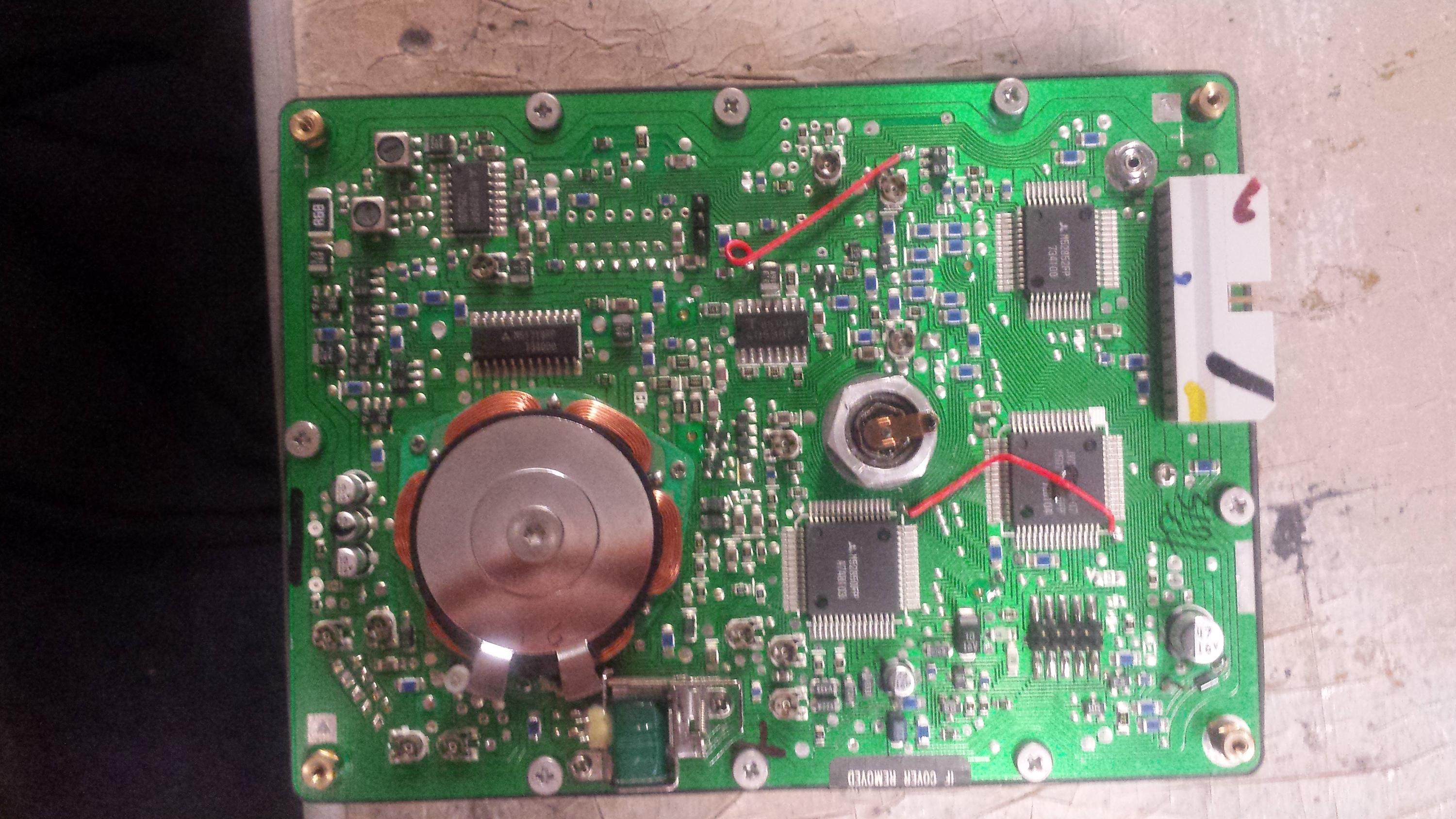

                  before you do, remove the drive pcb and look at the pads that connect to the motor & heads.
                  some are silver plated and get tarnished.
                  if it's not shiny, clean the pads.

                        Yeah "sticktion" is a problem in older drives, though I don't recall Conner being one of them (Quantum was notorious). I suppose both of these companies have been absorbed and gone now...
                        Conner CP3000 was a very popular drive IIRC.

                          All the old Connor's I have spin up and seek test fine, but nothing more after that, not sure what causes it as it's quite annoying because I feel like it's something so simplistic! They sort of die a silent death, you could put it.

                              Further research revealed the model of Zenith portable computer I have has a unique JVC designed 26 pin MFM/Rll type interface that is made especially for this type of computer and is incompatible with any thing else. Turns out the hard drive is not a conner, as I though it was was its a JVC JD3824R00-1. I replaced all the caps on the computers motherboard but still the drive is dead. Apparently the drive only spins up after the interface has initialised so it wouldn't spin up anyway just putting 12v to it on the bench. I can turn the drive spindle so its not stuck anymore. Here are pictures of the controller and the hard drive pcb side.

                                  No nothing like that. or i could have use another controller and drive. They have been trying to work this interface out with the intention of making a cf/sd card emulator but nothing yet finished so its get this drive working or its a floppy only computer now

                                        here are some info on this drive. The computer it comes off is a Zenith Supersport I repaired & re-capped
