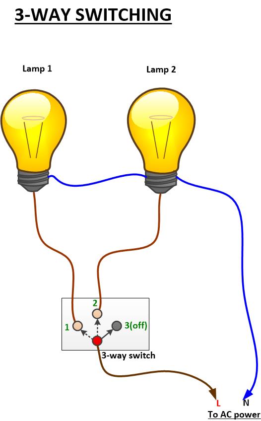

    Fixing a lamp, I have a strange light bulb socket, at least strange to me.
    It's a 3 way but not to a 3 way bulb. Way one, primary bulb on. Way two, second base bulb lights up but not primary. Way three, all off.
    It needs to fit standard (1/4"?) lamp post pole threading and take an E27 bulb. Am I just not using the right search terms? This is replacing a failed (worn out and severely corroded) socket that does not have more than a two way bulb contacts in the socket.

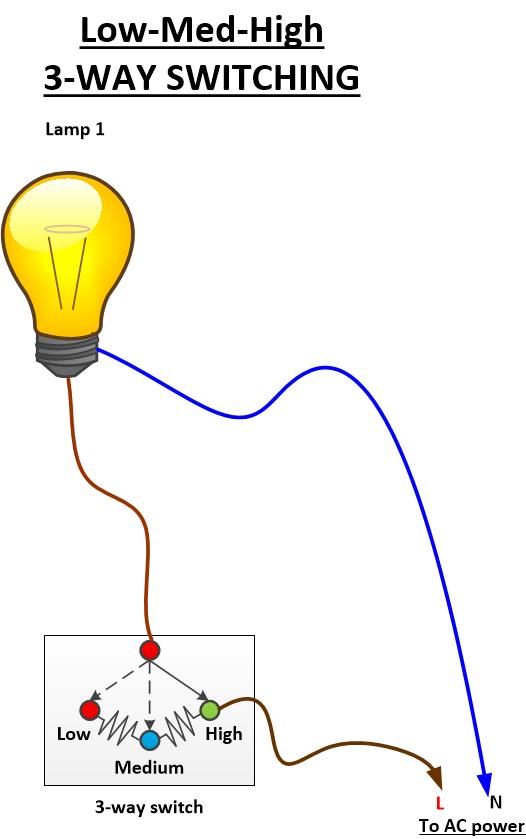

          Re: Different Kind Of 3 Way Light Bulb Switch
          Is this what you have??
            ^ Yes. I need it to do that, and have a rotating side stem switch like this:
            https://www.amazon.com/gp/product/B002DN4LX4
            If it comes with the exterior shell like that one at amazon, it'll have the (1/4"?) threaded mount on the bottom that is needed, or I could reuse the old exterior shell if I found the interior switch/socket assembly sold separately.
            Previously I wrote E27 but I meant E26, need E26 socket.
            Did some more searching, found a lamp repair site that stated I have a "3 terminal" socket. Think I found what I need with this:
              Is this what you want??
                ^ No you had it right the first time. I bought the PLT 90-421 that I linked on Amazon. Oddly 1000Bulbs sells it with $2.29 shipping on Amazon but wants $10 shipping if ordered direct from their website.
                https://www.amazon.com/Brass-Light-S.../dp/B0097E3LN8
                      3 way switches have so many different connotations.
                      One is the typical light fixture that uses a 3 way bulb with two filaments and the 3 way switch can select either one or both of the filaments. "Rotary Encoder" HAHAHAHAHA
                      It also can refer to a SP3T switch, which is what the OP wants.
                      It also can refer to the XOR house lighting dual SPDT switches that can turn on and off a lamp from two locations...
                      I think the SP3T switch or "SPDT with off position" is non-ambiguous here... though finding them can be tricky.
                                Received socket today and replaced it... took longer to post these pics than to do it, lol.
                                Nothing special involved, screws, middle terminal is socket for each bulb, AC neutral, and the two opposing side terminals, one is AC hot and the other goes to the other bulb socket center conductor.
