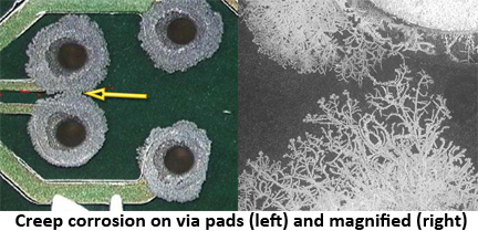

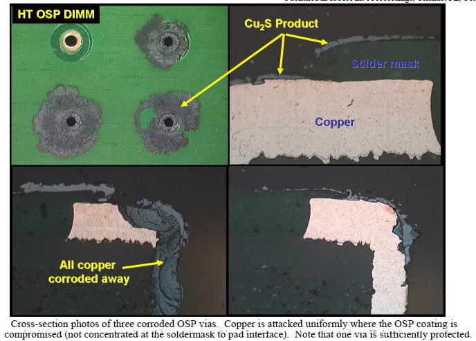

    I'm seeing this on Western Digital HDD's and Synology NAS in dry, not corrosive home environments.
    It's a black fuzzy slime on PCB's mainly on via's, any exposed copper.
    Thought it was just due to manufacturing crappy PCB wash, but after searching the web- it is metal-sulfide dendrites that cause semi-conducting/shorting problems.
    It looks like due to RoHS - lead-free, immersion tin and organic flux.
    Do people know about this? I just learned it.
    I use a toothbrush and IPA, give the board a scrub and it's OK afterwards. But under a BGA?
    http://thor.inemi.org/webdownload/Pr..._Corrosion.pdf
    https://community.wd.com/t/wd-hdd-pc...ame-it/13414/3

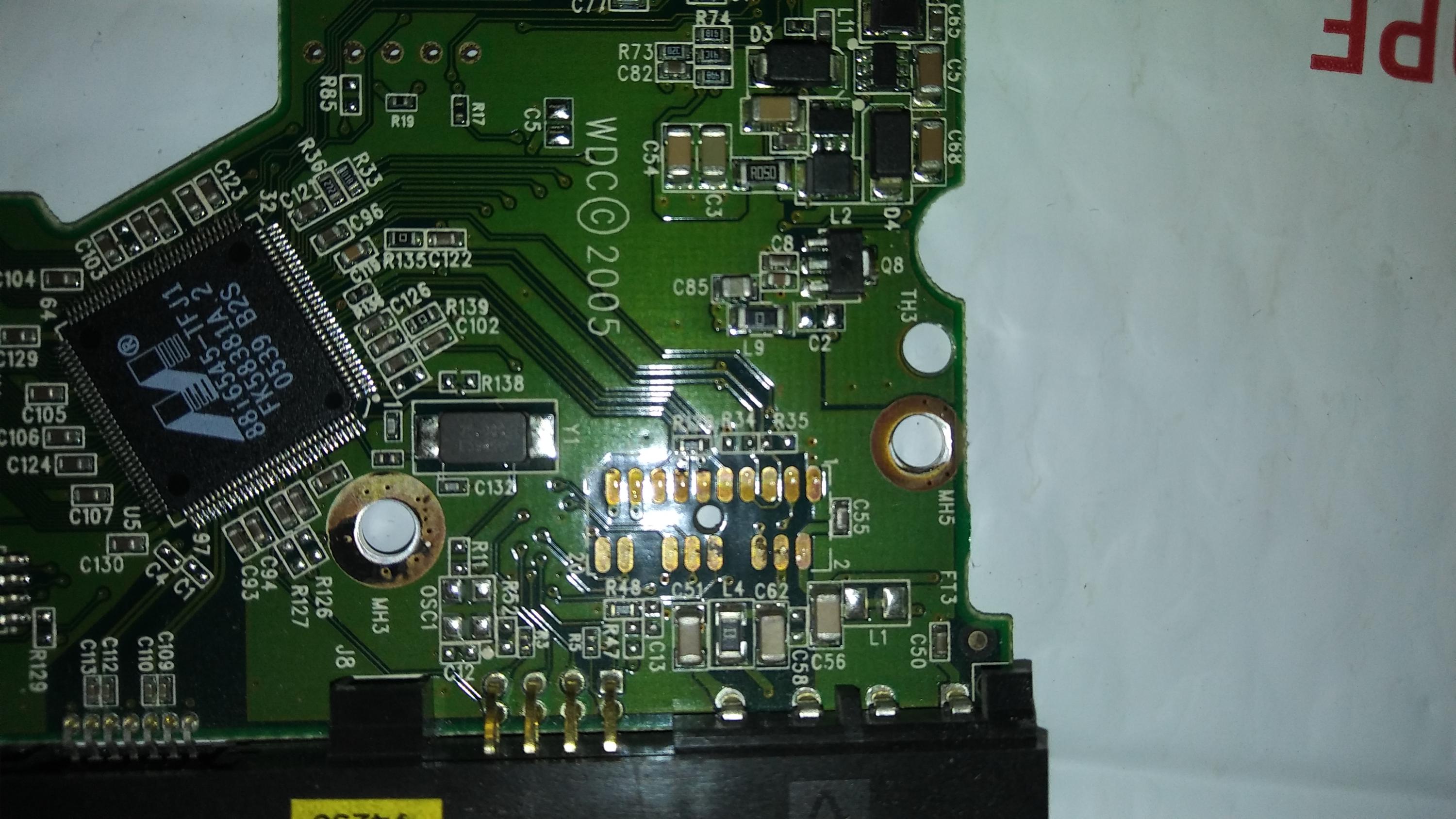

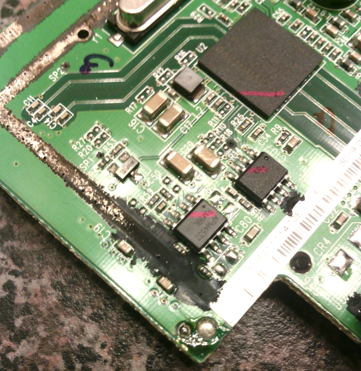

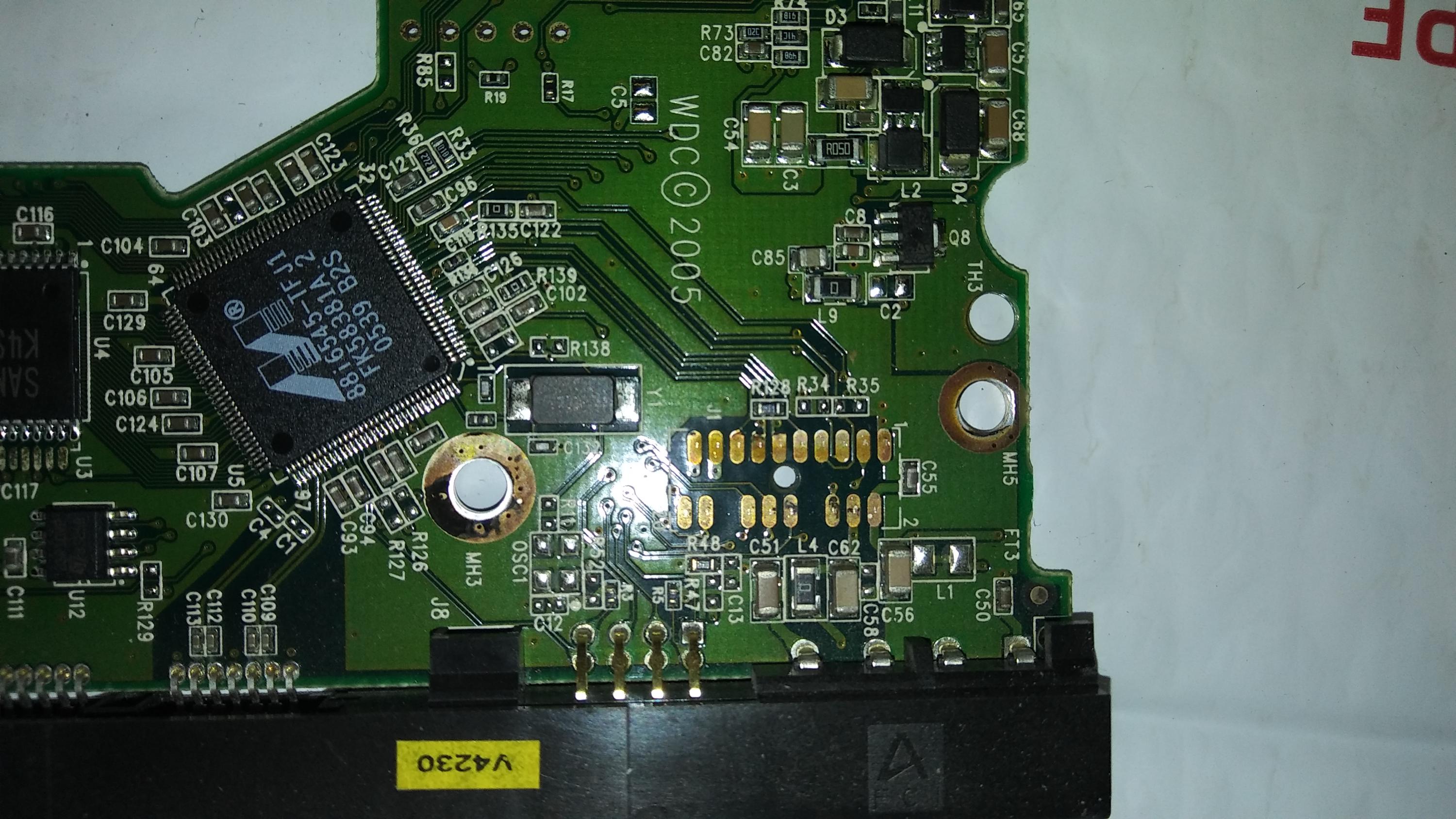

              Re: Creep Corrosion on PCB's
              Yes here is how the precursor looks.
              All WD drives I have look like this...
              https://www.badcaps.net/forum/showthread.php?t=58024
              • capwizard
                • Jun 2016
                • 1991

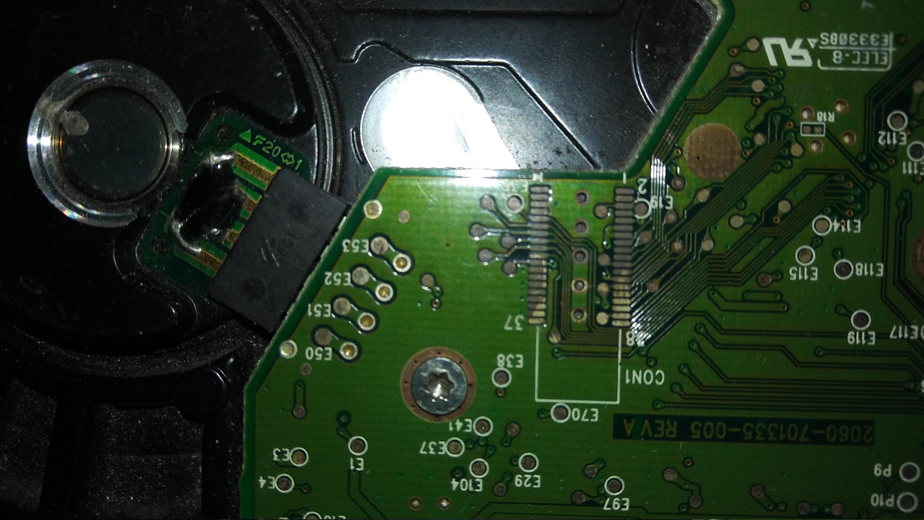

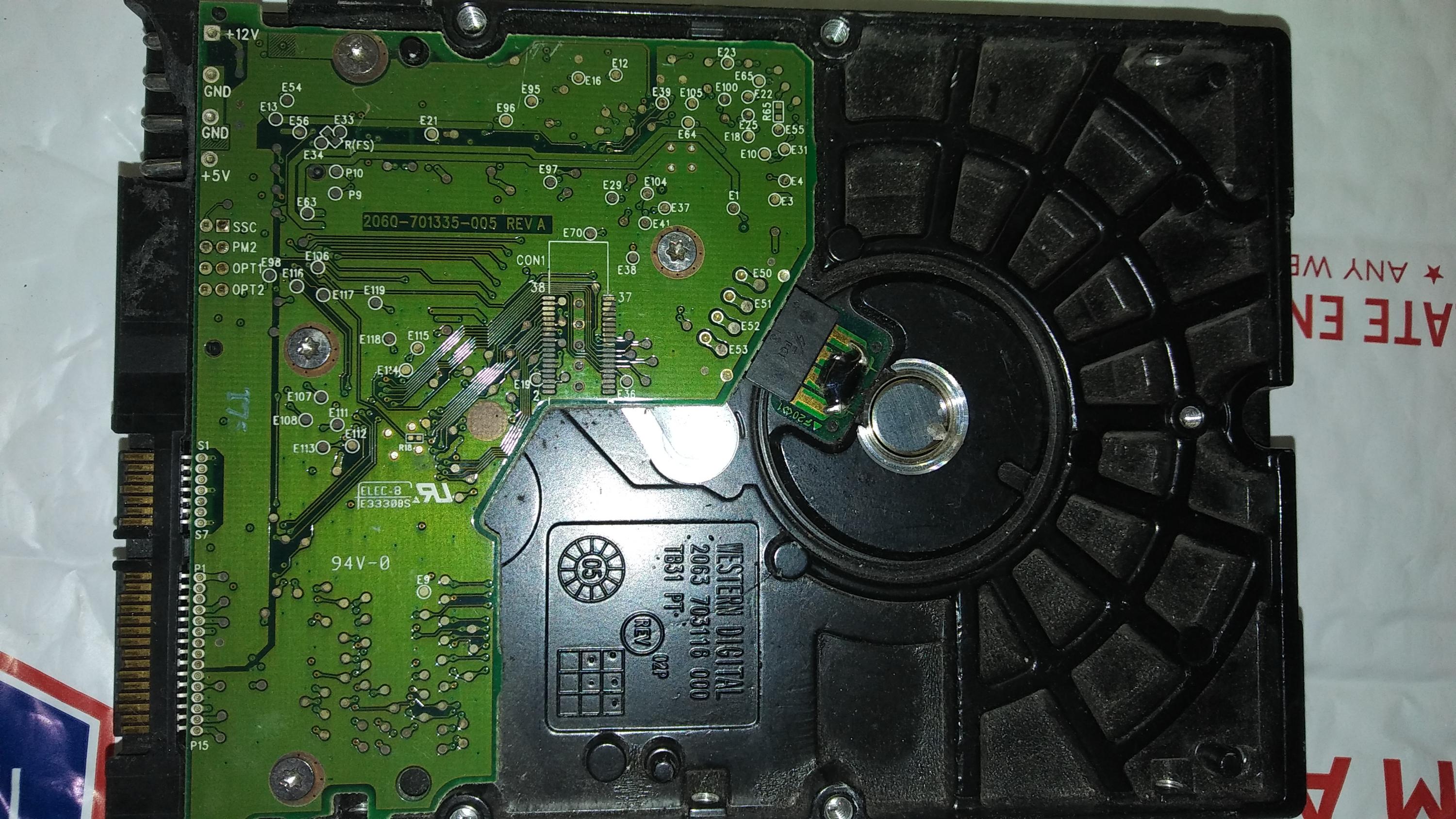

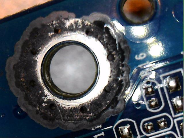

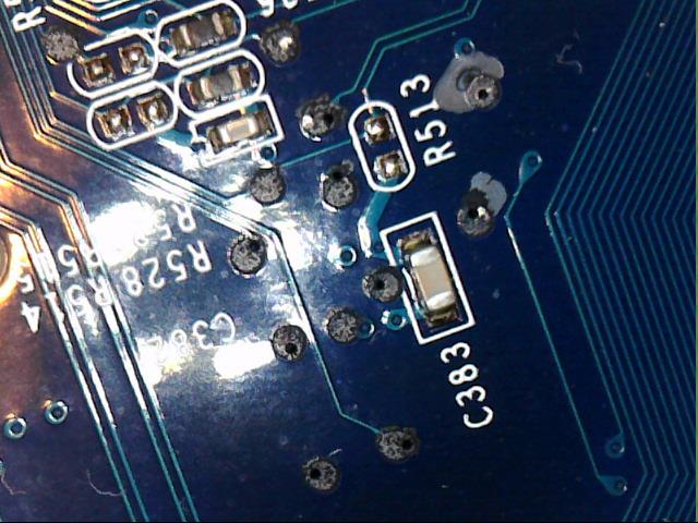

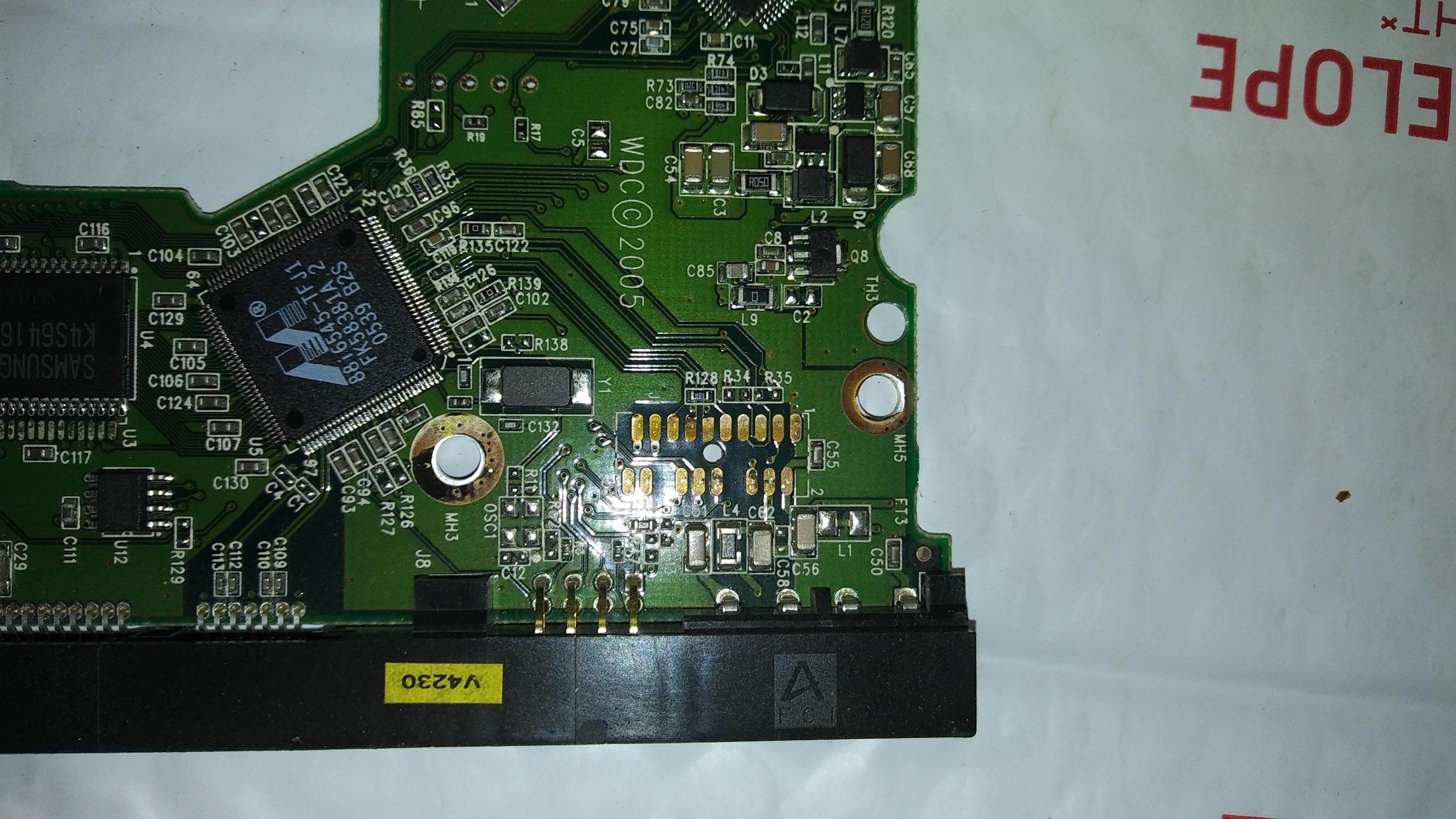

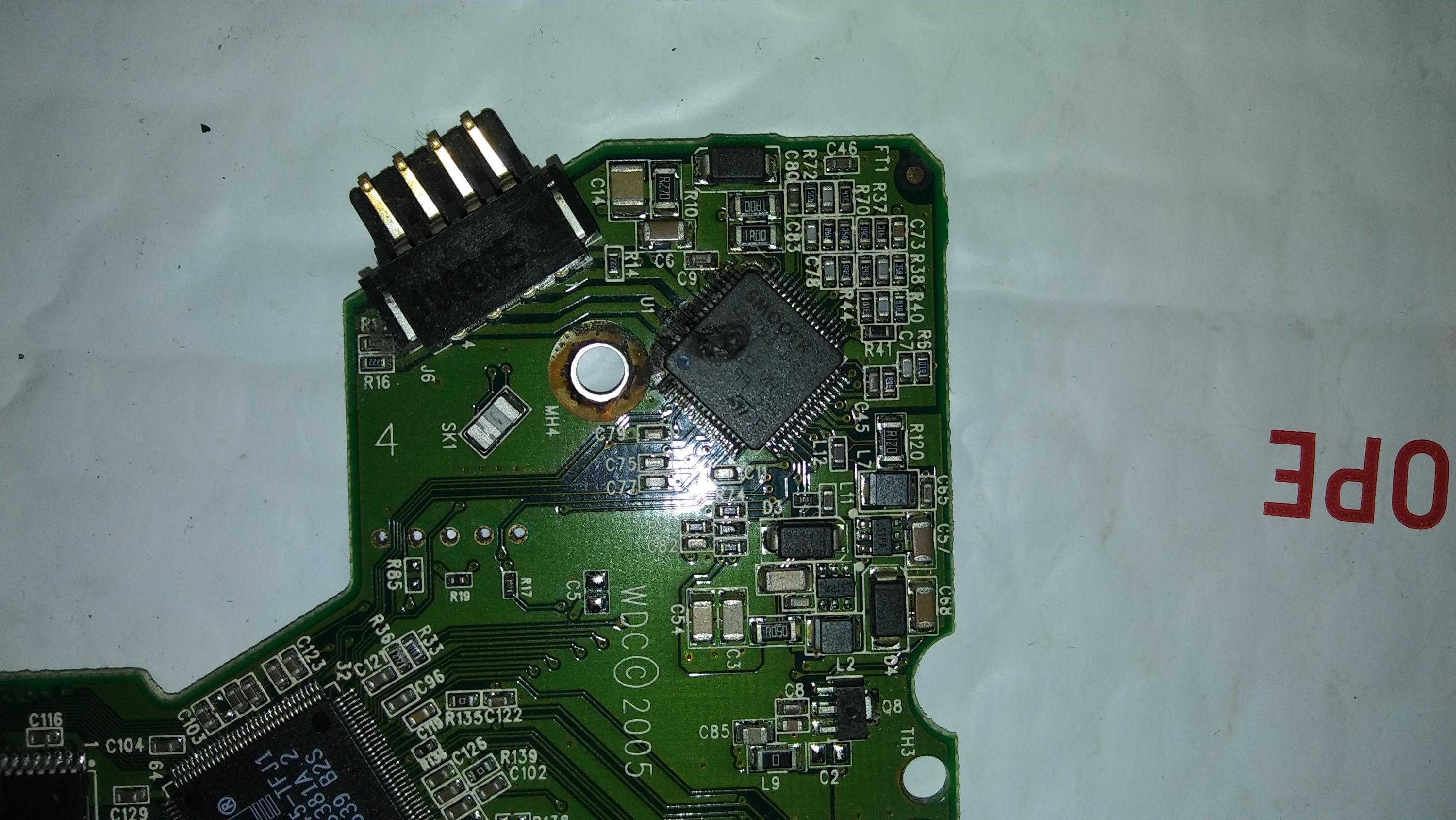

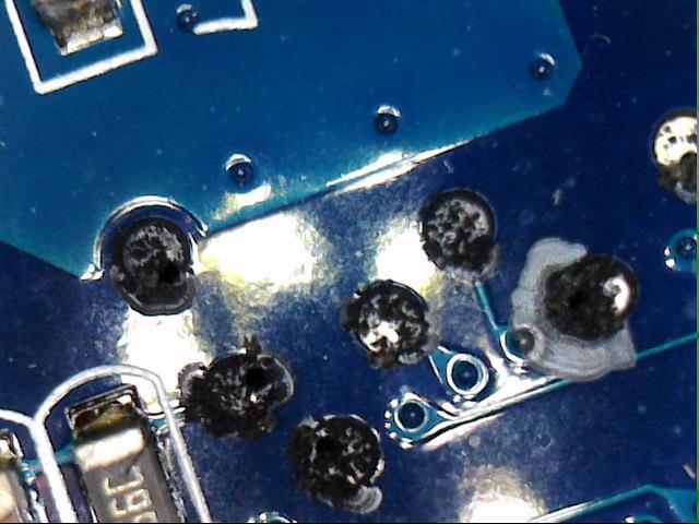

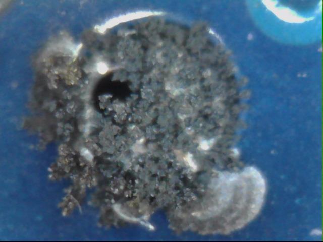

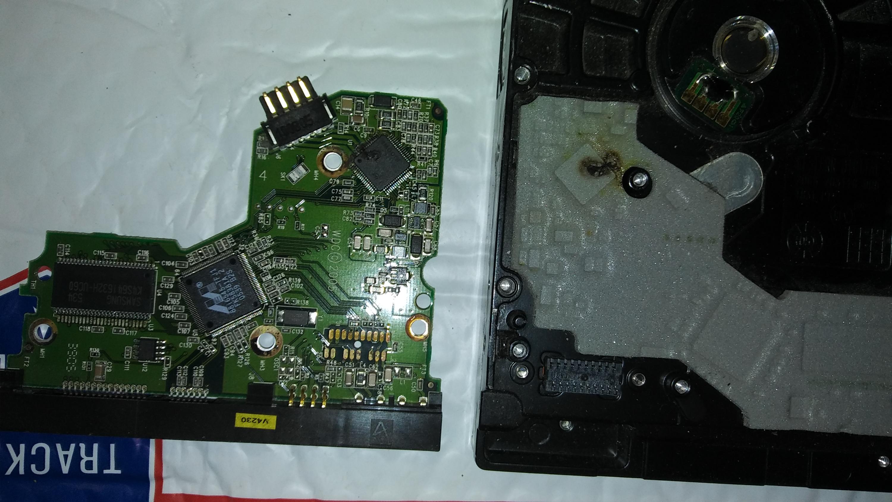

                Thank you, Per Hansson, I check my not working WD 2000: 200G IDE 5". See if you're right?
                pic3, 4: U1 This Disc motor drive IC is burnout, it is a common problem.
                pic 5, 6, 7 : The connectors to the HD heads, are like you said, are really bad, Thank you, I really did not pay attention to it.

                  The 2005 WD hard-drive head contacts look like PCB gold plating (ENIG finish) against a tin connector? The motor is all gold connections. Ah the good old days.
