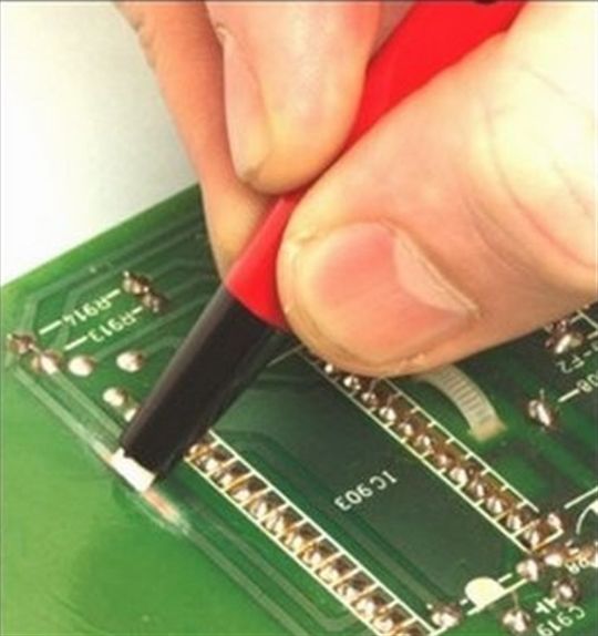

                    Soldering to the board is easy, I removed the gold with a fibre glass pencil, tinned the tracks and soldered the same 0.15mm wire I used on the plasma.

                      A fibre glass pencil, Scratch Brush, I never heard that in my life. Thank you for let me know it is exist.
                      I always use a razor blade to scratch the PCB which let me feel awkward and dangerous(will need more super glue) and Diamond bit Dremel is hard to control.
                      The fiberglass brush does a good job at removing coats and cleaning the surface of the material you are working on. I use it to clean PCB tracks prior soldering, it just works great.

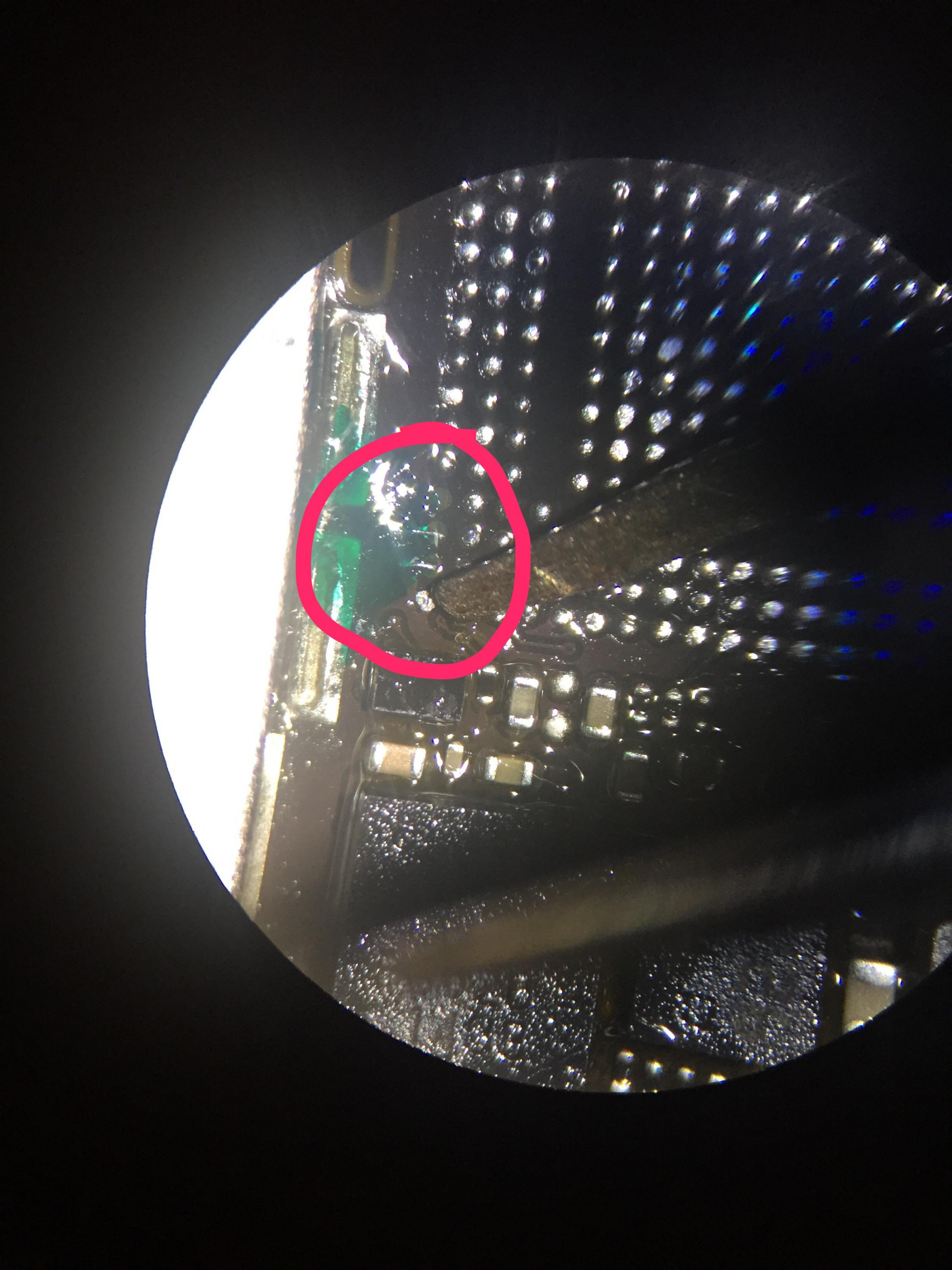

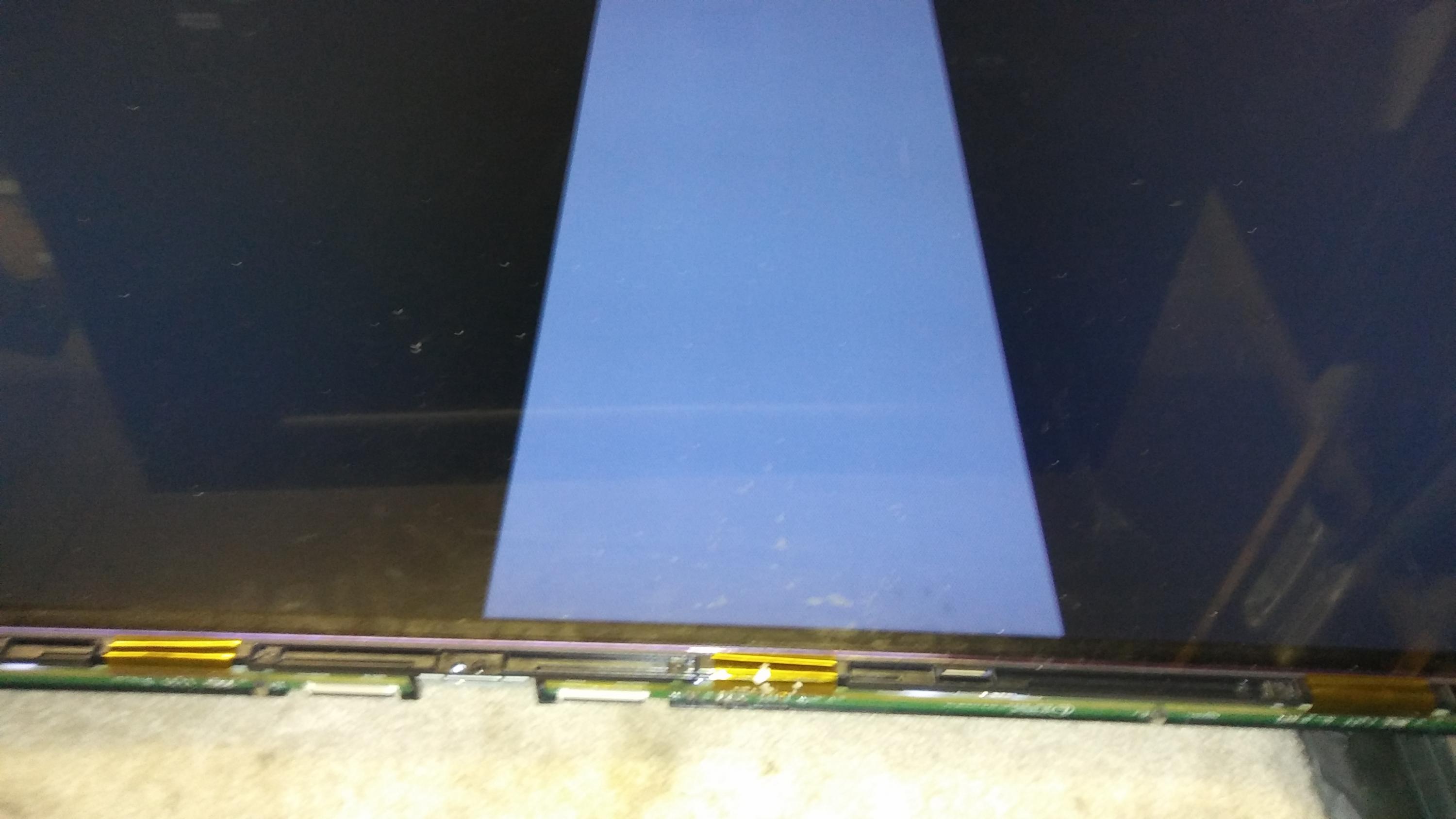

                        Yes, Silver Conductive Glue works.
                        Pic2 ; It has a short, no problem use needle take out.
                        Pic 3,4 : ...Works, but TAB IC already damaged................................ Only needs 1/4 drop glue to finish the job so buy the best quality Silver Conductive Glue.
                        Hope! Someone will find out which Silver Conductive Glue is best for our application. My glue looks never will get harden.

                          You may want to put some UV curable solder mask over that area when the connections are repaired. I usually use it on my iPhone board repairs when i'm running micro jumpers(it keeps everything in place and prevents shorts) but it may work well in this application as well.
