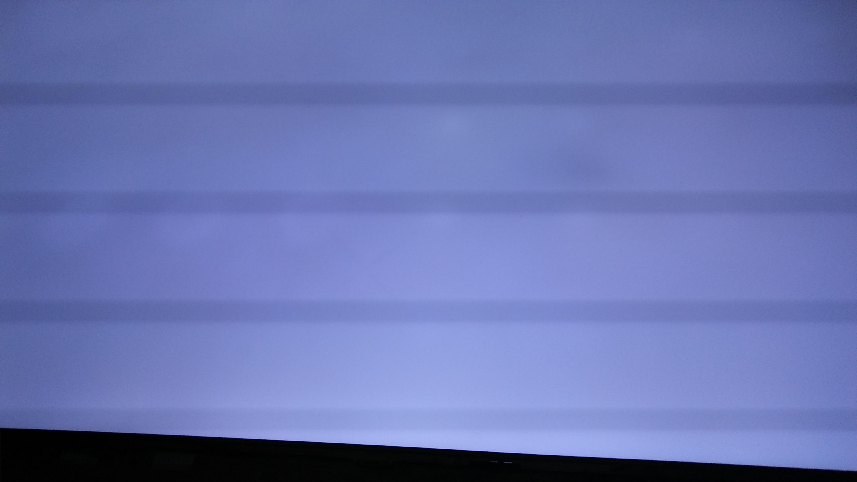

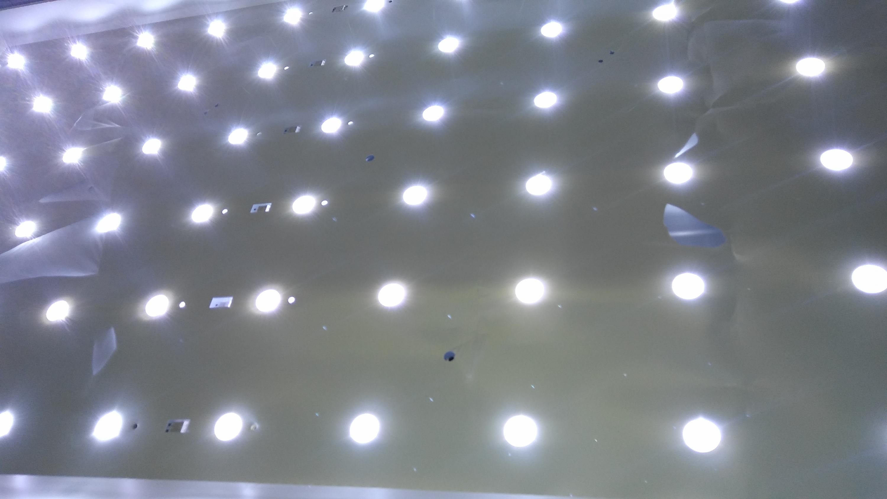

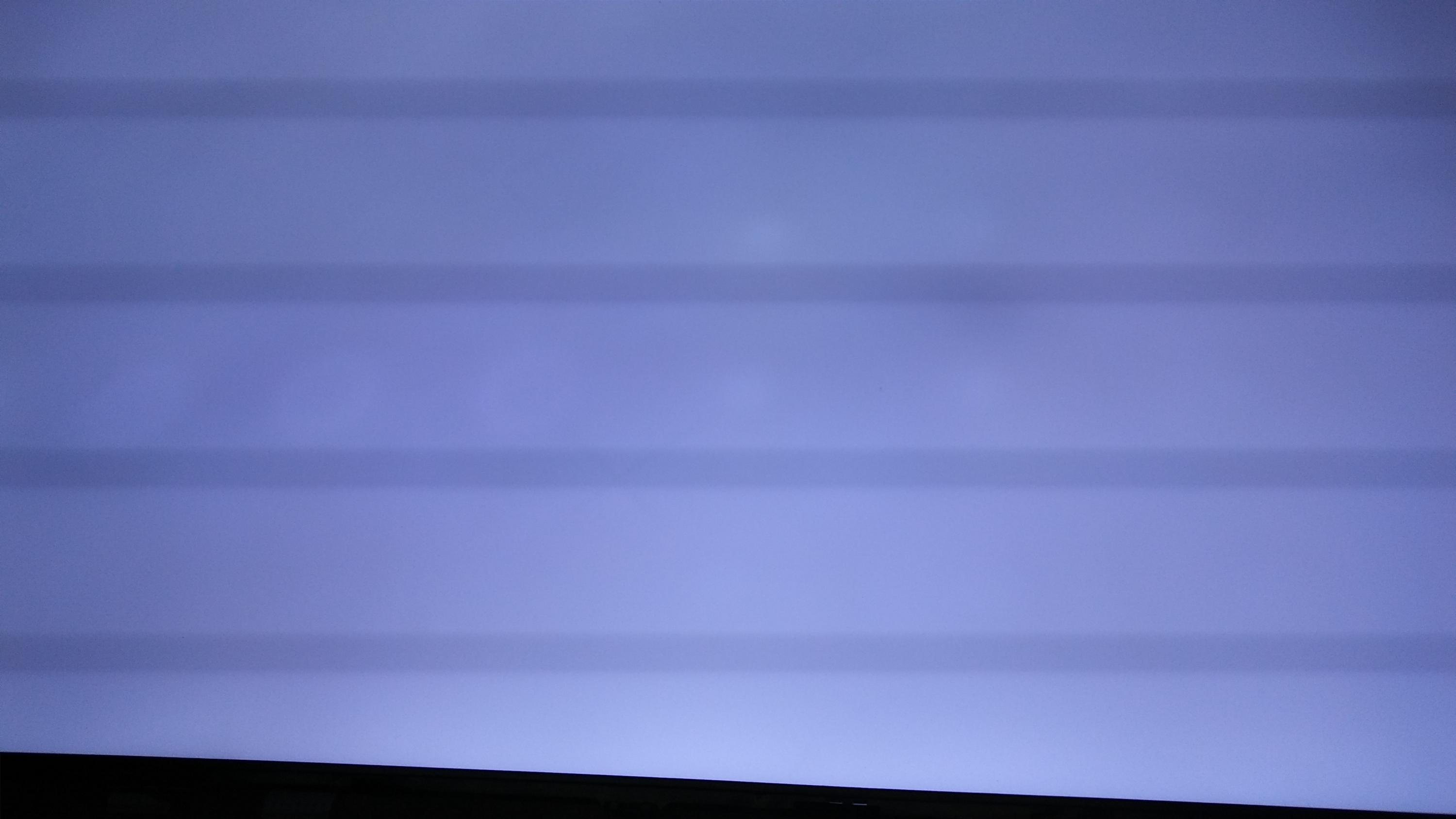

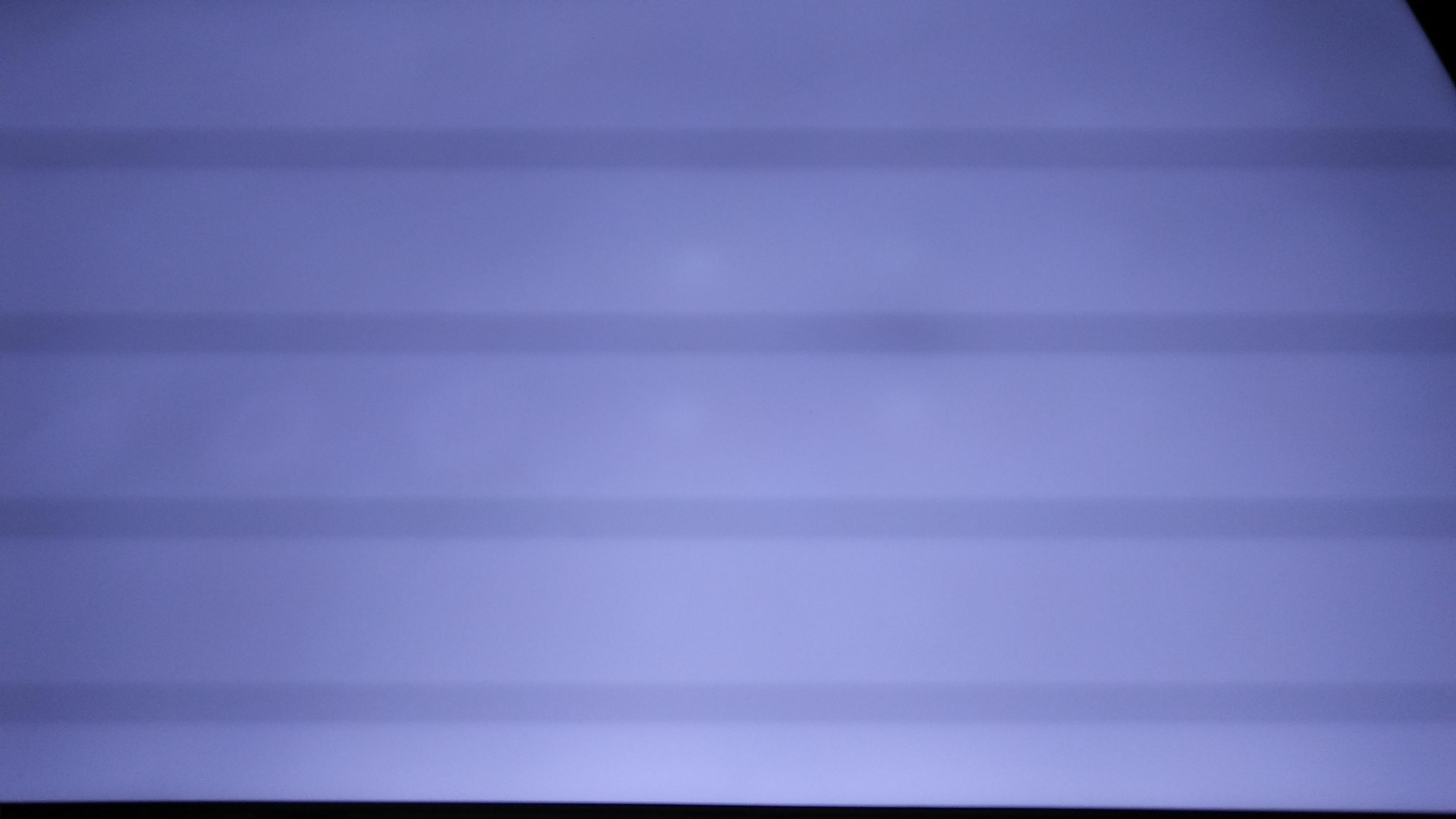

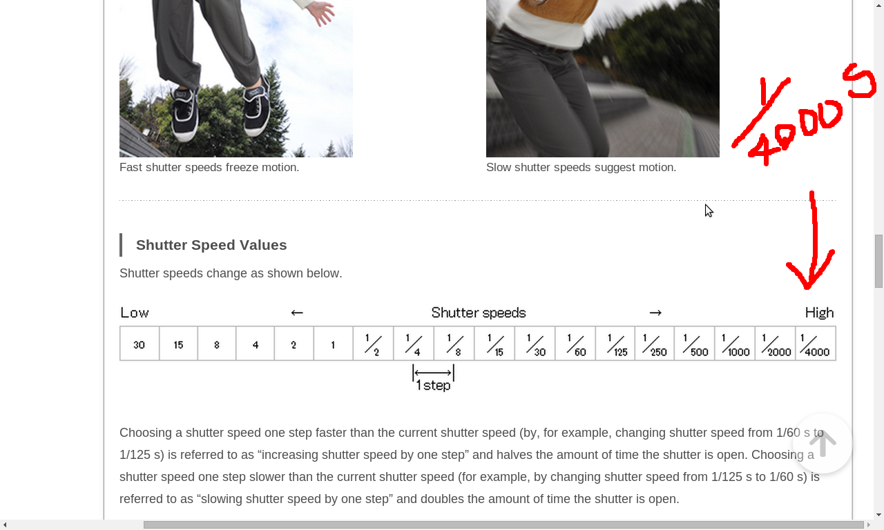

    This Hitachi LB55061 I changed LED, when I took pictures show the dark bars but not in my vision? Is something does with LED PWM blinking frequency? How can I calculate it out (camera at 1080p)?

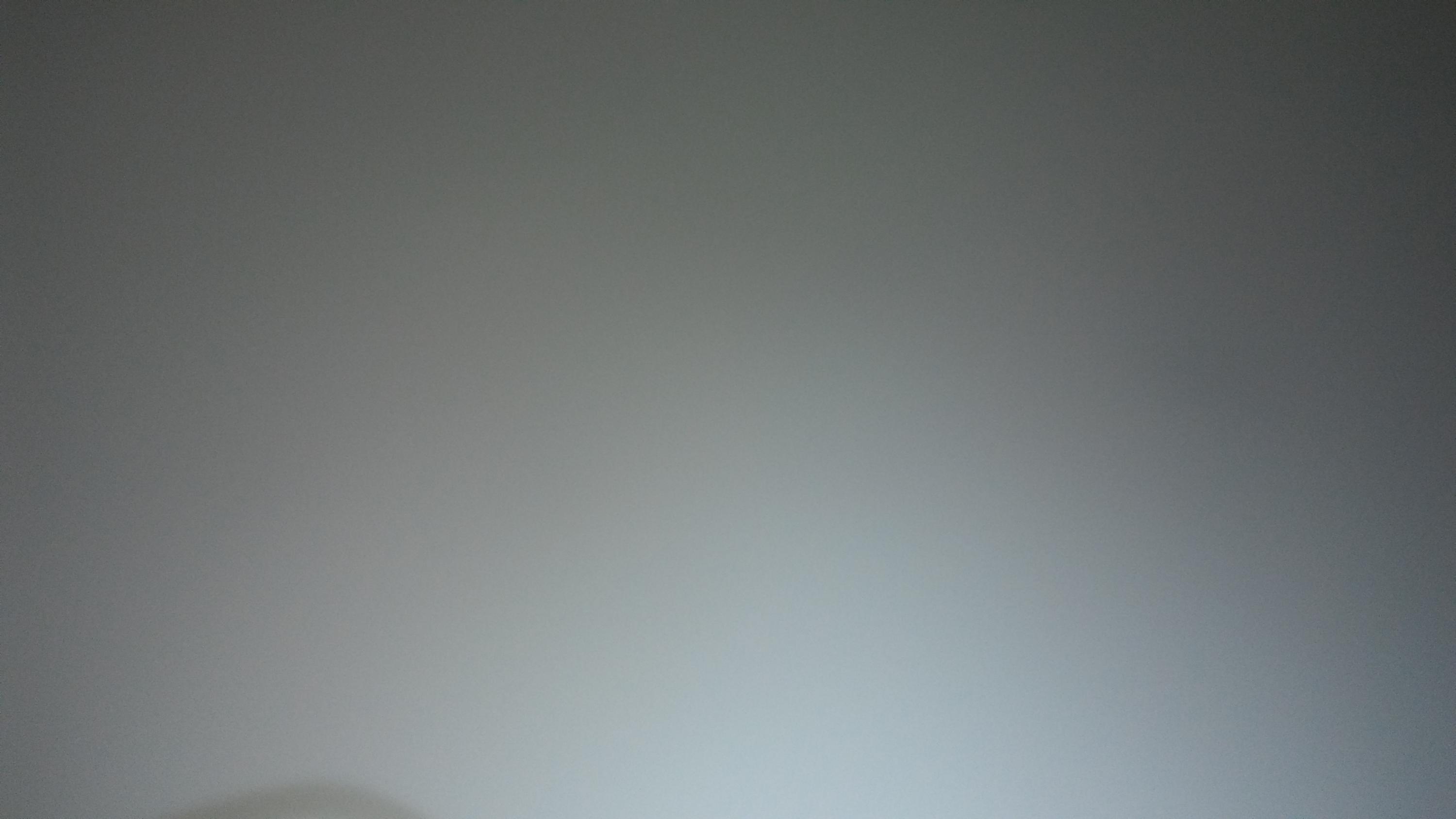

    Last pic: Took with no backlight. I dont thing so, because is in the pic..
    Is something do with this?

    Its your camera shutter speed and PWM.
    http://www.tftcentral.co.uk/articles...modulation.htm
    http://laptopmedia.com/highlights/wh...o-our-reviews/

      "We can infer that the phosphor involved in producing blue can switch both on and off faster than the other colours. the backlight will continue to emit light for a few milliseconds after the backlight power is switched off at the end of a duty cycle, "
      I saw this phenomenon, I don't think anybody can answer my question, No one will pay attention to it. budm, Thank you. Your correct answer is really surprised me!.............

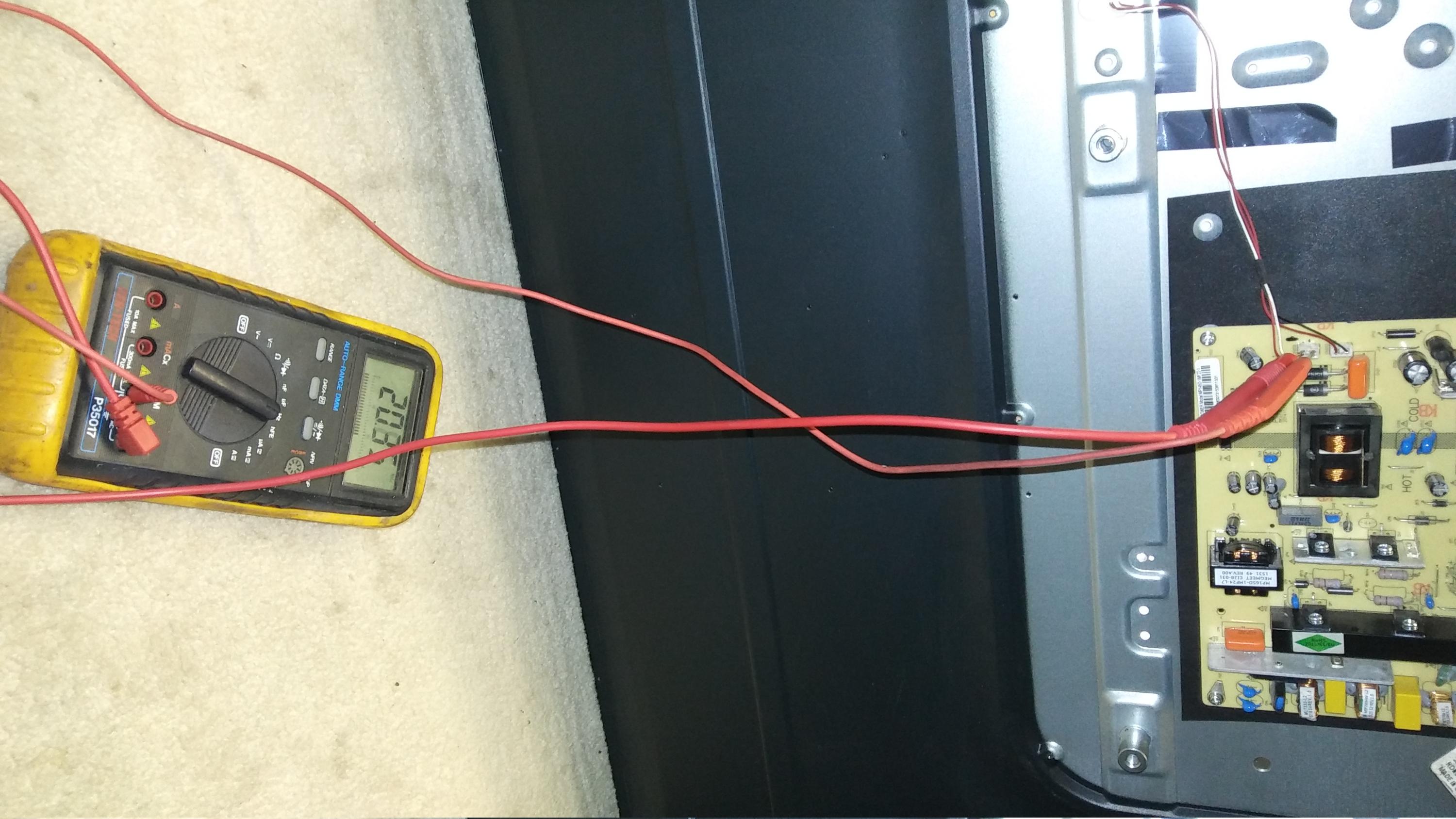

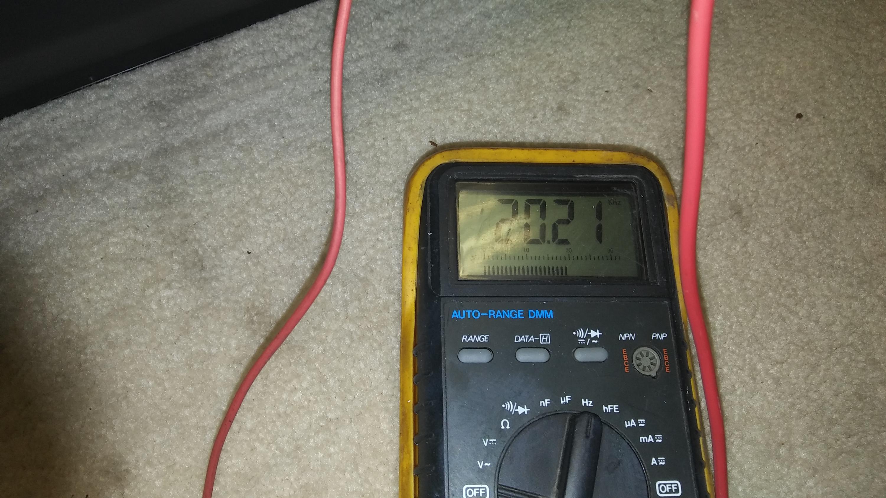

      PS: For 20 minutes I can't find my (T-mobile LG stylo 2 plus) shutter speed, so I use Meter test the frequency of the PWM to LED, found is 20 kHz. 20.000/5 bars = 4000
      "Multiply this count by the inverse of the shutter speed. For example, if using a shutter speed of 1/25 of a second and 7 cycles are counted, then the number of cycles per second is 25 * 7 = 175Hz. This is the backlight cycle frequency."
      4000 * 5= 20000 =20 kHz ...........So, 1/4000s that is the shutter speed of my phone. ........

          But ...but ...Before you say "Common on, get outta here!"...I have A question?... Why is horizontal bars instead of vertical?

            try tilting the camera.. if the lines stay horizontal, then its because the camera sensor is scanned line by line.
            Check here similar effect https://www.youtube.com/watch?v=R-IVw8OKjvQ ( just to note that it's not like the russians have implemented some extraterrestrial technology in their choppers )
