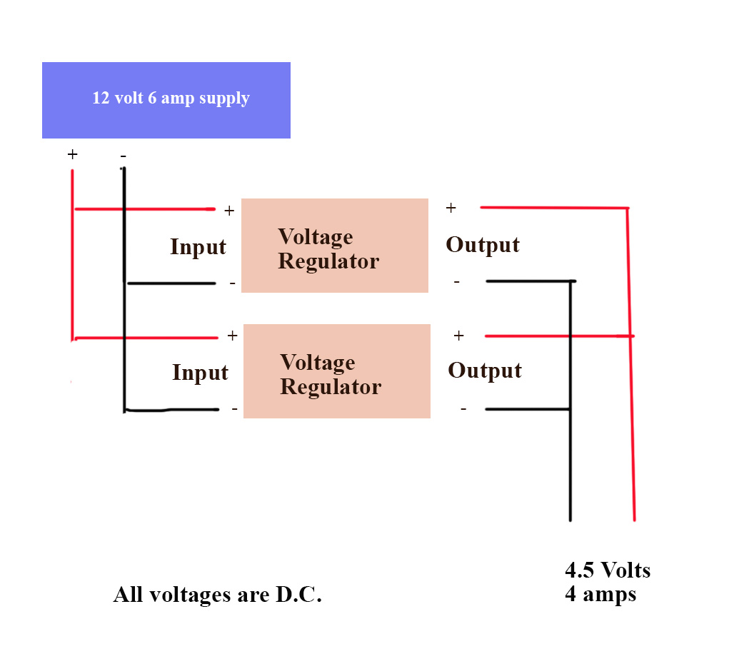

      Re: Need 4.5 Volt 4 Amp Power Supply, Cheap
      If you have a 6 amp 12 volt supply I would build up a test rig using a LM317 adjustable voltage regulator. That way you can you determine the min and max working voltage and how much current is really needed.
      As an aside, why not just throw a li-ion battery, like a 18650, into it with clip leads and see if it works. If you don't have any just cut open an old laptop battery pack.....
          Yes, I know it seems strange but C cells are rated at 8000 mah so that makes it look ok. I looked for some 18650 and I will try these also.
          I'm still would like comments on my drawing I attached. Will it work, in theory?

              No, drawing 4A continuously from C cells does not sound right, where did this number come from? Can you use a capacitor to help against instantaneous draw, as that thing can't possibly be drawing 17+W continuously. Does the device still work on batteries, did you measure how much current it actually draws? Three brand new C cells in series can get pretty darn close to 5V so it should well be within the proper operating range.
              Something else is wrong.

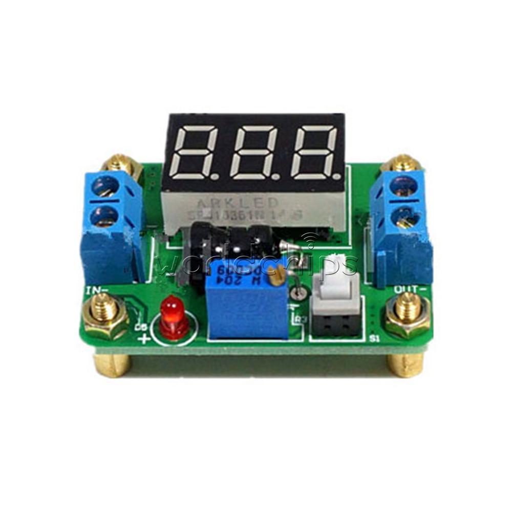

                              Here is a link to Ebay where I purchased them.
                              http://www.ebay.com/itm/20W-DC-DC-4-...MAAOSwopRYeZR5
                              Also see phot attached.
                                Ok, so the chime is a solenoid and gong... Or a loudspeaker? A solenoid could need 4amps peak.
                                That Power supply module has minimal capacitance on it, which means it is a bit noisy. Battery power is extremely quiet and it may be the receiver doesn't work well with noisy power.
                                I would add a big capacitor at the receiver's input power - say 1,000-4,700uF to see how it does. The cap will filter some power supply noise and also give a boost when the solenoid needs it.
                                  So it is buck converter, so all you have to do is to set the output to 4.5V and put DCA in series with + output to see how much current it draws and if it maintain 4.5V output..
                                  BTW, what is the feeding Voltage to that board?

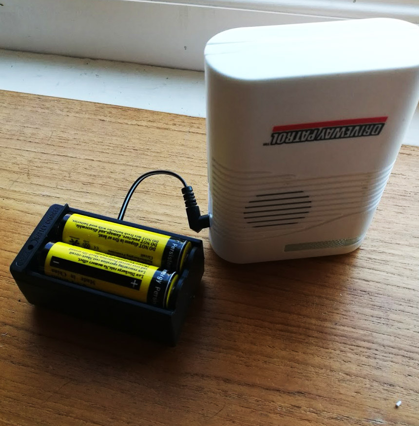

                                        So far, this works just fine. Thank you srhofmann for the suggestion.
                                        Here is what I did.
                                        1. Purchased 4pcs 18650 3.7V 9900mAh Rechargeable Li-ion Battery +2 Charger Set High Capacity. From Ebay for $12.69 including shipping.
                                        2. Modified one of the 2 chargers to be a battery holder.
                                        3. Soldered a proper barrel connecter and short lead into the "battery holder".
                                        This is working just fine. Let's see how long the batteries last.
