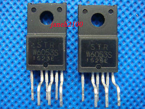

How do I test STR W6053S?
  • buchman
    • Aug 2015
    • 294
    • greece
    I need to know if it is ok and works properly.
    Thanks guys.

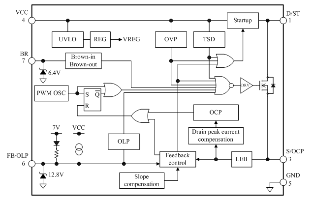

    Re: How do I test STR W6053S?
    No simple way - but if you test with an ohmmeter from the pin that is separate, to the center pin of the group of 5 - no shorts = 99.999% it is OK
      You can test internal MOSFET (pin1-3) and power source (pin5-4) see if any low resistance exist.

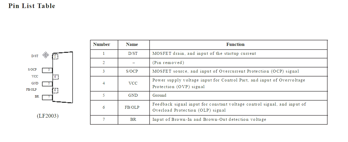

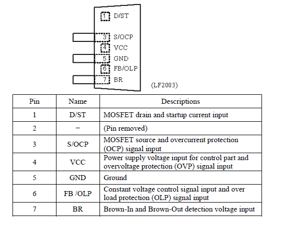

        I am attaching a table of the connections.
        Unfortunately I am not familiar with these names and functions yet.
          Originally posted by capwizard
          You can test internal MOSFET (pin1-3) and power source (pin5-4) if any low resistance exist.
          with ohm meter? what should I see?
            MOSFET (pin1-3): + - /15 M Ohm - + /389 k Ohm
            power (pin5-4): + - /1.2M Ohm - +/864 k Ohm
