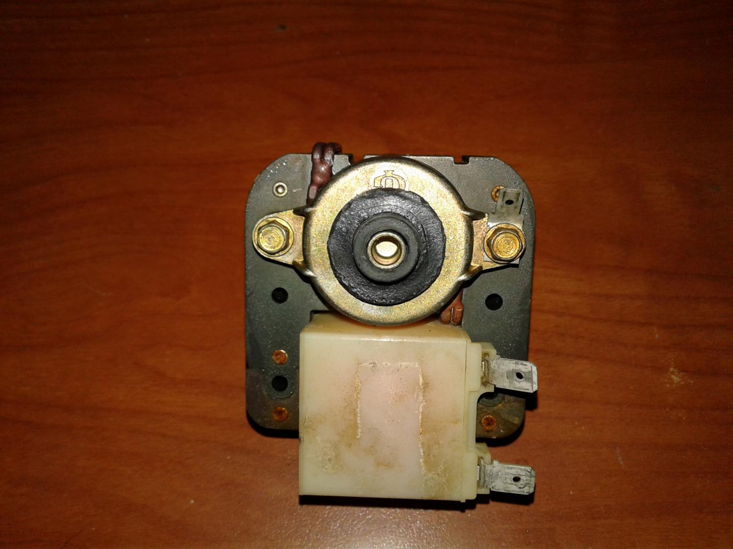

          stj, those c-frame motors have sintered bearings held by a sort of circular spring washer. The aluminum end bells have little tabs that are bent over to retain the circular bearing retainer. When these are assembled, the center of the spring retainer is first compressed, then the tabs get formed clamping the whole thing together.
          If, somehow, you manage to undo the tabs and remove the retainer, you've got no way to tension the assembly. You may get the tabs bent back down, but that bearing will be loose inside, rattling around.

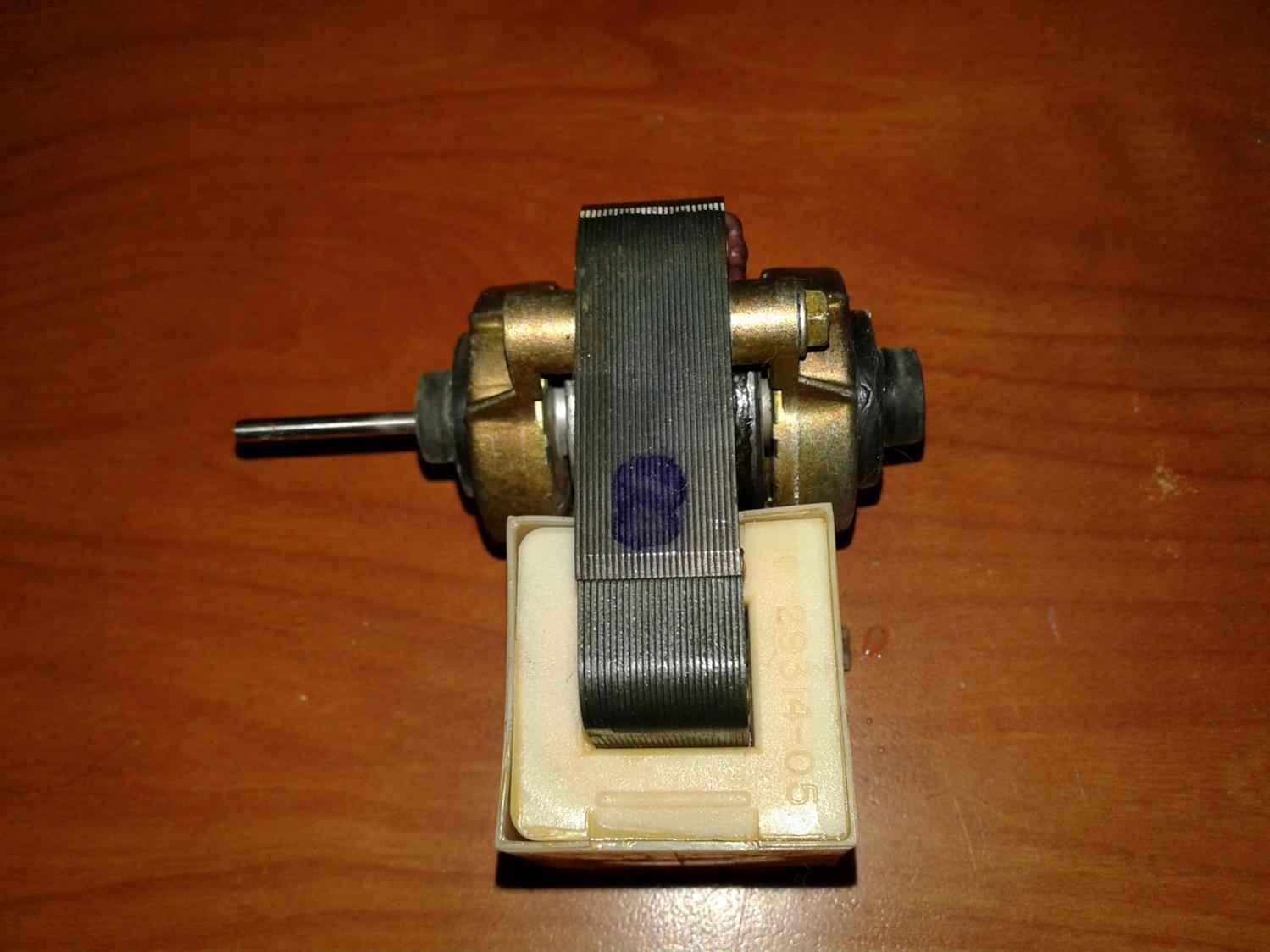

            If it is a c frame motor, Grainger has a kit for about 30 bucks. armature rotation can be reversed quickly and comes with two sizes of fan blades to fit most applications.

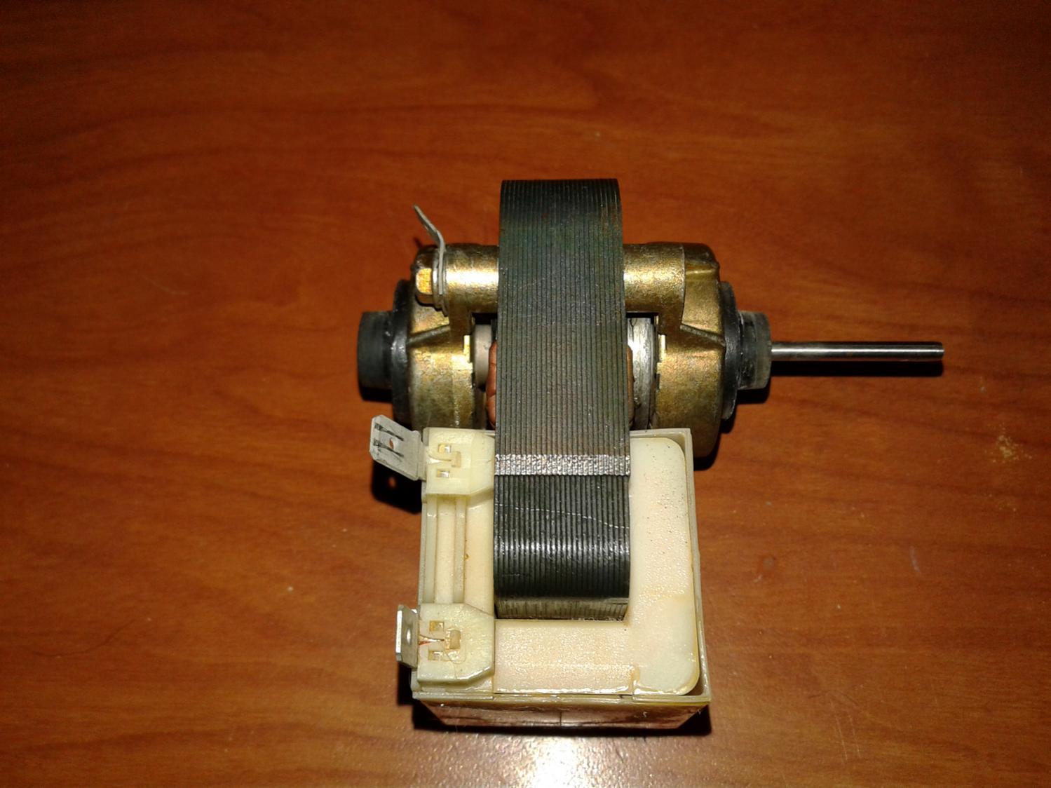

                  Okay so I'm back with the same problem. I took it out, fiddled with it, put it back in (before everything in the freezer melted) and now it's 2 months later and it started making that grinding noise again.
                  So I repeat the process, do all my research and end up in the exact same place, which is I see at least a dozen motors that look exactly alike, but none that I can find a resource to cross-reference from my original part number to the one that I think might work.
                  And, the primary issue is cost, because a motor that cross references from my part number is $90 to $120, and a new, looks-exactly-the-same motor is as low as $15.00.
                  So we're talking about $75 here.
                  Originally posted by stj
                  cant you tear it down and replace the bearings?
                  Right, so bearings, what bearings. I opened it up and didn't see no stinking bearings. What I found was a spinning thing inside of a big metal thing with two cap things on either side of the spinning thing and they all fastened together with two screws. And the spinning thing was sloppy, noisy and dirty. But no bearings, anywhere.
                  The OTHER thing I noticed was that it wobbled around quite a bit, like something inside those end-pieces was wallowed out.

                  And, as an aside, as a short-term fix I sprayed WD-40 into both end thingies, and packed some lithium grease. Also cleaned the black crud around the spinning thing and put on a layer of lithium grease on both the spinning thing and the cylinder part it spins inside of. It runs quieter now, but from what I've read lubricating them is a short term fix and the only way to get any real life out of the motor is to replace it.

                    the spining thing is the shaft, the gold coloured bit that it spins in is called a "sintered bronze bearing"
                    and yes, they wear down allowing the shaft to wobble.
                    you can get a short-term fix by putting oil on the bearing by dripping it down the shaft.

                                      Re: Need Source for Refrigerator Motor
                                      what a way to get help from forum members.learn something new every day..
                                      anyway its a dirt common shaded pole motor.
                                      a few measurements an look around ebay,surplus sites,or gasp junk fans/heaters.
