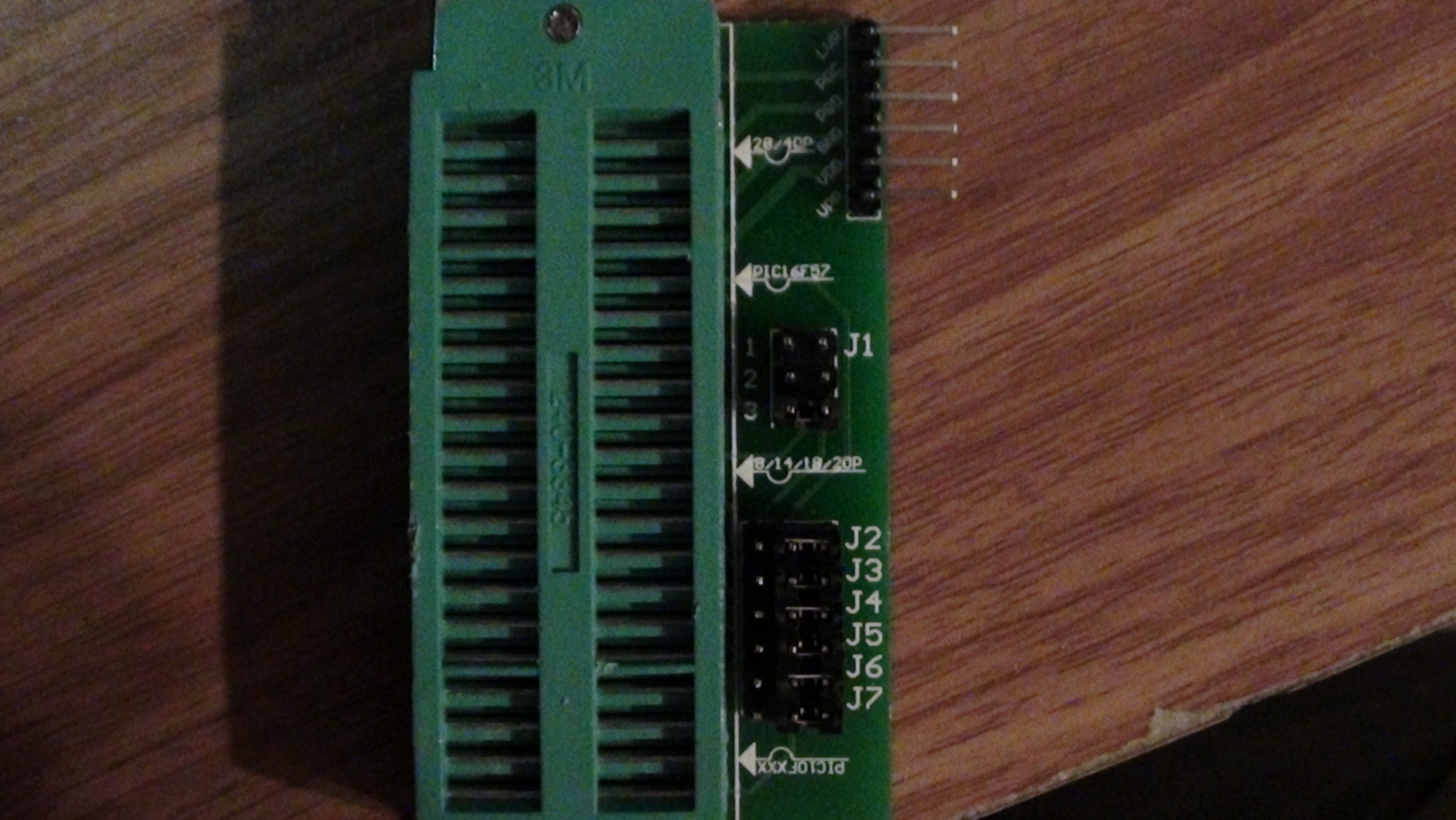

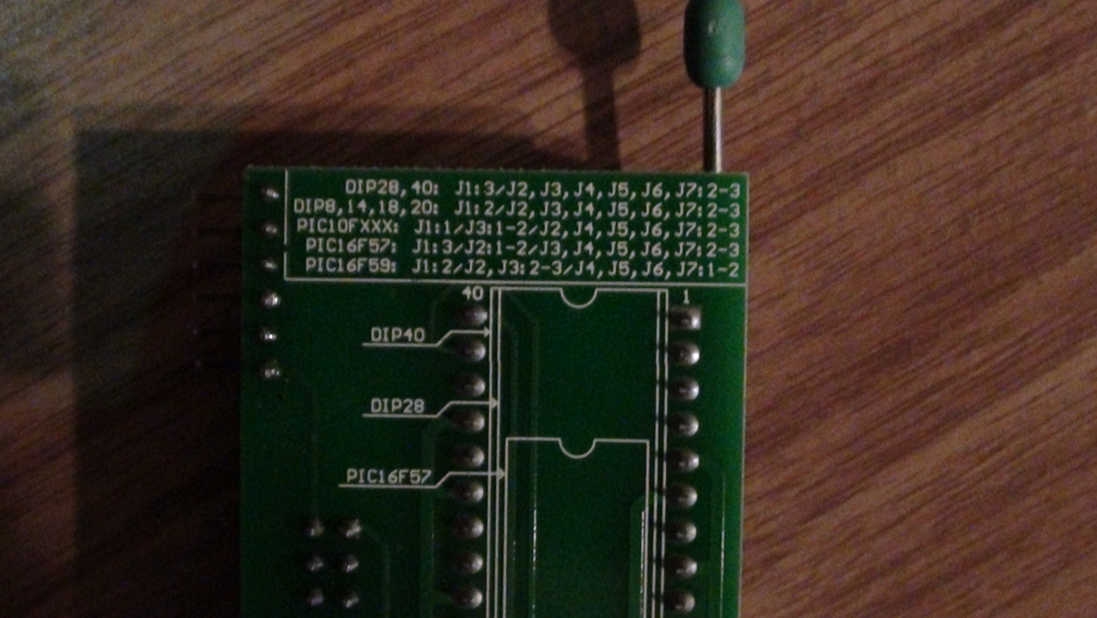

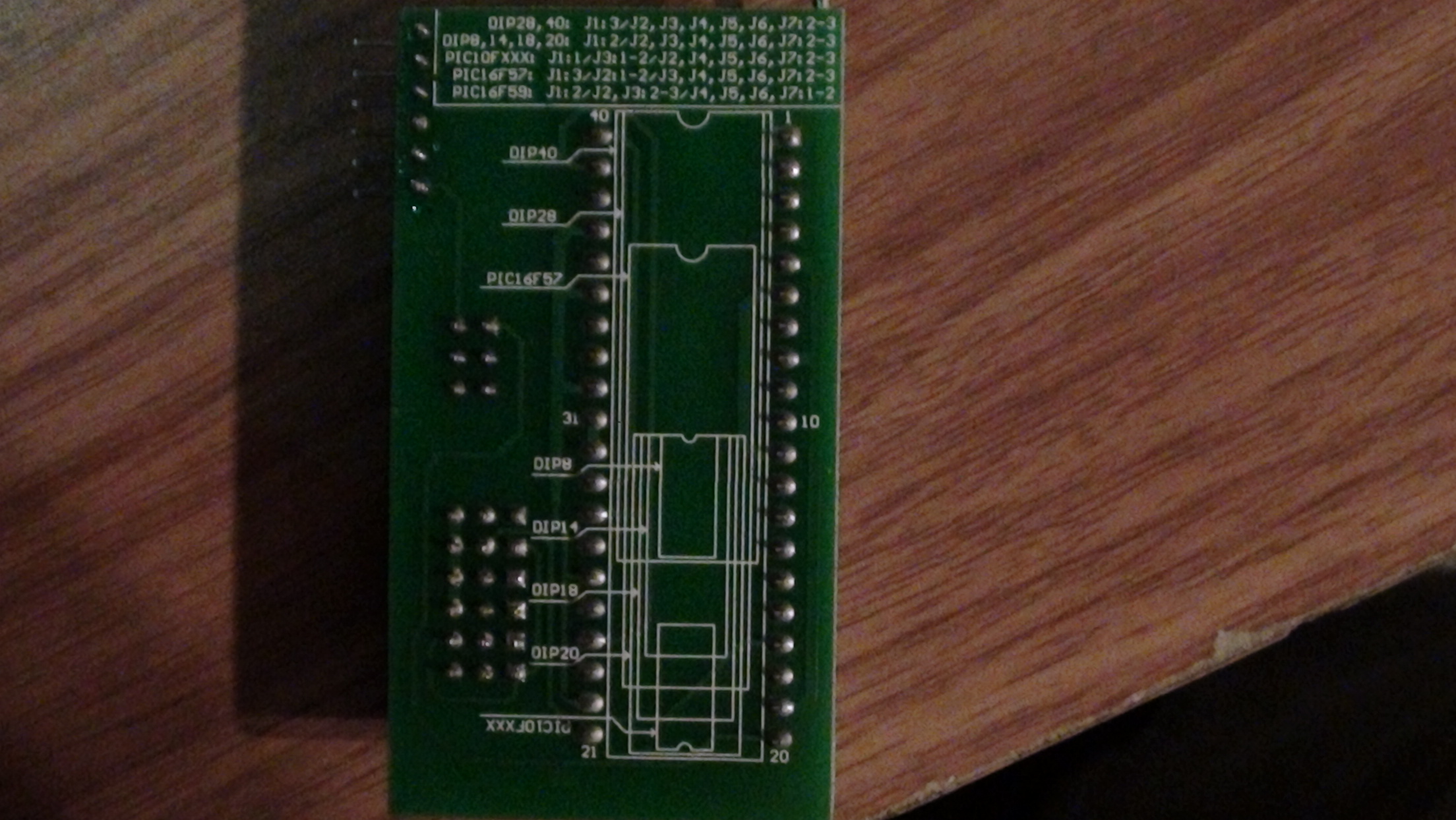

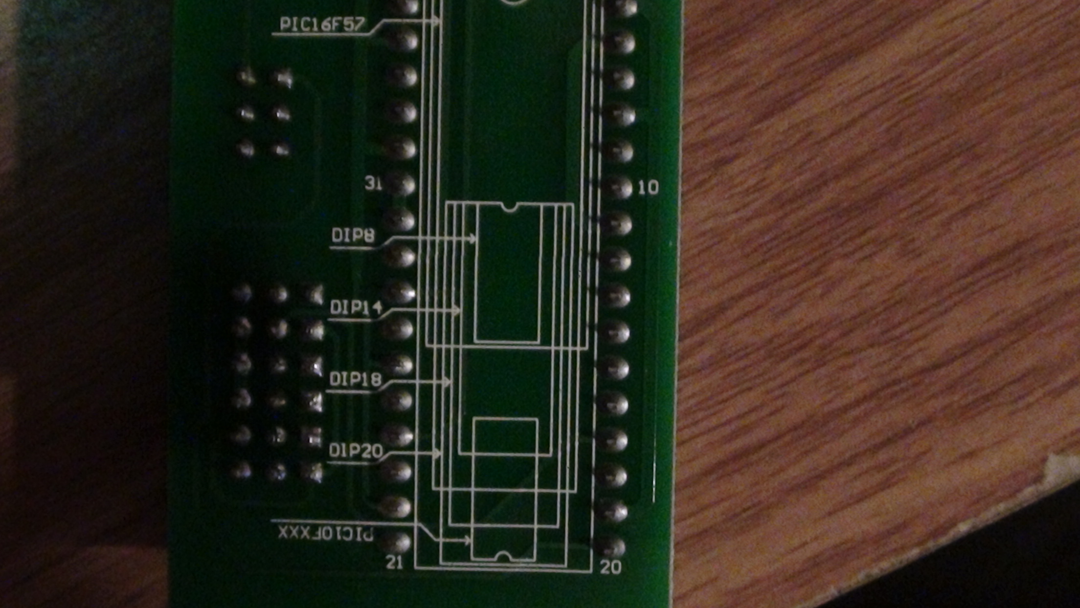

                                    I got my PicKit3 clone today!!!! But now I have a bunch of questions! Nothing came with any manuals or anything. I got a nifty ZIF socket but I'm not 100% sure how to use it. The back has some words:
                                    Code:
                                    [FONT="Times New Roman"]
                                    DIP28, 40: J1:3 / J2, J3, J4, J5, J6, J7: 2-3
                                    DIP8, 14, 18, 20: J1:2 / J2, J3, J4, J5, J6, J7: 2-3
                                    PIC10FXXX: J1:1 / J3: 1-2 / J2, J4, J5, J6, J7: 2-3
                                    PIC16F57: J1:3 / J2:1-2 / J3, J4, J5, J6, J7: 2-3
                                    PIC16F59: J1:2 / J2, J3: 2-3 / J4, J5, J6, J7: 1-2
                                    [/FONT]
                                    I have a PIC16F628A, which is 18 pins, so I'd want the DIP18 settings. Setting J1 is easy because it's a two pin header and there's three options, 1, 2 and 3.
                                    It's J2 - J7 where I'm a bit confused. There's five three pin headers there but it doesn't tell me which of the three pins are pin 1 or pin 3. They just say J2, J3, J4, J5, J6, J7. Should I assume that the pin closest to the ZIF socket is pin 1? I'll post a picture so you guys can see what I'm talking about.

                                      Each J2 to J7 has 3 pins, pin 1 is the one closest to the ZIP socket.
                                      So when it says J* set to 1-2, it means pull out the jumper and set it on the first two pins on that J jumper. Where it says 2-3, put it on the last two pins.
                                      Sounds complicated, especially without documentation. Honestly, you could have bought an original Pickit3, you only buy it once after all.

                                        Thank you! I knew how to read the jumper settings and when it says 1-2 or 2-3, I knew what that meant, just wasn't sure if pin 1 was closest to the ZIF socket or if pin 3 was. Thank you so much!
