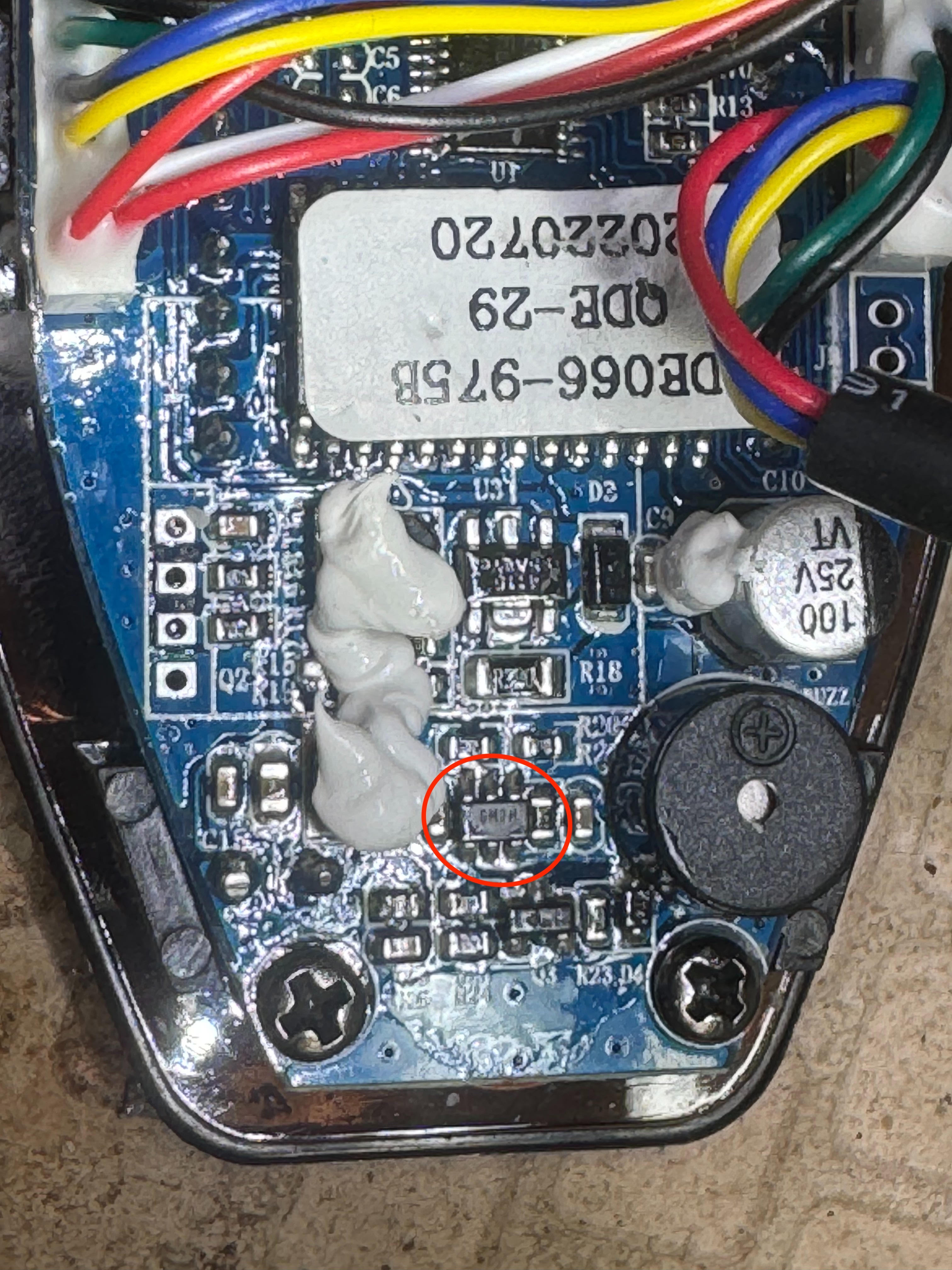

    Hi
    working on a not turning on Wheelspeed WS1 scooter.
    diagnosed - issue is the display/power button
    on the board, with the multimeter I noticed there is a short to ground. as the red wire has 0 ohm to ground.
    with infrared camera, this chip (photo circled) would heat up if I push power button on.
    but I can't find any replacement or online info of this chip.
    on the chip you can see it has a label GM2H, I have another good working display with the same chip but it has label GM2C
    could anyone help me id this chip and guide me to mouse or digikey which chip I should get
    the scooter is 36v
    thanks in advance

    It might help if you could trace the circuit around that IC. At least identify its power and ground pins.

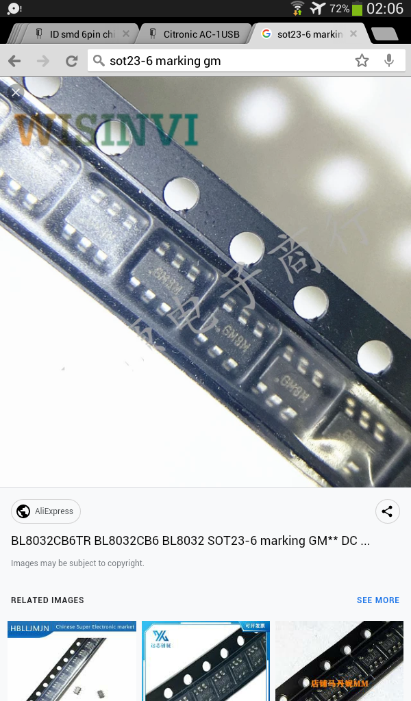

      BL8032

        thanks BL8032 seems close to it, pins according to the PDF looks the same, I will try to buy this
        thanks again

              When you're measuring the short to ground, I assume you're measuring it on the header that comes in from the master controller plug, and not at the IC's leads?

                According to eBay seller the data sheet showed
                pin 1 ground
                pin 3 vin
                I had short here or continuity
                when I removed the chip
                then the short to ground was gone
                before when I test for continuity my wire red and black was 0 ohms
                after removing chip
                it was gone
                checked the chip off board
                pin 1 and 3 shorted
                so I hope that is the issue
