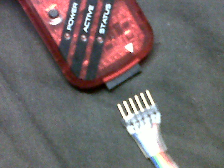

    I'm interested in buying a PicKit 3 programmer, like the one located here:
    http://www.microchip.com/Development...paign=PICkit+3
    I've modified a circuit that has a pre-progammed PIC (16F628A) and added an ICSP 6-pin header. I noticed though, that the kit only comes with the PicKit 3 and a USB cable. Does anyone know where I can get the 6-pin cable at? Also, I've seen talk about an RJ-11 connector. Is that just for debugging in-circuit or am I supposed to be using RJ-11 connectors instead of ICSP 6-pin male headers? If so, that'd really suck.
    Finally, I see talk of some special header for in-circuit debugging. It appears to be a circuit board. But there's a few different "header" packages. How useful is in-circuit debugging and do I really need to purchase one of these special "headers"?
    Here's a link to a PDF that talks about the various headers. https://cdn.badcaps-static.com/pdfs/...9062dabff9.pdf
    This is all new to me so I apologize if some of my questions sound a bit naive. Thank you.

    got a pk3 here.
    the pk3 uses a socket-strip 2.54mm pitch 6pin
    i make cables using pinstrips.
    btw, the design is open and the chinese have nice clones.
    http://www.ebay.com/itm/141774464184
    this one comes with cables and a programming board!
    (my next upgrade )

            I was thinking for the cable, maybe something like this:
            http://www.ebay.com/itm/5pcs-of-Dupo...YAAOSwm8VUr37w
            What do you think Stj?
            -- Law of Expanding Memory: Applications Will Also Expand Until RAM Is Full
              • 31140
              Re: Questions about PicKit 3.
              the pin pitch is the same as stripboard or a chip, .1"
              it's intentional so you can put a pin-header on the board and just drop the programmer onto it without a cable!
              (providing you leave clearance around the pin header for the programmer casing)
              mplab-x is free.
              http://www.microchip.com/pagehandler...family/mplabx/
              and the chinese clones dont have issues because microchip made the original schematics and board layout public!
              the ebay link will work, but it's a lot of money when you can just get a strip of 30pins that you snap to size for next to nothing.

                Thanks! On this design, there's no way to fit the PicKit on the board. I should've thought of that before but when I was looking at PicKit's on ebay, I didn't realize they where clones and I thought all of them came with a cable. I might try to just make a cable myself if I can find a cheap enough female header / socket that goes into the PicKit. I really appreciate all the help.
                If you're certain the chinese ones are of high quality, I could save some cash and buy one that comes with the cable and one of those nifty ZIF sockets.
                  • 31140
                  it's male - with pins that goes into the pk3
                  i would 100% go for that chinese one with the chip-socket adapter.

                    pic
                    • Spork Schivago
                      • Mar 2012
                      • 4734
                      • United States of America
                      Originally posted by stj
                      pic
                      Thanks! No idea why I said female. I need female end for the board, the male end for the PicKit3. I'm going to order the one you linked to me. It's not in the states so it might take a little bit to get here, but it seems to come with everything.
