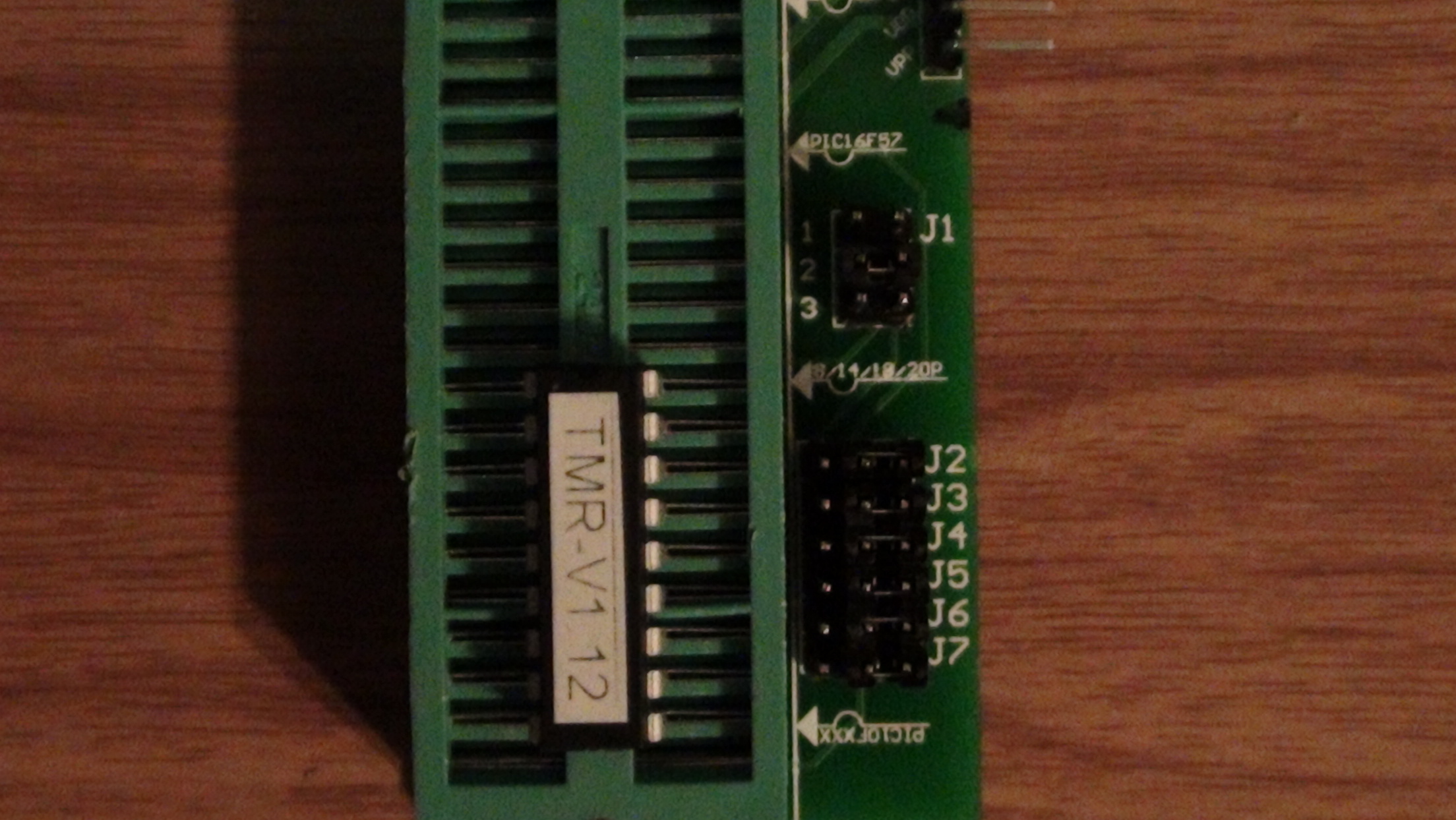

      I have J1 set to #2 and I have J2 - J7 set to 2-3. Here's a picture of how I have the PIC installed in the ZIF socket. I've verified the right pins from the ZIF socket are going into the right sockets on the PicKit3, I didn't want to plug it in backwards and risk frying stuff.

        Re: Questions about PicKit 3.
        pin1 on the jumpers has a square pad on the other side,
        the no-power thing is a classic for people who dont download the pdf.
        you need to go to the "power-tab" in the programmer options and enable the power output from the pickit.

            Yes, I figured that out. I believe the PicKit2 would auto-detect whether there was voltage or not on the pin and if there wasn't, it would just supply it. I've made sure the power button was checked and I verify with the datasheet that the voltage was good (5v). I get a different error now:
            Code:
            Connecting to programmer...
            The programmer could not be started: Could not connect to tool hardware: PICkit3PlatformTool, com.microchip.mplab.mdbcore.PICKit3Tool.PICkit3DbgToolManager
            I know my J1 is good, but my J2 through J7 jumpers, do they look correct? Or do I need to move them all over to the other side?
