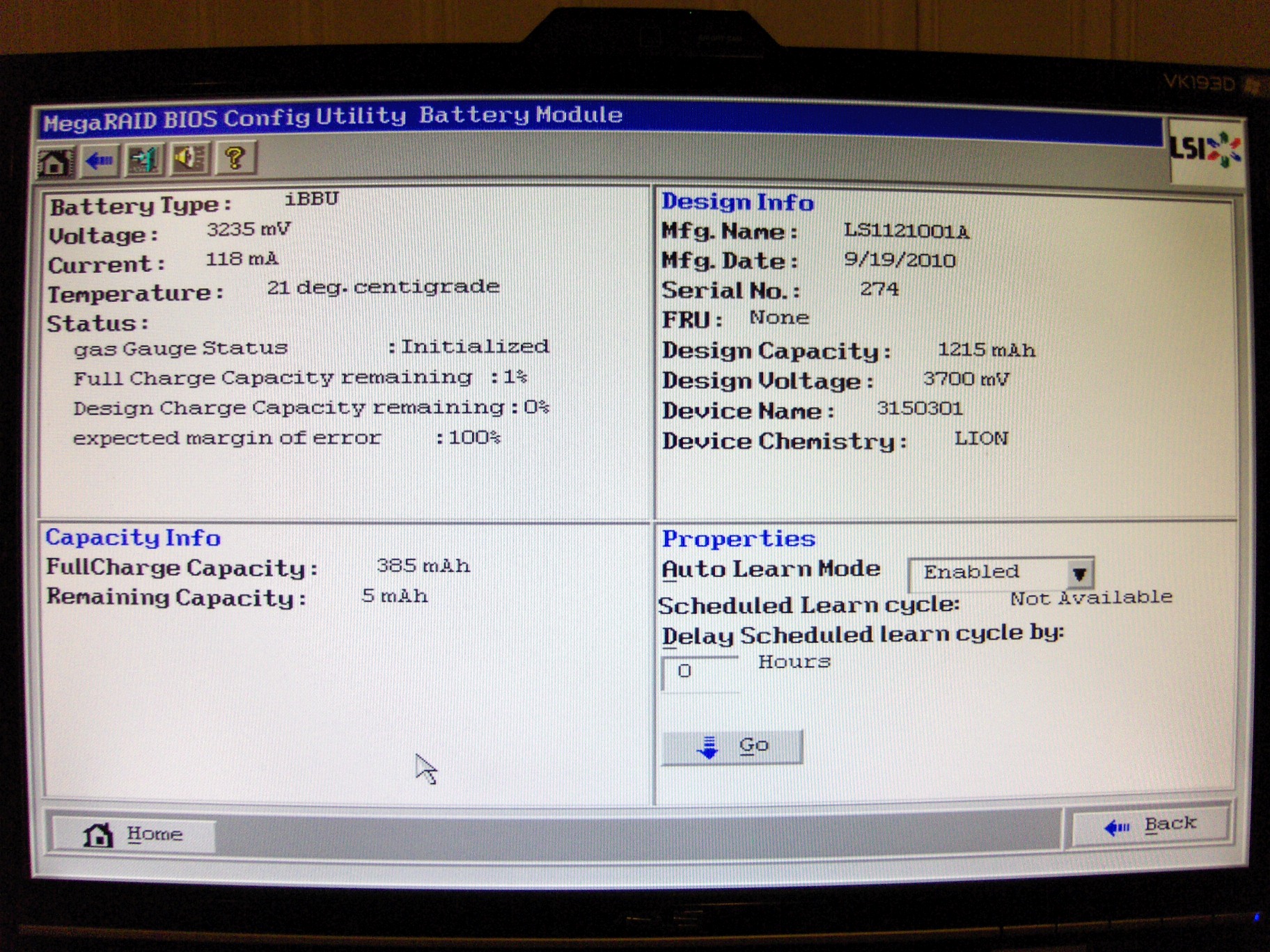

                              I finally got hold of two defect Lsi battery modules for free to play with.
                              Boy howdy was I lucky, no sn0710031 on this board but a TI bq2060a using an external eeprom. So instead of trying to modify the Dell unit I will use the Lsi modules by replacing batteries and perhaps reprogram the eeprom.
                              The Dell and Lsi units use two different batteries, both batteries are Li ion but they have different capacities and the Samsung battery has a hard metal case as the Sony US503759 a8h has the regular softer package.
                              Sony battery is 1350mAh and Samsung is 2000mAh.
                              Can I use the Samsung ICP103450S battery on the Lsi board or will it catch fire ?
                              I can perhaps dump the eeprom content and I should perhaps be able to zero it out to make sure a new battery will be charged properly, if you see the pictures the defective battery has only 385mAh left,eeprom also holds serial number, manufacturer information and design capacity.
                              Anyone good at hex editing ?

                                      Anyone up to date on battery chemistry ? I'm worried about cut off voltage and charging current to be incompatible with the Samsung battery. Are they compatible ?
