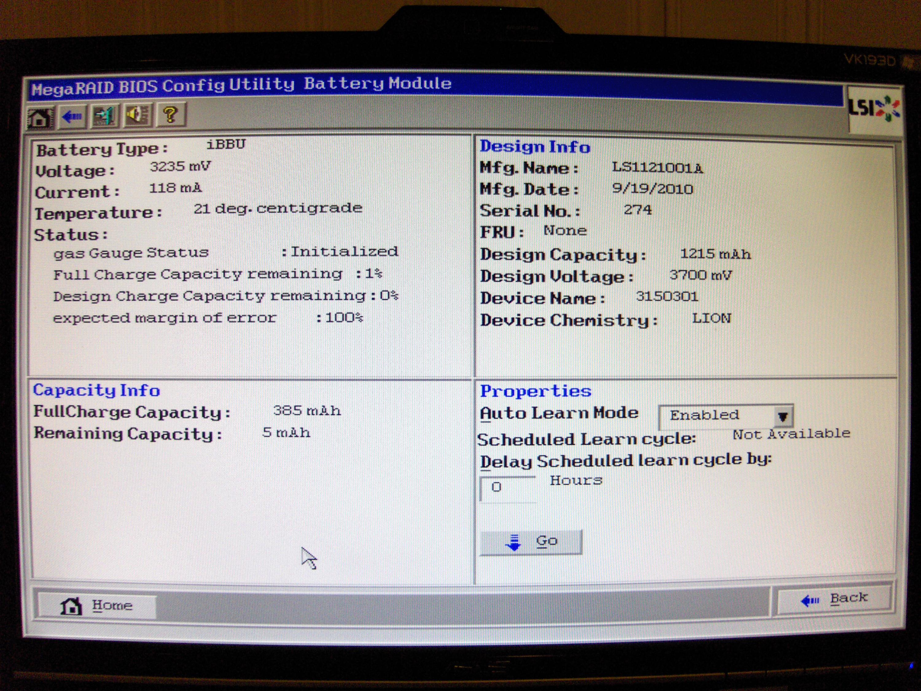

    So I have a bin dump of the eeprom - I verified it too so everything is ok.
    Some of the content is easy to match up with the information the raid bios and the raid software in windows provides.
    Looking at the Megaraid bios and comparing with hex workshop I can see
    Mfg name - LS1121001A
    Device Name - 3150301
    Device Chemistry - LION
    The serialnumber 274 and mfg date 9/19/2010 I can't see, windows software gives us information that the battery has been discharged 50 times and I can't see that either.
    I don't know how smart the software is and if it is important to change mfg date to this year but what I would like to change is design capacity to match the samsung battery and the completed discharge cycles resetted.
    Anyone has knowledge of this ?

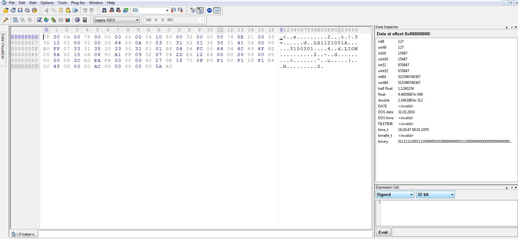

      Code:
      Offset(h) 00 01 02 03 04 05 06 07 08 09 0A 0B 0C 0D 0E 0F
      00000000 7F 3C 0A 00 78 00 00 00 00 00 04 10 80 00 32 00 .<..x.......€.2.
      00000010 00 00 74 0E 21 00 33 3D 12 01 00 02 00 00 64 00 ..t.!.3=......d.
      00000020 0A 4C 53 31 31 32 31 30 30 31 41 04 00 00 B0 FF .LS1121001A...°ÿ
      00000030 07 33 31 35 30 33 30 31 81 01 BF 04 34 FC 00 64 .3150301..¿.4ü.d
      00000040 04 4C 49 4F 4E C0 8A 02 10 0A C6 9C A1 FF 09 32 .LIONÀŠ...Æœ¡ÿ.2
      00000050 07 04 2D E6 12 64 00 00 00 00 00 00 00 00 05 3C ..-æ.d.........<
      00000060 A0 EA FB 00 00 00 92 27 0E 18 75 0F F0 F1 8C F1 *êû...’'..u.ðñŒñ
      00000070 28 F1 E4 0C 48 0D 00 00 AC 0D 00 00 00 00 5A A5 (ñä.H...¬.....Z¥

      • Serial Number = 0x0112 = 274
        Manufacture Date = 0x3D33 = 0b0011110100110011 --> 0011110 1001 10011 --> 30 9 19 = 2010/9/19
        CycleCount = 0x32 = 50

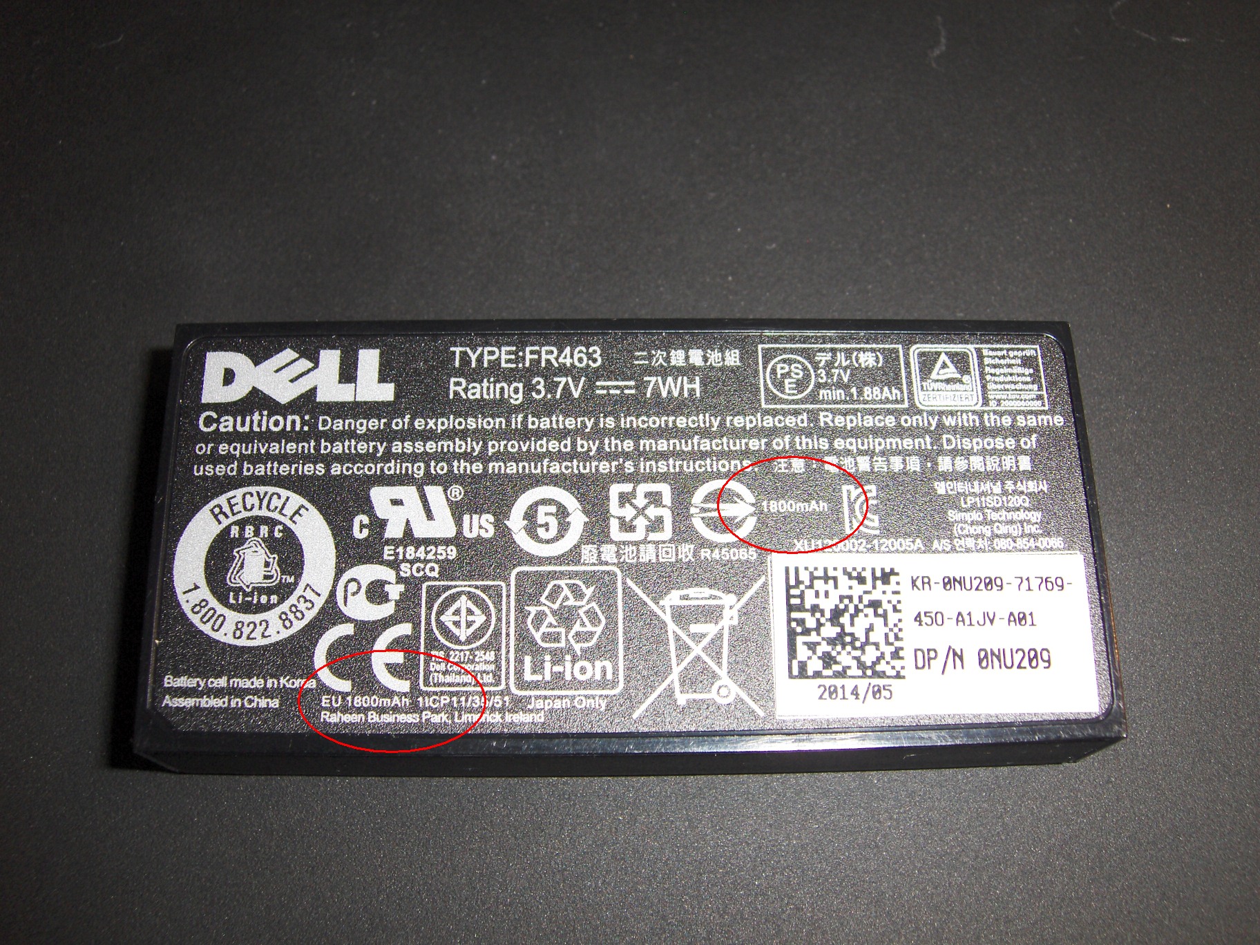

          I took some time last night and also found the fields I wanted to alter and I see you did too but much better then me hehe
          You obviously have done a very good job - Thanks
          I wish I could swap eeproms but the Dell circuit does not have an external eeprom so the battery controller must have it internal and datasheet for that chip difficult to find.
          I think it might work if I change the pack capacity to 1800mAh, change the last measured discharge (full charge capacity) to 1800mAh and 0 out cycle count.I will read the datasheet to see if it is possible to program a autolearn cycle.
          I notice the standard charging current for the Samsung battery is 1000mA and as the eeprom has a lower value of 512mA I dont think it will hurt the battery, perhaps just leave all the advanced charging functions as they are.
          The software also has a auto learn mode so perhaps it will be able to use a 1800mAh battery without editing every function.
          Anyone have any obvious reasons for me not to proceed ? things I need to be aware of ?

              This is what I got -
              Code:
              New replacement Dell PERC battery: SN0710031 IC with embedded EEPROM, Samsung 1800mAh
              Used defective LSI battery: bq2060A, external 128x8 EEPROM, Sony 1215mAh
              Although the Samsung battery datasheet specifies 2000mAh Dell has set the capacity to 1800mAh - for better lifespan I guess - see picture.

                Dell appears to derate the battery by 10%.
                1350mAh x 90% = 1215mAh
                2000mAh x 90% = 1800mAh
                I don't know any more than you regarding batteries. This thread is a learning experience for me.
                AIUI the battery is calibrated at the factory. The calibration data are written to EEPROM and the SEAL bit is then set. This restricts read and write access to certain bytes. If you reset the SEAL bit, then all bytes have read/write access. Therefore I would set the Pack Configuration byte at offset 0x3F to a value of 0x24 (SEAL = 0).
                0x3F Pack Configuration 0x24 0b00100100
                Also set the Cycle Count Threshold word at offset 0x3C to a value of 0xFA60.
                0x3C Cycle Count Threshold 0xFA60 1440mAh (= 0x10000 - 0xFA60)
                Note that words are little-endian, ie least significant byte first.
                Also the Pack Capacity ...
                0x3A Pack Capacity 0x0708 1800mAh

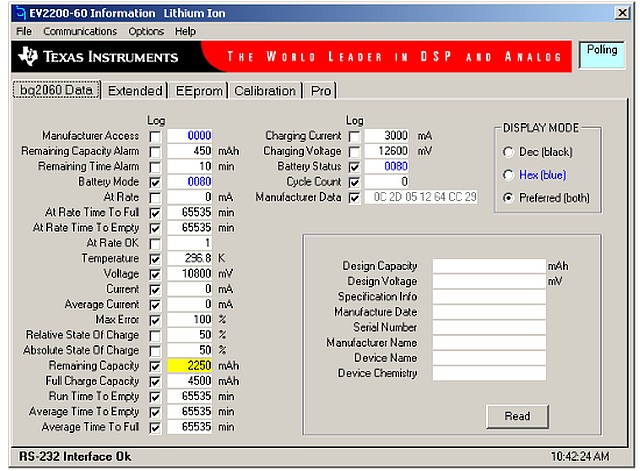

                  This is the support page for the BQ2060A:
                  http://www.ti.com/tool/bq2060aevm-00
                  Perhaps you could try the software tools. There may be a way to read the EEPROM in-circuit via the SMBus. If so, then try the same software with the SN0710031 ICs.

                    Hehe that software was a good tip - if I can make it work it will simplify everything.

                      The TI URL is now dead. I'm attaching the software.

                                Originally posted by Gabriel View Post
                                Also why is MaxT DeltaT C0 hex which is 192 ?
                                The "Max T Delta T" parameter consists of two nibbles. The least significant nibble codes for Delta T according to Table 11 on page 46 of the datasheet. So a value of 0x0 equates to 1.6 degC.
                                The Max T component is stored in the most significant nibble. It is calculated as follows (page 46):
                                Max T = (69 - maxtemp)/1.6
                                So ...
                                maxtemp = 69 - (MaxT x 1.6) = 69 - 0xC x 1.6 = 49.8 degC
                                Therefore a value of 0xC0 in the "Max T / Delta T" parameter represents 50C / 1.6C.

                                        Bit 6 is the SEAL bit. A value of 0x64 for the Pack Configuration Byte sets the SEAL bit whereas a value of 0x24 resets this bit. AIUI, you need to select 0x24 until you have finished "tampering", then you can seal the EEPROM.
                                        0x24 = 0b00100100 <- unSEALed
                                        0x64 = 0b01100100 <- SEALed
                                        BTW, "batterystatus" and "pack configuration" are not the same thing.

                                          AIUI, the battery pack communicates its status via the SMBus BatteryStatus command (0x16, page 33). This word reports alarm, status and error codes. It is presumably stored in the IC's RAM.
                                          The Pack Status and Pack Configuration command (0x2f, page 38) reports the Pack Status in the upper byte and Pack Configuration in the lower byte. The Pack Configuration is retrieved from offset 0x3F in the EEPROM whereas the Pack Status appears to be RAM based.
