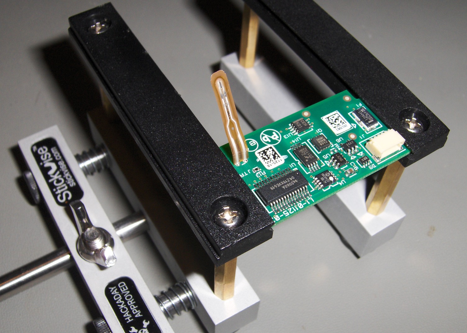

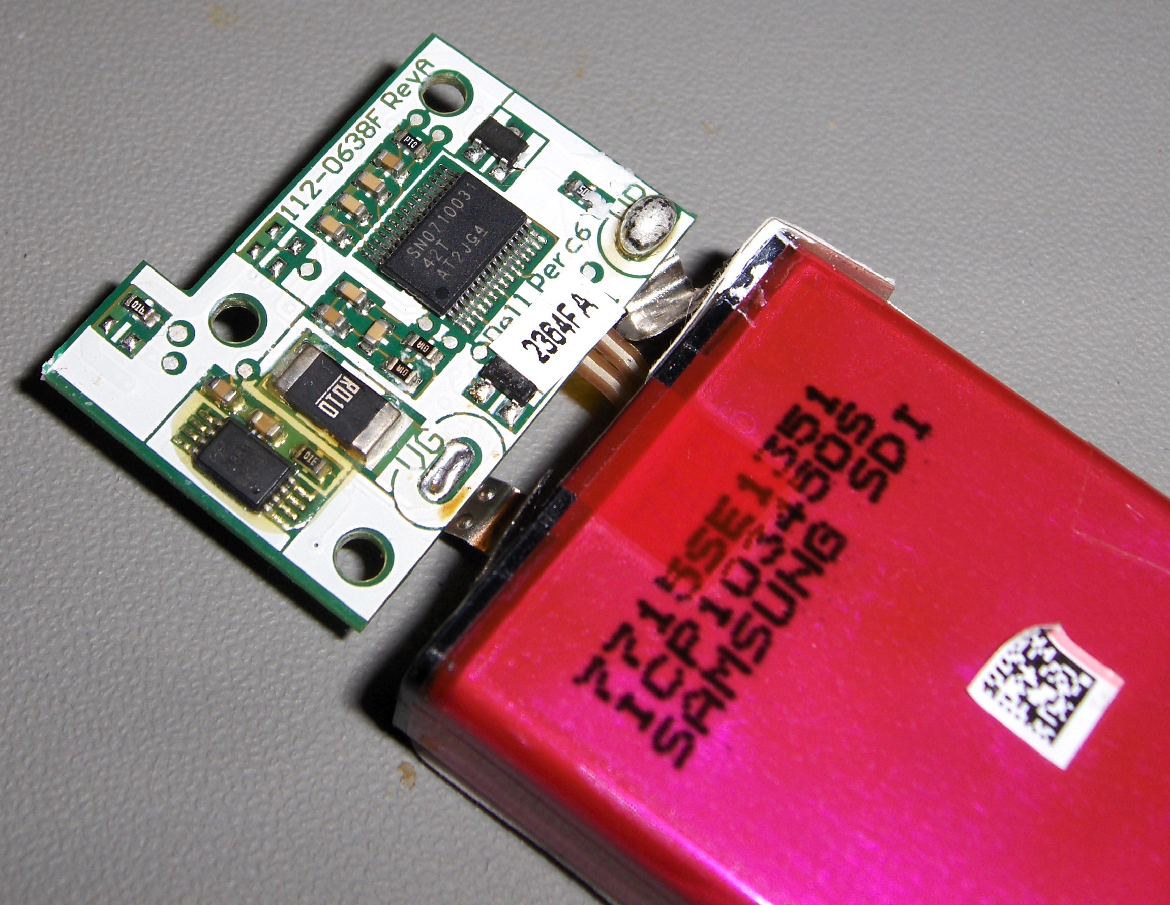

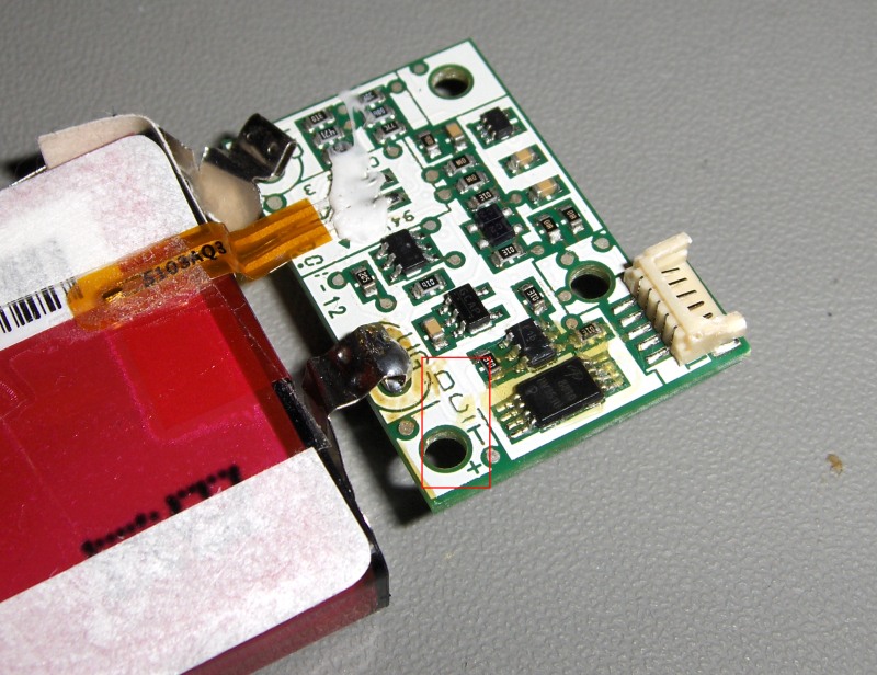

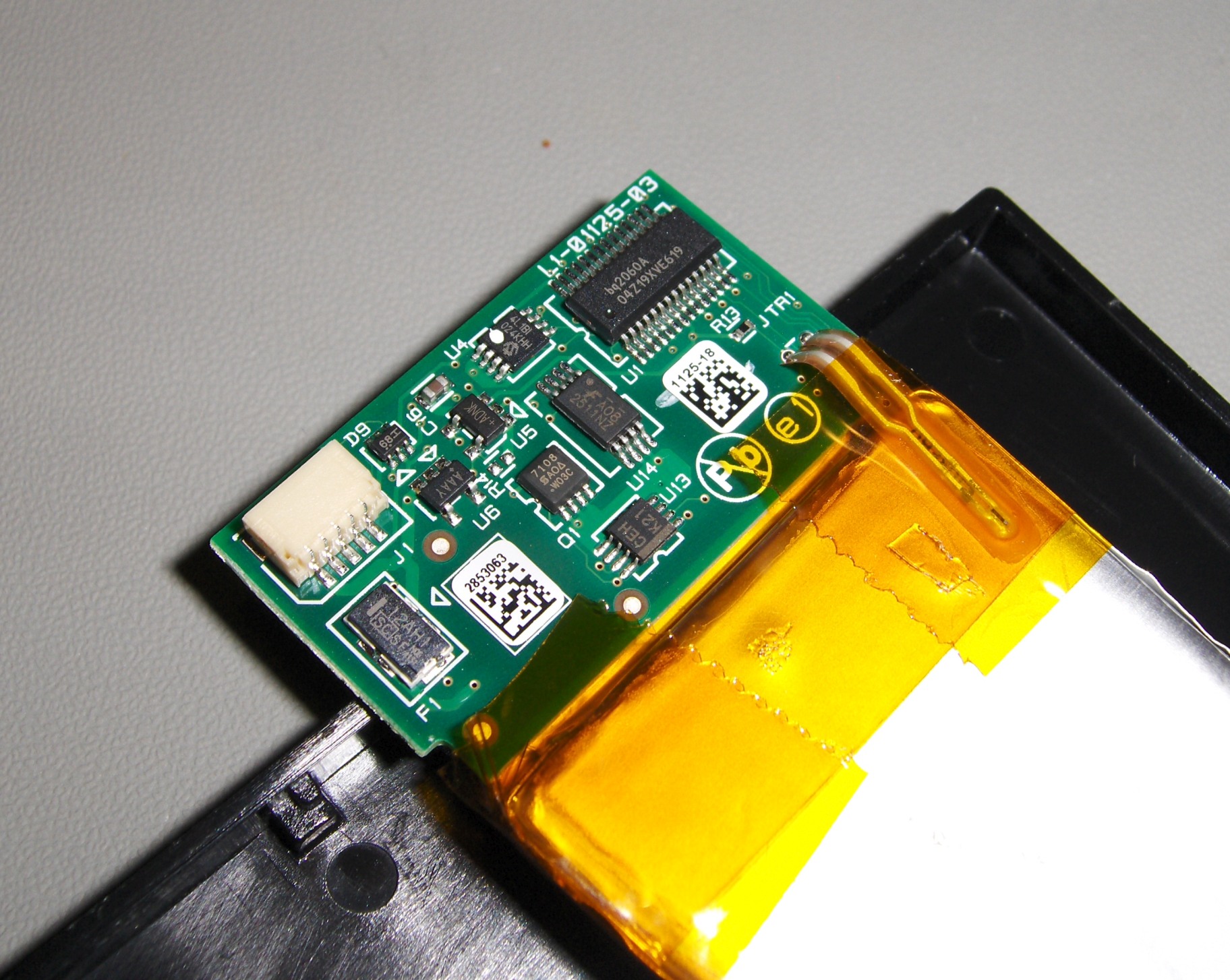

    What chip is the large sn0710031 ?

    I believe it's made by Texas Instrument and I couldn't find any datasheets on the chip. When I searched for it though, I found an Enhanced Product Hex Buffer/Driver With Open-Drain Outputs ( http://www.alibaba.com/product-detai...680448902.html ). SN74LVC07A-EP lists your sn0710031 as a related part number0. Here's a datasheet for the SN74LVC07A-EP https://cdn.badcaps-static.com/pdfs/...d50210e6ea.pdf
    I've contacted TI to see if they can help identify it. Hopefully they'll respond soon with a link to a datasheet or something.

          Got a response from TI. I'll just copy and paste what they said Gabriel...
          You can look up part marking on a tool on our website. I have looked up the part and this is what I got: http://www.ti.com/packaging/docs/partlookup.tsp#divline
          Part number | Marking | Package | pins Status | Description
          LP38842T-1.2/NOPB LP38842T-1.2 KC | 5 ACTIVE 1.5A Ultra Low Dropout Linear Regulators
          LP38842T-1.5/NOPB LP38842T-1.5 KC | 5 ACTIVE 1.5A Ultra Low Dropout Linear Regulators
          TL4242TDRJRQ1 4242T DRJ | 8 ACTIVE Automotive Adjustable LED Driver
          I know the formatting is a little hard to read. Couldn't figure out how to add a grid. It's | separated.
          As you can see, none of them have 30 pins like your chip. So now I'm questioning whether it's actually TI or not. Sorry. Wish I could be more helpful.

              its a battery fuel gauge chip.
              probably house marked.
              is that a dell raid backup battery?
              i tore up a bunch for the cells.
              its probably ti/benchmarq though.

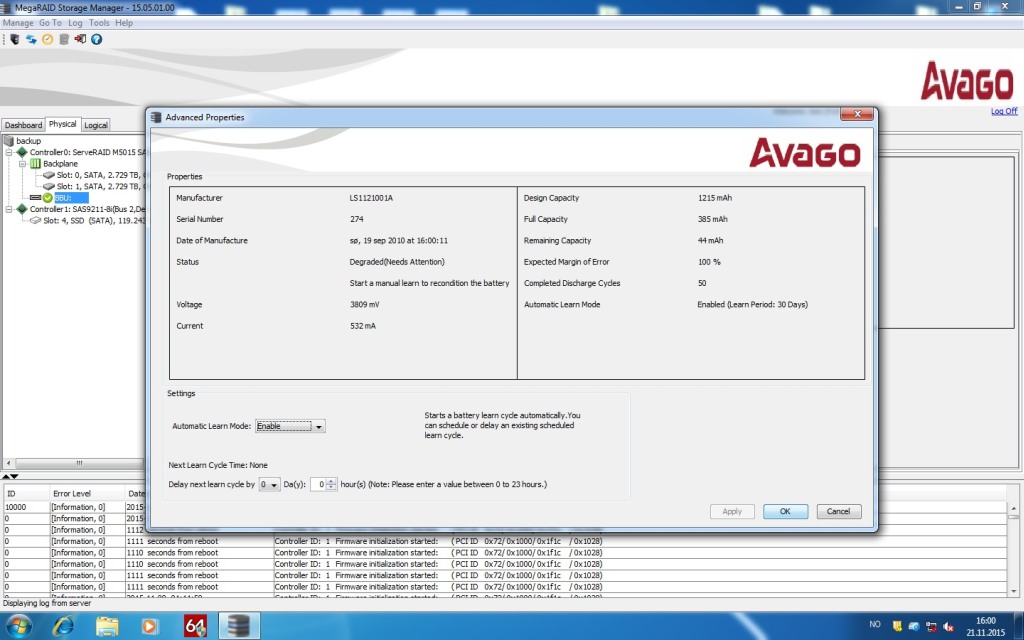

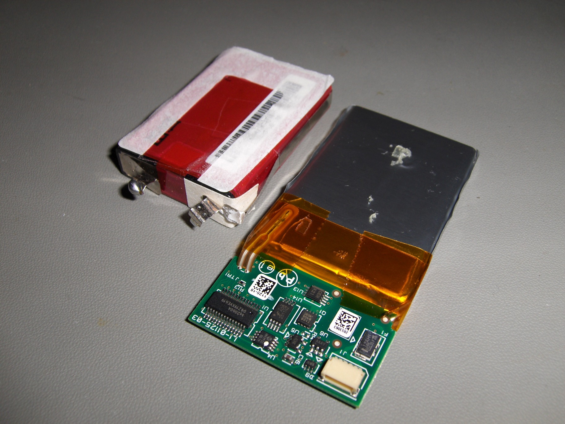

                Yes it is a Dell raid battery - I have a Lsi 9260-8i and their battery cost 227$ here in Norway and as these Dell Perc 6 batteries has the same pinout and battery plug as Lsi and as the Perc 6 raid card is made by Lsi I thought I could swap them but 9260 card does not see the battery.
                I was hoping that there was a small eprom that could be changed to match Lsi data.
                Pinout is data,clock,-,T,+ see picture.

                  The date codes on the chips should tell you when the IC (controller?) was manufactured. The markings are consistent with TI markings, AFAICT.
                  I would determine the controller's supply and ground pins. I would also trace the data, clock, and T signals from the connector to the controller.
                  Also determine where the temperature sensor (thermistor?) goes. That would be an ADC input to the controller. In fact ISTM that the entire circuit should not be too difficult to trace.
                  Once you have this information, then we could go to the Wayback Machine and determine which ICs were available at that time.

                      As has already been suggested, the chip is probably "house marked". That is, the chip is probably a custom part made for Dell. ISTR that "SN" was a prefix that was commonly assigned to such custom parts. If it is a custom chip, then TI would be prohibited from releasing proprietary data to you, as such data would be the property of Dell.

                          Is there any smart way to remove the silkscreen ? can barely follow the traces, tried a fiber pen but it was too fine to polish it away.

                            I found a whole bunch of "SN0" ICs in the following TI list:
                            http://focus.ti.com.cn/cn/download/a...alldevices.txt
                            Strangely, Mouser lists a SN0708100P device. If it is a proprietary OEM part, then I can't understand why Mouser would be able to sell it.
                            http://au.mouser.com/ProductDetail/T...ts/SN0708100P/

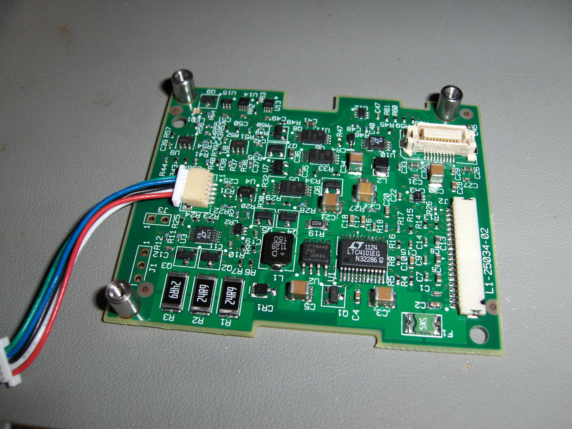

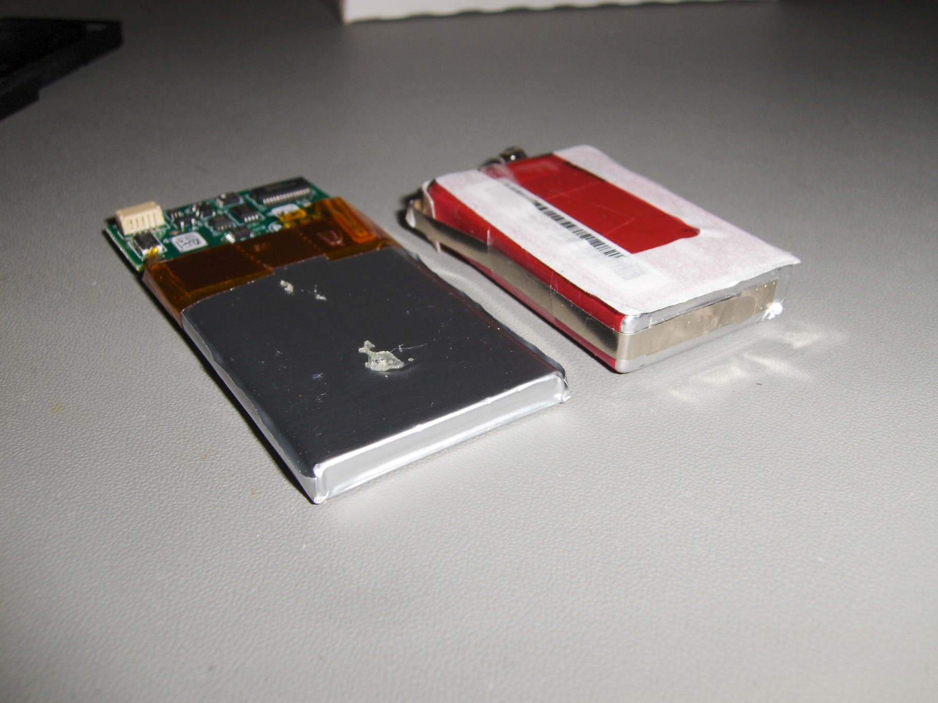

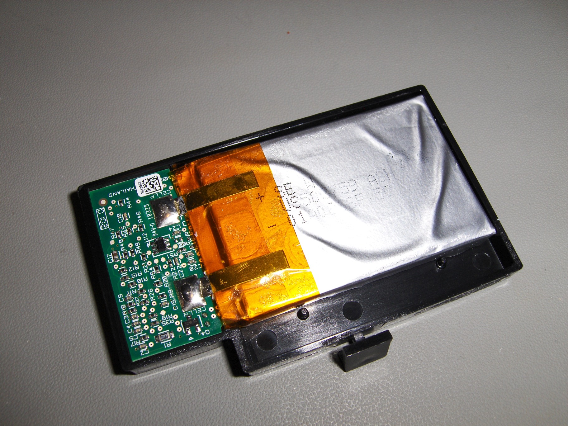

                              I finally got hold of two defect Lsi battery modules for free to play with.
                              Boy howdy was I lucky, no sn0710031 on this board but a TI bq2060a using an external eeprom. So instead of trying to modify the Dell unit I will use the Lsi modules by replacing batteries and perhaps reprogram the eeprom.
                              The Dell and Lsi units use two different batteries, both batteries are Li ion but they have different capacities and the Samsung battery has a hard metal case as the Sony US503759 a8h has the regular softer package.
                              Sony battery is 1350mAh and Samsung is 2000mAh.
                              Can I use the Samsung ICP103450S battery on the Lsi board or will it catch fire ?
                              I can perhaps dump the eeprom content and I should perhaps be able to zero it out to make sure a new battery will be charged properly, if you see the pictures the defective battery has only 385mAh left,eeprom also holds serial number, manufacturer information and design capacity.
                              Anyone good at hex editing ?
                              Added some of the datasheets for you, could not find Sony battery datasheet.

                                  or use a power supply to keep the controller alive and live swap the cell.most will recal on a full cycle.
                                  btw the cell is cheap and easy to get in the form of a samsung blackjack extended battery.$4 on ebay.got a ton of em in my extended family in harbor freight magnet lights with a tp4056 board.

                                    I got curious ...
                                    FDW2511NZ, Fairchild, Dual N-Channel 2.5V Specified PowerTrench MOSFET, 20V, 7.1A:
                                    24LC01B, Microchip, marking 4L1BI, 1Kbit, I2C, serial EEPROM, 2.5 - 5.5V:
                                    https://cdn.badcaps-static.com/pdfs/...c3cf891b16.pdf
                                    bq2060A, Texas Instruments, SBS v1.1-Compliant Gas Gauge IC:
                                    https://cdn.badcaps-static.com/pdfs/...43804650eb.pdf
                                    SN74LVC1G08, Texas Instruments, marking CEH, Single 2-Input Positive-AND Gate, 1.65V to 5.5V:
                                    https://cdn.badcaps-static.com/pdfs/...b92049dee8.pdf
                                    Si7108DN, Vishay Siliconix, N-Channel Fast Switching MOSFET, 20V, 14A:
                                    https://cdn.badcaps-static.com/pdfs/...fb551f6ef1.pdf
                                    MAX835EUK-T, Maxim, marking AAAY, Micropower Latching Voltage Monitor, SOT23-5:
                                    https://cdn.badcaps-static.com/pdfs/...9619a44ad0.pdf
                                    MAX1725EUK+T, Maxim, marking ADNK, SOT23, Adj 1.5V to 5.0V, 2.5V - 12V, Ultra-Low IQ, LDO Linear Regulator:
                                    https://cdn.badcaps-static.com/pdfs/...8ac5ffd395.pdf
                                    SFH-0412A, Sony, Self Control (SC) Protector, marking 12AH1, 12A, 4.0V/7.1V:
                                    https://cdn.badcaps-static.com/pdfs/...715af27c24.pdf
