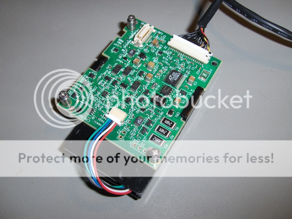

    Flashed back the modified content and fitted battery.
    I bought a interposer kit for the battery to move the battery away from the raid card itself to keep the battery cooler - it also makes it easy to measure directly on the battery.
    Raid web bios, everything seems to be right - new data is reported correctly.
    Storage manager in windows reports are ok - battery is now charging with 438mA.
    Battery almost fully charged at 4.1V, charging current is only 55mA and it will now start to discharge.
    Something is wrong, battery capacity suddenly changed to back to 1215mAh.
    Command timeout and unexpected sense errors in log.

    Battery discharging and is now @3625mV - fluke measures 3646mV.
    Battery discharging and is now @3567mV - fluke measures 3588mV.
    Battery discharging and is now @3443mV - fluke measures 3443mV.
    Getting worried and turn computer off to save battery as this is a raw cell without protection circuit.
    Now I wonder what would happen if I repogram the lc2401 with same hex code but with code sealed, then software/driver should not be able to change design capacity back to 1215mAh.
      #42
      Re: Help identifying this chip - battery controller chip ?
      I don't understand why the software would want to change a design parameter, nor do I understand where the 1215mAh value would be stored. Very strange ...
      Can your TI software change the design capacity back to 1800mAh, or do you now need to remove the EEPROM again? Have any of your other EEPROM modifications been undone?

        I need to remove the chip again, this time just for a test I will let the packconfiguration be 64hex (sealed) and see if the software manages to change it back to 1215.
        I don't think anything else is changed but I will dump the eeprom again to see.
        However my goal was to make use of defective battery packs and it is possible to replace battery and reprogram eeprom when battery pack is defective but then I need to have access to a Sony US503759 a8h 1350mAh or similar type.
        If I keep the capacity at 1215mAh I'm 99% sure I will have no problem re-using these packs.

              Ok, I got it working.
              Design capacity is not changed back to 1215 and stays at 1800, after first calibration full capacity is now at 1909mAh.
              After second calibration full capacity reaches 1925mAh.
              Not sure it is a problem with hex code or normal feature of this software but charging stops as 49% but battery status is 'optimal', I will ask at a few raid forums what capacity their original ibb07 stops charging at.
              If I remember correctly turning off automatic learn mode I can charge the battery up to 100% but if status will then be 'Degraded'.

                  I ended up with using a htc 1200mAh battery - everything is working as it should, posted a update in this thread link
                  Thanks for the help fzabkar.
