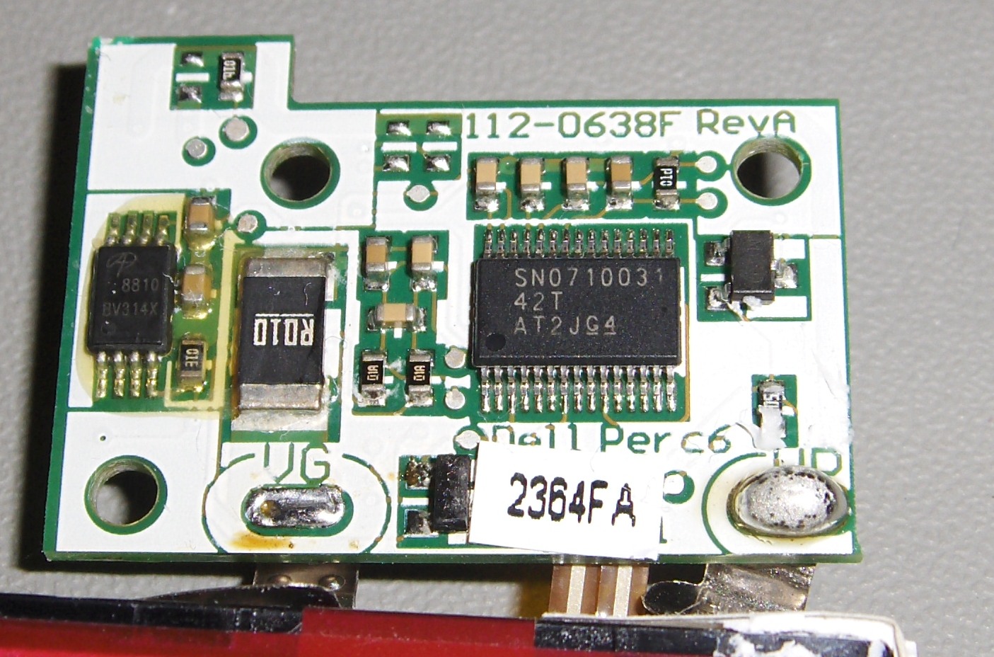

Help identifying this chip - battery controller chip ?
    Re: Help identifying this chip - battery controller chip ?

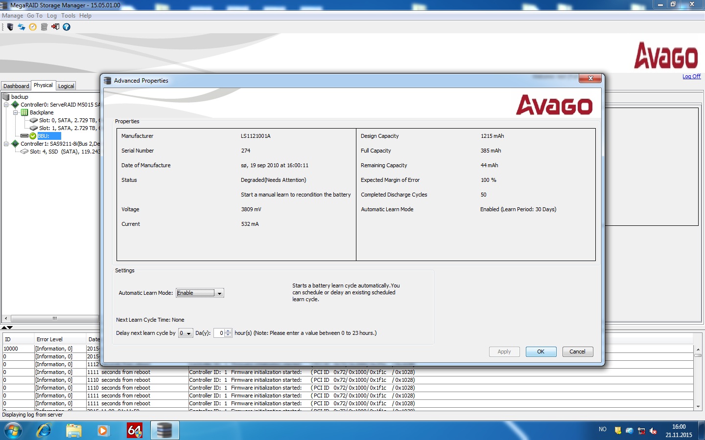

    So I have a bin dump of the eeprom - I verified it too so everything is ok.
    Some of the content is easy to match up with the information the raid bios and the raid software in windows provides.
    Looking at the Megaraid bios and comparing with hex workshop I can see
    Mfg name - LS1121001A
    Device Name - 3150301
    Device Chemistry - LION
    The serialnumber 274 and mfg date 9/19/2010 I can't see, windows software gives us information that the battery has been discharged 50 times and I can't see that either.
    I don't know how smart the software is and if it is important to change mfg date to this year but what I would like to change is design capacity to match the samsung battery and the completed discharge cycles resetted.
    Anyone has knowledge of this ?

      • Serial Number = 0x0112 = 274
        Manufacture Date = 0x3D33 = 0b0011110100110011 --> 0011110 1001 10011 --> 30 9 19 = 2010/9/19
        CycleCount = 0x32 = 50

        Instead of modifying the EEPROM of the original Sony battery with Samsung parameters, ISTM that it would be better to take the EEPROM from the Samsung battery and change the relevant text strings to enable it to identify itself as the original Sony battery.
          I took some time last night and also found the fields I wanted to alter and I see you did too but much better then me hehe
          You obviously have done a very good job - Thanks
          I wish I could swap eeproms but the Dell circuit does not have an external eeprom so the battery controller must have it internal and datasheet for that chip difficult to find.
          I think it might work if I change the pack capacity to 1800mAh, change the last measured discharge (full charge capacity) to 1800mAh and 0 out cycle count.I will read the datasheet to see if it is possible to program a autolearn cycle.
          I notice the standard charging current for the Samsung battery is 1000mA and as the eeprom has a lower value of 512mA I dont think it will hurt the battery, perhaps just leave all the advanced charging functions as they are.
          The software also has a auto learn mode so perhaps it will be able to use a 1800mAh battery without editing every function.
          Anyone have any obvious reasons for me not to proceed ? things I need to be aware of ?

            Sorry, I was confused. Too many batteries, too many bytes.
            Is this your situation?
            Code:
            Original LSI battery:      SN0710031 IC with embedded EEPROM, Sony 1350mAh
            Replacement Dell PERC battery: SN0710031 IC with embedded EEPROM, Samsung 2000mAh
            Used LSI battery:        bq2060A, external 128x8 EEPROM, Sony 1350mAh
            AIUI, the bq2060A IC allows a blank EEPROM to be read and written via the SMBus until the SEAL bit in the Pack Configuration byte (0x3F) is set. If you reset the SEAL bit, then you should be able to reprogram the EEPROM via the SMBus using an appropriate software tool. This would allow you to keep experimenting until you get it right, without having to desolder the EEPROM each time. You could also verify whether the calibration parameters change after autolearn, assuming it is supported.
            One other parameter that you should consider modifying is the Cycle Count Threshold. This determines the discharge level at which the cycle count is incremented. Currently the Pack Capacity is 1215mAh (1215 / 1350 = 90%) and Cycle Count Threshold = 972mAh (972 / 1215 = 80%). This means that the battery must discharge by 80% to register an increase in the cycle count. In the Samsung case this value should be 2000 x 90% x 80% = 1440mAh.
            The Self-Discharge Rate of 2% seems wrong for an Lithium battery. Your Samsung spec suggests that it loses 10% of its capacity after sitting for 30 days. That's 0.33% per day.

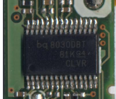

                        The controller chip sn0710031 most likely is a BQ20z90 or BQ8030, both has internal eeprom and is a 30 pin package.
                        Found some info here
                        After holiday ends I will continue with my BQ2060A setup.
