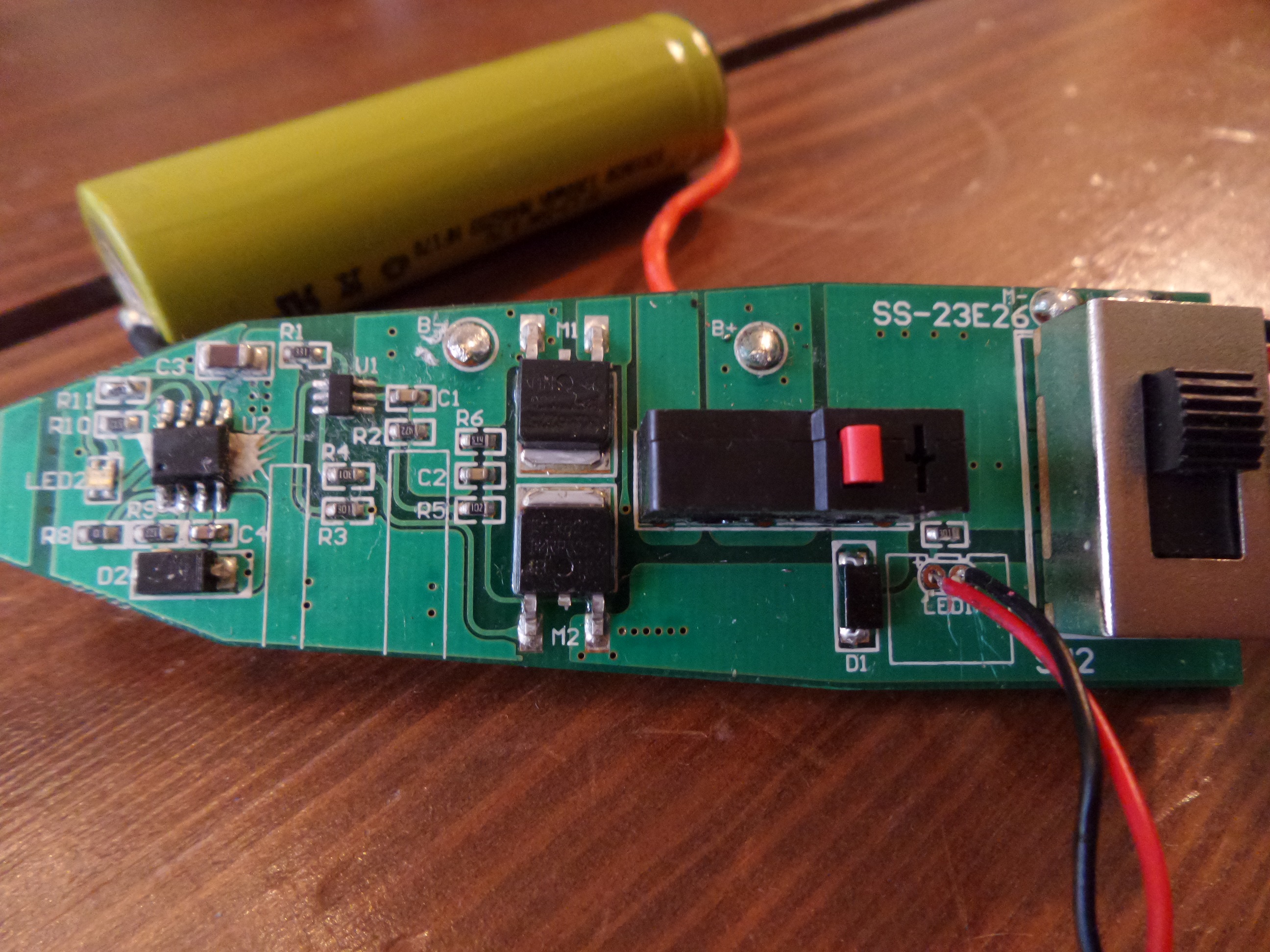

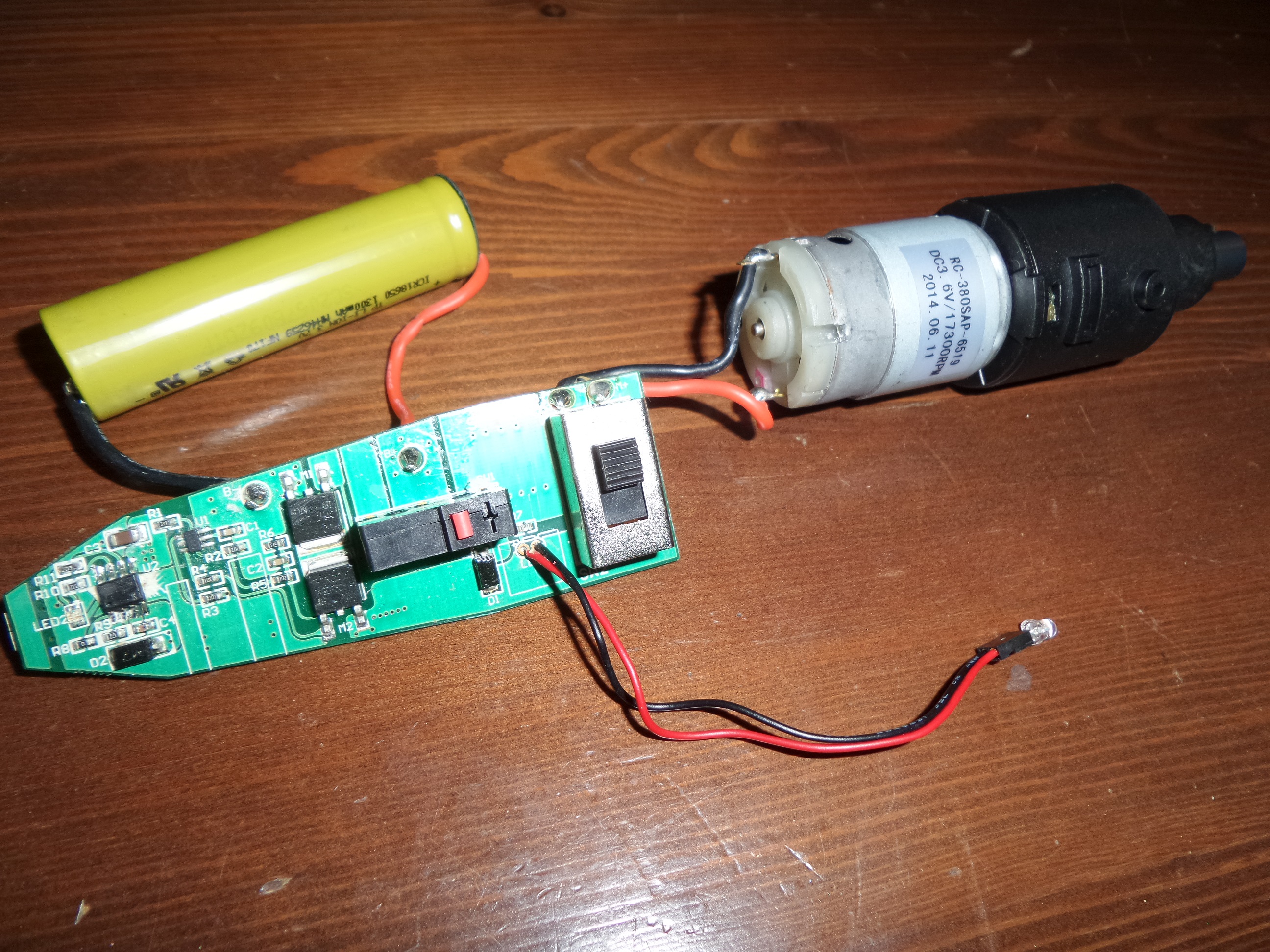

    Hello!
    My friends screwdriver got water inside and stopped working.
    He loves it so much that it needs to be repaired.
    If anyone has any idea where and what I could measure it would be really helpfull. Motor works fine.
    here is some pictures

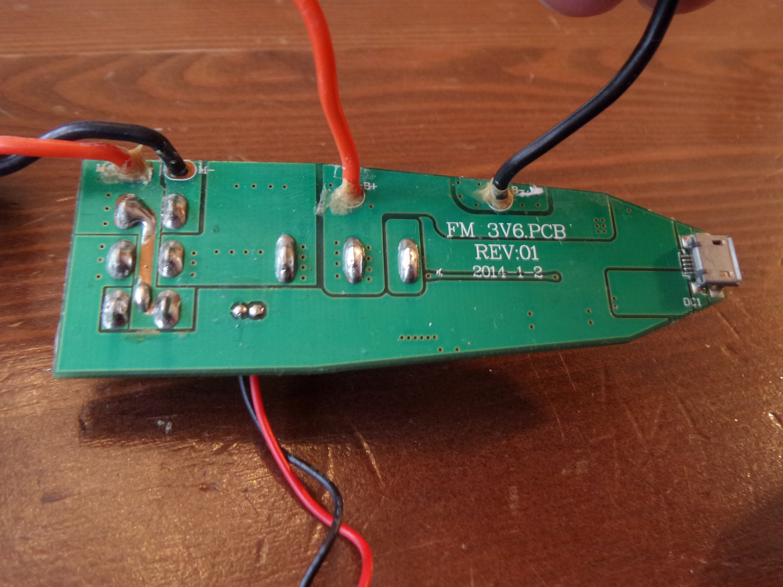

    Re: Ferm One electric screwdriver has no power
    heres the pics inside the screwdriver
      [Probably you posted this in the wrong place... ]
      More details needed... but start by:
      look for water damages: corrosion, open/shorted connections;
      measure battery and see if it charges when connected;
      test the power switch;
      I don't think the water damaged any electronic component...
          Can you tell us the markings on M1, M2, U2, U1, D1, D2?

            there are solder balls and splashes on it,
            it needs to be attacked with a stuff brush & some IPA
                u1 and the 2 mosfets is undervoltage protection.if battery low that shuts off unit.
                u2 is the charger.
                probably a tp4056.
                whats the battery voltage?

                                      still no voltage reading.define "fine"
                                        • 31015
                                        put a meter across the battery and tell us the voltage both normally and when the charger is plugged in.
                                        btw, does the motor run if you connect it to something else?
