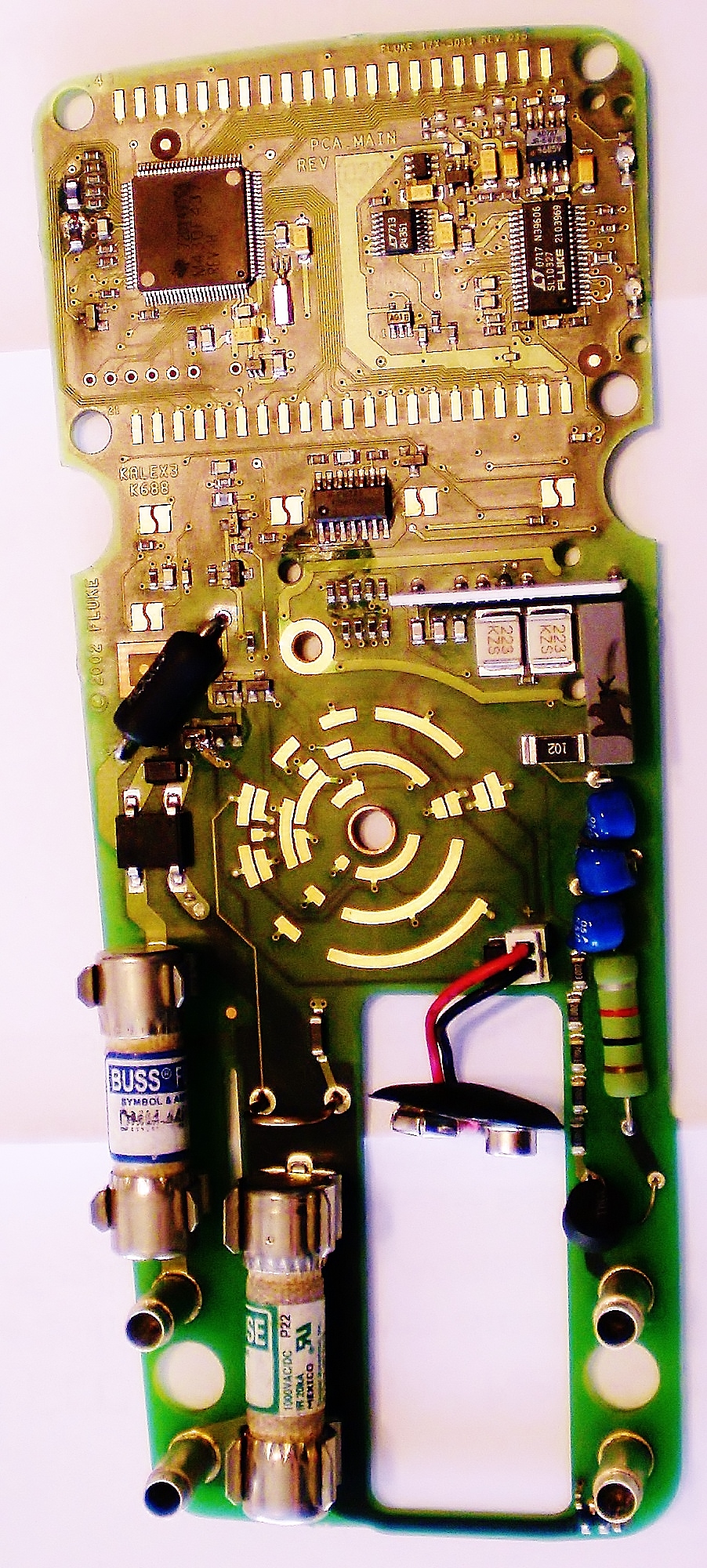

                                    So we need to go back to the information sheet on the micro controller. The supplied voltage to this chip is measured from Vcc to Vss. You can see this on page 53 of the attachment I provide previously. The range of the low supplied voltage is from 1.8 Volt to 3.6 volts maximum this can be seen on page one. If this measurement is at or above 3.6 volts maximum the chip will be damaged. So if you can try to measure this voltage. If it is too hard to measure on the processor then follow the traces back to a component that would be easier to measure. So there are two possible available supplies voltages. One pair is DVcc1 the positive and DVss1 the negative. The other pair is DVcc2 the positive and DVss2 the negative. You will need to measure across each pair. Also, you want to measure the pin under pz terminal which is the 100 pin chip not the 80 pin chip
                                      #58
                                      Re: Fluke 179 won't tun on
                                      Originally posted by tibimakai View Post
                                      We need to find out, how the battery voltage reaches the TI IC.
                                      Finally, the right question is being asked.
                                      The MSP430 maximum voltage is 3.6V. The Fluke 179 uses a 9V battery.
                                      So something has to drop the voltage down into the 3V range. If the photos weren't so bad, I would be able to see the 5V LDO that you are talking about.
                                      Thus, if the MSP430 isn't getting around 3V, check the 5V LDO. If there is no output on the 5V LDO, check the input voltage on the LDO. If there is no voltage on the input pin, check the trace from the 9V Battery positive terminal to see if the track/via is broken. If I found one broken track, there might be more.
                                      As I said, there are no schematics, but if you photograph the 179 PCB and use a very bright source like the sun from behind, you might be able to see the traces. For example, here is my photo of the UEI DM393

                                        #59
                                        http://www.eevblog.com/forum/repair/...-all-the-time/
                                        As you can see, the picture is focused and you can see all the writing even on the smd components. You can see all the traces despite it being a multilayer board.
                                        I have cleaned the image up some. If you magnify it I think you will be able to see the runs.

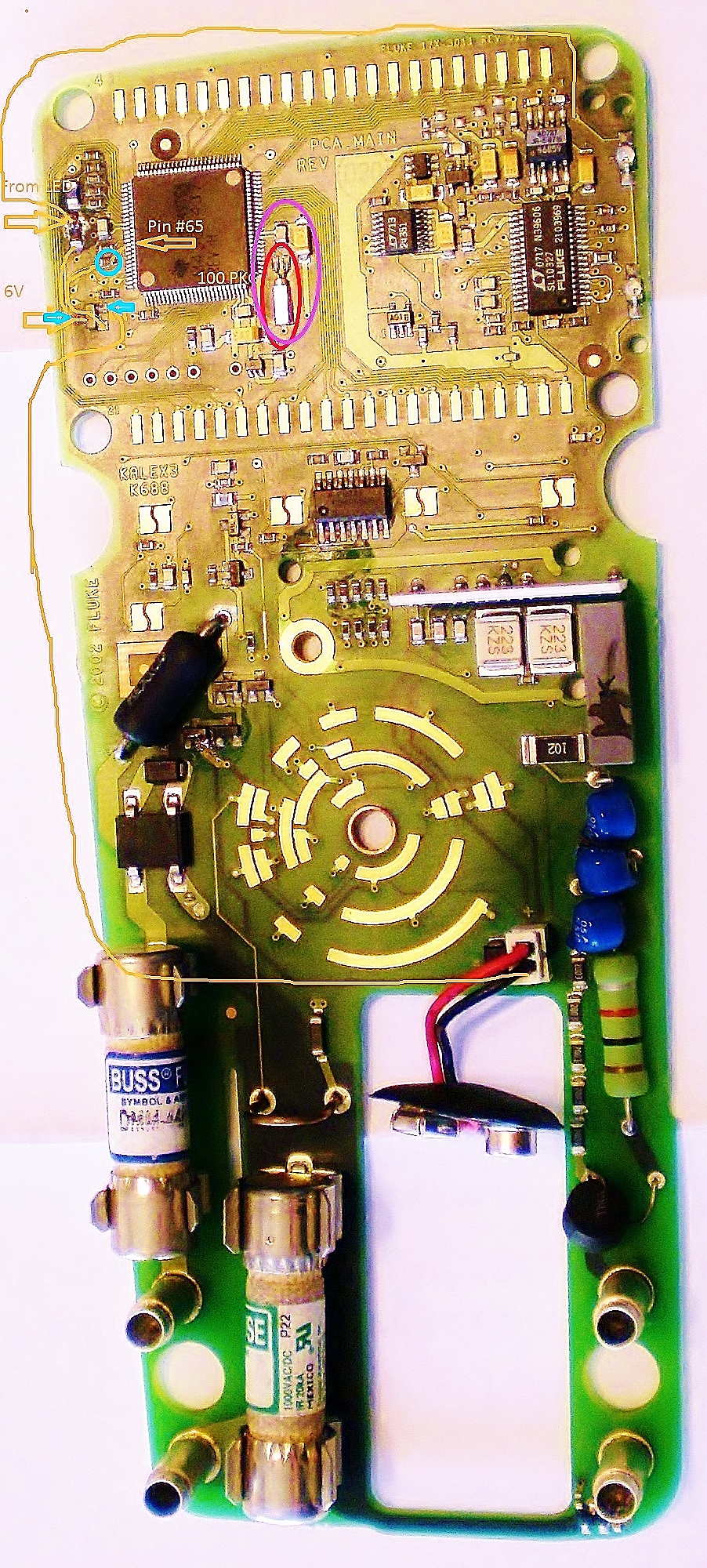

                                          #60
                                          This is the best I can touch up of the picture for you retiredcaps.
                                          Tibimakai the way to take the picture would be to put a white light under it, somewhere around 5000 kelvin. Make sure the board is completely flat. If the light shines around the edges of the board use black paper from the board to the light to block this out just use scotch tape to secure the black paper. Next if your camera has a macro setting then set it to this. Get with-in 30" of the board aim down making sure the camera is completely parallel with the board. Fill up the entire camera view, however close the camera will let you get. Take pictures with flash off and then flash on. With flash off it is best to take picture outside if you can. Good luck.
