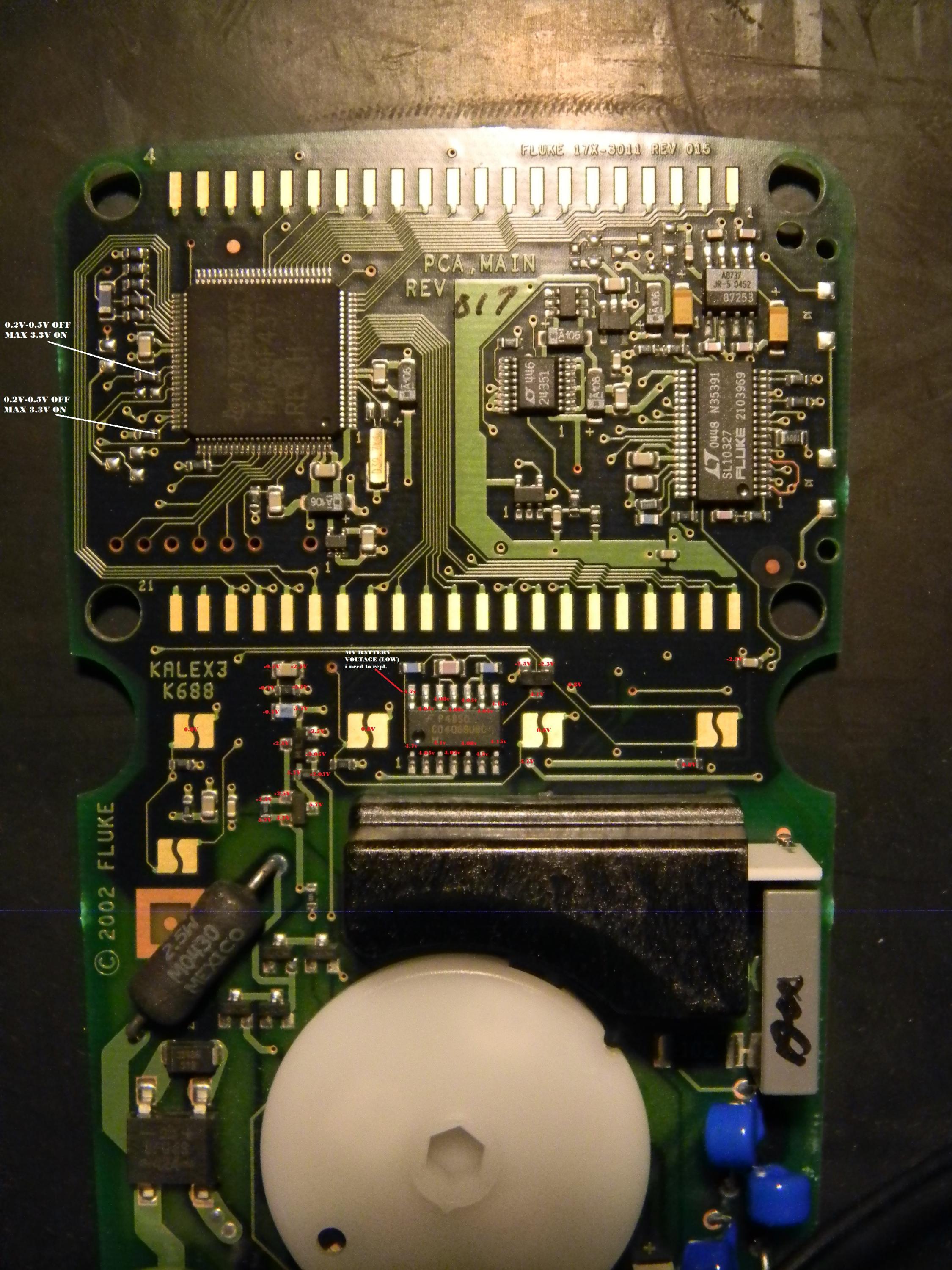

    I have attached your picture of the top side of board with a red x on the run I question.
    retiredcaps The Fluke number is 17x 3011 rev.36
    I believe it is rev 36 as it is hard to tell if the 3 is a 3.
    Also, it has a number KALEX3
    K688
    I believe it was made 2002. This is on the side of the board. It was inspected by #20

      Re: Fluke 179 won't tun on
      From your last pics it looks as if there is a break and/or short on the bottom side of the 14 pin ic. Might just be graphics artifacts due to picture compression though. The board also seems discolored around there?

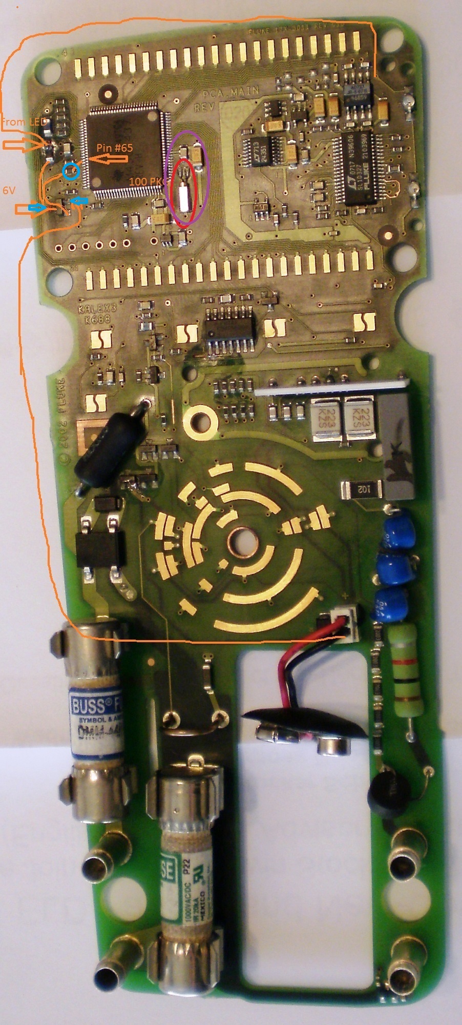

        What I have noticed, is that the transistor on the left/up, by the digital Texas Instrument IC is getting 6V at the collector pin(which was pointed out earlier that it may be corroded-but it turns out, that is just fine), but nothing comes out of it.
        I'm attaching a picture with my findings. If I measure that transistor(if it is one, I'm not sure), seems fine. I have measured 2x0.7V one way and nothing the other way.

          Just want to verify that you have ohmed out directly on the transistor pin where you show 6 volts to the preceding part? To make sure the run is not open just prior to the transistor? If we new the transistor type and number we could then determine if it is bad. Whether it is indeed a transistor or a cmos. We need to be able to tell if the transistor is bad or good. And if the processor out pin65 is actually telling this transistor/cmos to turn on. It could be a transistor and pin 65 could be connecting to its base pin or it would be a cmos and 65 could be connecting to the gate. This is where we need to find out what the number of the part is so we can look it up. Pin 65 is controlling the turn on of that part. Once we distinguish the above we will then know if we need to understand why the processor is not turning this pin on. There has to be a memory chip with instructions. This would be where a scope and better yet a logic analyzer would help.

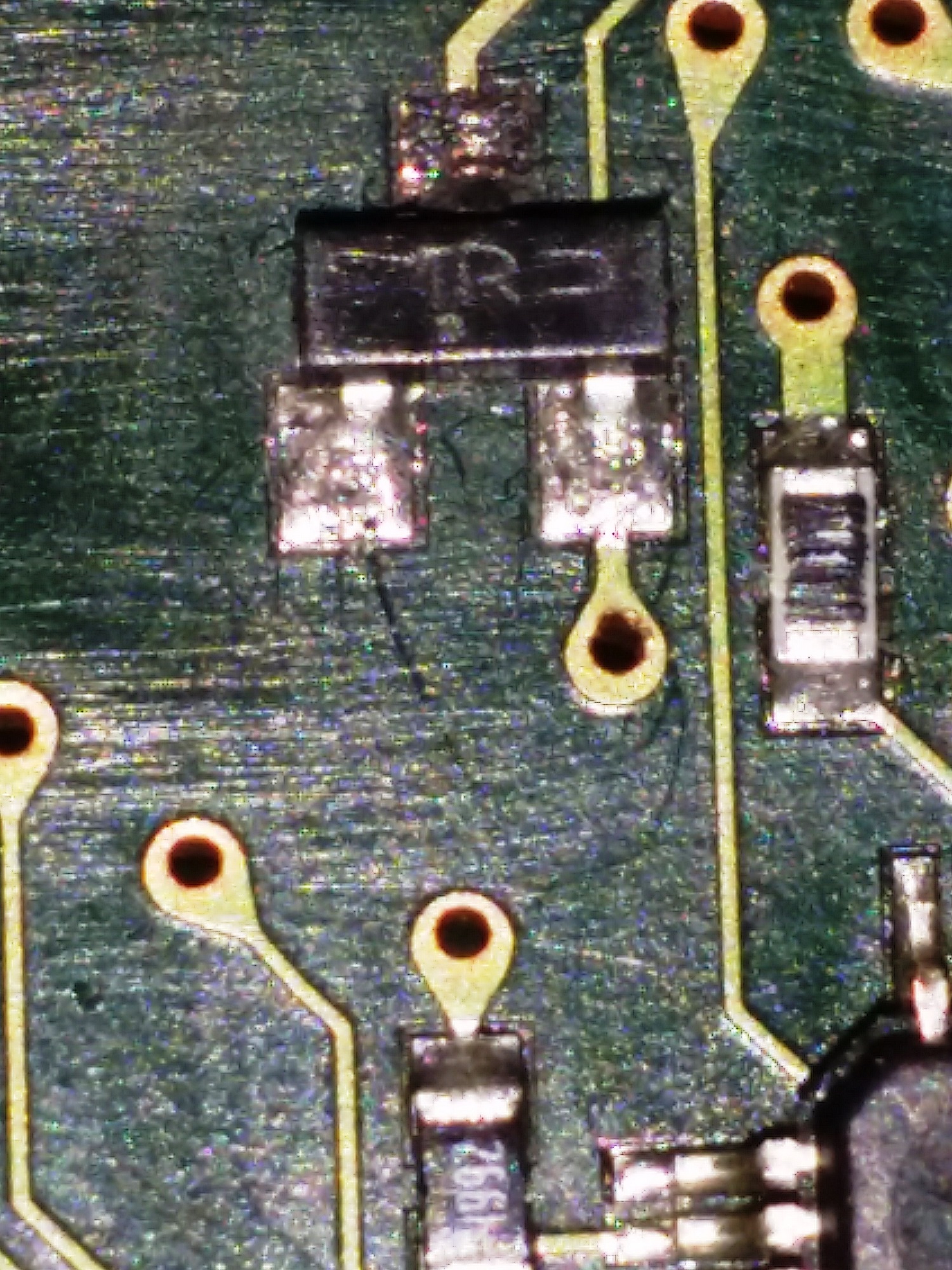

            To me, it seems like it is still connected. I measured right at the plastic.
            Here is a picture taken with my phone, I can't really tell what is it, 1R?

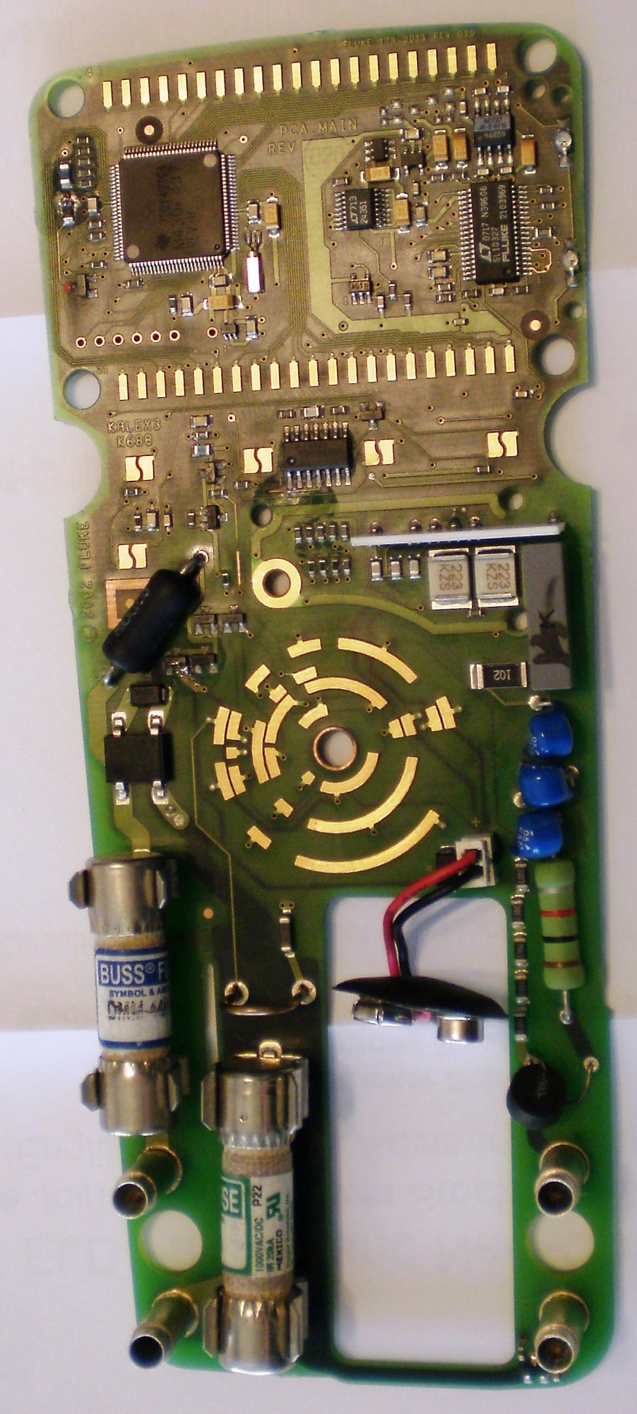

              i open my 175 just for you
              how can i help?!?!?!?
              my battery its 5.7v . i know its low !
              i did some probing. if you need something else tell me just don`t ask me for parts value cuz i open it and can`t read them
                Do you have any voltage on pin 65? Also, if you have a o'scope does pin 65 fluctuate when it is turned on that is goes from a low to high and then back to low?
                "retired caps" do you have a schematic of this board?
                Perhaps Retired Caps has experience with Fluke Multimeters and knows something we do not. I believe he asked you to check the oscillator to see if it is working. Do you have a way to do this? I have circled what I believe is the oscillator in red and the whole oscillator circuit in purple. You would measure this at the pin on the processor chip.

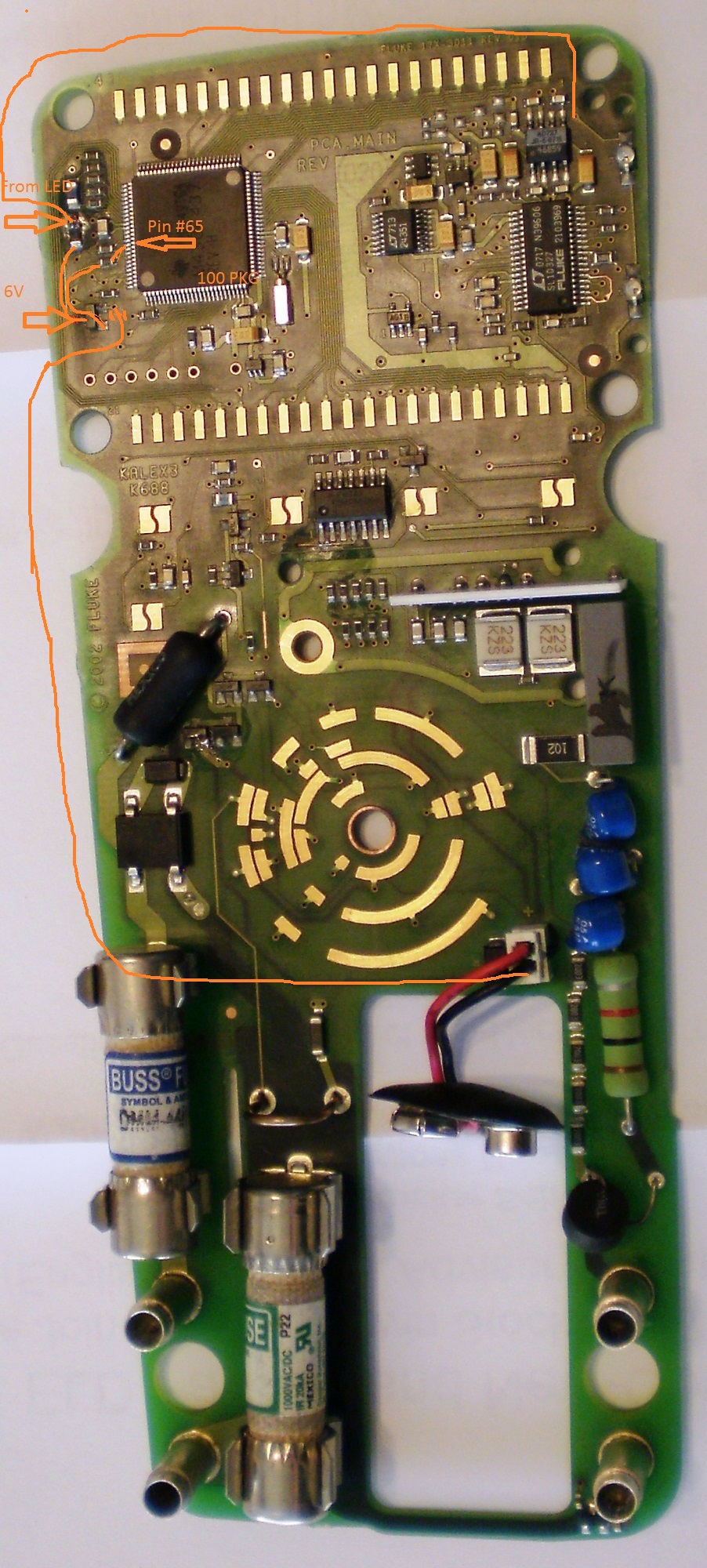

                      Seeing how you have a scope would you verify that the + side of what I think is the oscillator has a frequency when it is turned on and if it does can you tell me what is the frequency?

                          I want you to measure between the two blue arrow to see if you still get 6 volts at the same 6 volt measurement. Then if you have a variable power supply. You could build it out of a nine volt battery and a rheostat. I want you to take out the resistor I have circled in blue. Measure the resistor you just took out. Find a resistor of the same value with-in 5% and connect it up to your variable DC power supply on the positive side. The other side of your variable supply, the negative, you want to connect to the negative side of the battery of the meter. Now take a insulated wire 28 gauge or bigger and solder it from the output between the resistor you have connect to this variable power supply and the input of the transistor where the other resistor had connected to the transistor. Make sure the rheostat is set to its maximum value. Which means maximum resistance so as little current will flow, you could put a switch in line so you can turn off the power to the circuit. The rheostat resistance plus the resistor in series should lower the current/voltage value enough so it will not harm the transistor. The maximum rheostat value should be 1.5 times the resistor value. So if the resistor is measured at 100 ohms the rheostat needs to be 150 ohms. After all this is done you can turn the meter to on position. The leds should still be off. With another meter you want to monitor the voltage from the ground to the transistor where you have connected the resistor. Slowly turn the rheostat, but do not let the voltage your monitoring go above 6 volts. If the transistor/cmos is good it should turn the leds on before you reach 6 volts.

                            I have been thinking about this circuit we are looking at. This circuit appears to only measure if the possessor is up and running instead of if there is a voltage and if that voltage is correct. So you do not need to check that transistor out. So with that being said what we know is that if the processor is not turning on this Transistor/Cmos and you are measuring 6 volt at the transistor we have a problem. The problem is that there is some conduction going through this power up circuit. This then presents another problem. Did the designer mean for this to happen? I would say no because if the circuit in not up and running I do not want to drain the battery, however if I am in stand-by mode to conserve the battery I do not want to turn the circuit off completely so I can turn it on quicker with less inrush current. I would say your circuit is indicating that the meter is in stand-by mode. Have you verified that the 9 volt battery is actually 9 volts DC? If the battery is indeed 9 volts we need to understand why it is not coming out of stand-by mode. Stand-by mode would be used to measure if the instrument is being used or not. The designer would measure this from the input of the meter. He can do this in several ways. I would do it by using a comparator off of the input measurement . This comparator then would be monitored by the processor. If I did not read a high level then I would go into a count down sequence. After a certain time I would then put the circuits in stand-by. Also, once I measure a high I would then reset the count down clock. So what we can do is find out if the part number on the remaining chips actually have a data sheet or if fluke has prevented this from happening.
