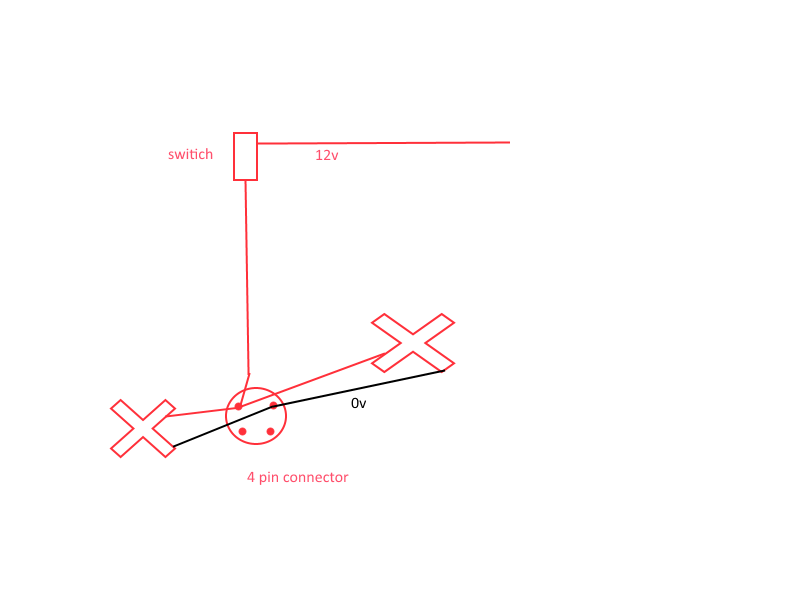

    I have a small switch that is connected to 2 fans the long wire from the switch is connected to the fan + wire, at that same exact point another wire is soldered which goes to the other fan + wire
    So the 12v wire from the switch is split into 2 which connects to both fans
    The ground is also done the same way
    When i had it wired this way, both fans would work via the switch after disconnecting power and reconnecting the small 60mm fan would no longer work but the 80mm fan did, i replaced the 60mm fan and the same thing happened and neither will work
    When i solder 2 different wires to the 12v switch and connect them to the fans, both fans work without fail
    I am not sure exactly why this is occurring, the amperage requirements are slightly different for the fans

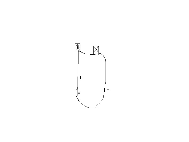

            I think it looks like this:

              That doesn't show how the power source is wired and the fans are in series, they should be in parallel if it's a 12v source and they are 12v fans. There is also no reason to switch the negative.

                yea it was a terrible explanation so basically in the drawing the 12v wire from psu is going to a 4 pin male connector, a female connector is inserted and on the other end is the fan 60mm
                i wanted to install another fan so i basically soldered wires to the male connector on the inside of the chassis to the corresponding wires
                the new 80mm fan works just fine but and when i insert the female connector it works as well
                after a power cycle the 60mm fan no longer works, i tried 2 more fans and the same thing happened
                when i solder 2 long wires directly from the psu to the new fan, both of them work fine
                            The negative wiring in my picture was hypothetical. That wasn't where it will return to exactly. LOL.
                            But, the description sounded just like that for the positive.

                              His drawing shows the fans in parallel, as they should be. What I wonder is what is the four pin connector going to? +12v and ground? If so then why is the switch connected to another +12v source? If he's getting +12v from the 4-pin connector then the switch belongs between the +12v at the connector and the two +12v leads to the fans. The ground goes directly to the negative leads for both fans.
                                  Should it not be just measure with a meter to see what one gets and then connect it up correctly?
                                    Re: 12v switch to 2 fans murders the smaller fan
                                    Per his drawing the two FANS are connected in parallel so all he has to do is to measure the DCV between the red and black wires of the FANS to see what he gets.
