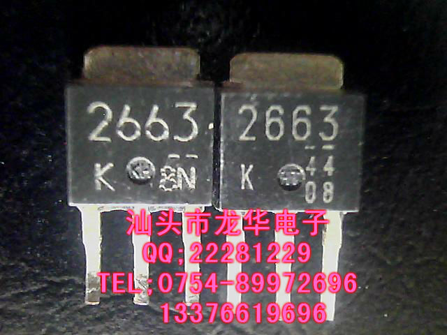

      Re: Transistor identification
      Does it look like these?
      http://www.ibuyla.com/Product/134064...ity_assurance/
      They seem to think they are 2SK2663
        Yep, exactly. So 1A/900 V N-FET, good, I'll look after replacement and take the foto, maybe we'll get aproximate value of the resistors…

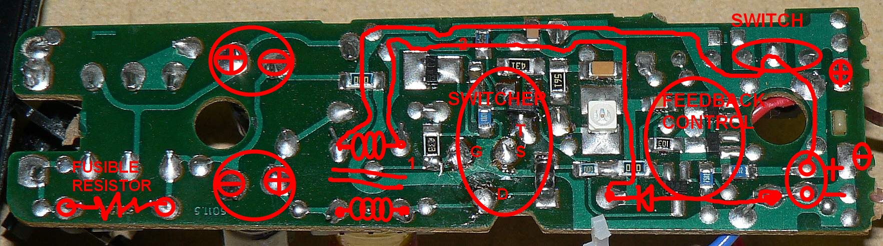

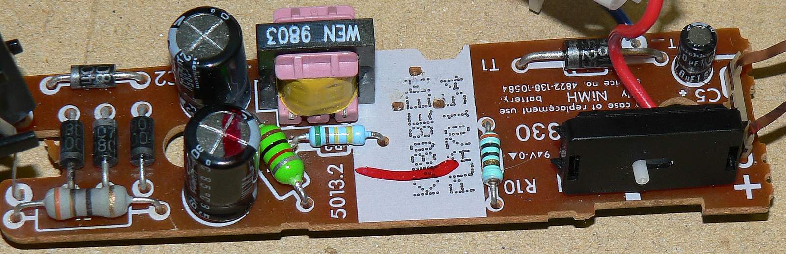

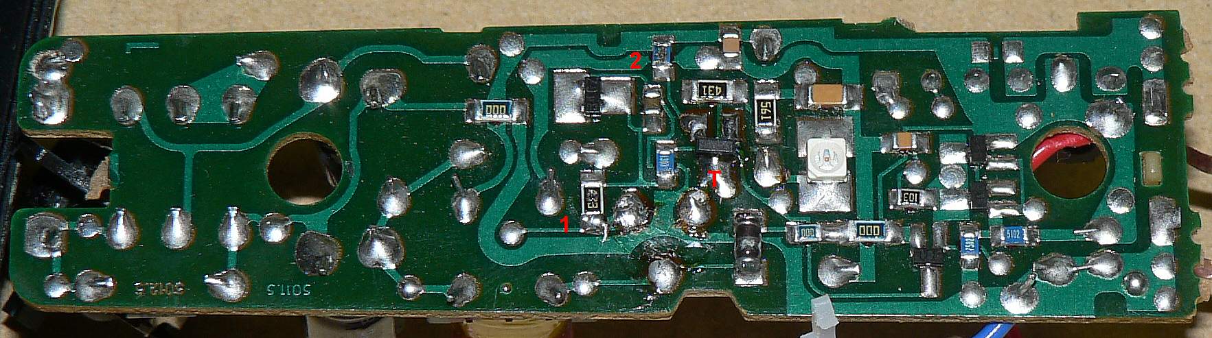

          Here it is. I have already replaced the SMD transistor which was burned, I identified it as some SMD NPN, replaced with BCW66H.
          Now also this N-FET in question is bad and also two resistors. Resistor 1 seems like 6x0 so I will guess 680 ohm. The blue one is 4-digit but I have no idea what. It goes from GND/- of the battery to base of the NPN transistor.
                          It looks like non-isolated 2-transistor switching power supply.
                          When that power MOSFET is shorted out, it will take many parts with it.
                                The black one which seems like something similar to 680 is 3 digit, so I see it is 68 ohm, not 680. The blue ones are 4 digits, yes. Unfortunately it is burned just through the print so I have no idea, I think we will have to guess it's value.
                                And the fusible input resistor is also bad, I'll replace it as well. Rectifying diodes all survived it.
