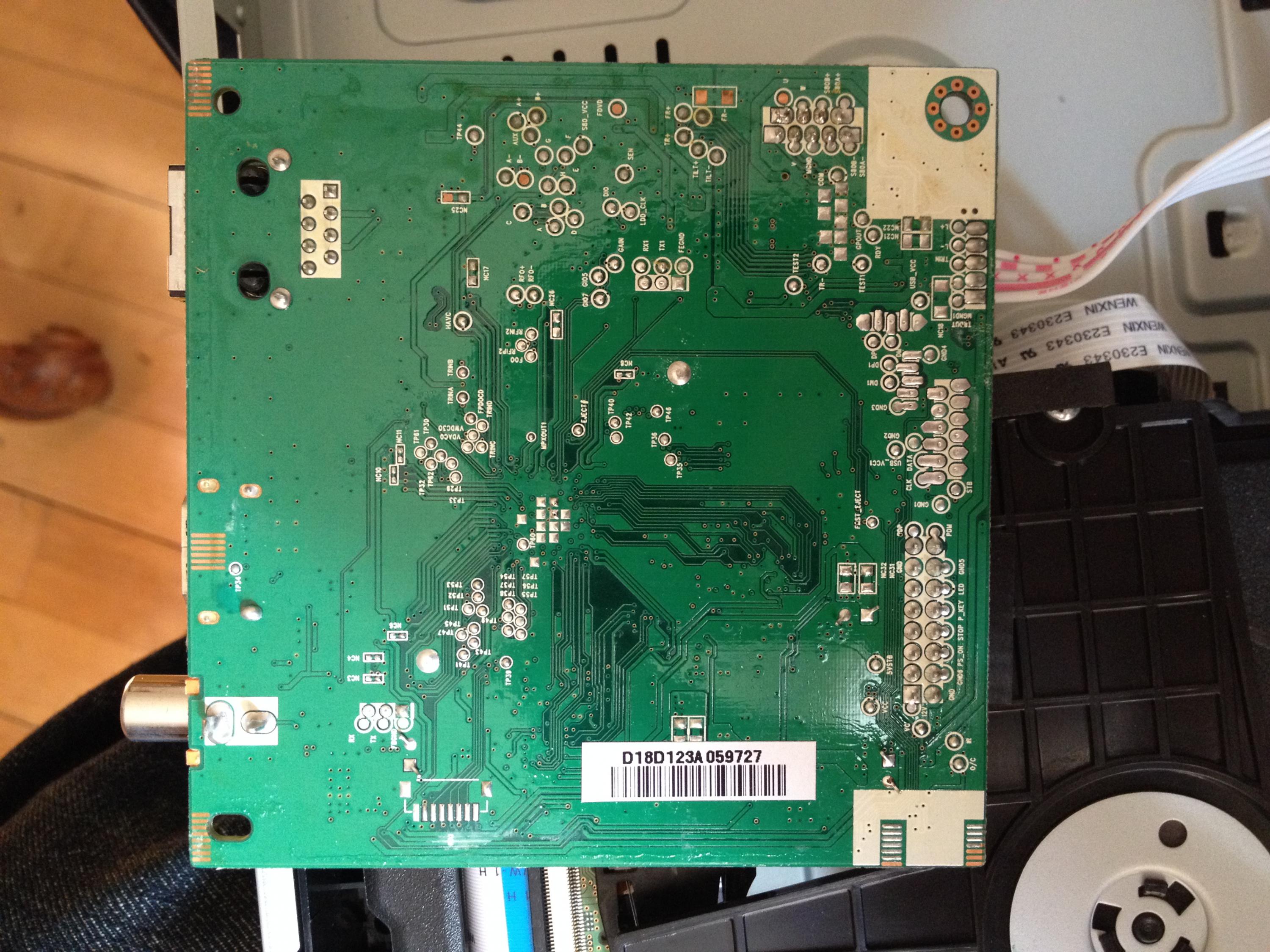

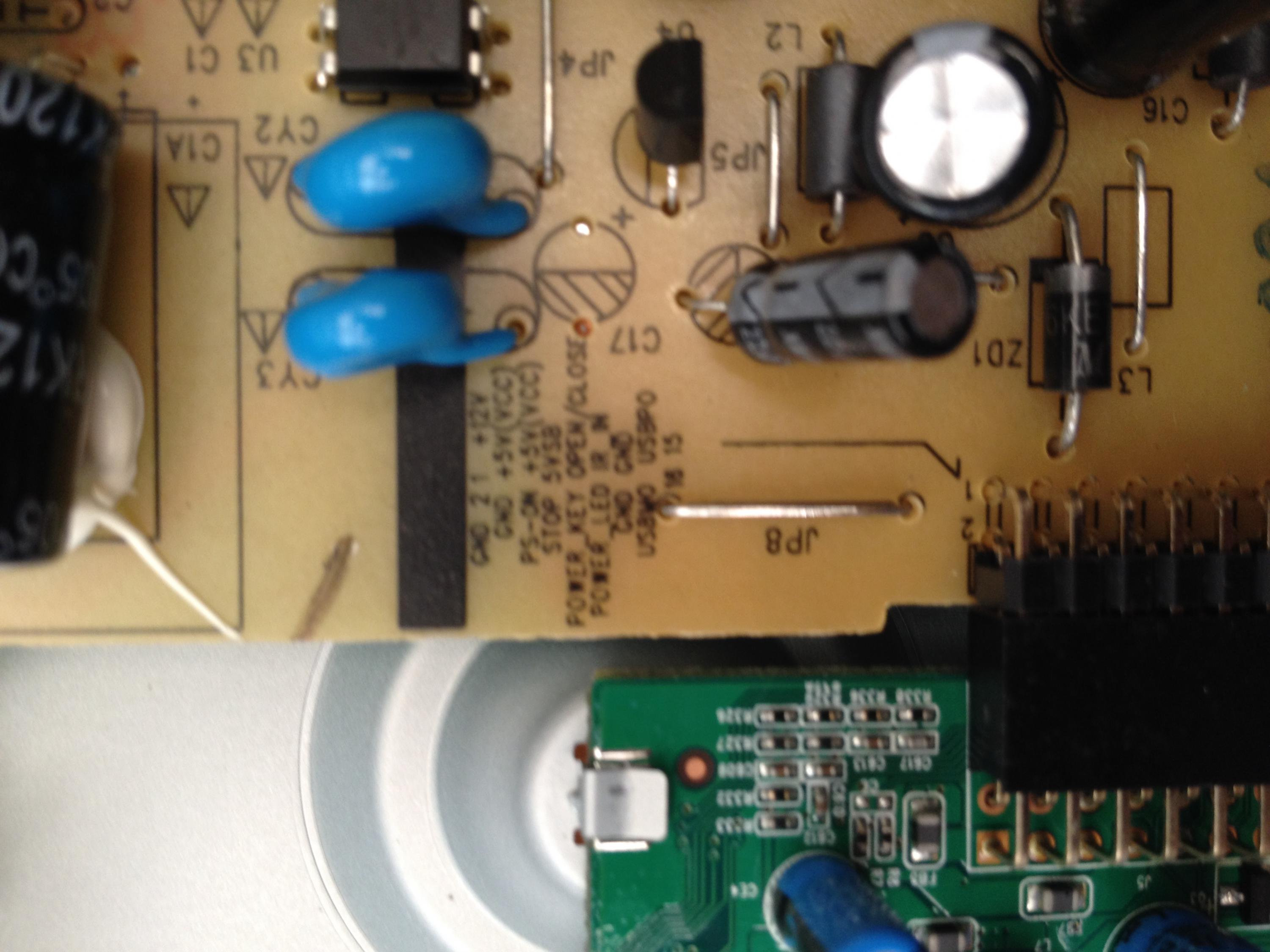

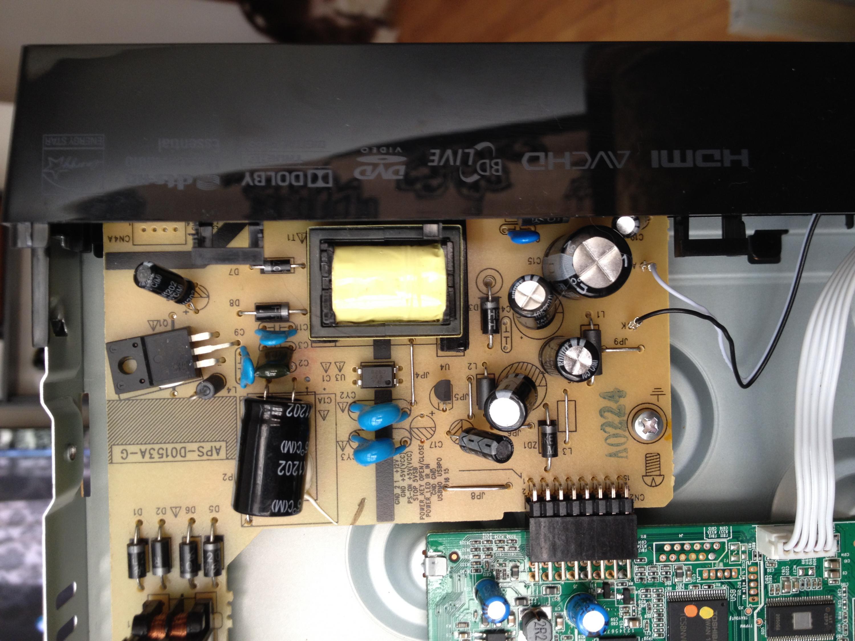

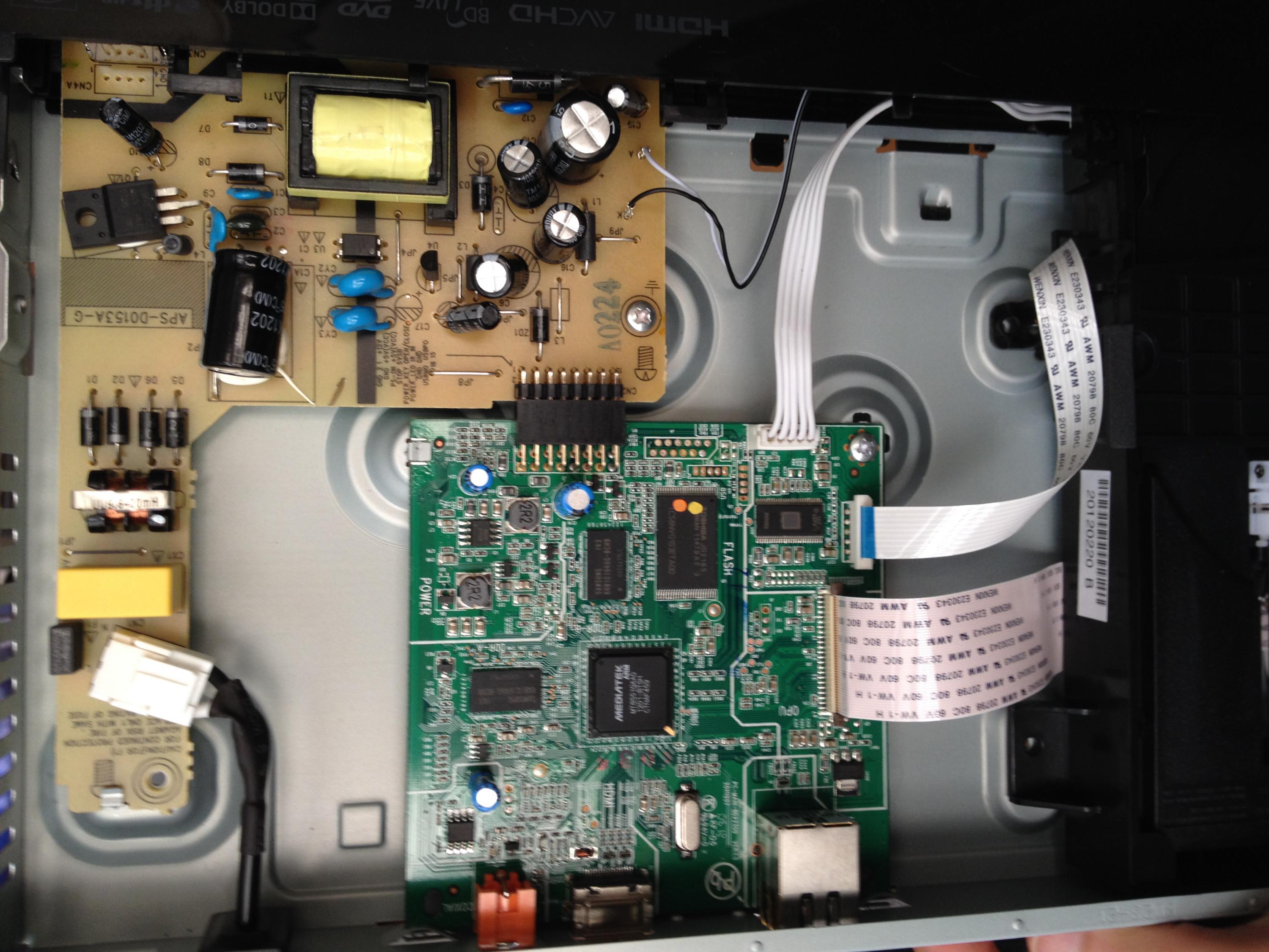

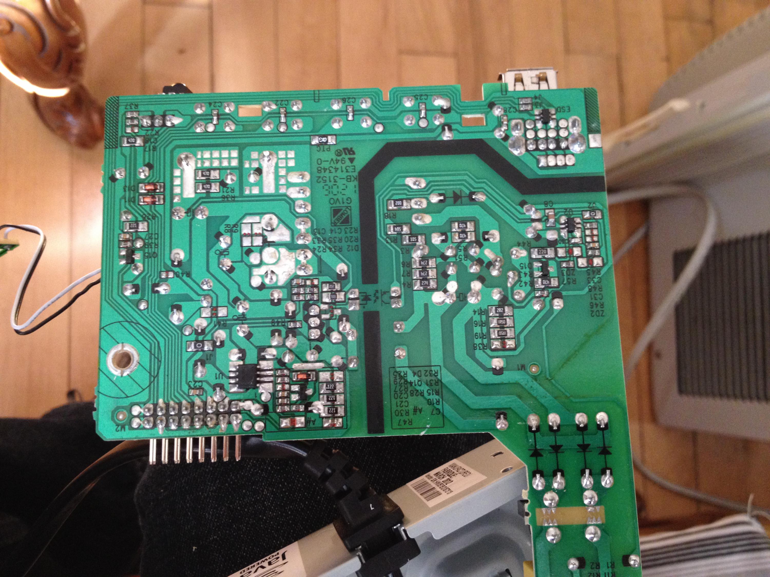

    All the voltages are present even standby but there is no standby light and unit doesn't respond to any keys.
    Ps_on has 1.4v and does not change when power button pressed. I've tried grounding that pin and still nothing happens.
    Mainboard issue?

      So what voltages do have on the connector of the power supply (5V, 12V, 5VSTBY) as shown by the labeling on the board? Since the PS_ON signal does not toggle which will point to problem on the main board.

            Re: Toshiba Blu-Ray Player - No Power
            12.45v
            5.20v (vcc)
            5.20v (vcc)
            5.14v (standby)
            1.4v (ps_on)
            3.30v (open/close) - eject this goes down to 1.20v when pressed but disc tray does not react.

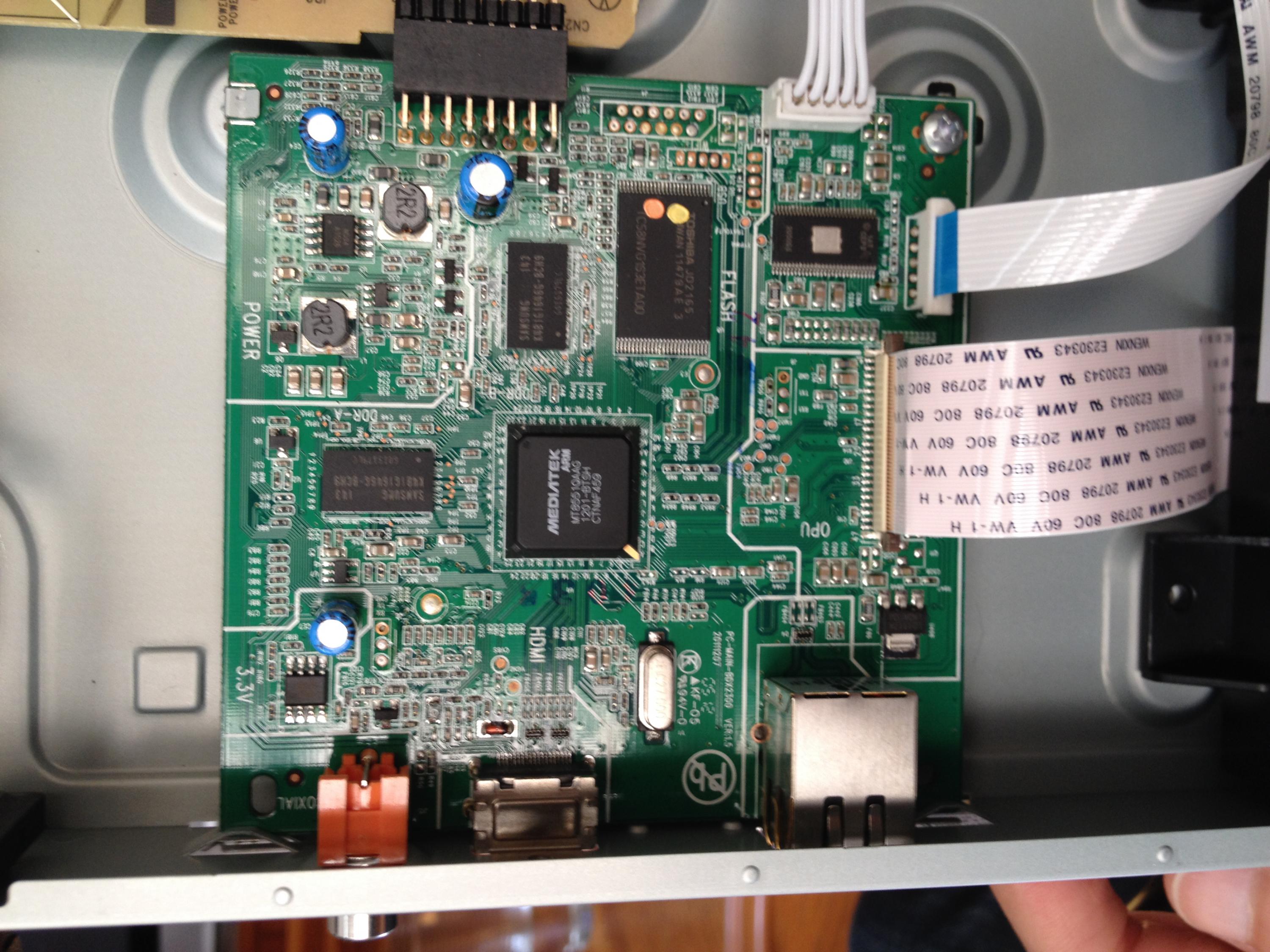

            Would the main board issue be the microprocessor? It feels pretty hot to the touch for such a small board and chip.
                so it looks like the PS_ON is stuck high (that is why all the outputs are present), it should toggle HI/LO when power switch is toggle.
                "Would the main board issue be the microprocessor? It feels pretty hot to the touch for such a small board and chip."That is the possibility right now you are having main board problem. The IC should not be too hot to touch.
                "When I grounded ps_on I did not remeasure voltages but with the mainboard disconnected I don't get all the voltages at the output pins" That is normal since the power supply is no longer receiving the PS_ON to turn on the switched 5V, 12V; only 5VSTBY will be present.

                    Not if it's more than just the pson signal. Sounds like there is no processing of any kind going on.

                            I couldn't find one for it. I searched "Mediatek MT8551"
                              This Philips uses the same MT8551, see SCH for pinout.

                                Thanks a lot! Looks very similar. So I found the reset pin, how do I actually do that? Ground it?
                                  • 31265
                                  meter or scope it to see what it does when you connect the power.
                                  what it *should* do is go to ground for a fraction of a second, then go to the main voltage - that i assume is 3.3v
                                  if it stays grounded then you need to find out why,
                                  if not, you can connect it to ground for a second to see if he cpu starts.

                                    Ok so I thought I found the reset pin but in fact there are two spots on underside of the main board labeled test1 and test2 which I misread as "reset1 reset2"
                                    That schematic doesn't give a detailed look at what pin exactly is reset on the cpu

                                      well i took a quick look, it does have the reset circuit together with a 5v to 3.3v regulator that's related.
                                      i dont know how similar yours is though.
                                      did you check any crystals or oscillators?

                                        I found a similar circuit like that 5v to 3.3v its labeled 3.3v and has a white border to distinguish the components within it.
                                        I did try grounding one end of a resistor that had 3.3v on it in that circuit similar to the schematic but nothing happened. No change.
                                        I don't have an oscilloscope to test the crystal unfortunately
