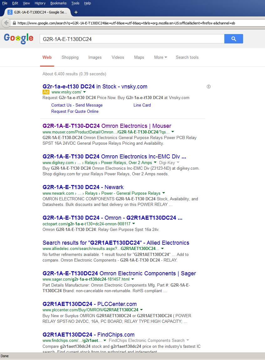

    having a little trouble figuring out what relay will substitute for my power relays on a pcb, I am replacing both that are side by side, thanks.

    example: G2R-1A-E-T130DC24, G2R-1A-T130DC24, GR2-1AE-DC24, GR2-1-E-DC24, all seem to look the same, the same, I guess I'm wondering what the numbers mean, and if I have to use the same exact ones I took out if I'm replacing both, thanks.

        Have you tried to use GOOGLE with at least one of those names, or parts of those codes?
        I just entered G2R-1A-E in google and first result that shows up was G2R series of relays made by Omron.
        Then page gives you the datasheet which tells you the meaning of those digits right on the first page:

              Well, you obviously didn't, or you don't know how to search.
              Here's the search results for the exactly first code you've written in your post :
              Any link on that first page will link to the datasheet, or tells you that it's made by Omron and you can then go on Omron's page and get the datasheet.
