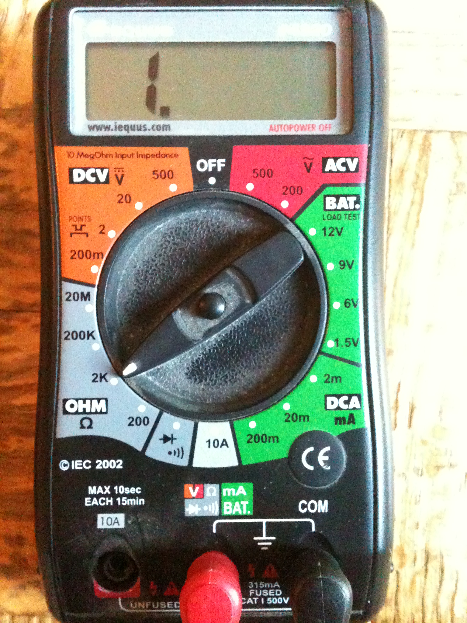

    Multimeter Settings
    Hi everyone. This site seems to be more towards computers and home electronics, but I think the same process would apply for what I am trying to do. I am trying to determine if the wiring to my car's fuel pump is good, I would hate to take the tank off to change it if it is an electrical problem. The car runs but only at 20 PSI fuel pressure, where it is supposed to be at 40 PSI.
    I have read that it can be an issue of the pump not getting enough power to run as it was intended.
    I have attached a picture of what my multimeter is set to for the voltage drop test, please let me know if I have this wrong.
    As for the process, I am basically doing what I saw in a youtube video where I run a jumper wire to the ground wire close to the fuel pump, and connect the red lead from the multimeter to it, then connect the black lead from the multimeter to the negative post of the battery. When I do this the display goes from 1. to 0.000, which I think is what is supposed to happen. Then when the key is turned on and the pump is activated, it goes to 0.25. I have read that anything below a half volt is acceptable. Is the 2K option on the meter the correct setting to use for this?
    I do have a next part where I am stuck testing the power wire to the pump, but I think I will wait and see what you guys think so far because responses to this may answer my own question.
    Thank you for any helpful tips or advice anyone might have on this.
    Re: Multimeter Settings
    "what I saw in a youtube video where I run a jumper wire to the ground wire close to the fuel pump, and connect the red lead from the multimeter to it, then connect the black lead from the multimeter to the negative post of the battery" OK, on this test, it is trying to see you do have high resistance between the Negative terminal of the batterry and the ground return of the fuel pump. '1' on you meter when the probe is not attach mean over range (or infinite resistance), using 2K scale will not give you good resolution when trying to look for low resistance, you should use 200 Ohm scale instead, the ground return reading should be < 1 Ohm, but you have to remember that what you see on the meter you will have to subtract the resistance of your meter probe (touch your meter probes together and see what you read, that will be the resistance of you test leads) to get the resistance of what you are reading. Now, I do not understand what youtube is trying to tell you when it tells you to applied power to the pump, that will cause error reading on you meter sine will be in resistance reading mode, not volt mode.
    Second thing is that you are only checking the pump ground return wire, how about the resistance from the batteries + terminal, through relay contact, then the wire all the way to the pump + wire? I would try get access to the + wire right at the pump and see if you do get full batteries voltage right at the pump.

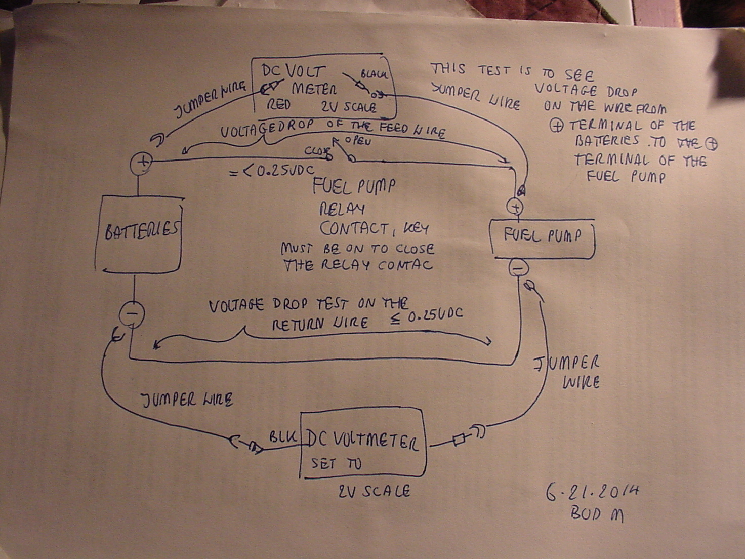

        OK, he is showing you how to test the DC Voltage drop on the fuel pump feeding wire (and relay contact) between the positive terminal of the batteries and the fuel pump + terminal and , and the voltage drop on the return wire between the negative terminal of the batteries and the return terminal of the fuel pump. He forgets to tell you to put the DMM in DC Volt mode. You should put your meter in DC V 2V scale.
        I hope my diagram will help explain what we are trying to test. You are basically looking for <0.25Vdc Voltage drops on the wires.
          Perfect! Thank you so much. I have spent a lot of time today searching the internet trying to figure out what setting the multimeter should be in, but had no luck. And like you say in the video, he doesn't mention it, he just turns it on and I couldn't see what he put it to.
          I will head back out tomorrow with the setting information and your very nice diagram and give it another shot. Hopefully the wiring is all good. I think changing the pump would be easier than chasing a bad wire problem. I have changed the fuses/relays because they were cheap and easy to get to, but no luck there.
          Thanks again, this is above and beyond what I was looking for.
                            Alright, so I have just re-done the test as shown in the youtube video using the DV Volt 2V scale setting and got the following results:
                            Negative shows 0.056
                            Positive ranged from about 0.3 to 0.6
                            How does the 0.056 reading relate to voltage under the 2V setting. I guess I am just not too sure what the various settings mean. I am told that a loss of 0.5 volts or less is good, so is this actually 0.056 volts or does that decimal need to be moved?
                            I am also not sure that the test is working right on the positive side. The reading worked the same on both sides in the video, but for me there is a 1. on the meter until the key is turned, then it goes somewhere between the 0.3 to 0.6. Shouldn't it work like the negative where it reads 0.00 until the key is turned?
                            Thanks everyone.
                              "How does the 0.056 reading relate to voltage under the 2V setting." That means the resistance on the return wire is very low which you would expect since the car chassis is connected to the negative terminal of the batteries.
                              You will see the '1' on the meter because when the relay is not close, the meter will see 12V and the meter is set to Volt so it shows over range ('1'), when the relay is closed then you are reading the voltage drop on the wire and the relay contact resistance, the amount of voltage drops on this wire is determined by the wire gauge being used and the relay contact resistance. @ 0.3~0.6 will give the pump 12V- 0.6V about 11.4V which is more than enough to run the pump, the pump should easily be able to run at 10VDC. I would say your wiring is OK.
