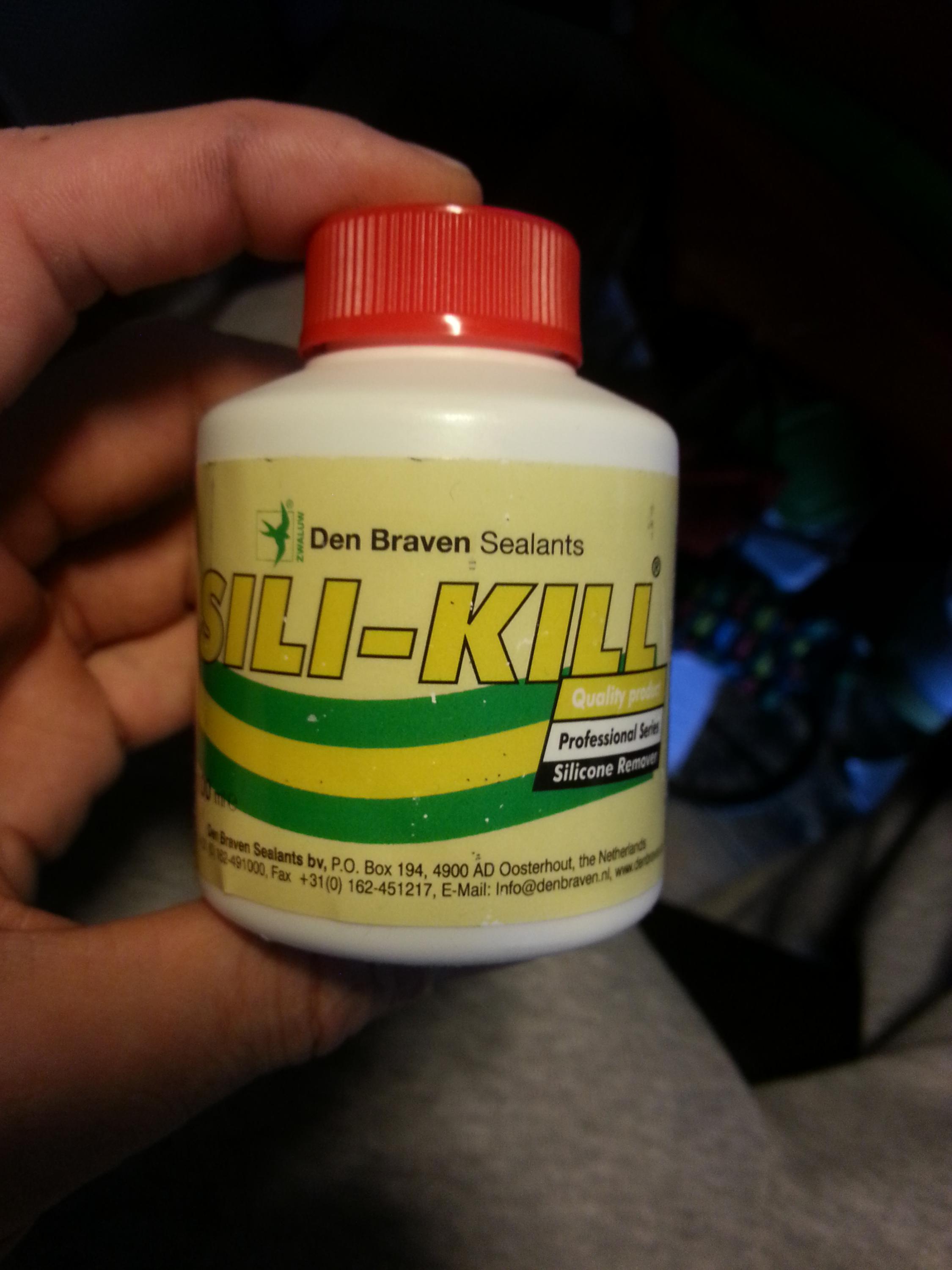

    I've looked through the forums and can't find the info I'm looking for. I have to remove some chips from one board and put them on another board. I used my rework station and scraped whatever silicone I could off the chip but there's still some on it. I tried goof off and it didn't work. Any ideas?

    Re: Removing Silicone from IC's
    That should work, I use Silicone Grout sealer (I found this out by accident when I was sealing the grout and spill some on the Silicone seal around the tub, the Silicone just came right off).
      I have some grout sealer. I'll try that first.
        The grout sealer didn't work. Off to Home Depot tomorrow.
          I use this
            • 31283
            brass-brush
            the type that comes in a pencil.
            although you should have used it before lifting the part.
              I haven't pulled the chip yet. I have a few test chips I can pull first. First time using the rework station. Going to Home Depot right away.
                Bought the silicone remover. Worked pretty good. I used a board type scraper brush after to get the rest off. Seems to work. Tomorrow I will try to use my rework station to put a chip on for the first time.
                  I bought the DAP silicon remover. It works pretty good. Not as good as I would like it but I used a fiberglass brush for removing the coating on pcb's to scrap it off. Tonight will be my first attempt on re attaching a plcc. Wish me luck!
                    plcc is easy with air - just use a swirling motion around it while gently testing at one corner with a lifter or blade
