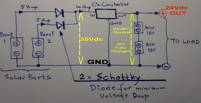

          Re: Battery question
          As I understand it, you have the something like this schematic:
              Exactly.
              only thing is there is no diode to stop panel getting voltage from other panel.
              battery voltage is currently at 24V

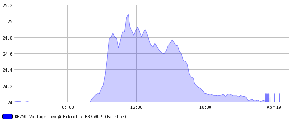

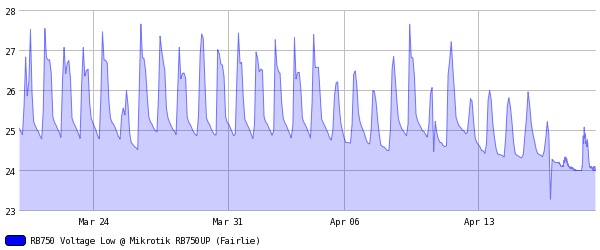

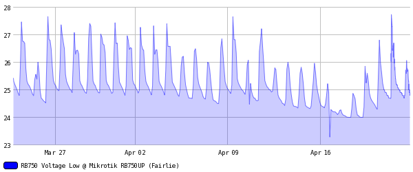

                  Here are the voltage statistics.
                  18th of April
                  last 30 days
                  My pc

                        I have used these graphs before. For the time since April 6, battery about 12.5V down to 12.0V which means the system is not doing well.
                        I would say your battery is too small. Voltage comes up quick in full sun, almost too fast. Lots of charging when sunny.
                        Look at the night-time voltages (dips). You can tell how heavy the load is by looking at the slope of the night-time portion. It's quite steep, meaning the load is too high for the battery size. That would be my guess.

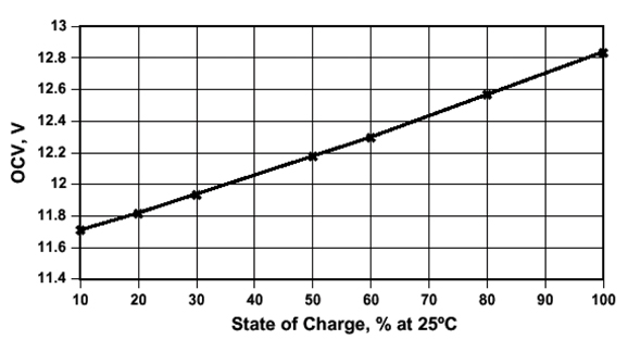

                                jopshnz, I designed remote-site solar systems that failed and I had to helicopter in at $1,000/hr, land in muskeg and fix them. It's no fun. Important to really look at the data and have the right parts when you go in...
                                What I will talk about is based on rough % state-of-charge verse battery voltage. Attached is a graph, it might be slightly off from your SLA but shows my viewpoint. Assuming around 20C temp.
                                When the system was doing well in March, daytime charging peaks are 27.5V which is great (100% charged), and night-time dips 25.4V falling to 24.8V so I estimate the pack is down to 70% by sunrise.
                                Some rough math: 14hrs of darkness, 30% of 200Ah is 60Ah (consumed) gives about a 4.3A load.
                                At this point, I would suspect
                                - You have night-time parasitic current drain, backfeed to the solar arrays or the charge controller (I hope it's not a Morningstar), or your load is simply drawing more current than expected.
                                - The battery is failing and is no where near 200Ah capacity, like kc8adu says, it could be sulphated.
                                In sunlight, the battery voltage (after April 13) 24.5V jumps up to 26.0V, saying 55% capacity at sunrise and 100% charged an hour or two later. This recovery is too quick and indicative of a battery problem. In full sun your panels put out 10A total?
                                I think the battery is performing poorly and adding another panel would not help.
                                It's also important the data acquisition system is properly grounded (single point), so the readings are accurate. Charging current can artificially inflate the charge voltage numbers if the grounding is wrong.

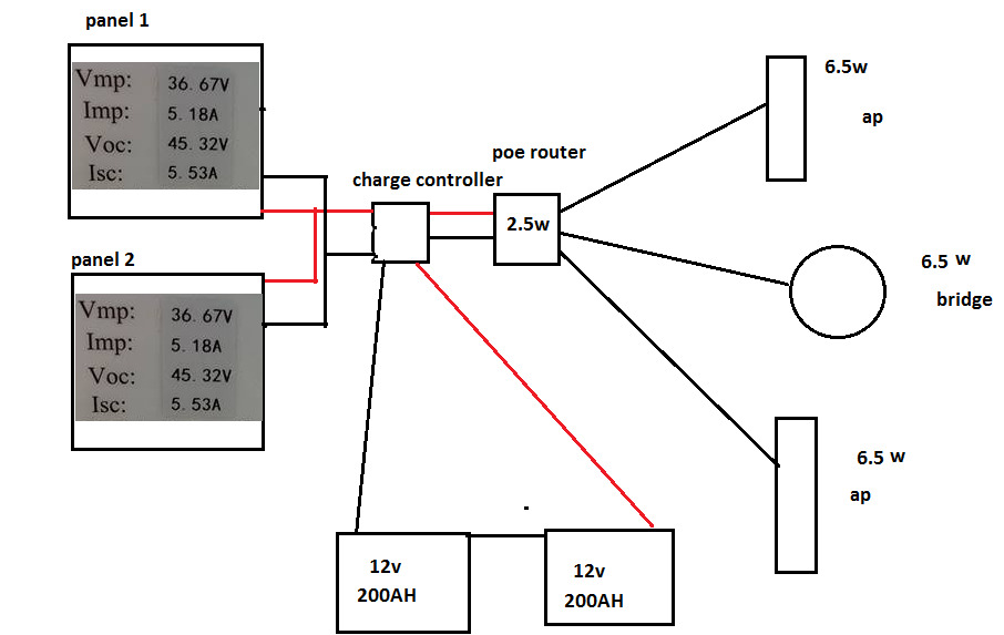

                                    We have 3x 6.5 Watts
                                    And one 2.5 Watt device.
                                    i have uploaded a layout of the site.
                                    Poe router is data recorder.
                                    also uploaded chart from today.
                                      From the graph, it looks like the system can handle poor sun/cloud for about 5-7 days before the batteries get low, and about the same time to recover.
                                      I just the feel the battery is working too hard. Either the load is higher than expected or the battery capacity is smaller than expected.
                                      The RB750UP router is rated for 2.4-3.6W, and I'm not sure about the AP and bridge models but 24W total seems reasonable.
