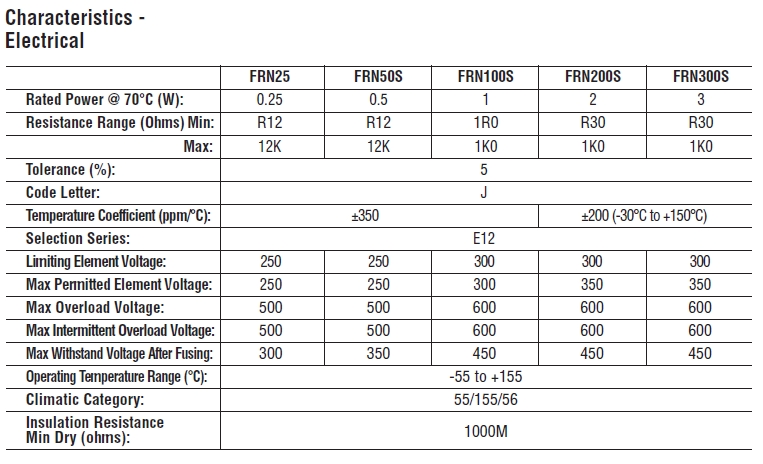

    I have a blown fusible resistor labeled as W1/2J 2.2 ohm FU985. I interpreted it as 0.5 Watt, +/-5% tolerance. I can't read out further information. The dimension of this blown fusible resistor is 10mm in length and 5mm in diameter as the attached photo. It is relatively big.
    When I tried to order this online, tyco FRN50 seems to have same specification. But the dimension of FRN50 is much smaller.
    It is 6.3mm in length 2.3mm in diameter.
    It is only about half of the size of the blown one. Will this replacement work?
    I have attached the specification for FRN50. Does size matter especially the heat and thermal concerns?

      If you look at the spec, the withstand voltage after fusing (after blown open) is one of the important number to compare to the old one. It is similar to the fuse voltage rating, I.E. you do want to 5A 32V car fuse to replace the 5A 250V fuse used in the line operate equipment.
      Do you know where this fusible resistor is used in the circuit and how high is the voltage it is being used in?

          When it goes open, it must not allow the voltage to jump over the open circuit, thus the the withstand voltage after fusing rating is provided.
          FRN series is the Flame proof Fusible resistor.

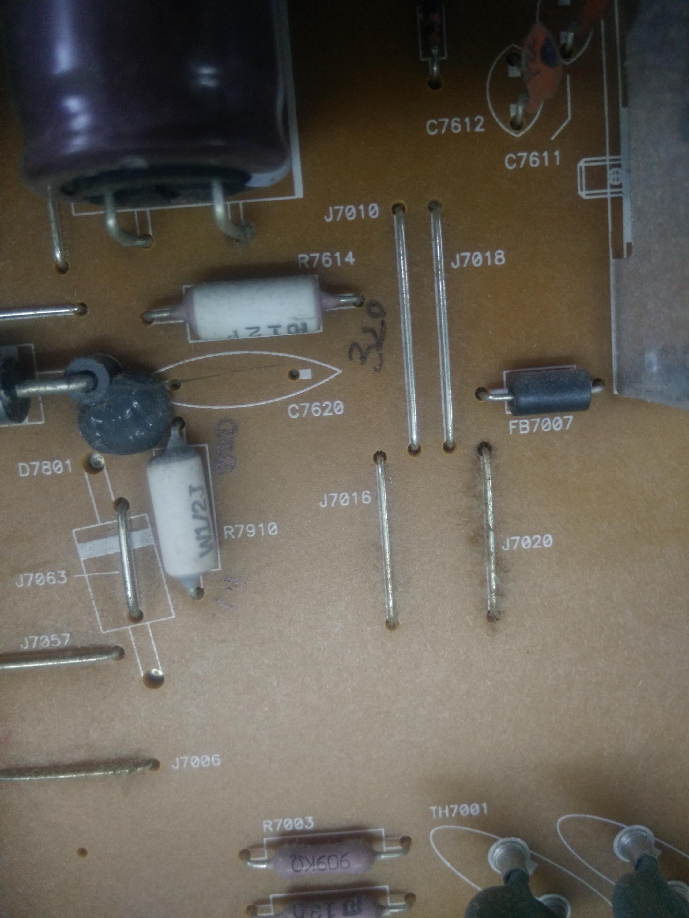

            This is for Sharp AQUOS LCD TV power supply board DPS-226-AP-1. It's at primary circuit so it must be 230volts AC.
            So can this replacement fusible resistor FRN50 be used but with a much smaller dimension?

              Size of a resistor and it's temperature rating determine the wattage. That resistor is the size of a 2W part.
              I would not use the 1/2 part as a replacement.
              Most power resistors are rated at 70°C, so their size determines the wattage.

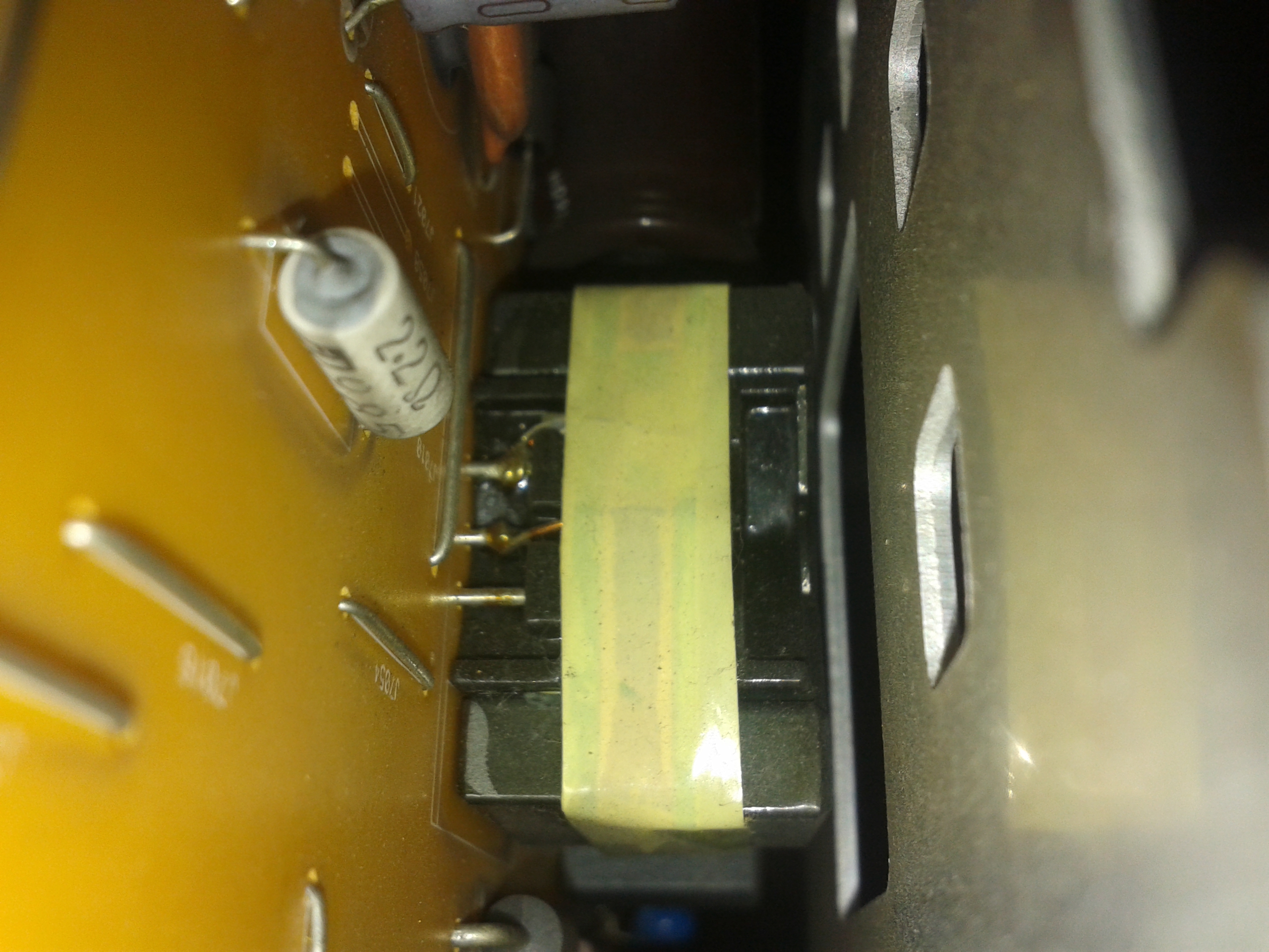

                  This is the photo for the blown fuse before desoldered.
                    Re: Questions for Fusible Resistors
                    More likely to be for main B+ line which will be around 330VDC. Trace out the circuit to see if one end is connected to the + terminal of the main filter cap (450VDC rating). There must be shorted out components that you need to checked out.

                        So it is the fusible resistor for feeding the B+ which is around 330VDC. So the fusing withstand voltage should b e more than 330v

                          Looks like it is made by Futaba. They have some funny names for their resistors: "ANTI-BURST FUSIBLE RESISTOR", "HEAT ENERGY SURGE WIRE WOUND FUSIBLE RESISTOR" etc. Take a look under "fusible" category.
                          Note a fusible resistor has two voltage ratings - the max. working voltage, and the max. fuse voltage. This is a 2.2R beast, so it would normally never seen more than a few volts.
                          Why it is so big and really a 1/2W? I guess its a high-voltage type, or non-inductive if used as a snubber.
