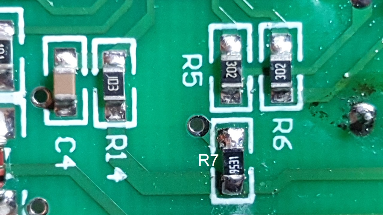

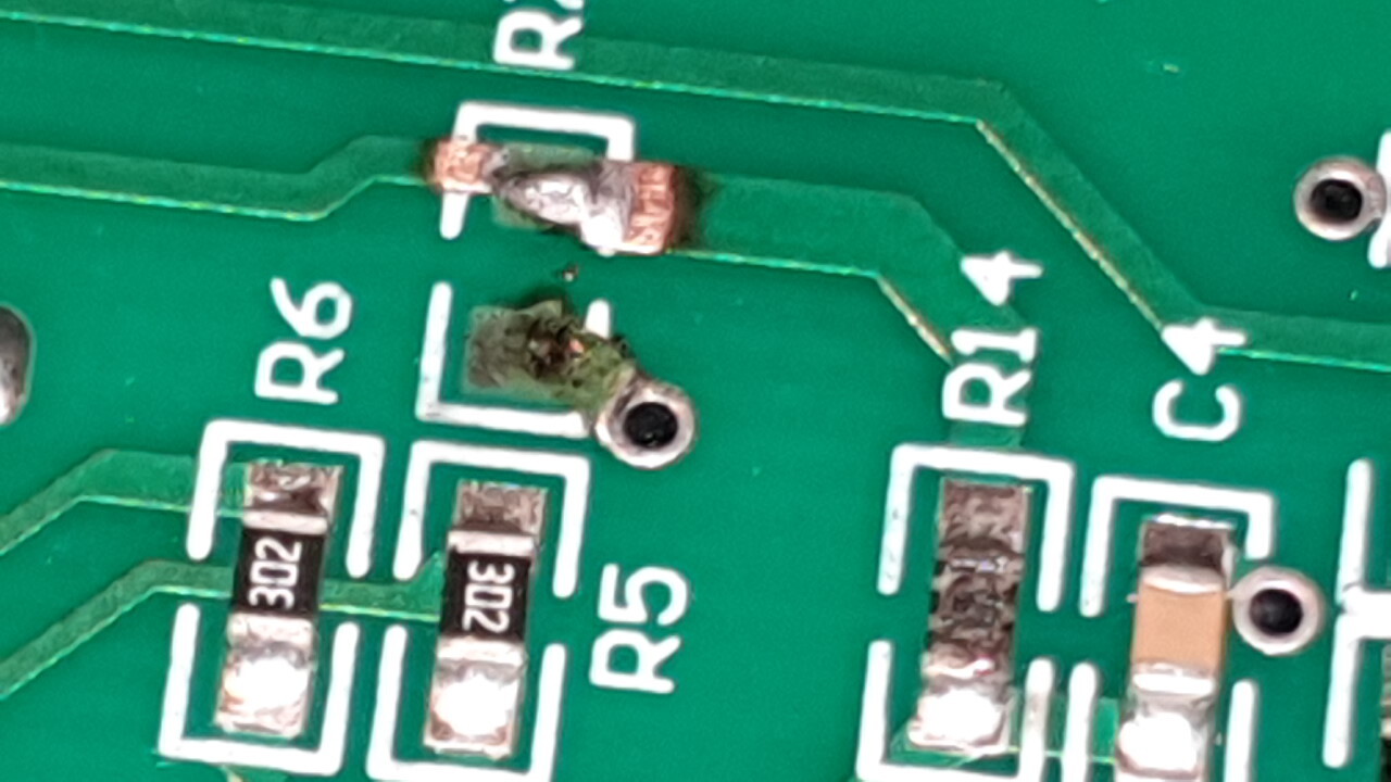

    We have one of those heated throw blankets you plug into AC power. The other day it went *bzzzbzzzbbzz... pop*, so I opened it up to find what appears to be two resistors gone *poof*. (R7 & R14 in picture)
    luckily, we have a second blanker with what appears to be identical controller, so I opened it up to take a picture
    According to the good controller PCB, R7 = 9531, & R14 = 103
    Online SMD resistor calculator says
    R7 - 9531 = 95.3kohm
    R14 - 103 = 10kohm
    Is this correct? Would all I need is a 10k ohm & a 9.53k ohm? I had a google but there seems to be many types with many with different tolerances. Any suggestions on which ones I should choose?​

    first you need to find out what has shorted to make them burn.
    start by checking diodes and ceramic caps
    • redwire
      • Dec 2010
      • 3912
      Resistors never fail and burn up of their own accord. Something happened to overload them.
      If it was a mains transient, lightning that arced over them, then whatever is downstream next is surely dead. They seem to go from control button (or whatever blanket 3rd pin is for) to R14 to MCU... that is surely toast.
      Does it power up? LED display on?

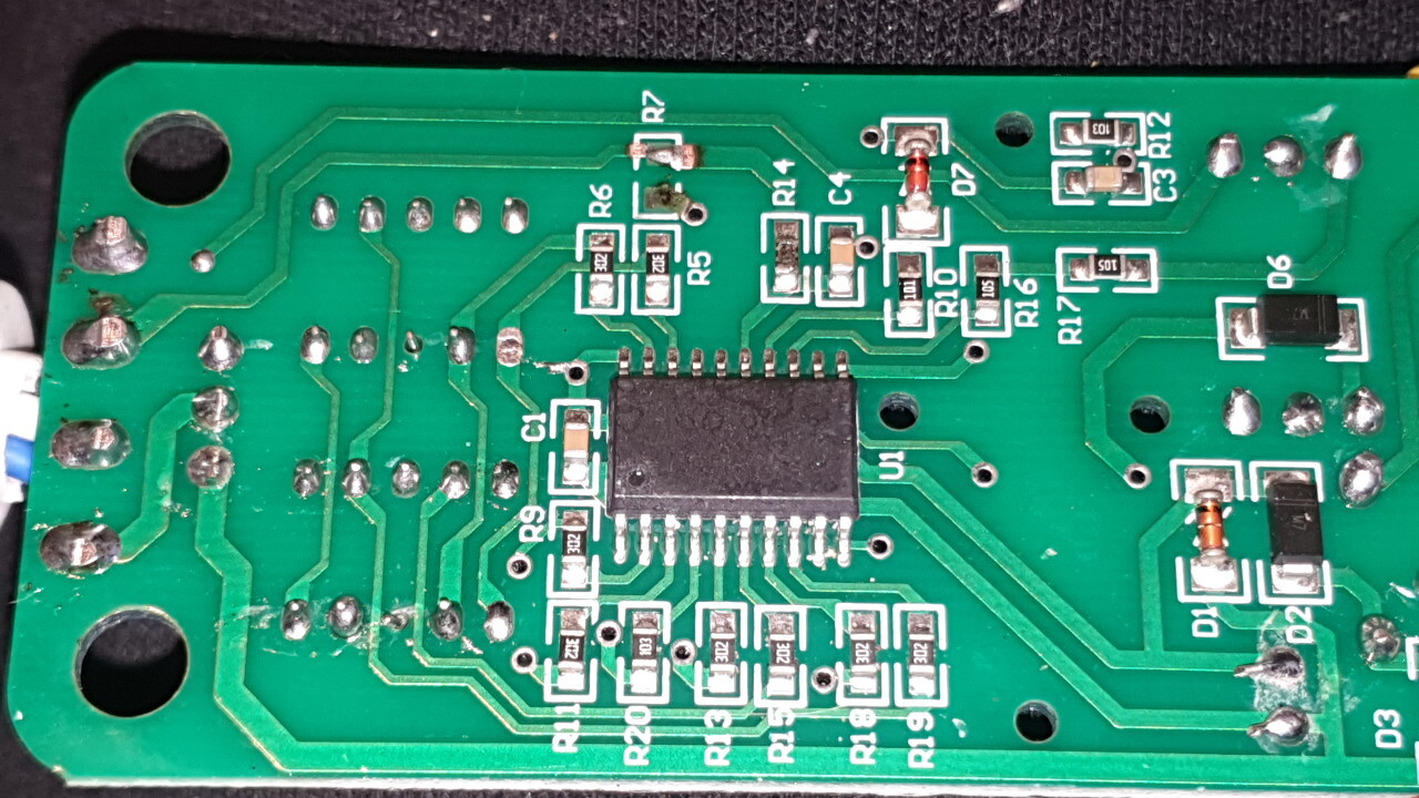

        The track they're on is connected to an unknown IC & leads to the main input for the throw-blanket. The only other cap I see is linked to R14 resistor but the capacitor has no value written on it. The blanket/controller that's good is still under warranty & desoldering the cap to check value I can't do. Can these caps be checked in circuit?

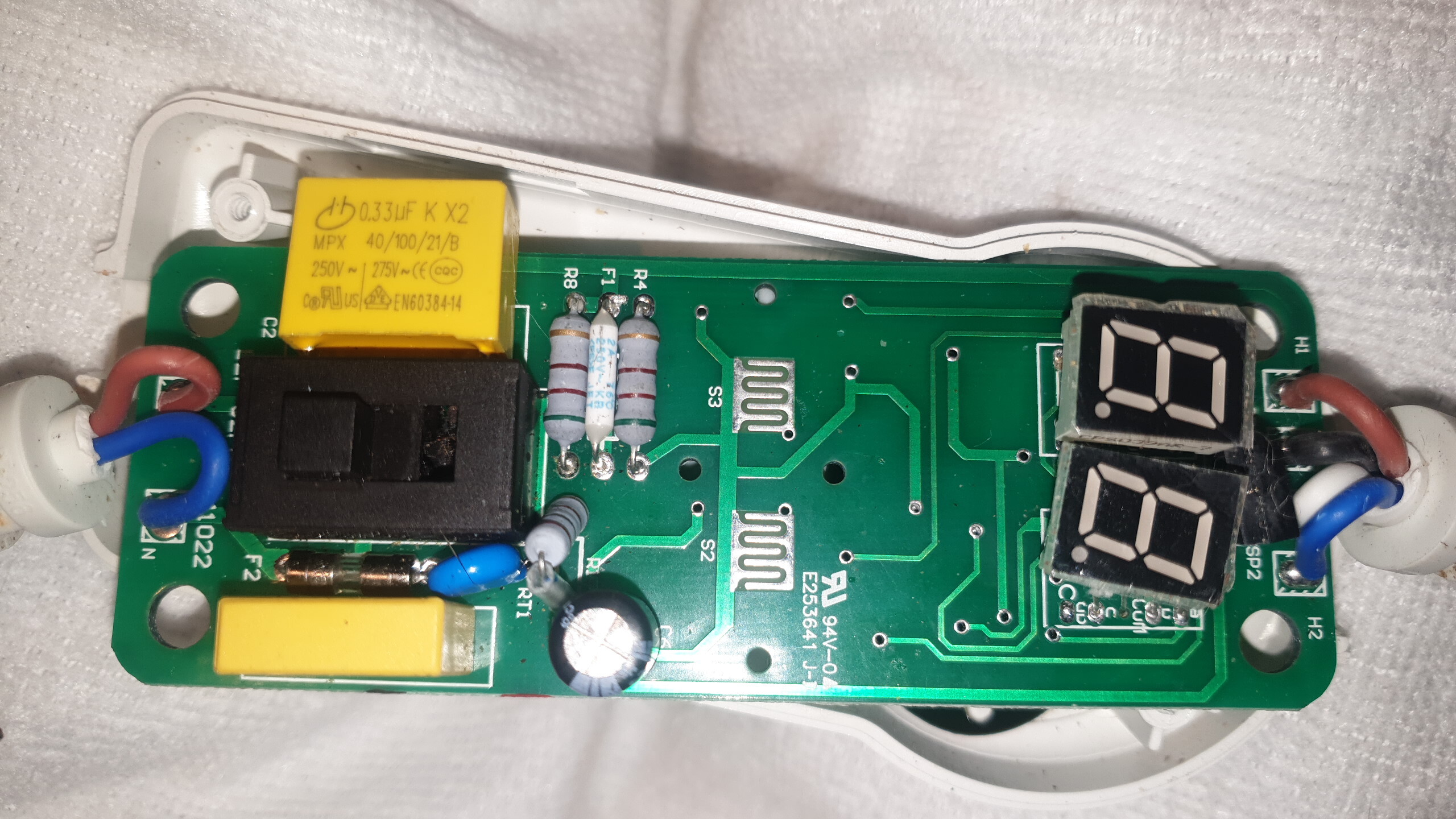

          picture of the other side?
          i dont see a triac or other switching device - maybe it's the chip you mentioned.
          also cant overlook a short in the cable to the blanket

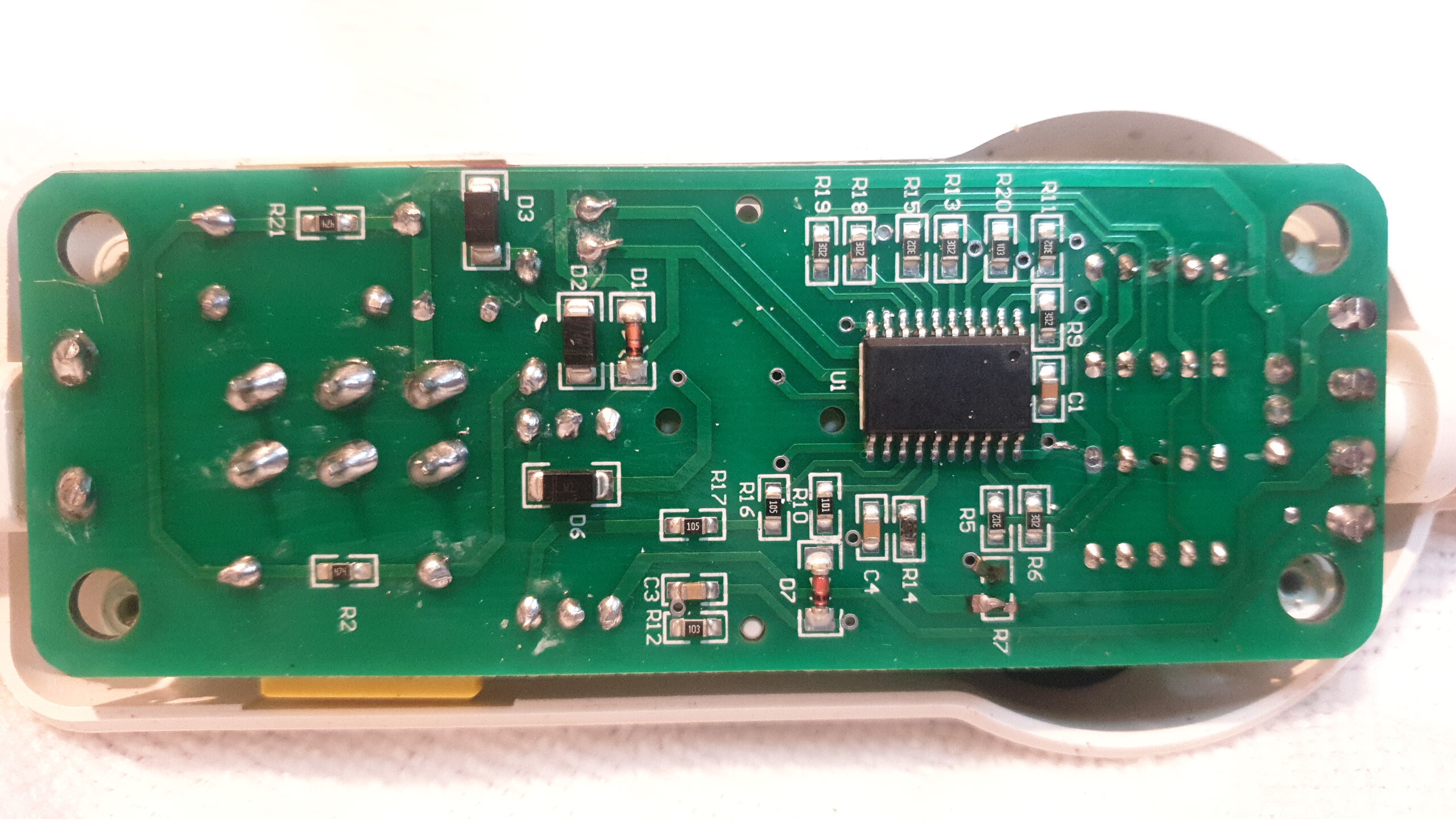

                Sorry for the delay in response. I've attached two images showing each side. I'm not sure what a 'triac' is, I was hoping for it to be a simple resistor replacement lol, guess I'll have to weigh up trying to fix or whether it's best to scrap it. I'll have a look for some shorts, but in regards to the chip, if the chip can't be identified then I won't know what value to measure at the pin(s), therefor it would make it near impossible to repair, no?

                          i cant see any mains switching devices,
                          i'm wondering if the numbers are just a display rather than a control.
                          and if both fuses are good it may just be a shorted display chip
                          it looks like it has a big switch so maybe it just has full power and half power (half wave rectified) to the heater

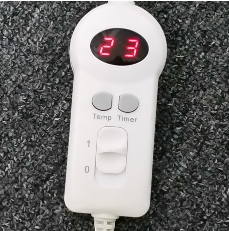

                            and here is a pic of how it looks on the front .

                                Oh, I didn't see/test the white (ceramic) fuse (F1), iirc the glass fuse (F2) tested ok.
                                The big (0-1) switch is on/off. The temperature & timer go up to 9 I think via the soft-press gray buttons

                                  f1 looks like a thermal fuse
                                  the wonky display might not be helping things

                                        are there any more components under those elevated displays?
