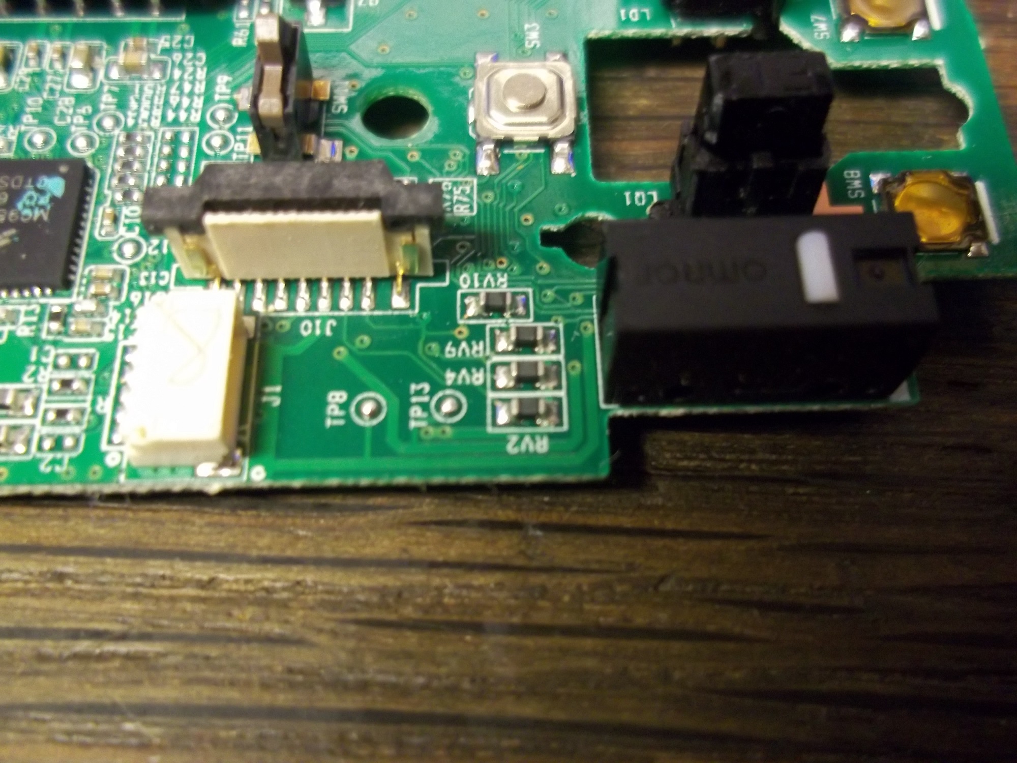

    What does "RV" on a pcb stand for? I want to say resistor voltage? I got a bunch of them on this Logitech mouse that's dead (no power, person plug wrong power brick into usb hub and fried everything that was plugged in.) When measured they only work one way and come out to 182k ohms.
    So what are they?

    One-way sounds like it's a rectifier. (AC-to-DC)

          RV is usually board designator for Varistor

            Can we the pictures?
              Re: What does "RV" stand for?
              sorry it took so long, picture below.
                They look like typical SMD caps, which are seen often on graphics cards.

                  the capacitor uses Cxx for the capacitor designator on this board. Rxx for the resistor, RV (Varistor for peotection) it is proably connected between Ground and the junction that needs to be protected.

                    Concur with budm, probably surge protection diodes. Another possibility might be temperature compensation thermistors.

                      If you are talking about the items in bottom right hand corner they are sm resisters
