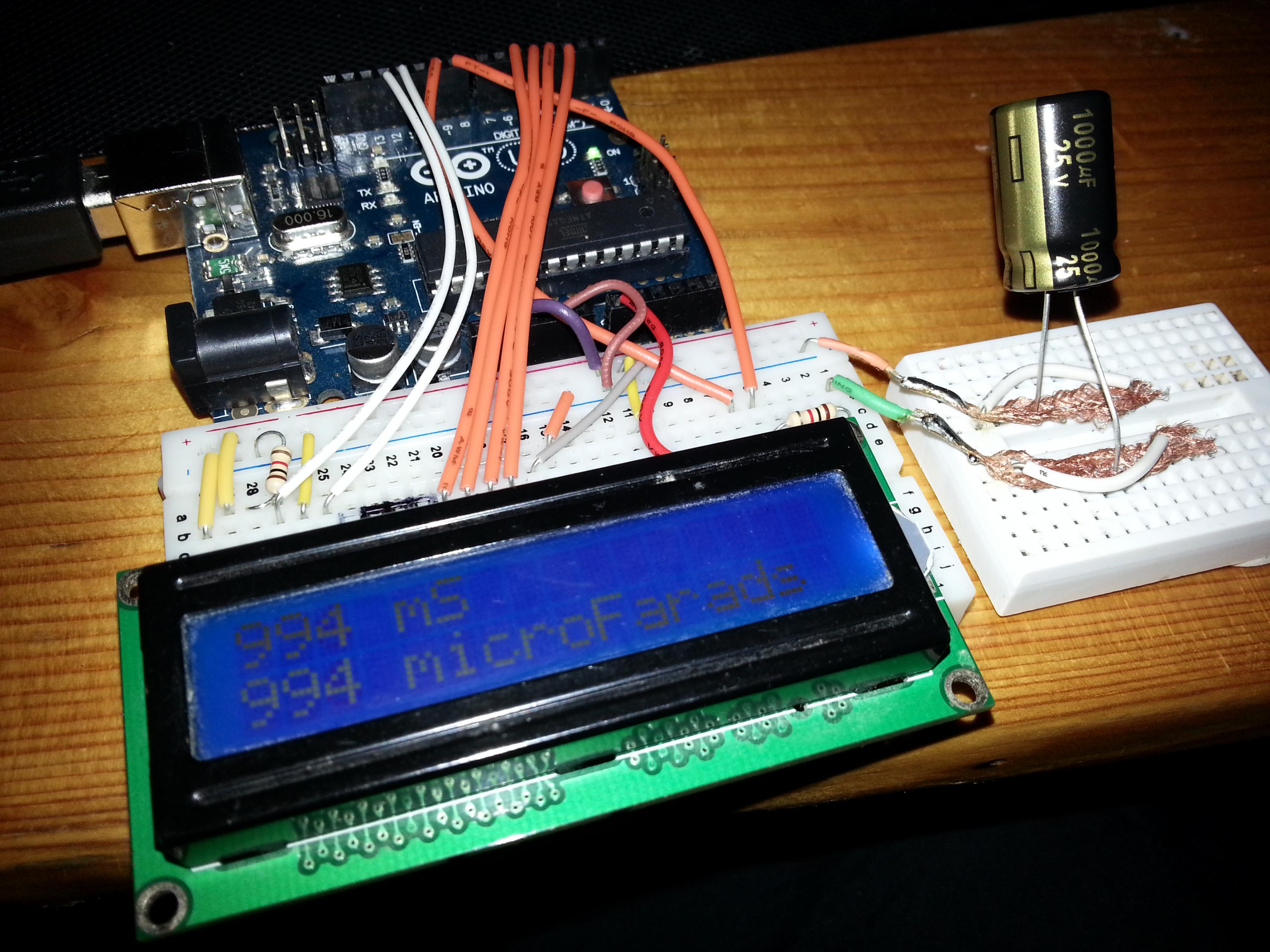

    I made it from the help of some online schematics and code.
    Simple design really, looks messy from all the LCD wiring.
    As you can see from the image, 1000uf cap reading at 994uf, fluctuates around 994 - 1000uf on the reading, so pretty accurate. Depending on how accurate the resistor in the charge circuit is.
    Using this with blow capacitors, the reading is either 50% or less than the rated farads, or doesn't get a reading at all. Used it today and found a couple of bad caps with it that weren't blown.
    Thinking of a way to have a green/red light system to detect if the capacitor is bad, but not sure how I would do this without having to tell it the rated farad of the cap.
    I have a load of these arudinos, and LCD displays, may etch some PCB's to create a permanent one.

                      I wonder if there is a better way to test the capacitance, instead of having to wait a second or two xD
                        Here is the code that calculates the Farads.
                        Code:
                         digitalWrite(chargePin, HIGH); // set chargePin HIGH and capacitor charging
                         startTime = millis();
                         while(analogRead(analogPin) < 648){    // 647 is 63.2% of 1023, which corresponds to full-scale voltage
                         elapsedTime= millis() - startTime;
                         // convert milliseconds to seconds ( 10^-3 ) and Farads to microFarads ( 10^6 ), net 10^3 (1000)
                         microFarads = ((float)elapsedTime / resistorValue) * 1000;
