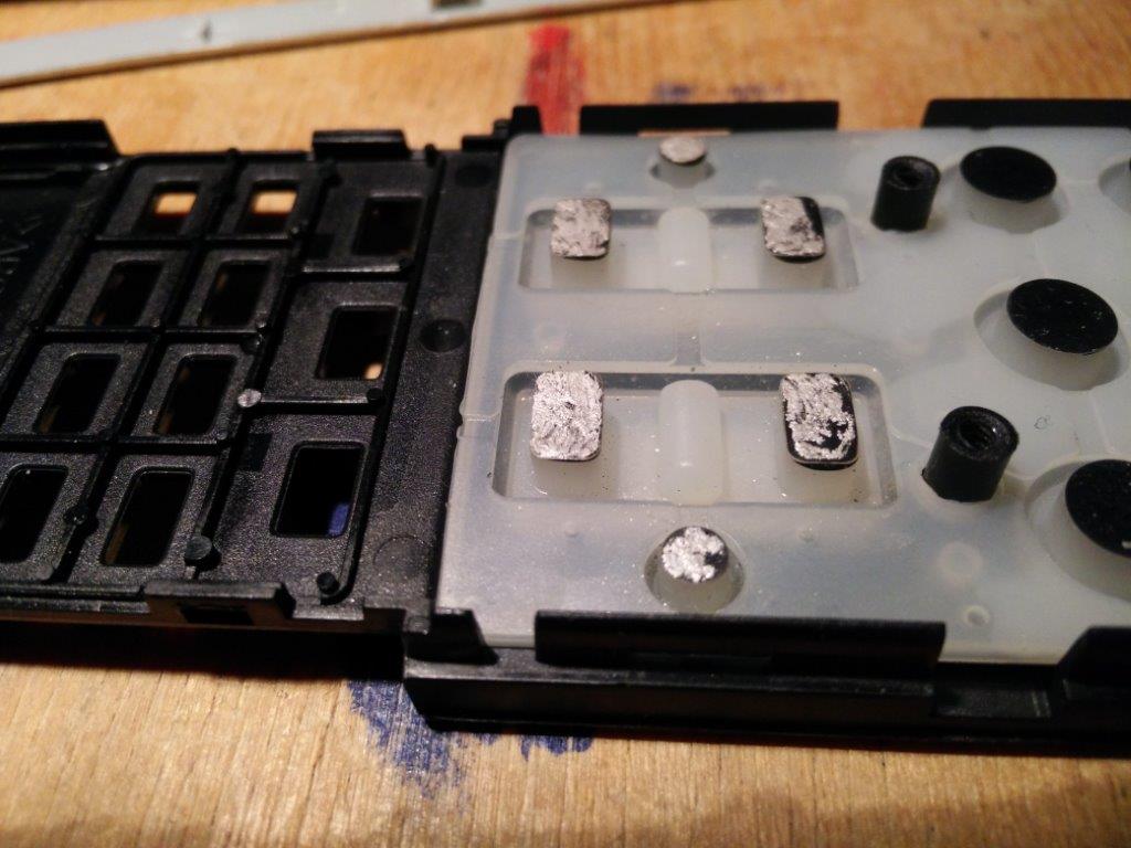

                      MG Chemicals Rubber Keypad Repair kit 8339, $30 "Guaranteed to work over 500,000 keystrokes under normal using conditions" - didn't last a year
                      Their "pure silver" is mostly silver colour and rubbed off onto the PCB. The dispensers dried up, so....

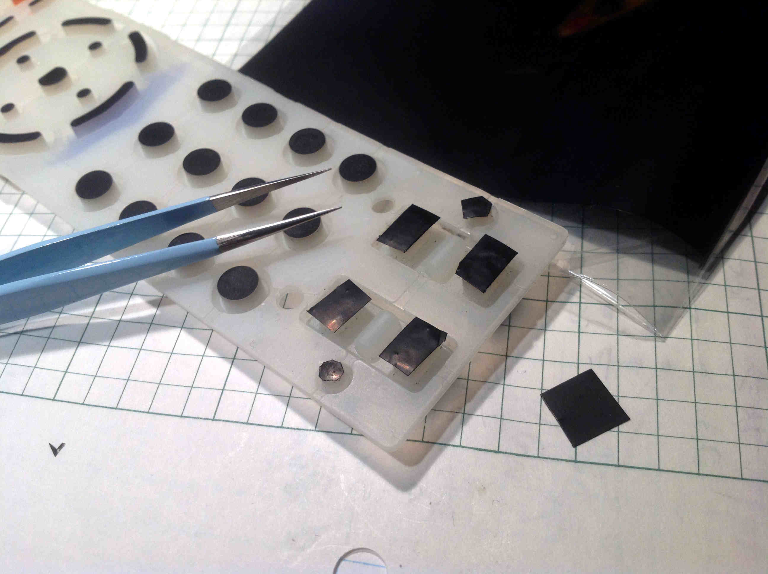

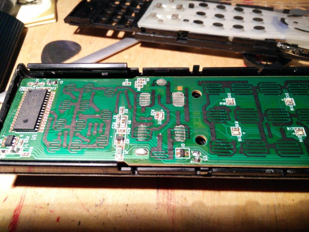

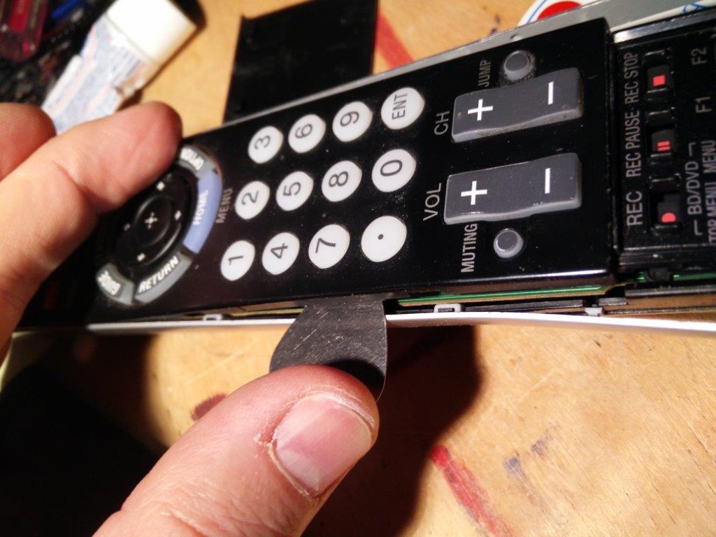

                                Follow up- I found a better way to repair remote control keypads.
                                The MG Chemicals remote control repair kit did not last. The conductive silver paint just rubbed off as the first two pics show.
                                What I did is glue conductive plastic, AKA Velostat/Linqstat to the buttons. Got a small piece on eBay.
                                Velostat is a carbon impregnated black polyethylene film, paper thin 4mils. Used for ESD bags. But glue does not stick to it at all. I had to use two-part cyanoacrylate.
                                After the glue dried, I used side-cutters and trimmed each piece.

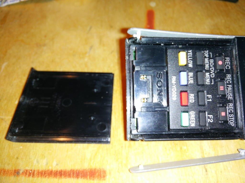

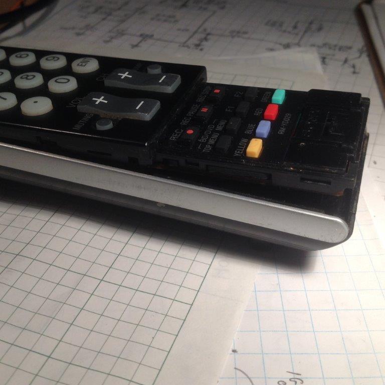

                                To disassemble this Sony remote (RM-YD029), do not pry the silver side-trim out at all. It has interlocking fingers between the top+bottom pieces.
                                You have to pry the top and bottom clamshell apart using a metal guitar pick. Start at the mini keypad end and work to the other end.
                                Hope this works for others.

                                  Re: Repairing Remotes

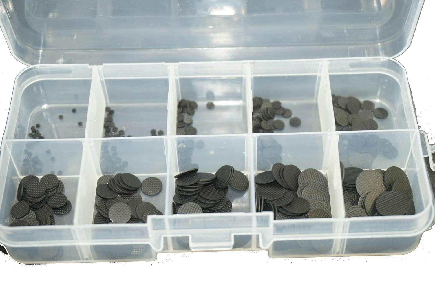

                                  OK so that repair did not last long. The problem is no glue really sticks to polyethylene and the pads fell off.
                                  Next, I tried a USD $7 rubber pad kit from fleaBay "keypad repair KIT for IR remote controllers - 100pcs conductive pads ,1.5mm~10mm"
                                  These glue onto the keypad, I used silicone glue, you can trim excess off after it's dried using small side-cutters. Hard part is just using a tiny bit of glue and keepiong it centered and squished a little (put a weight on it) until it dries.
                                  The key travel is much less now - but it works for years now.
