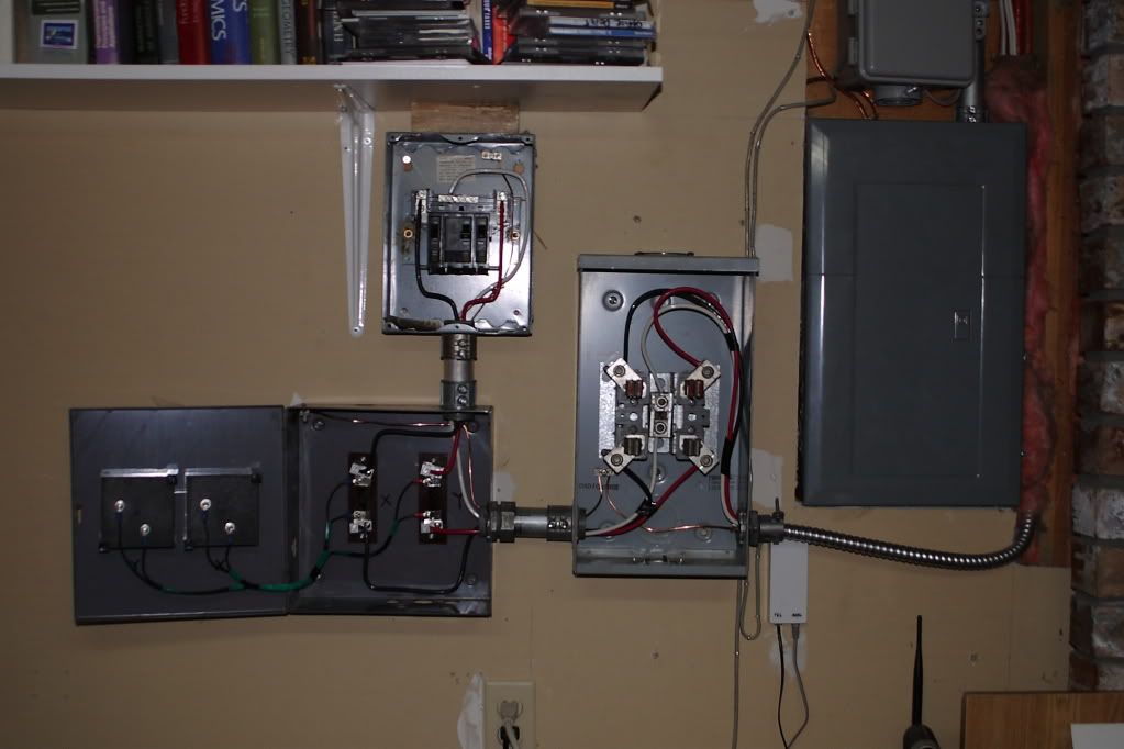

    For those who did not follow the other thread, I installed a 240V 40A branch panel in the house and for monitoring purposes I also installed a standard 200A KWH meter and two 50A 75mv shunt driven ammeters.
    For testing I'm using a 120v 1500w space heater which according to the formula should mean a 12.5A load. The problem is that the (appropriate) ammeter isn't reading anything at all. Even adding a 1200w toaster oven didn't budge the needle. I ended up having to drag out a vacuum cleaner to see the needle nudge up one amp during startup.
    Not sure if the shunt configuration is not correct or I'm not properly load testing the system. With the racks and home theatere not yet installed I don't have half a dozen servers to load the system. Only random appliances around the house.

    Are the shunts made for the Amp-meter? Do you have the spec for the Amp meter that should tell you what kind/value of shunts can be used with the meter. 75mV @50A is not even enough to bias on the Diode. Spec of the meters?

      Specs for the ammeters said that they required the use of 50A 75mv shunts which had to be ordered separately but only cost a few dollars more.
      The ammeters came from here.
      The shunts came from here.

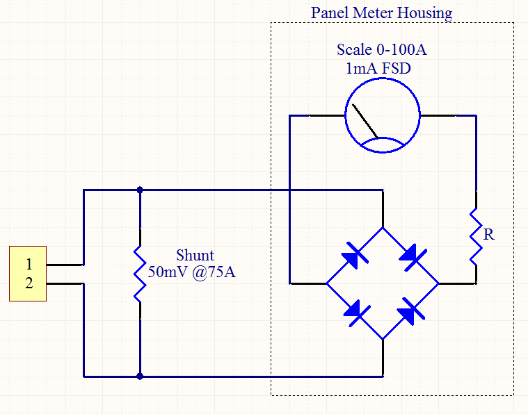

              mV shunts are for metering DC current, or AC current if you have electronics (op-amps) to rectify.
              The panel meters need a current transformer with burden resistor, feeding them. CT's can generate several volts since they are constant-current devices and this overcomes the voltage drop in the panel meter's (internal) diode rectifier.
              I drew a schematic of what possibly is going on. In simple terms, I would go with CT's.

                      At only 75mV full scale at 50A, that is not enough to bias on the rectifier diode (Typical Diode has Vf of about .6V (600mV), you need at least 1.2V to turn on two Diodes in bridge rectifier. You are better off using CT setup.
                      I do not see how they can be selling the meter like that to be used with 75mV/50A shunt without active electronics to drive the meter. I still like tosee what happen if you feed the meter with signal generator to find out what the sensitivity is.

                                        Re: Ammeter Setup not Behaving
                                        I did some research, because when I worked in substations there are dozens of these meters and I never really paid attention to them... except when they read zero and it all hits the fan...
                                        The seller has an AC panel meter mixed with a DC shunt- together they will not work.
                                        The panel meter is a typical DIN 96mm used in the electrical utility industry, which has many standards to keep things compatible, so real specs (ohms, volts, amps) you will not find.
                                        From your pic, the symbols on the faceplate bottom left tell you the beast is: Moving Iron type, Accuracy Class 1.5 to DIN43780, vertical mount, dielectric strength 2.5kV AC
                                        Moving-iron meters work with AC or DC and I'm wrong about it needing rectifier diodes (moving coil meters need these)
                                        The standard to drive these is a 5A CT, although some meters are for 1A CT's. I'm not sure, your meter looks like a 50A scale one with overload room to 100A. I would try hook it up to a (split-core) 50/5A CT. In other words 50A gives 5A to the meter. A 100A CT with two turns feeding it, could also work.
                                        I'm not sure about the burden resistor. If it's in the meter, then no prob. - but without it it is easy to peg the meter playing around. Take an ohmeter reading on the meter (sans shunt), figure what makes it read full scale if you can.
