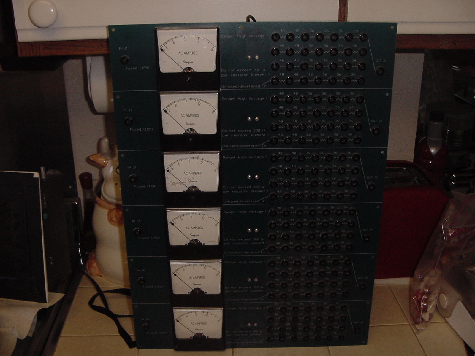

Ammeter Setup not Behaving
    Re: Ammeter Setup not Behaving
    Yeah, my meter is scaled up to 50A with overload to 100. If you recommend a 50/5A CT those are pretty easy to secure on ebay for about $15 each thankfully.
    As for the resistor I poked at the meter terminals (with the shunt disconnected) and a readong of 0.5 ohms means there shouldn't be anything in there.
    I don't have anything variable enough in the house to peg the scale. My bench supply can deliver the voltage but only 3A max. Even if I turn off current limiting and even slightly turn up the voltage the current draw almost immediately pegs the output limit of the supply. I suspect too that this expects 5A.

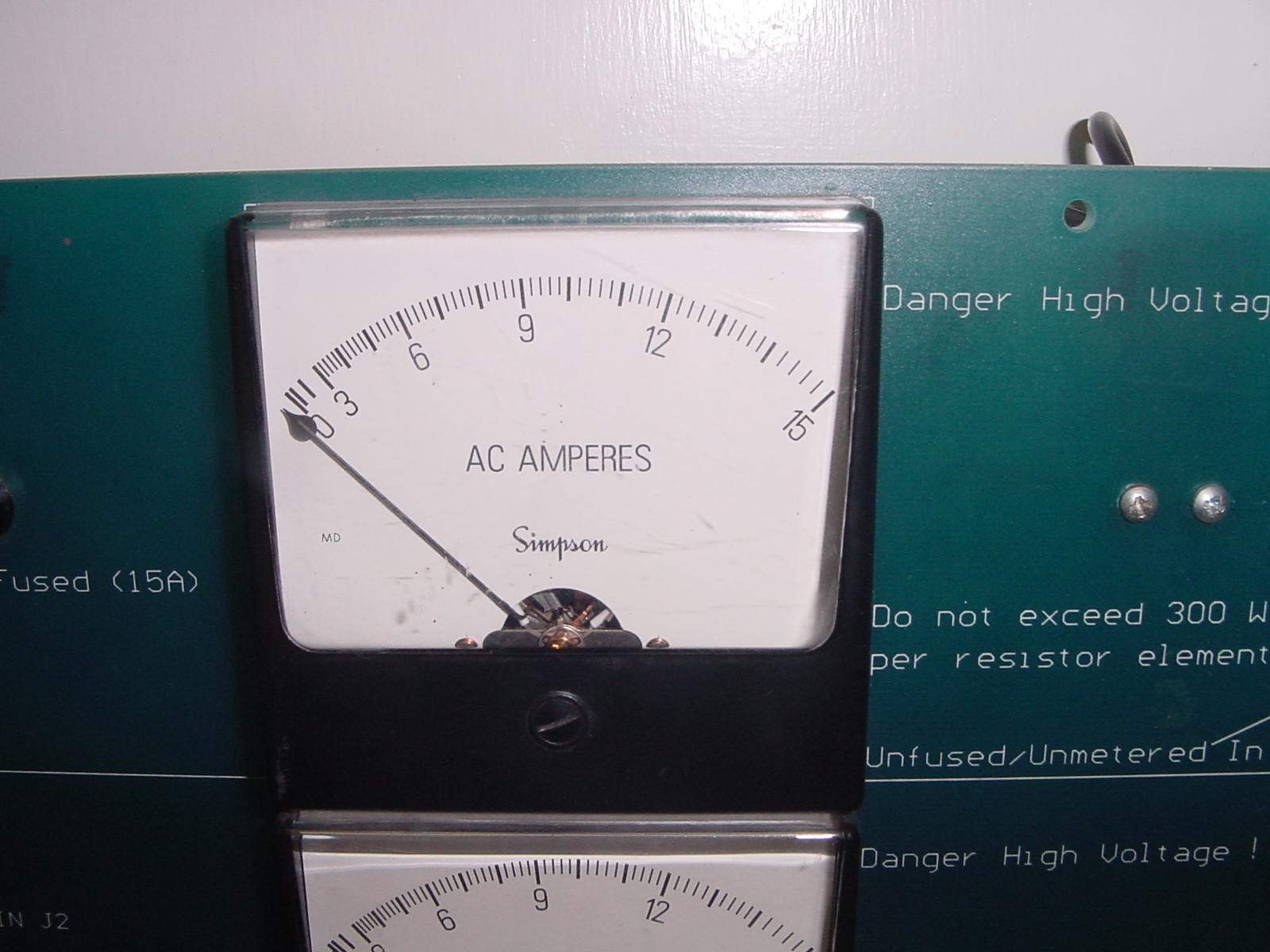

                Originally posted by redwire View Post
                From your pic, the symbols on the faceplate bottom left tell you the beast is: Moving Iron type, Accuracy Class 1.5 to DIN43780, vertical mount, dielectric strength 2.5kV AC
                Moving-iron meters work with AC or DC and I'm wrong about it needing rectifier diodes (moving coil meters need these)

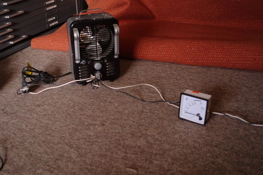

                                      When written science fails, you shut the hell up and try practical.
                                      Tore out the basic components and tested various arrangements on my living room floor. Resistive load used was that 1500 12.5A space heater.
                                      During testing I could not use my DMM as the ammeter setting only works for DC, so I had to stick with "how big are the sparks"
                                      TEST 1
                                      Line was passed through the CT with one wind around the core. Ammeter was then attached directly to secondary terminals on top.
                                      (Note that the single wind is the red wire. Supporting the terminals on either side is a bakelite bar)
                                      RESULT:
                                      There was very miniscule needle movement, but nowhere near where it should be (12.5A)
                                      TEST 2
                                      Line was wired with the ammeter in series to the load.
                                      RESULT:
                                      Expected amperage was correctly measured.
                                      Okay, so I then had a suspicious feeling that perhaps the miniscule needle movement was in fact a reading of 1.2A. To test this I made five turns of the line around the core. In theory this would give me a reading half of what it really was.
                                      The result:
                                      I was correct.
                                      In the confusion of Ammeters being sold on ebay, somewhere along the lines a decimal point moved or something and in reality the meter was expecting a current ten times higher than could be delivered.
                                      ....Or a CT that was a tenth of what I needed was purchased...
                                      Off the top of my head because it is not feasable to make ten turns of heavy gauge insulated wire around the CT, the only solution short of getting more sensitive meters would be to increase the number of winds inside the meter?
