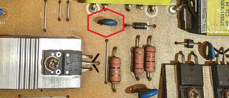

    shows us please yours equipment that you used by measure volts..
    and check this ceramic cap if its broken from leg or had any sign of broken at surface

      Capacitor C9149 looks sane on the aliexpress.
      Out of curiosity I've had a look at the original board, and this capacitor was not soldered. I've noticed a couple of differences between both boards :
      - original board had no C9149, no FB9904 and no C9922
      - aliexpress board has neither L9301 nor C9309. And two more components are missing on the rear side : Q9107 and U9901.
      I have no clue what these differences imply !

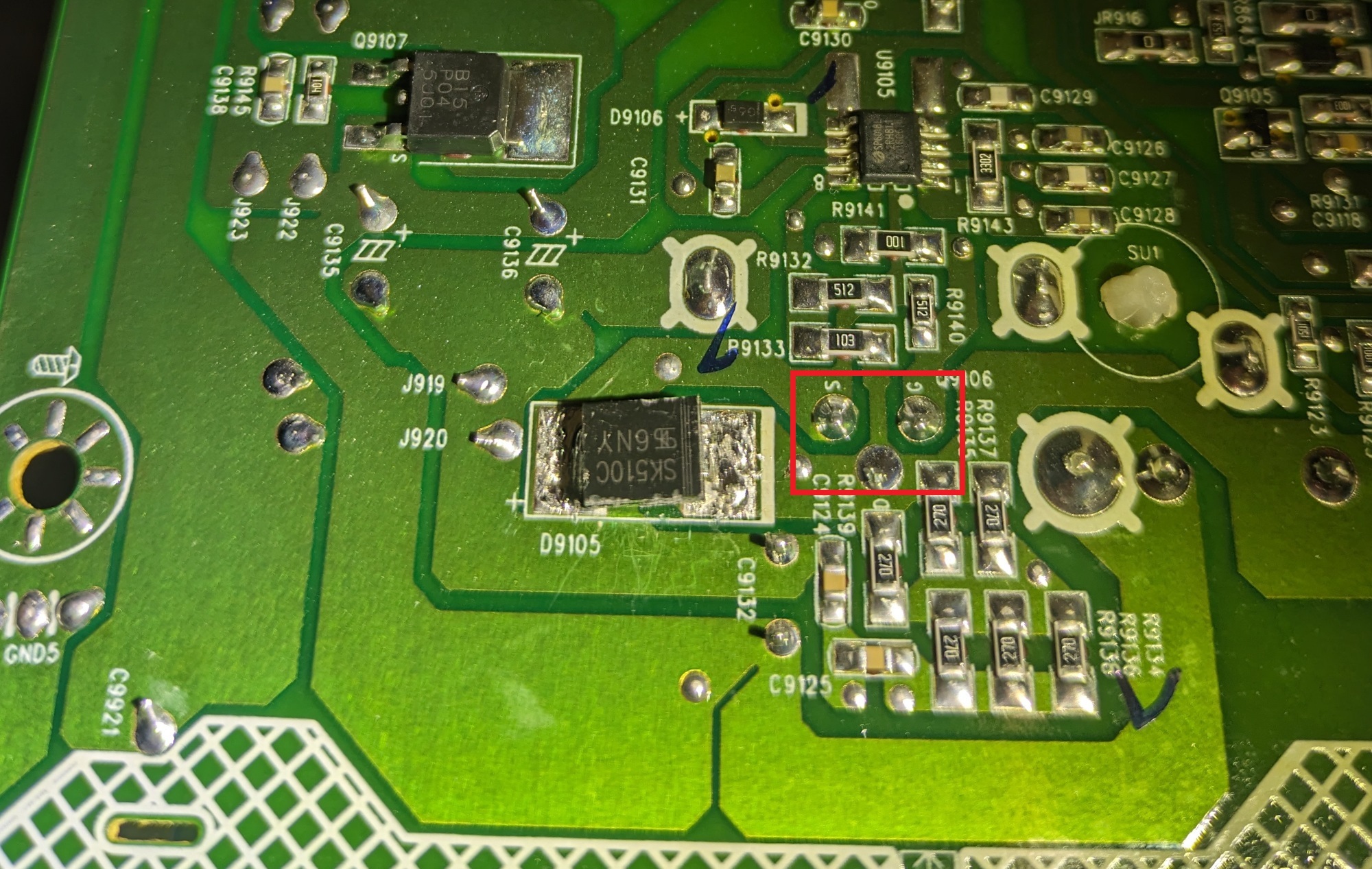

              You mean Q9106, which is a K22A10N1 mosfet (photo attached) ?
              I've soldered out (easier than the CMS diode) and tested as requested.
              I see no short between any of the gate, the source and the drain. Infinite resistance everywhere, even with the highest caliber on the multimeter.
              If I should order some units of this shottky, feel free to advise a brand / model. Then I'll just have to find a friend with the appropriate equiment (or try with my 30W iron).
              Thank you Diah !

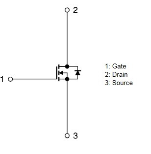

                measure it again to be sure i diode mode between source & drain.. it should read diode in one direction

                  [post edited, I've just got that a multimeter in diode mode displays volts and not ohms haha]
                  Ho yeah, right. I was in diode mode, but I didn't test both directions. Testing again I find infinite resistance everywhere except :
                  - red probe on source, black on drain : 0.9 volts drop voltage
                  - red probe on source, black on gate : 0.6 volts drop voltage
                  I've tested the nearby half-unsoldered shottky D9105 too, it shows 0 volts / 0 ohms in both directions. I guess there is no doubt that this one is dead.
                    yes replace it, its open... also be sure D9105 tested correct fine.

                      If the probes are swapped, what will it show?
                      • hervou
                        Hervé
                        • Apr 2024
                        • 11
                        • France
                        Ho maybe I wasn't clear enough. Probes swapped gives infinite resistance / OL on both.
                        • lotas
                          • Jan 2016
                          • 4595
                          • Russia
                          This means the Mosfet is working and there is no need to change it!
                          Replace the Schottky diode.

                              There is a diode installed inside the Mosfet, which shows the parameters of the diode.
