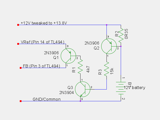

          Re: Using an SMPS to charge a car battery
          There will always be a drop but if designed properly you can do better than 6V drop. I'm thinking it's possible to do this current regulation in less than 1V...
          Here's a quick hack circuit, untested of course, to do the current regulation.
          Not sure if it will work but it just might...?
          This hack will basically tell the PWM to stop if it exceeds about 2 amperes into the battery.
          Advantage of this circuit versus LM350/LM317: Not quite as much loss. Most in the 0R35 resistor which needs to be a 2W unit.
          Disadvantage: Well, requires several internal mods to PSU.
          And problem with this circuit: The gain is way too high I think. I did not really consider gain and likely this will cause oscillations...
          This is wasting about 1.5 watts or so of power. Can do better than this... but this is a fairly easy hack.
            Are you talking about the directly influencing the feedback to the primary side PWM chip?
            How would you go about hacking the 12 volt rail up to 14/15V... I spose you could rewire the secondary side of the SMPS transformer to join one of the 12V rails and one of the 5V rails... then use a schottky diodes / voltage regulator / filter caps of the appropriate ratings.. Of course the feedback would then cause the SMPS to shut down... Maybe you could toy with the preset on the feedback circuit?
              This circuit is affecting the feedback circuitry. Since the TL494 is on the secondary side, there's no dangerous voltage path to ground, but if you get it wrong it could self destruct like a lot of other things
              As for the voltage, toy with the feedback circuitry of course! There's usually a pot somewhere you can change the voltage output. After increasing the voltage to 14 volts or so, add this circuit and you're limited to 2A to charge up to about 13+ volts (which isn't fully charged). Then you're just charging slowly through the resistor which is fine too...
                  All the TL494/KA7500's I've seen on ATX PSUs are sitting on the secondary side, completely isolated from the mains/primary side. It uses a transformer which I call a "ticker" that "tickles" the two main transistors on the primary side half bridge. This is different than the UC3842/UC3844 based supplies which sit on primary...
                  Not to say there are other ways to build this... but I've seen a lot of supplies like the Antec SP400 that did it this way, along with a whole bunch of other PSUs that I've dissected.
                        There are a bunch of schematics around that you can look at to see how the two transistors in the tl494 are typically driving two other external transisistors (usually 500mW transistors, or even 2sc945's - not that big) that do the transformer (for isolation) - and the other side of the transformer connects to the bases of the transistor half bridge.
                        Granted it's a lot of work to get a SMPS to charge a battery, but it's much more power efficient and smaller/lighter You could reduce R2 some more and get more current before it limits current too... Change that resistor to about .1 ohms and get around 7 amps to the battery (though the resistor would dissipate 5W).
                        Need to use an op amp circuit to get rid of that efficiency problem of that current limit sense resistor...
                          Some years ago I modified an old AT power supply to charge a car battery @ 5A.
                          Modifications done: I put a current limit similar to eccerr0r's suggested schematic, with 0.1Ohm shunt resistor 5W
                          I moved the voltage sensing point to after that shunt resistor, and set it with a trimpot to 14.3V (bulk charge)
                          I added an small board that would set the voltage to 13.8V when the current decreases under a certain value (~0.4A if I recall good). It was made with the shunt, an operational amplifier (LM358) and a LM311 which changes the resistors of the feedback/reference divider.
