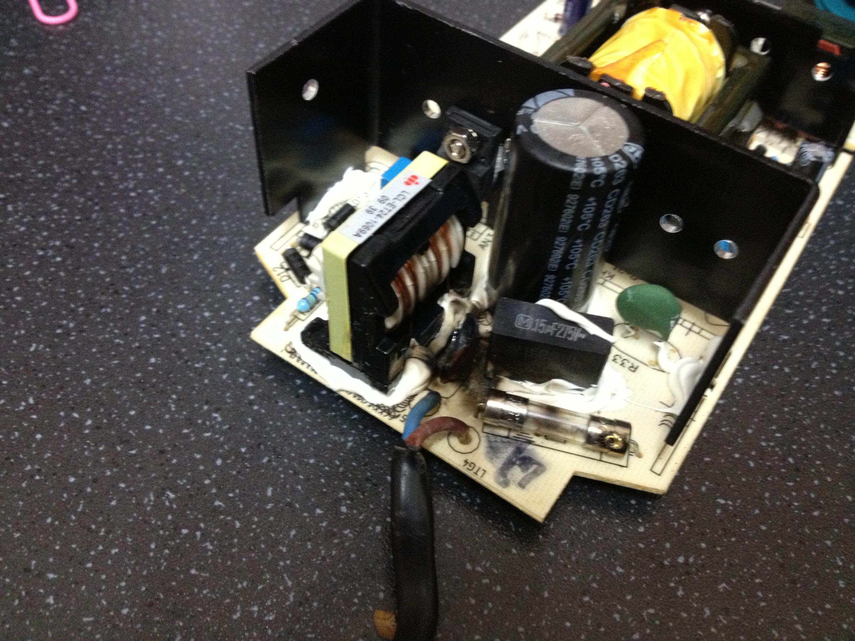

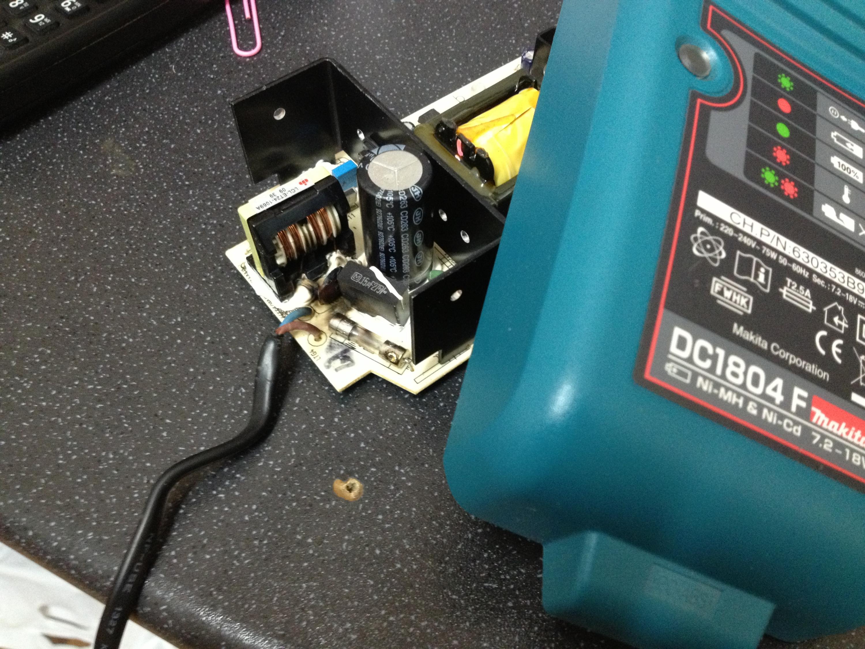

    Makkita cap id requird if anyone can help
    a friend of mine treid to charge his drill battery from a generator his charger went bang its a Makkita DC1804 f Battery charger blown a fuse and cap can anyone advise a replacement cap friom the photos
    thanks steve

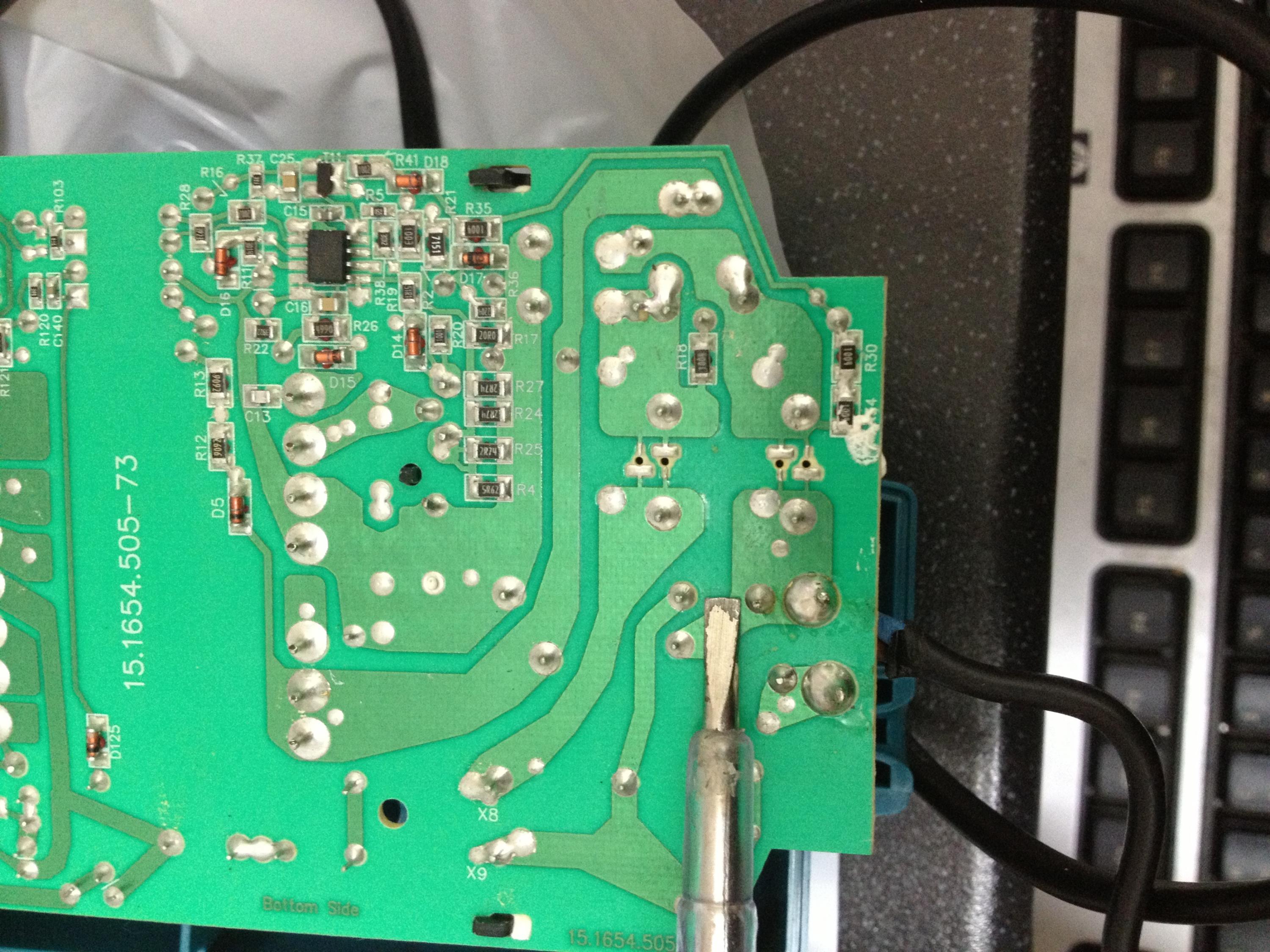

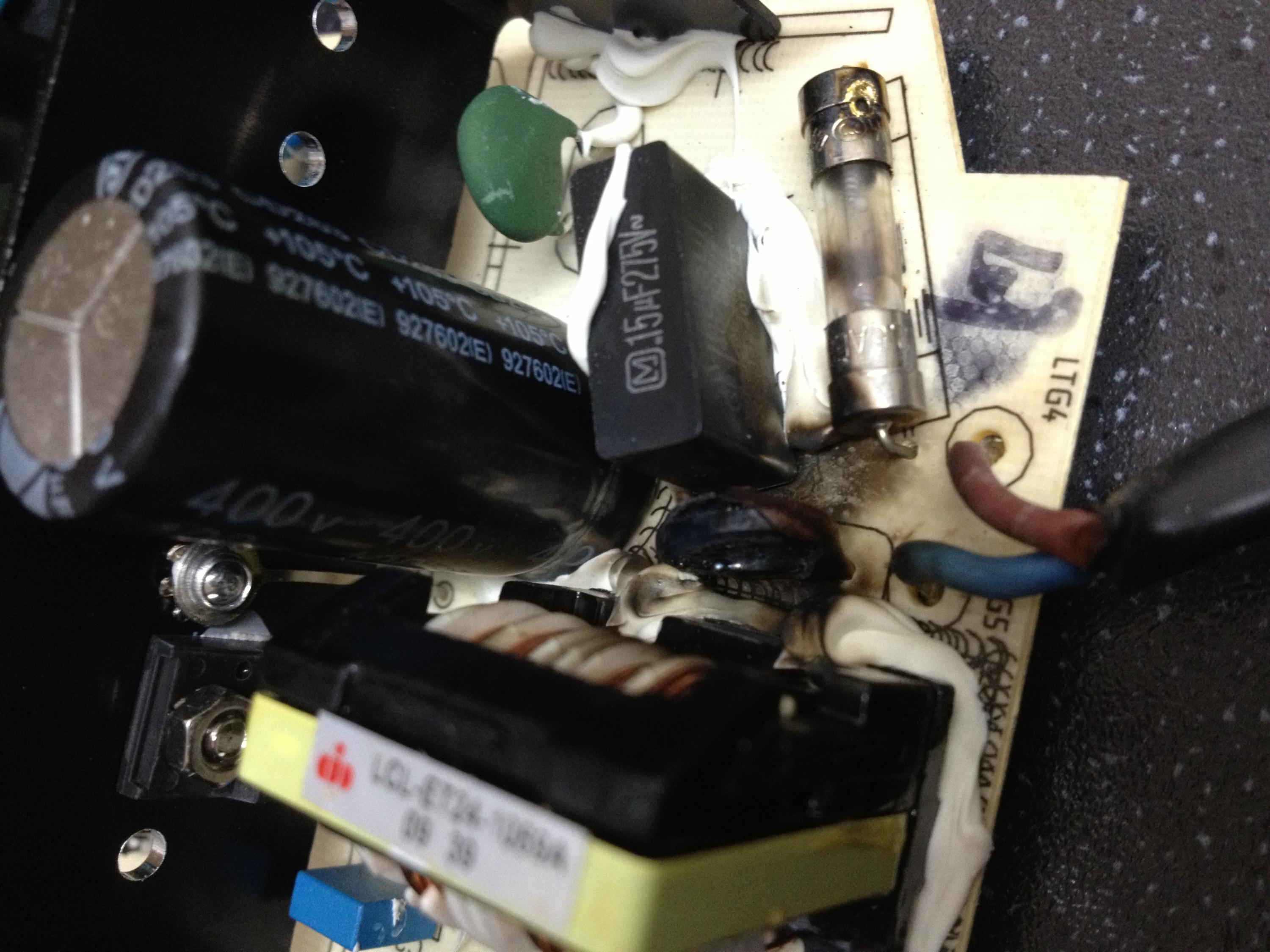

      I believe that is an MOV for surge protection, I need to see the bottom side of the board.

        Re: Makkita cap id requird if anyone can help
        changed links Sorry And uploader underside

            can you remove the items from the board The black box cap may have suffered as well.
            Clean them up with isopropyl alcohol there may still be some letters numbers visible on the mov

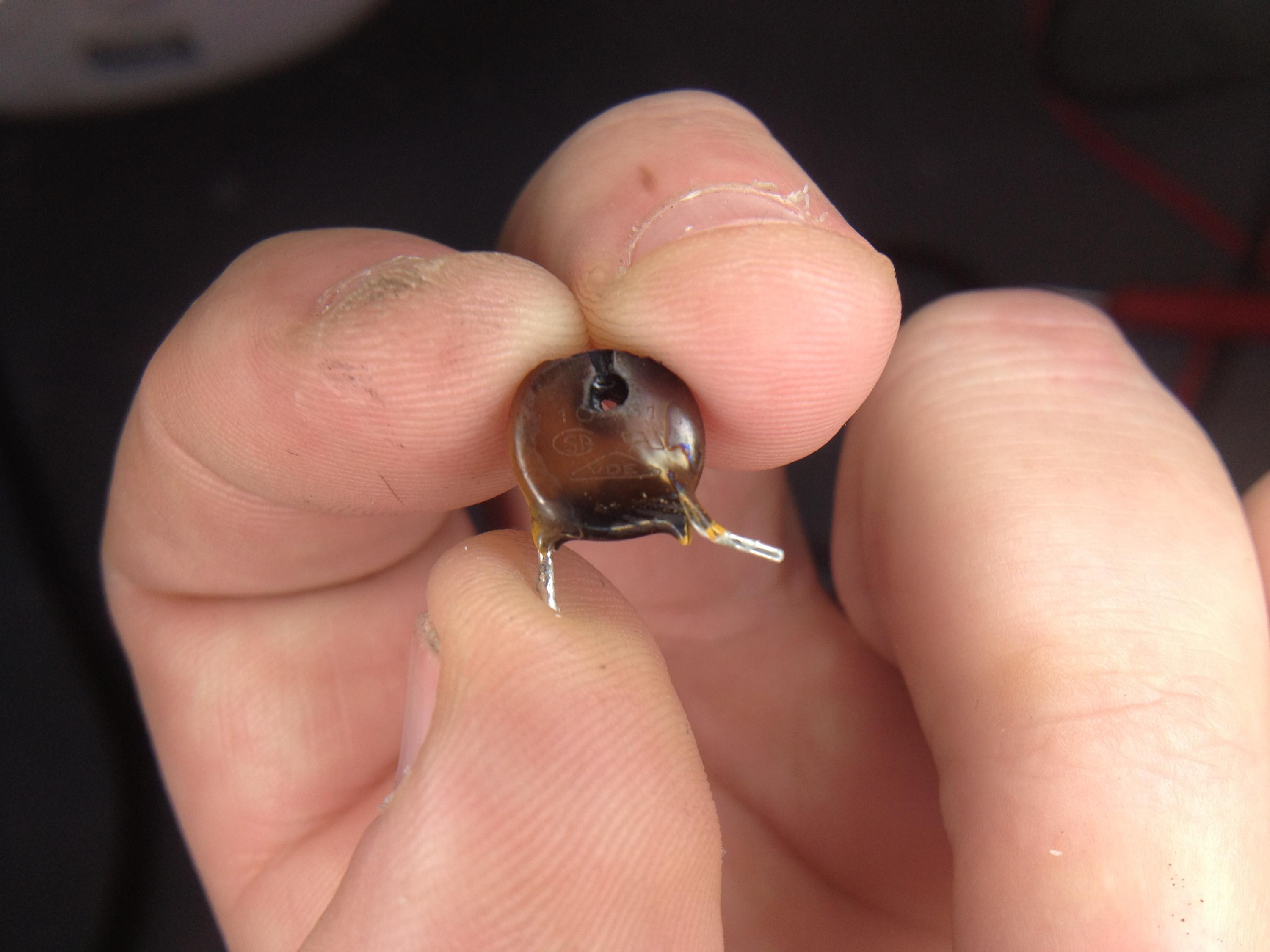

                cant see a lot on it damage to middle of numbers can see 10431 i think but very damaged

                  Hi yes it probably says 10D431K is it 1 cm across ie 10MM - 10D
                  This will give you the details is there a farnells near nottingham?
                  They are cheap to buy postage and packing and min order is the problem

                    yeah that looks about right is this the same thing
                    http://www.ebay.co.uk/itm/Metal-Oxid...item1c1ce98200
                    if so i will order that cos notts is a 45 min drive from here

                          Yes -good spot- missed that when I was googling - skipped straight past it to some info further down. I cant of course guarantee that is what it did say on the burnt one but seems a reasonable guess if it is 10mm across.

                              275V MOV: 10mm Diameter, D is the MOV series, 431 = 275V R.M.S is the rated voltage, selldoor got the correct spec.
                              That generator must have gone up to 500VAC or more to blow that MOV. We had our problem with people using our product with cheaply made generator with poor regulator, I always suggest them to put 100W lamp at the outlet to give it the light load and it is also used as an indicator since most people will not have Volt meter to check the output.
