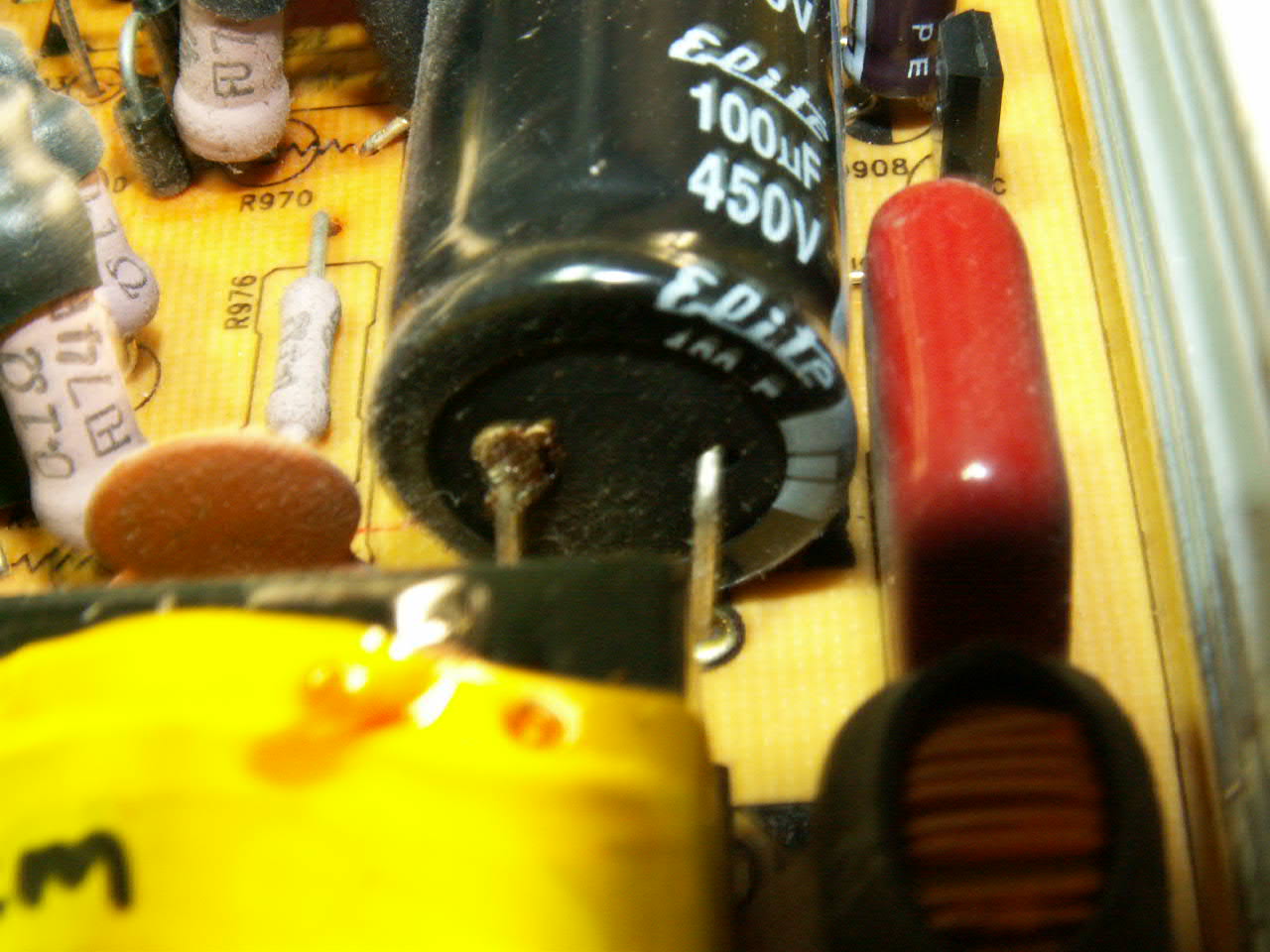

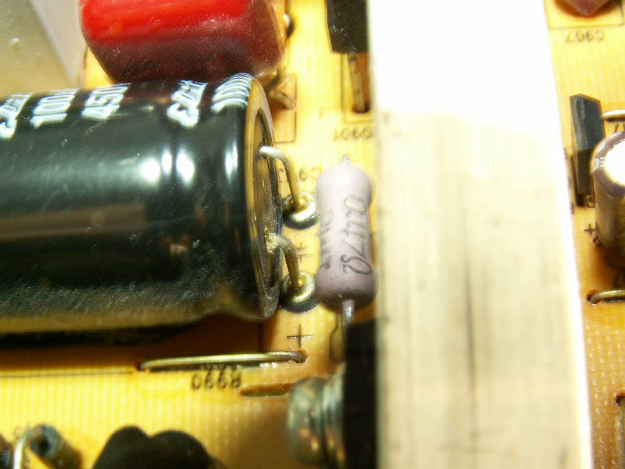

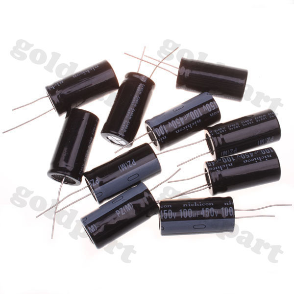

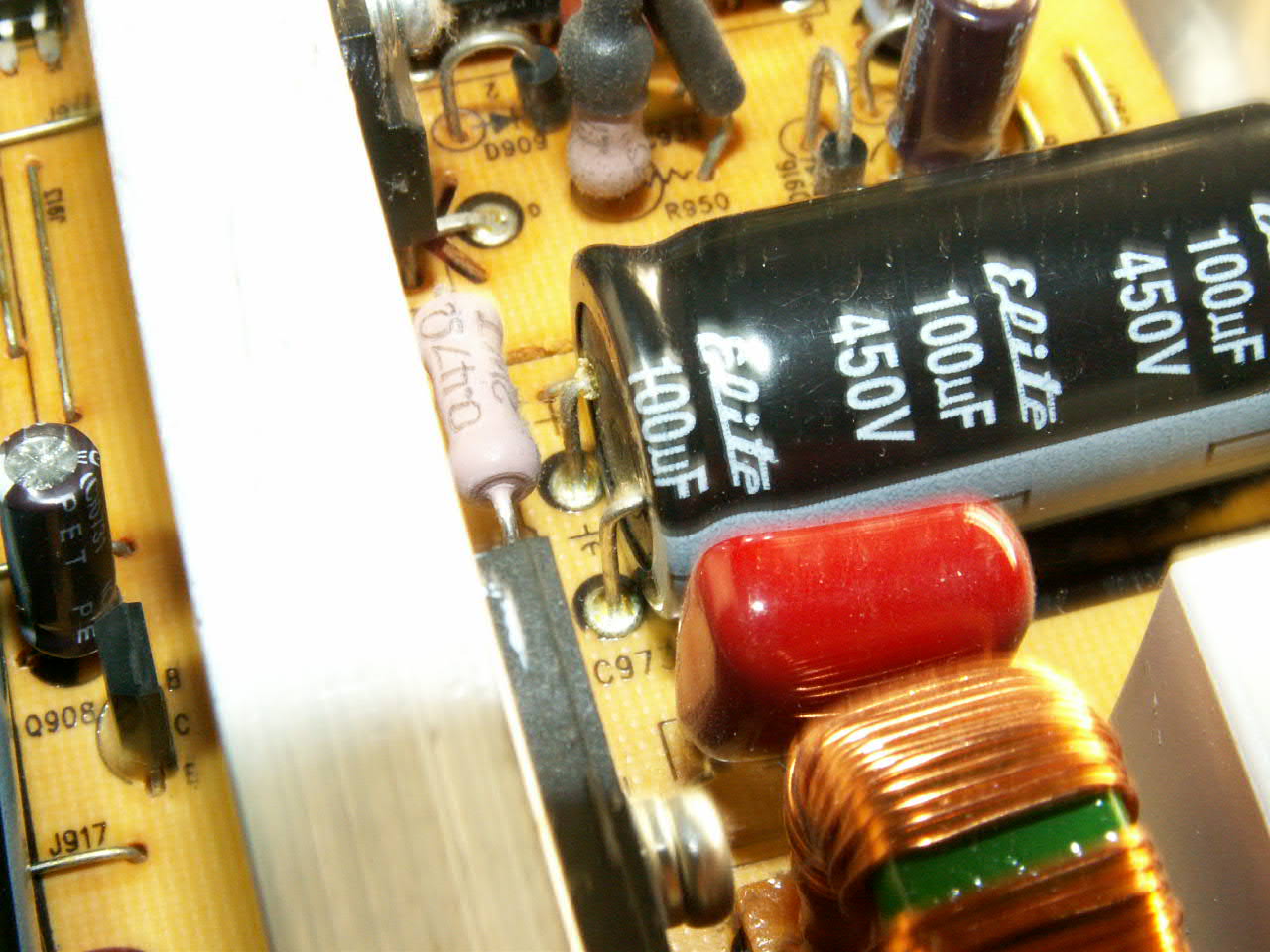

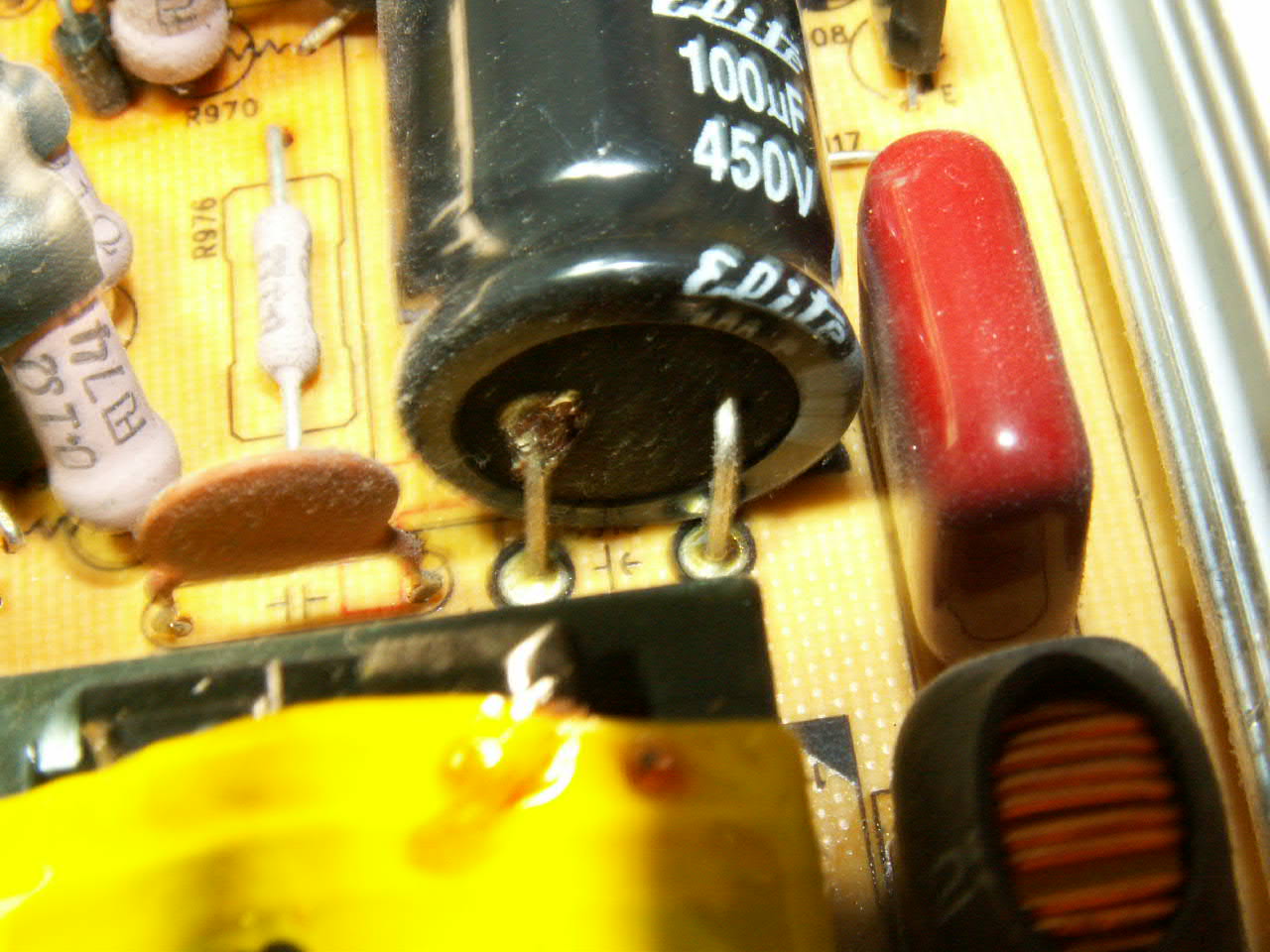

    Good day; I have run across my first bad 450V @ 100uF capacitors on a RCA L32WD22; I think. See Pictures. I tried to buy 2 from a local supplier here in Ontario; but he wanted my first born and some body parts for them. Checked online; first at Bad Caps, but it is not available here. Looked on eBay and found these (See picture.); Nichicon 450V @ 100uF Display Capacitors; “PZ” series. The problem here is I cannot find them on the Digi-Key site for info. The question is; are they suitable for using in the repair of a monitor power supply board?
    Thank you.

    Those are fake. It's plainly apparent from the picture. Don't buy them.
    Don't worry about the spec for big filter caps. If it fits, it's good.
    If you're buying the rest of the capacitors for the PSU from Digikey, you may as well buy the main filter cap from them. Make sure the diameter is ok.
      Re: 450V @ 100uF capacitors on eBay
      It does not have 100/450V
      https://cdn.badcaps-static.com/pdfs/...e0d99cc53e.pdf
      Just type in 100uf 450V in the search box @Digikey, then you can choose NICHICON, RUBICON, just measure the dimension of the original cap.
      This cap is not exposed to high switching frequency so it is not as critical as the ones used in the secondary side, this cap only exposed to 120Hz (US), or 50Hz (Europe).

            Those are definitely fake.
            The bung really gives it away, and also if you notice the plastic wrapper of the capacitor is not as smooth as real nichicons - its very distorted.
              Looked like dents in the can.
              so obvious i can spot the fakes on the droid here.
                Its hard to tell. Sometimes they are dents from improper handling, and sometimes (more common on cheapies) the plastic wrapper isn't shrunk right.
