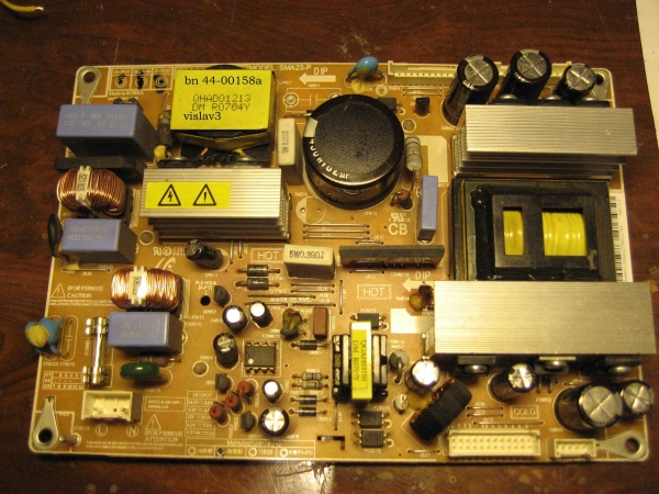

    hi guys,trying to find the wattage of a resisor,this one is a 0.22 ohm 10% (color bands ,red,red,silver,silver),no schematic so unsure of wattage size,power board is bn44-00158a ,resistor location on board is,rm801,from samsung 23"lcd tv,resistor is coming off the positive from main filter cap,(82uf 450v),cheers

      That is more likely to be the resistor for the Source pin of the MOSFET, typicaly will be 1Watt (you can use 2 watts if you have the room) Flame proof metal oxide resistor. Verify if it is connected to the Source pin of the MOSFET. if itis connected to the + leg of the 82uf/450Vdc cap, then it may be used as fusible resistor for the B+ LINE, then it will be 1/2w or so.
      Any pictures of the board and the resistor?

          my camera is crap,but found the image on google,resistor is just to the right of main filter cap,this supply is pain in the ass,just wont fire and give the main board its 12v,changed pwm,also the usualy problematic f9222l ,output caps,this resistor is showing 0.00 ohms or short, when it should be 0.22 ohm,so not sure !,only thing havent checked yet is the switching buck regulator,but there aint any voltage getting to it anyway,all mosfets,diodes check good,only voltage outputting is the 5v stb,discconecting the main board or others makes no difference,the supply will hiss then click,hiss then click etc,this sound is coming from the pwm (viper 12a),its getting a stable 22v,other checkpoints when measuring voltage,on the diode side of optocouplers ,the voltage is up in down tallying with the noise from the pwm,bloody stumped me this one!,no dry joints either,all high voltage caps checked,and insulation tested up to 1000v,it cant be the main board beacause it should need more than the 5 odd volts that its getting to work properly!,no 12v

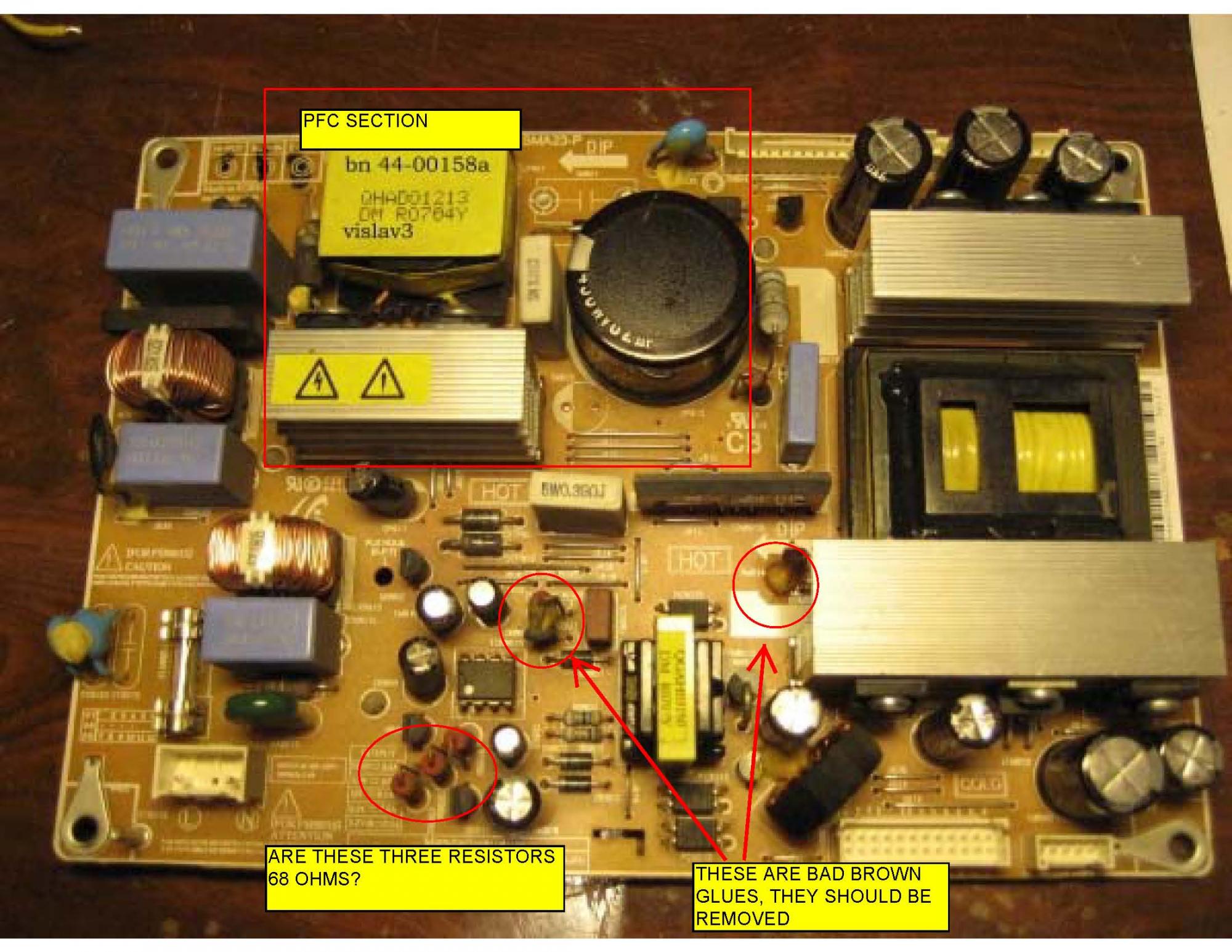

                        something i have noticed,is when the main board is connected the ps-on voltage jumps from 5.3v down to about 1.6v and this happens every 2 seconds,5.3v then low,5.3v then low etc, wether the tv is in standby or not makes no difference,also the touch sensor buttons on tv have no response,the remote works,when pressing the power on button,front tv led light goes off(think that is correct for samsungs).max voltage from psu is a measly .62v on the 12v,24v rails,ive tried powering the supply without main board ,with the ps-on jumperd,no voltages come up ,BUT the standby 5.3v is stable at 5.3v,main board attached ,up and down like a bluebottle with the shits!

                          Now I see, when you try to measure low resistance value, you hsould use the lowest scale to get better resolution, in this case, you should use 200 Ohm scale.
                          The main board is cycling on and off, I am sure that will not be the only signal that is doing that either. The 5VSTBY is always steady?
                          So far I cannot locate free download of the diagram for this power supply board yet.

                            the 5v stb is steady when the main board is detached,cycling when main board is connected,nearest ldo on the main connector into the main board is reading 5.3v,thats the highest voltage i can find on the mb when probing around,the main board must have to recieve a 12v signal for anything to work surely!,this is where im getting confusion as to if its the psu or mb at fault,normally i can get them to fire up on there own with no boards connected,apart from a dummy load,im really edging toward the main board,maybee its sharing its stb voltage to also tell the rest of the psu to start !??,but that would be a strange assumption beacause it must need more voltage than 5v!

                              The 12v and the 24v will not be on until the main board puts out steady PS_ON to keep the 12/24v on. The 5Vstby should be steady when the main board is connected, so what you can do is to load the 5Vstby output with 10 Ohm 5w resistor (this will cause the 5Vstby to suppy 1/2A of current through the resistor and it should be able to handle that OK (Toal power will be about 2.5Watts). There should be label some where on the board that tell you the output voltages and current of the outputs. I cannot see that well in the picture.

                                        This board looks familiar, please check those resistors, make sure they are not open. If I am correct, they should be 68 Ohms resistors.
