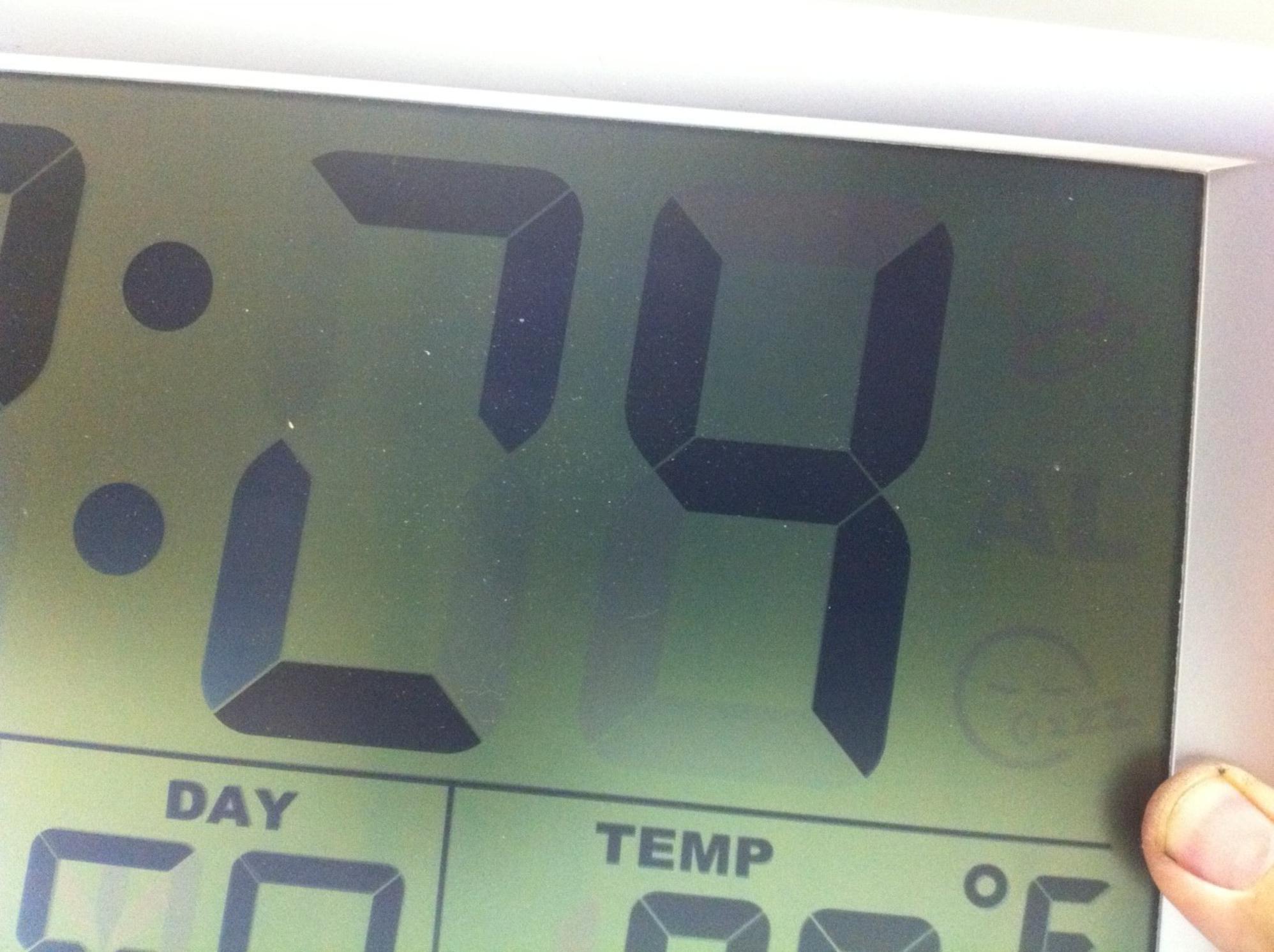

LCD Clock digit faded and partly missing
  • freakytiki4u
    Coolest Member
    • Aug 2009
    • 130
    Anyone know why this happens and how to fix it or where I may send the clock to be fixed? The #24 is what you see and part of the 2 is missing. Everything else works perfectly except that digit. New batteries are installed. Thank you sincerely for any reply and info

    Re: LCD Clock digit faded and partly missing
    I decided to just replace the clock but ty for looking
      Good decision, that is caused by bad ITO which cannot be easily fixed.
        or a fouled zebra strip.clean it and the display edge as well as the board contact area.
        i used an alcohol prep on a fluke 73 a while back.was missing segments and faded looking.looks new now.
