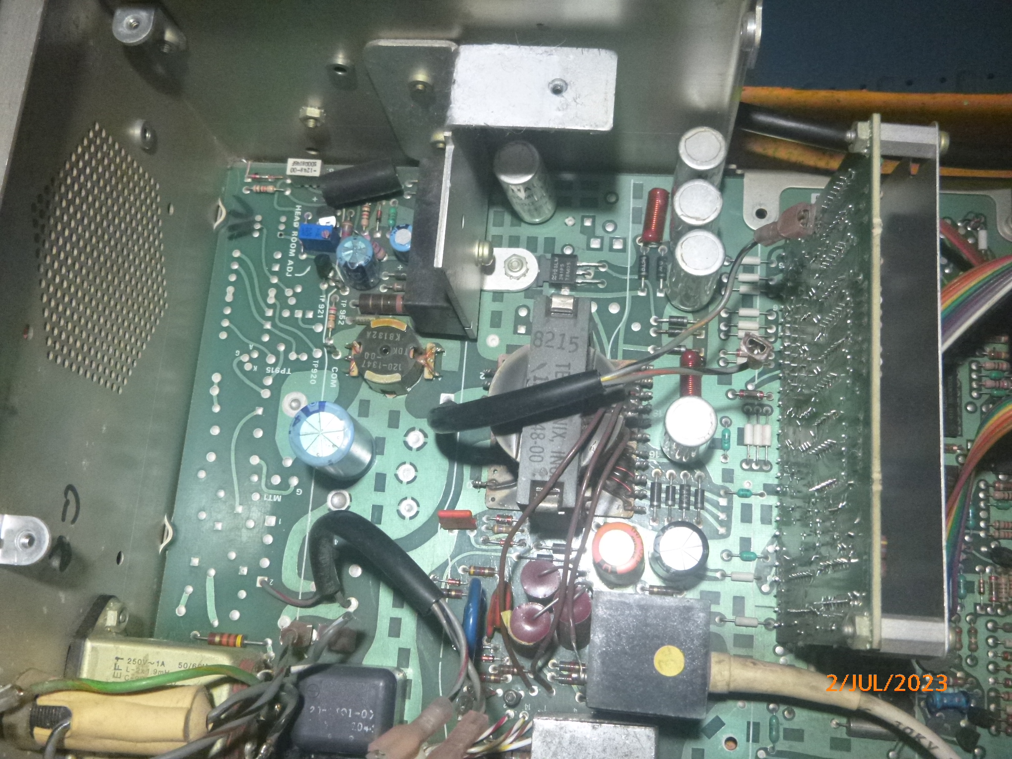

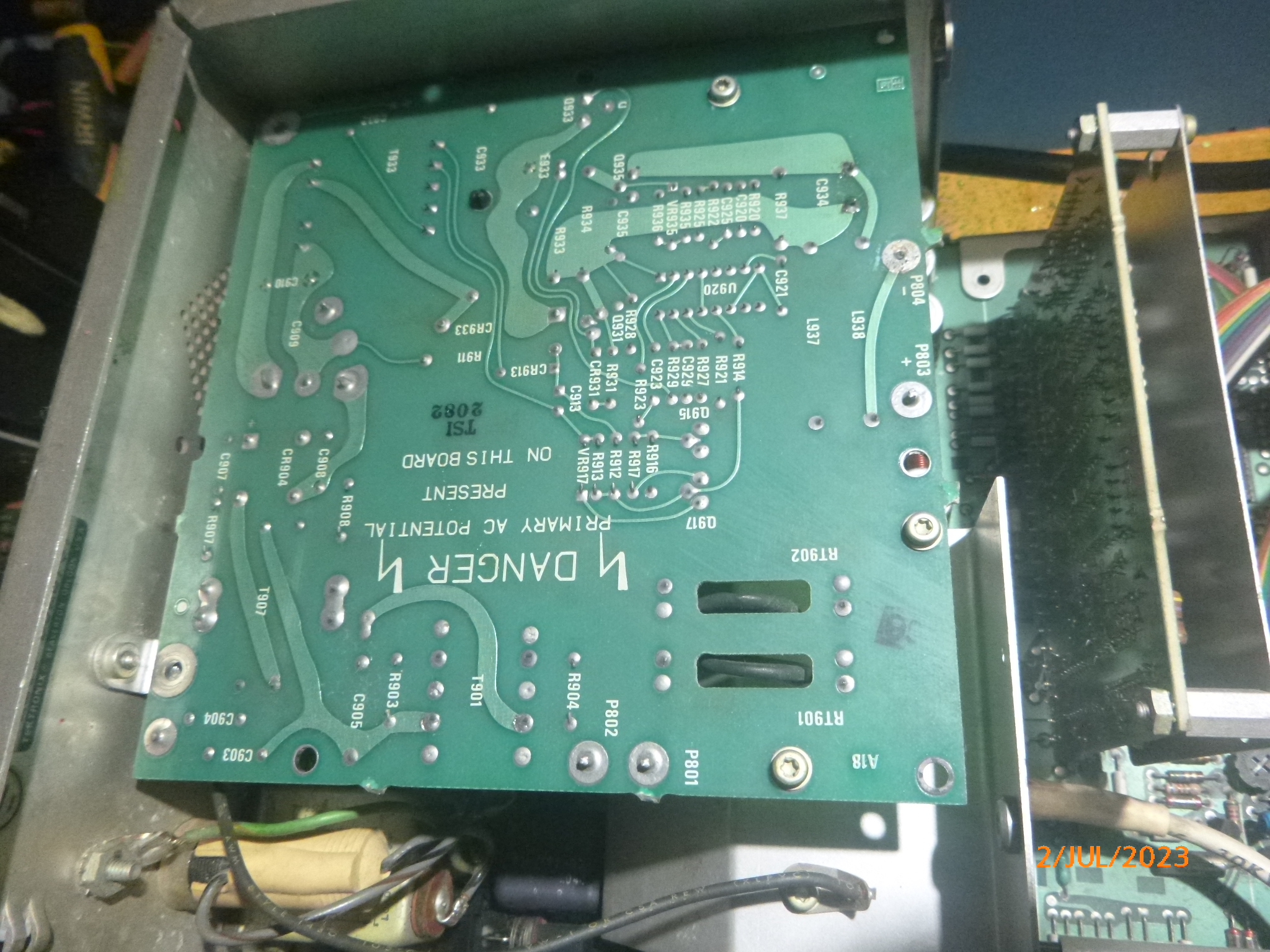

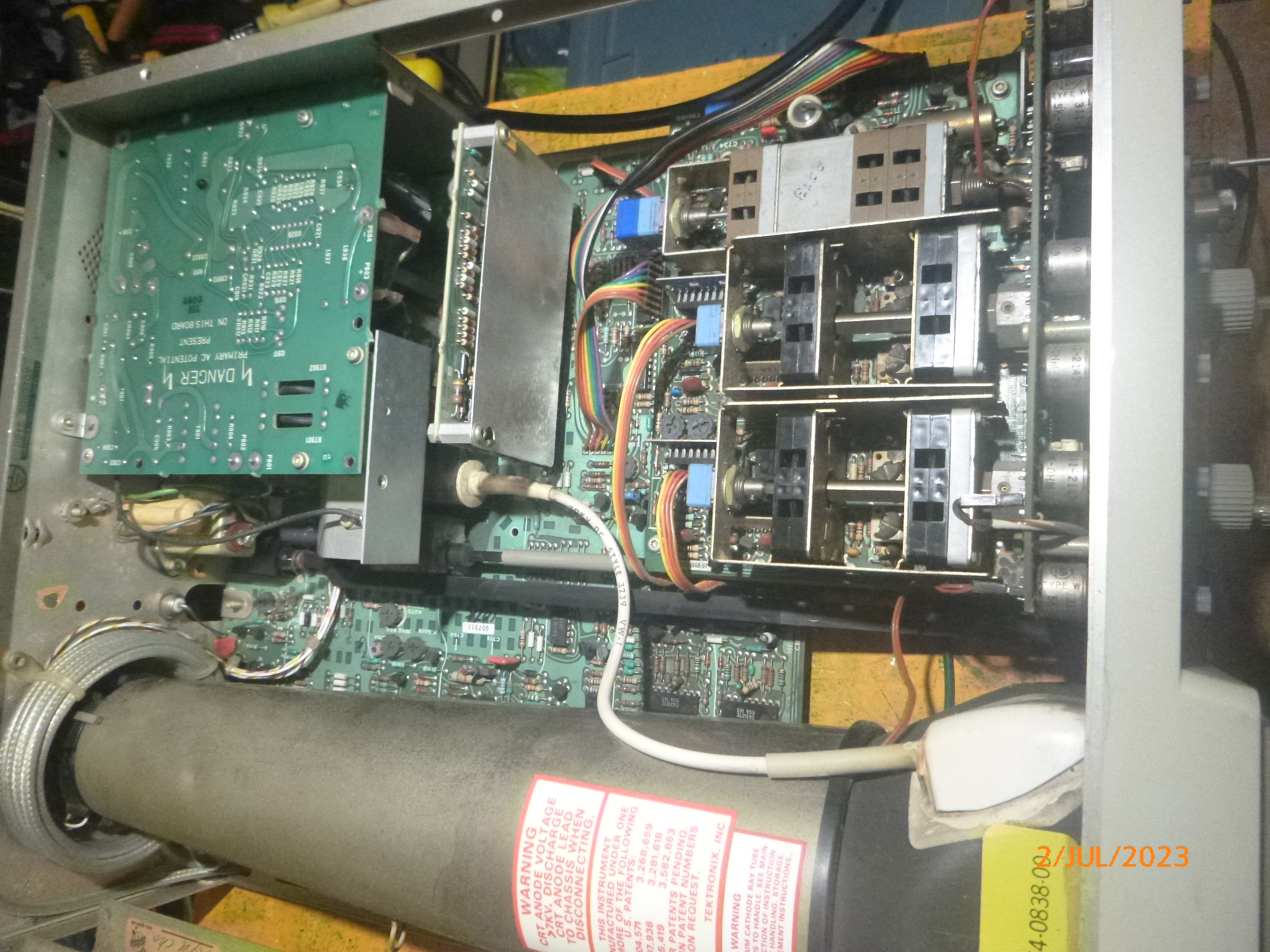

    There is this old Tektronix 2215 scope which has been laying around for some time, that I knew had some issue, but couldn't remember what...
    Anyways, last night, I thought I'd give it a look, as space is needed, so put it on the bench and plugged it in.
    The CRT had a terrible trace which only filled half the screen and didn't seem to respond much to any of the controls, so I decided to give it 15 minutes to warm up whilst I cleared up the bench a bit.
    After maybe ten minutes, I heard the dreaded 'pffft-pfssss-pop' followed by the most almighty amount of smoke!
    Even though I'd yanked the plug from the socket, there was so much smoke coming from the HV section, that I was expecting to see flames.. But no, just plumes of smoke.
    I mean, I have an impressive record of toasting electronic components but I honestly don't remember such a dramatic event without flames.
    As it sank in that that was a major fuck-up, I realised that at least the toasted component would indicate in which circuit the problem lay, so set about opening the HV section which is sandwiched between the main board and another smaller board which sits above.
    Anyway... the point is, there was nothing burnt!
    None of the caps had exploded, no resistor had roasted, no damage was done to any component or trace on either board. Not even the slightest scorch mark.

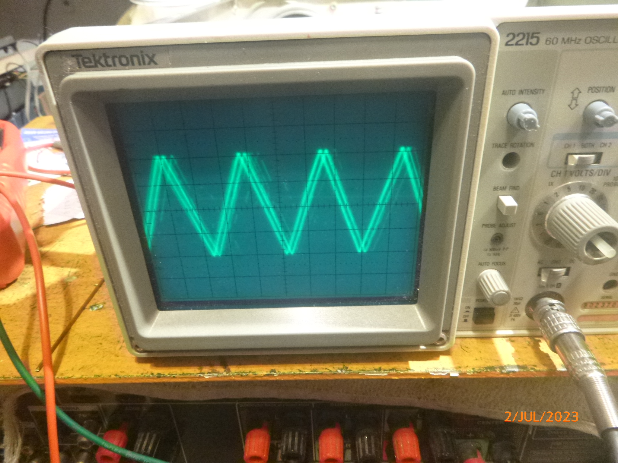

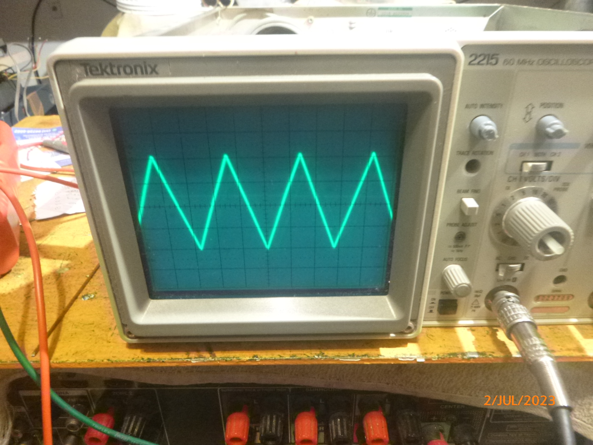

    Weirder still, is that now the scope (almost) works fine. The intensity and beam finder aren't quite right and the display judders and jiggles around, but the CRT now shows full waveforms.
    So what the fuck???
    What am I missing?

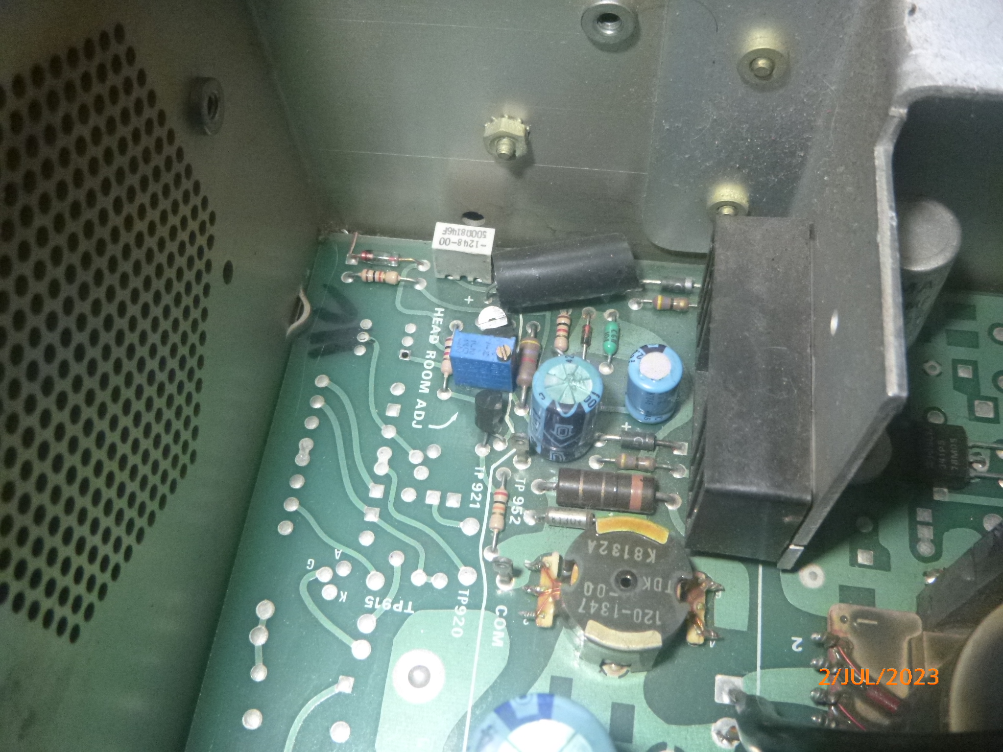

    Usually these are known for to do this kind of noise in the PSU filter section (X cap). Sounds like it and smokes like crazy too.
    • Per Hansson
      • Jul 2005
      • 5895
      • Sweden
      Re: RiddleMeThis - What smokes but doesn't burn?
      Probably one of the Rifa caps let out the smoke, they can be inside the mains filter too.

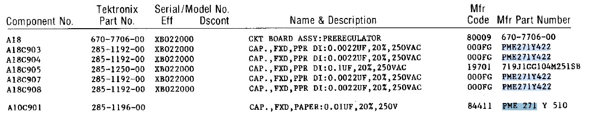

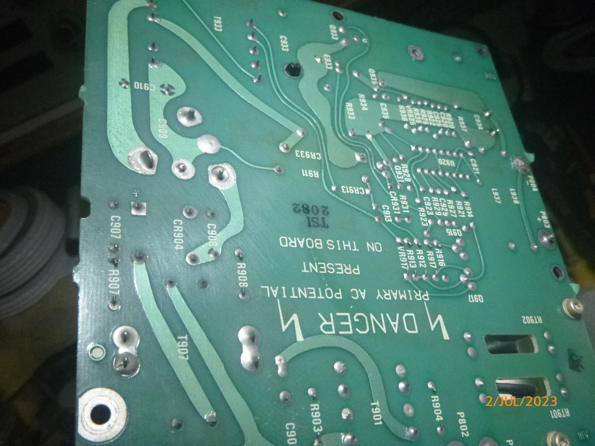

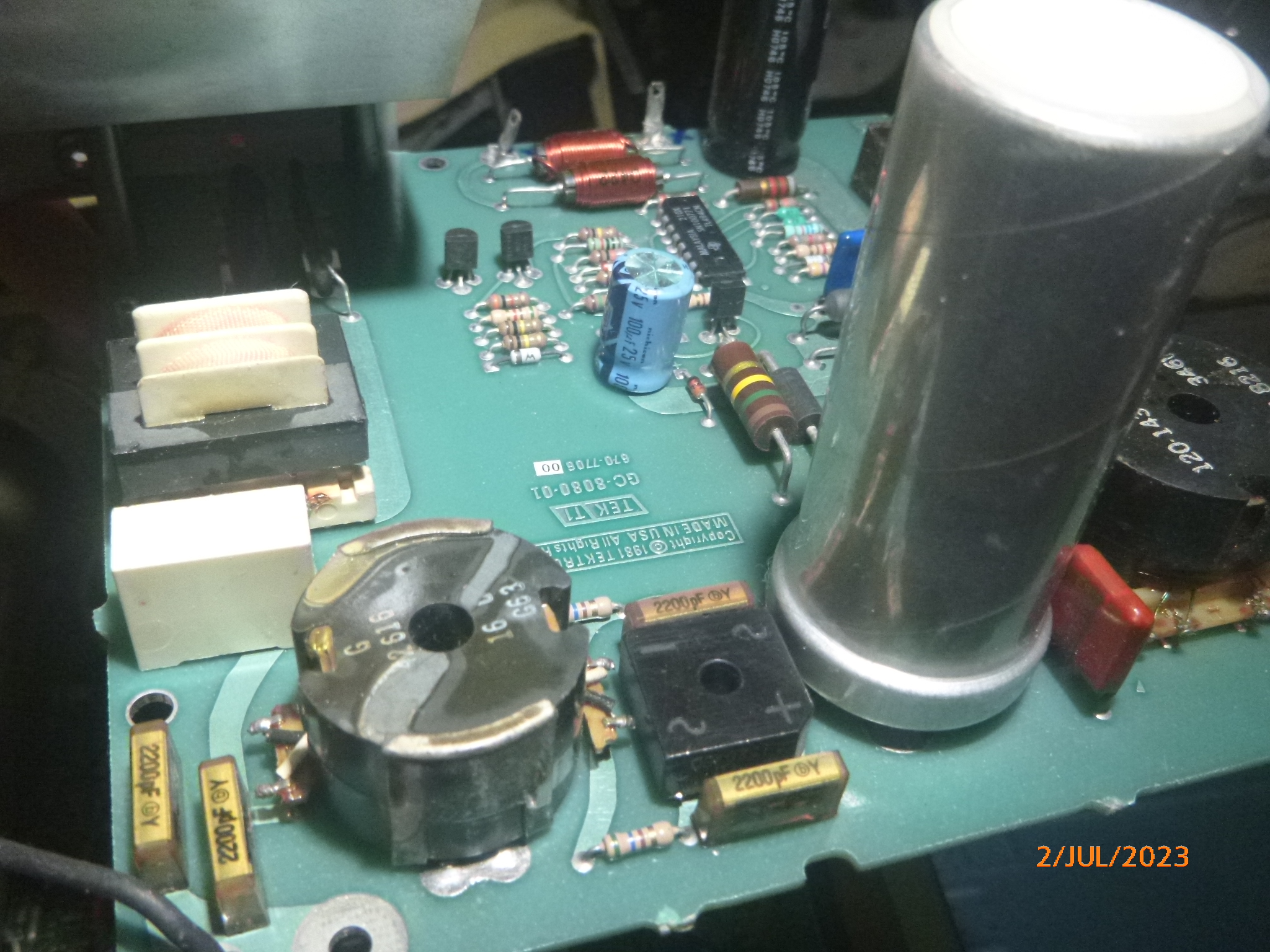

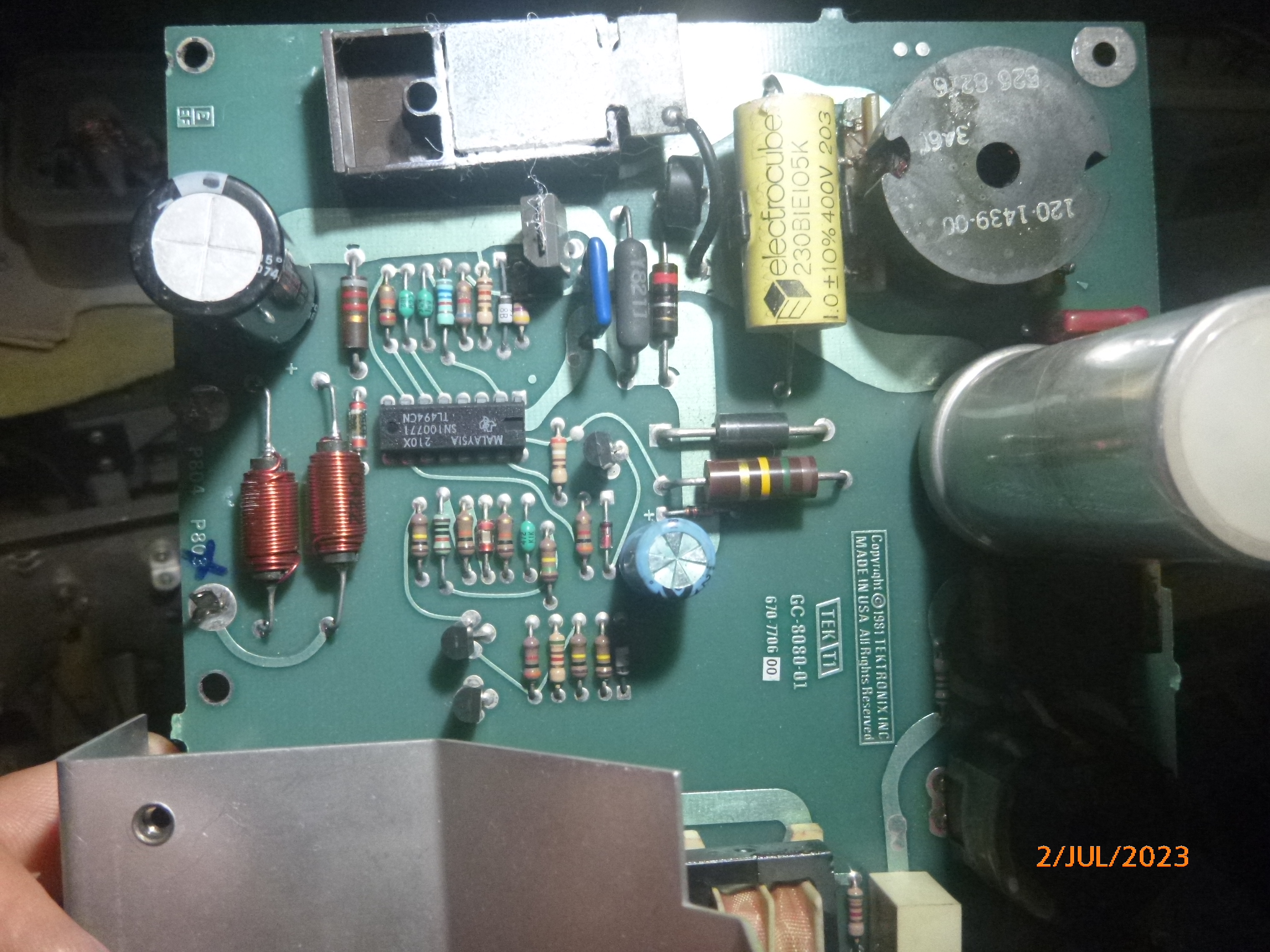

          C903 C904 C907 C908 are 250VAC 2200pF Rifa PME271 Y class safety caps on the preregulator board.
          C901 is a 250VAC 10000pF Rifa PME271 Y class safety cap located on the main PCB under the line filter.
          They are actually still in production, I have the same scope and used identical replacements in mine.
          Some people do frown on this because the way they fail, but I see it as they lasted 30 years so who am I to complain
          (They fail due to ingress of moisture, so it depends on how the unit was stored if it is a problem or not).
          Was it any of these that failed or was it actually the ones inside the line filter? (IEC receptacle)

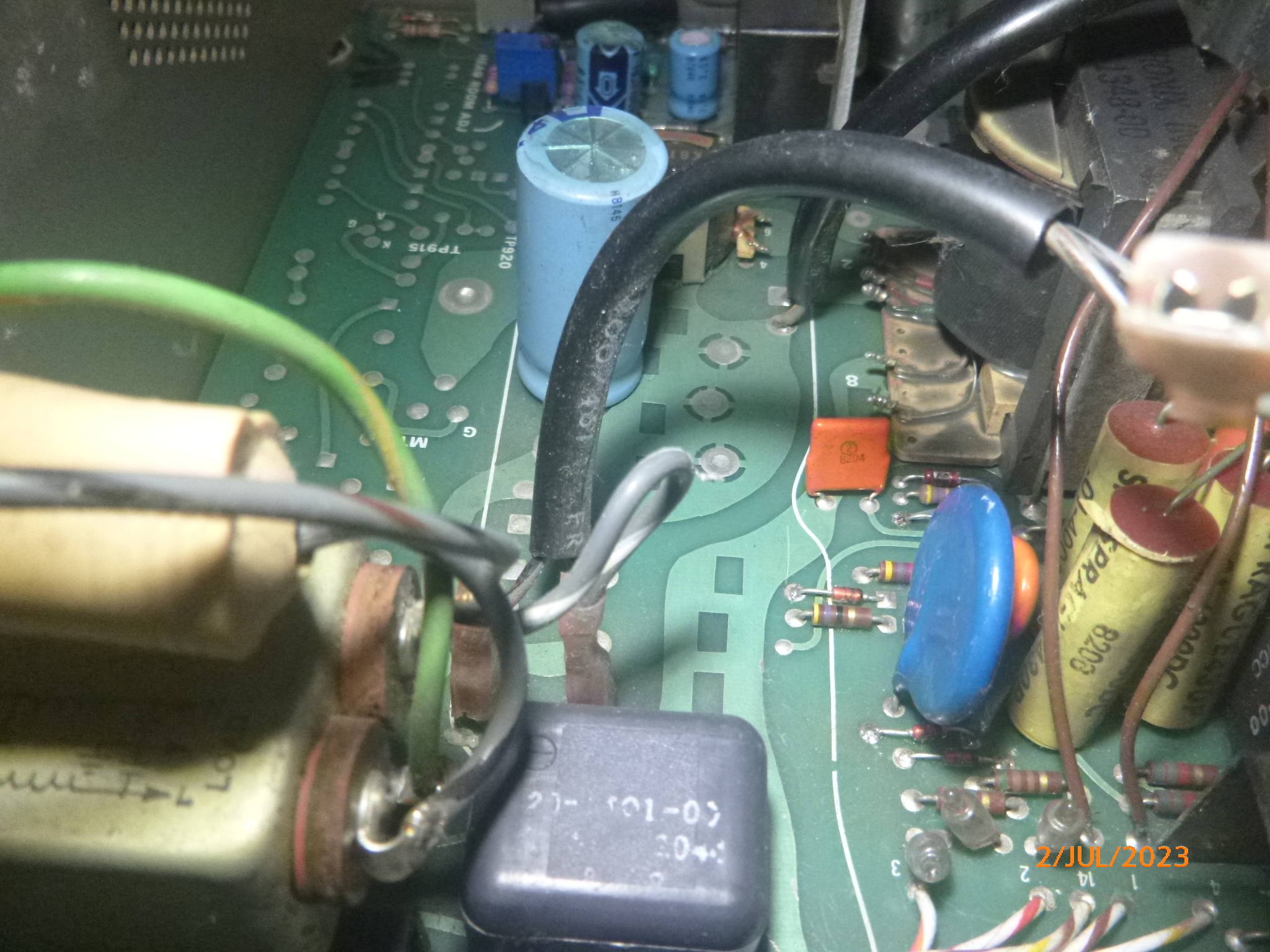

            For now, I have just swapped them out with polyesters and that seems to be ok. Getting original Rifa's here in Brazil is not cheap (+/- $10 ea).
            A much bigger hurdle right now is with what to replace the C628 matched set on the A12 Sweep board?
            One of them is a polarised 0.01uF and what appears to be electrolytic!
              You can replace them with any other safety rated Y capacitors.
              Do not change those capacitors, they are extremely reliable and as you see part of a matched set precision capacitors!

                  I found two out of the four on the power board had cracked. Only very finely.
                          I'll put them back in then, eh?

                            Yes, you will not find matched replacements for these capacitors.
                            There was a thread on eevblog about them a year or so ago with a better explanation than I can give but I can't find it again.
