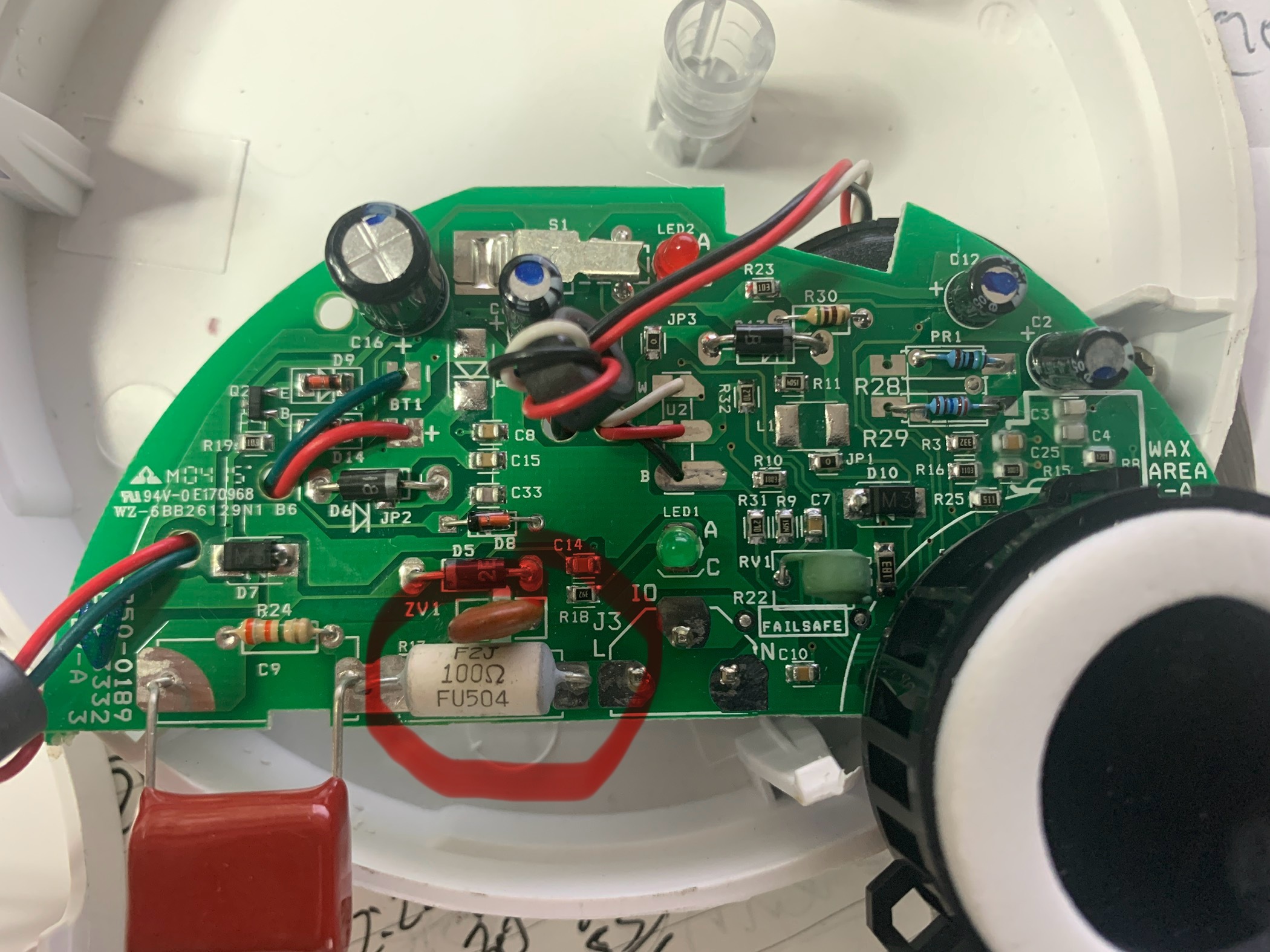

    Hi to all, I was diagnosing 2 smoke detectors that experienced power surge. I opened one up and found a weird fuse/resistor, which now has open circuit. I can't find this part.
    Forgot to mention they both light up and I believe the test function works, but when I put smoke to them no alarm!
    Any help in this regard would be greatly appreciated.
    Thanks,

    it's a fuseable resistor.
    what does ZV1 say on it and is it shorted?

      Thanks again, RV1 looks like another resistor, it has PK on it and has some measurement (I got a .524 kohms). If you look at the word FAILSAFE it looks like it is not installed with this particular smoke detector. Forgot to mention they both light up and I believe the test function works, but when I put smoke to them no alarm!
