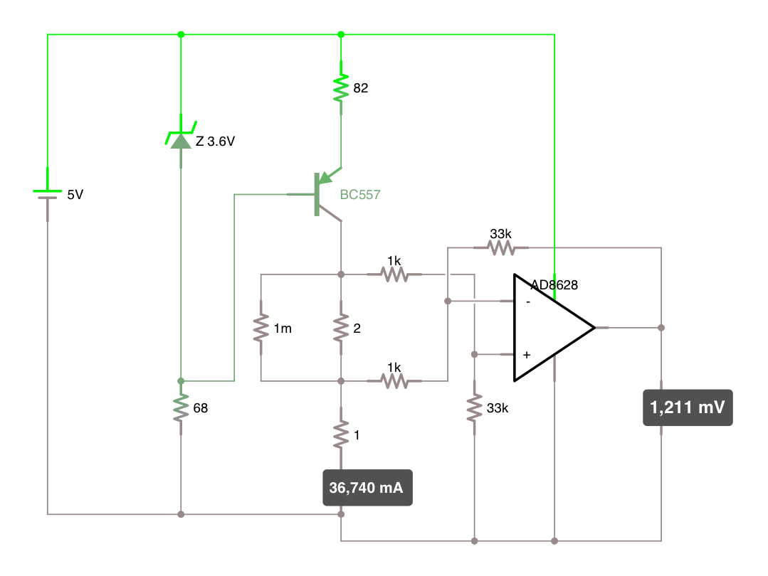

    I received the pcb some times ago. but there is a failure I did not find until now.
    I made some changes in the schematic, using a constant current source for better repetability,
    well I'm still investing. the voltage regulator is giving 2.4V instead of 5V
    ... and it does not seems to be a short circuit !
    Some more info about?
    I mean about voltage regulator.

        Re: New tool to find short capacitors on motherboards : shorty with display
        I added a voltage regulator 1755S to bypass the one inside the arduino. just thinking there would be a better regulation than the 1117. I also added a constant current source with the pnp transistor, to have better accuracy and better reproductibility of the measures.
        now I'm debugging this new schematic, it's almost working, but as a reminder it is a hobby project, and I have been very busy these last months.
          I was more about
          As I see 1755S is limited to 300mA
          Aprox 60mA via Q1 and resistors, 240mA for Arduino, oled and others.
            I checked on a lab power supply, the whole device is now using 50-60mA.
            the current constant source now is using 30mA.

              #86
              Some schematic will help a lot.
              Where did you get 2.4V instead of 5V with voltage regulator?
              Also
              Voltage drop C-E on BC557 at 100 mA is in datasheet 0.65V
              5V -Vdrop on BC557 = 4.35V
              4.35V on 82 + 2 +1 ohms is around 0.051A that is 51mA but since it may be pulsing lab power supply will show some intermediate value.
              I'm not so familiar with Arduino but in source code seems like you defined TRANSISTOR and BUTTON both to pin 3
                transistor is on an analog pin 3 A3, and button on a digital pin 3 D3
                they are not the same pin.
                anyway, the transistor is always on, and has been removed from the source code when I use the constant current source.
                  this is the actual state of the schematic of the shorty-with-display input stage.
                    Are both 3 but must be something to differentiate.
                    For digital pin you can define simple with number only but for analog inputs you need to specify is analog one by using A prefix.
