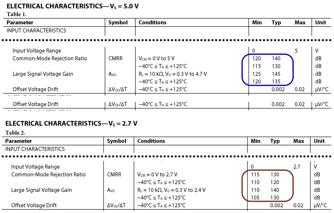

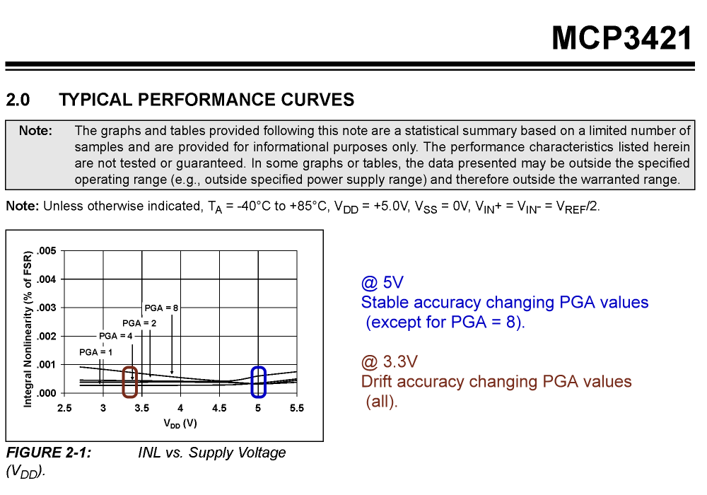

    My thoughts FWIW:
    e)
    Changing supply voltage from 5V to 3.3V will degrade performance and accuracy for both MCP3421 (INL vs. Supply Voltage) and AD8628 (Signal Voltage Gain).

      Re: New tool to find short capacitors on motherboards : shorty with display
      Originally posted by megaraider
      e)
      I checked the datasheets, and didn't see anything that would indicate less performance or accuracy at 3v3 vs 5v. Maybe I'm missing it?
      I'm asking because it would be really nice to sub out a pi pico for the nano. Nanos had their time, and that time is passing. Unfortunately, it's a 3v3 board (can take power from 1.8 to 5.5v) and the pins aren't 5v tolerant. I have an pi pico in the mail, should be here on mondy, I'm going to see if I can get the software running on it. Would make an interesting option, and not very expensive at 6 usd.

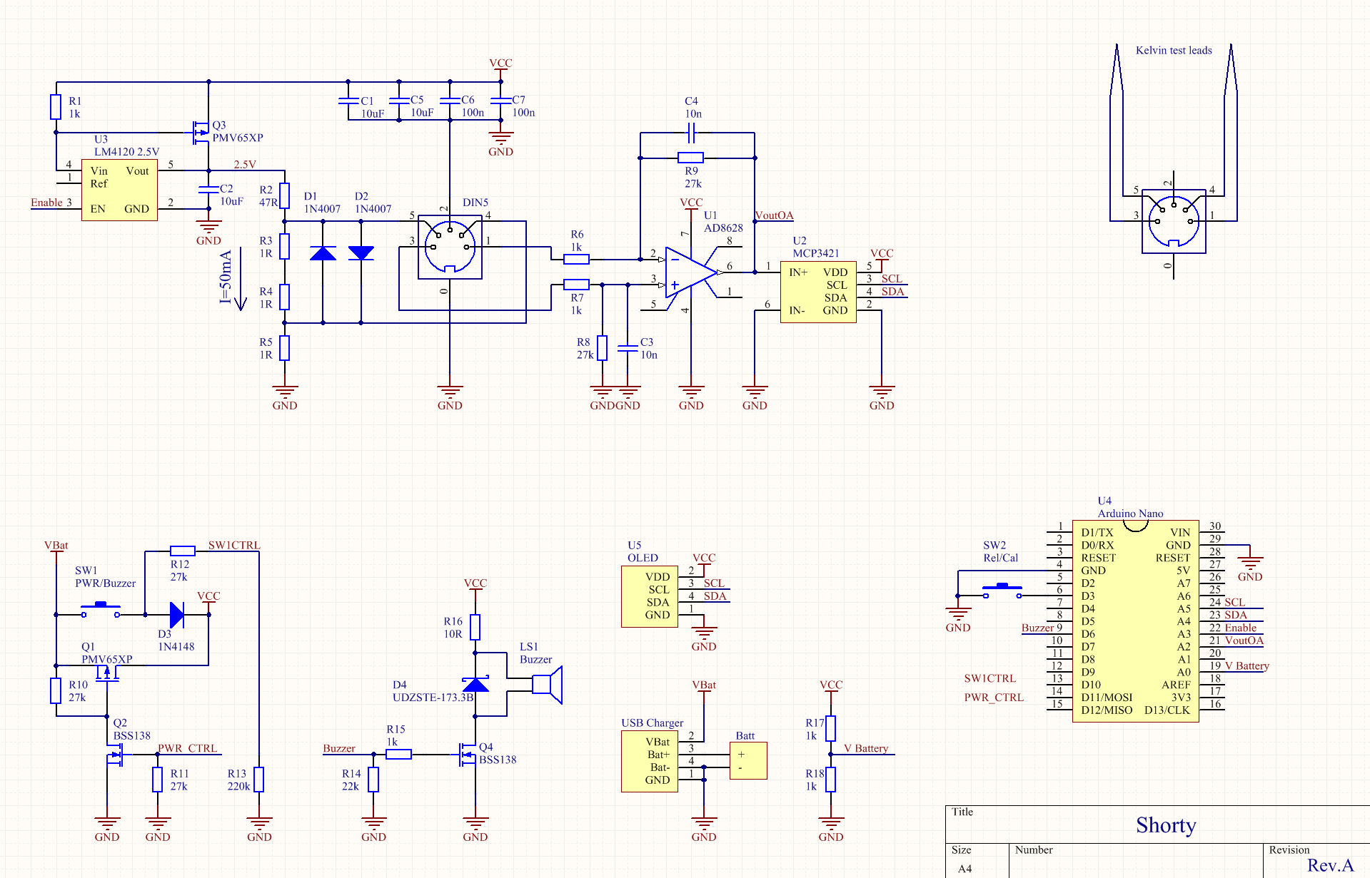

          #144
          I think the original circuit does not push much current through the probes?
          BC557 switching around 56mA but most of that goes through R2 2Ω which is in parallel with the tested resistance, and by current-division gives around 1.4mA only to the probes. Test voltage aound 113mV which is good.
          If this is right, then the source needs an update to pass more current through the resistor under test. Not a new vreg.

            #145
            Originally posted by kripton2035
            I added a voltage regulator 1755S to bypass the one inside the arduino. just thinking there would be a better regulation than the 1117. I also added a constant current source with the pnp transistor, to have better accuracy and better reproductibility of the measures.
            I read through the thread and found this post by krypton. Sounds like he added a voltage regulator and constant current source to the pnp transistor. I believe he later said he removed the transistor entirely and just used the constant current power source.
            I'm not really sure of the severity of the issue he was trying to hunt down, the videos sure look like he has a functional device. Could be an issue of the perfect being the enemy of the good. I'm pretty sure I'd be fine with an 80% solution when what I have right now is a 0% solution.
            I took a look at the code, he bit bangs the registers, so I'm going to have to get the datasheet out, but should be able to figure out what he's doing and get it going on rp2040.

              #146
              I'm wrong about some of the test currents. I checked math again and the circuit with 5V is putting a max of around 58mA through the resistor under test, with 114mV open-circuit. So this looks quite reasonable, assuming the (Arduino Nano V3) and 9V battery power supply holds up.
              With a test resistor of 1Ω that's 38.6mV and 38.6mA
              With a test resistor of 0.1Ω that's 5.6mV and 55.6mA
              With a test resistor of 1mΩ that's 58.4uV and 58.4mA The op-amp is a bit noisy then, after it is 1.578mV to the ADC input, a little small.
              I don't see any deal breakers, other than 5V '328 with 3.3V OLED and no cap across R8 and R7 for filtering incoming noise, you could try average it out in firmware.
              In the mΩ measuring it's in the noise floor and battery limit. You guys want 1A?! Any inductance and that would wallop what you are testing...

                #147
                Originally posted by clearchris
                I checked the datasheets, and didn't see anything that would indicate less performance or accuracy at 3v3 vs 5v. Maybe I'm missing it? (...)
                JFR see attached images taken from datasheets.
                Off course we're talking about peanuts... but when it comes to detecting µΩ

                    #149
                    That sounds like why he added the constant current source for the probes to limit current through the item being tested. IIRC, he said it was limited to 30ma. Probably a really good idea.
                    Megaraider:
                    Yeah, you got me, good catch. There's definitely value in feeding the AD8628 5v. There's likely also a lot of value in adding a constant current source the the probes. Reading the code, krypton uses a gain of 1 for the MCP3421. Not sure if there's any value in changing the gain on the ADC, if we want more gain, we should probably change the amplifier to get a bit more range. Upping the gain on the MCP3421 adds a bit of noise, though I'm not sure how much a difference of 5uV matters. For this application dealing with uOhms, maybe a lot.
                    If we are dealing with 1.578mV to the ADC input we could run the ADC on 3v3 (to get 3v3 communication to the MCU) and it should be fine. Everything else can run 5v including the OLED.
                    I'm just throwing out some ideas, I'm not necessarily advocating (ok, maybe for the rp2040, but I'm not married to it) you guys know this stuff far better than I do. I suspect krypton was putting some effort into keeping the BOM down, but I wouldn't have any issues bumping it up (suggestions so far, not all by me, amp, mcu, transistor, constant current source, more caps) if it increases quality.
                    BTW, I noticed that the VoutAOP line to the MCU in the schematic isn't used in the code. Is there any reason you would need this line? It's probably just a source of noise if it isn't used.

                              I received the pcb some times ago. but there is a failure I did not find until now.
                              I made some changes in the schematic, using a constant current source for better repetability,
                              well I'm still investing. the voltage regulator is giving 2.4V instead of 5V
                              ... and it does not seems to be a short circuit !
                              https://www.badcaps.net/forum/showpo...1&postcount=78
                              now I'm debugging this new schematic, it's almost working, but as a reminder it is a hobby project, and I have been very busy these last months.
                              https://www.badcaps.net/forum/showpo...5&postcount=83

                              this is the actual state of the schematic of the shorty-with-display input stage.
                              ### clearchris notes: schematic pic of constant current circuit and input stage attached
                              https://www.badcaps.net/forum/showpo...6&postcount=88

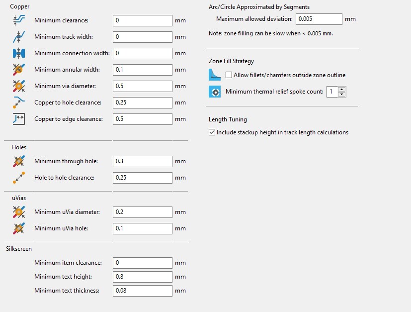

                                      I was working on my laptop and was trying to find a short in the circuit. I came across this project and think it is going to be really useful. I saw that the PCB design part was never been done or at least I did not see it.
                                      So I took the time using KiCAD to finish it up. I designed to use 0603 SMD for easy hand soldering.
                                      I've upload it in github.
                                      You guys are welcome to use it and help improve my design.
                                      https://github.com/theflyingsquirrel...ithdisplay.git
                                      I am planning to use solidworks to design the box for this after I get the circuit part done.

                                          How thick should the trace be? There is a ground plane on the back layer.
                                          Here is the setting now.
