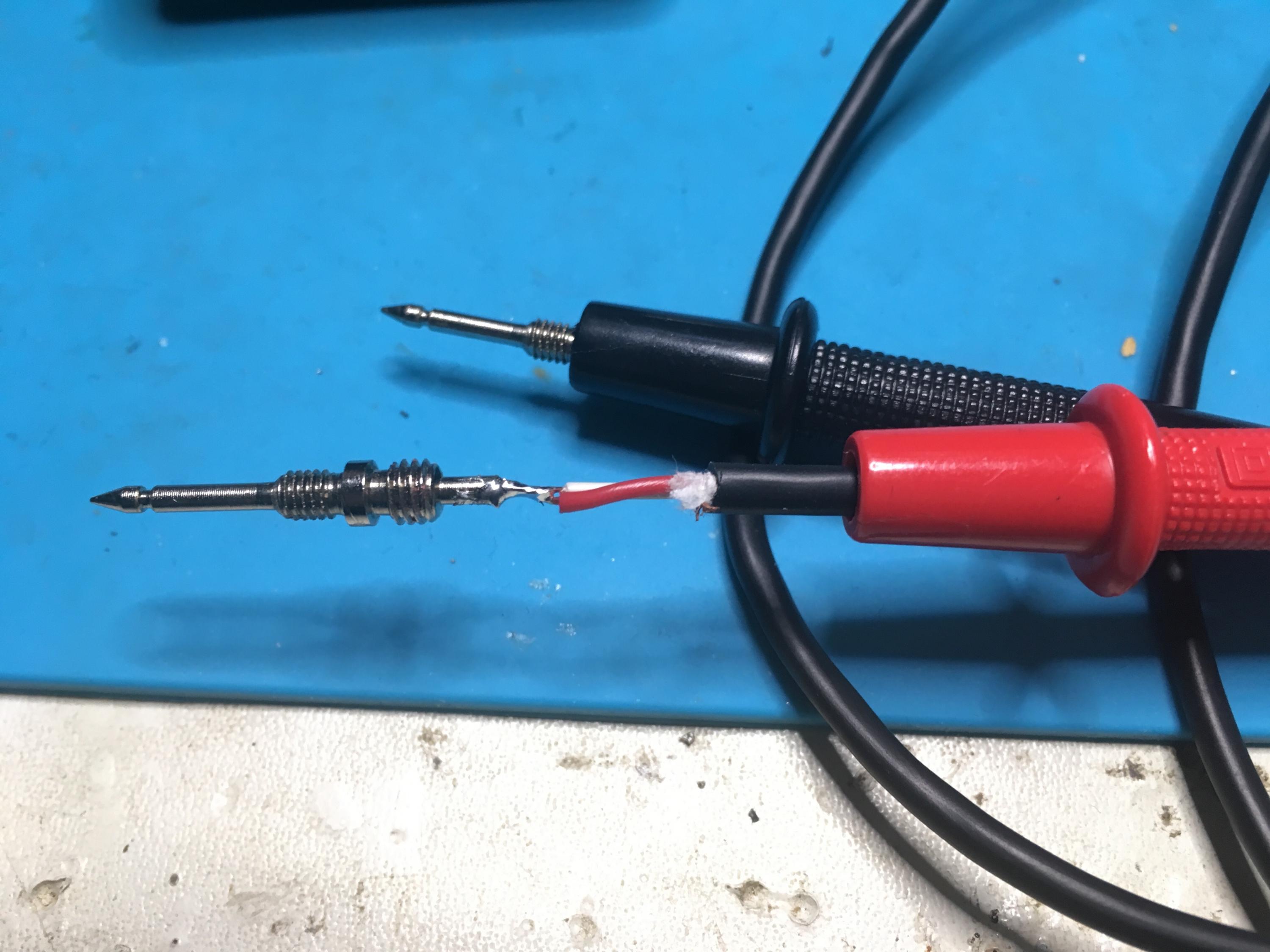

                      you must have 4-wires probe or you won't get the reading stability like on the video.

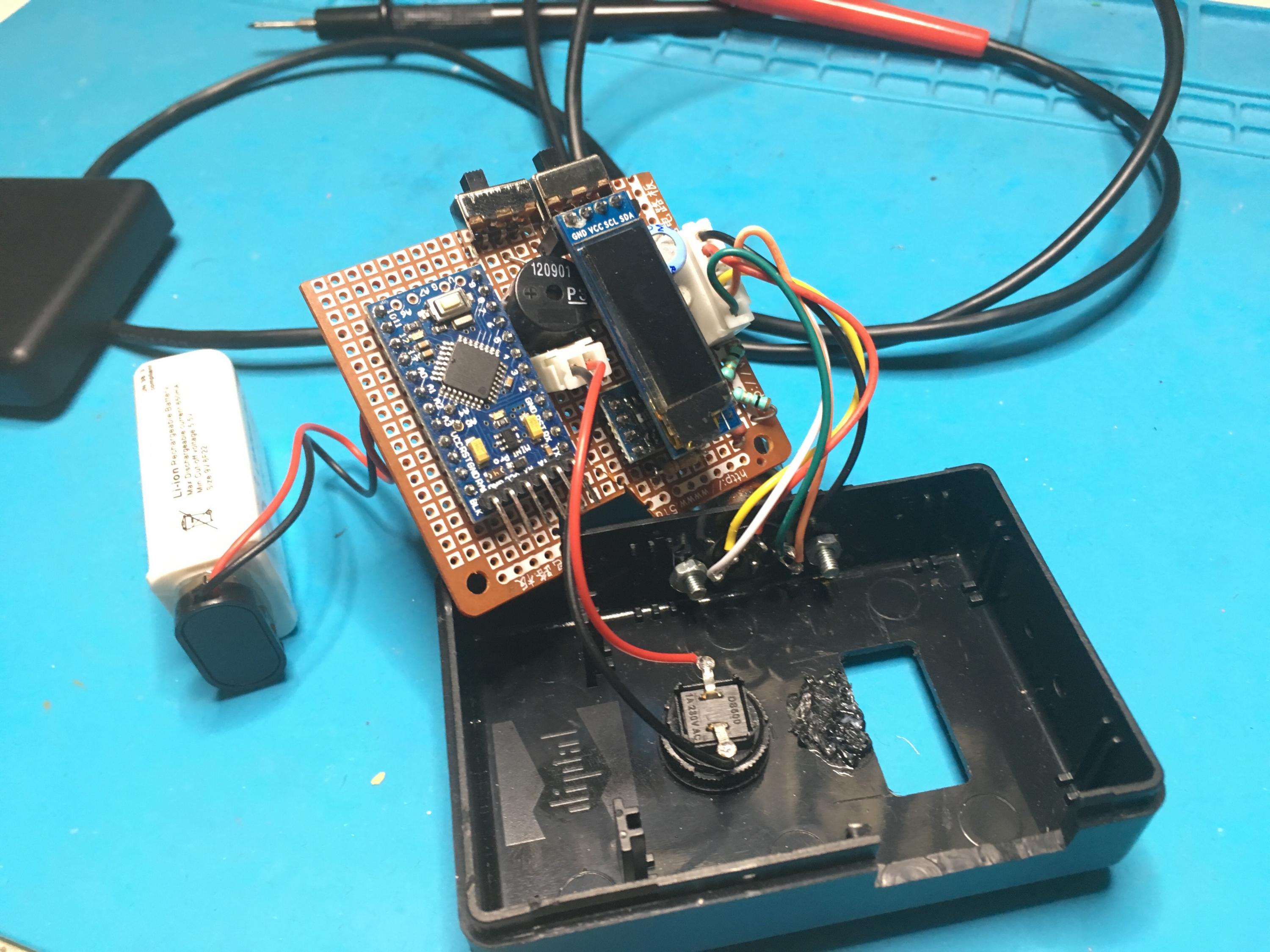

                        Re: New tool to find short capacitors on motherboards : shorty with display
                        inside the shorty prototype

                              just noticed, your prototype has an 8pin adc, but the part number your using is mostly just sold as 6pin sot23 package.
                              not a problem, but keep that in mind if your going to design pcb's

                                @stj : the adc is on a 8 pins protoboard, but it is a 6 pins, the last two pins are not connected on the adapter sot23-6 to 8pdip.
                                    I also changed the aop, from a mcp6041 to a ad8628
                                    the mcp had too much voltage offset, and I losed a lot of low mΩ resolution with it
                                    the ad8628 is perfect with 1µV offset.
                                    not sure you also have the aop in your drawers ?
