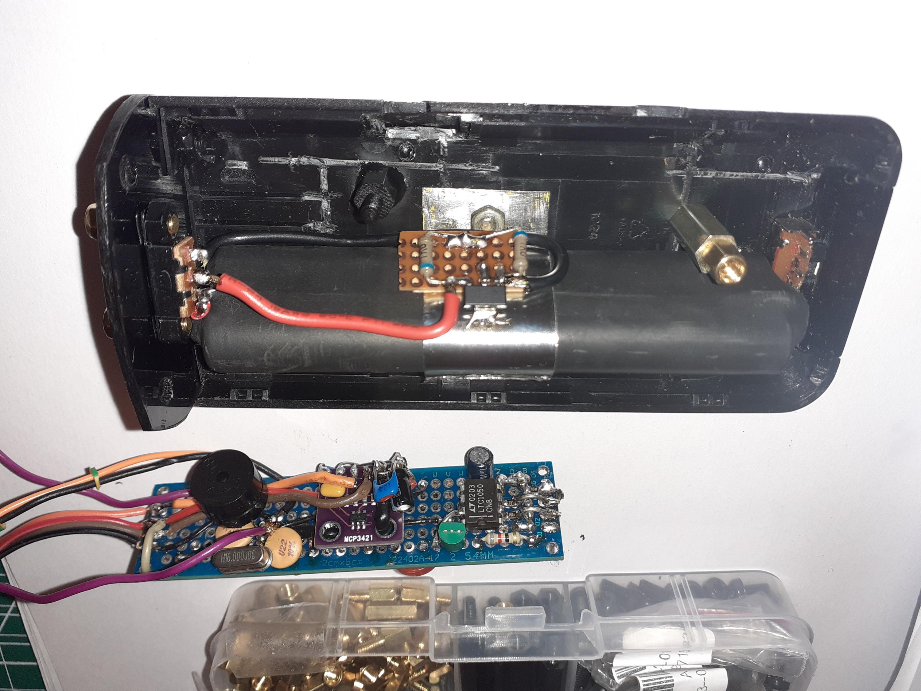

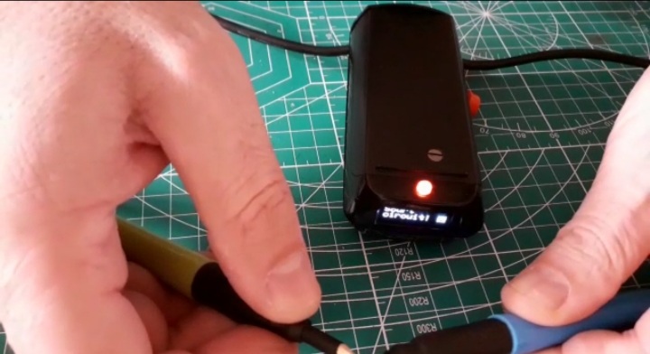

    Hi Kripton
    The AD8628 come in two package types, SOP-8 (which is cheaper) or SOT23-5
    I think form your pics you are using SOP-8. Can you confirm that is the correct one for your pcb?

        @dicky96
        yes I use the ad8628 in the sop-8 package for my pcb. (and the mcp3421 in sot23-6)
        anyway as I will publish the kicad files (schematic and pcb) once the pcb is ok
        you will be able to change the package if you need it.

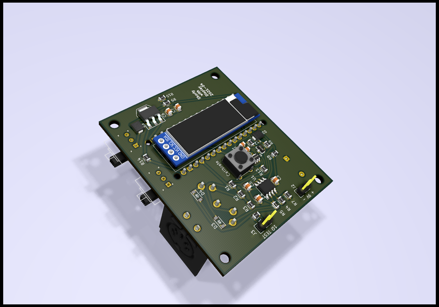

                      #70
                      Re: New tool to find short capacitors on motherboards : shorty with display
                      nice to see other variations around my project !
                      the pcb is ready to send to manufacture (for prototype and test only). should receive it in 2 weeks. then test it and if it is ok manufacture in greater qty.
                      it should cost EUR 10 with untracked shipping, and EUR 15 with tracking.
                      there will be an order button on my pcb page of the project.
                      for now, the last variation of the pcb.

                                    • kripton2035
                                      • Mar 2014
                                      • 31
                                      • France
                                      #78
                                      I received the pcb some times ago. but there is a failure I did not find until now.
                                      I made some changes in the schematic, using a constant current source for better repetability,
                                      well I'm still investing. the voltage regulator is giving 2.4V instead of 5V
                                      ... and it does not seems to be a short circuit !
