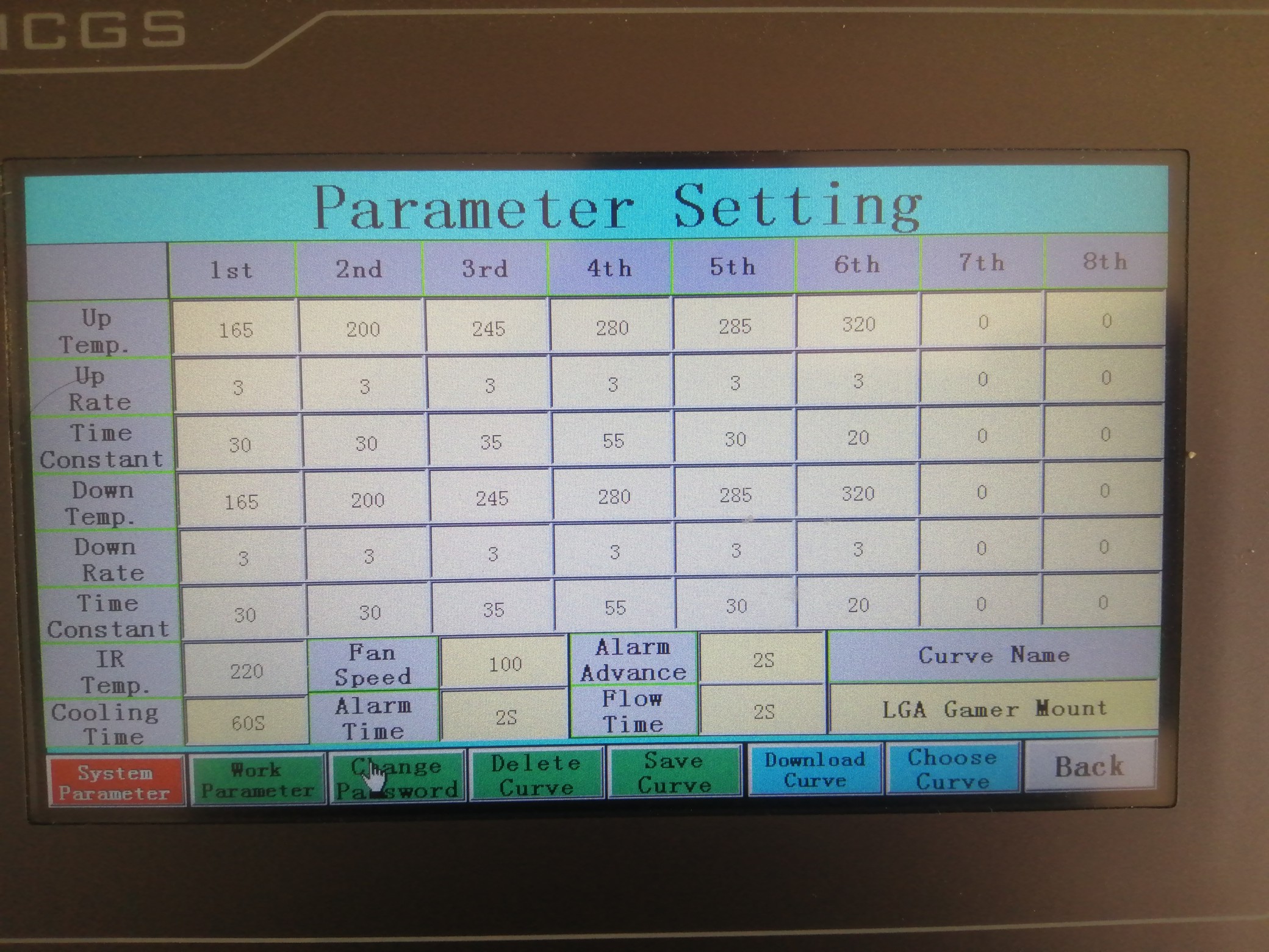

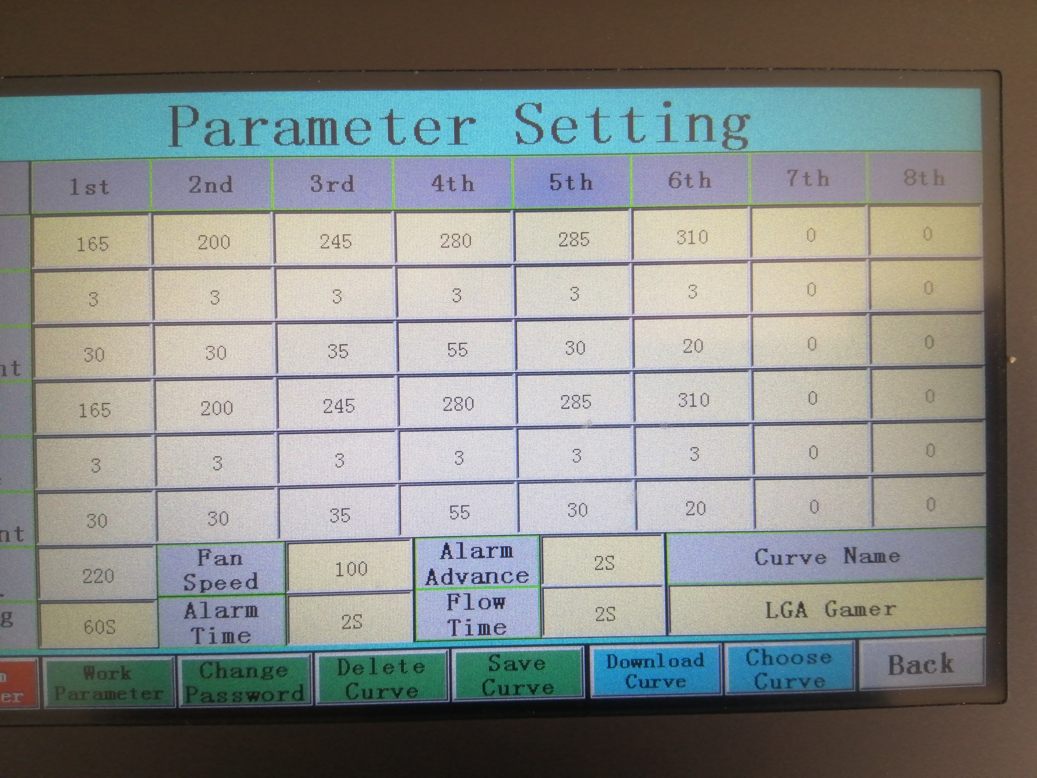

    After a bit of experimentation I created a profile that will desolder LGA sockets from gaming motherboards, as the one I use for standard motherboards wouldn't do it.
    But that profile will not attach the new socket properly. I then created a profile that is 10C hotter on the final ramp up and it still isn't soldering the new sockets. IIRC, with this profile, the probe near to the LGA on the top of the PCB is getting up to around 260C-265C on the final ramp up.
    I will have to try a hotter profile for sure, it seems my probe isn't reading the actual temperature at the LGA to PCB junction. But how much more heat?

    Profile 'LGA Gamer' used to remove
    Profile 'LGA Gamer Mount' used to solder.

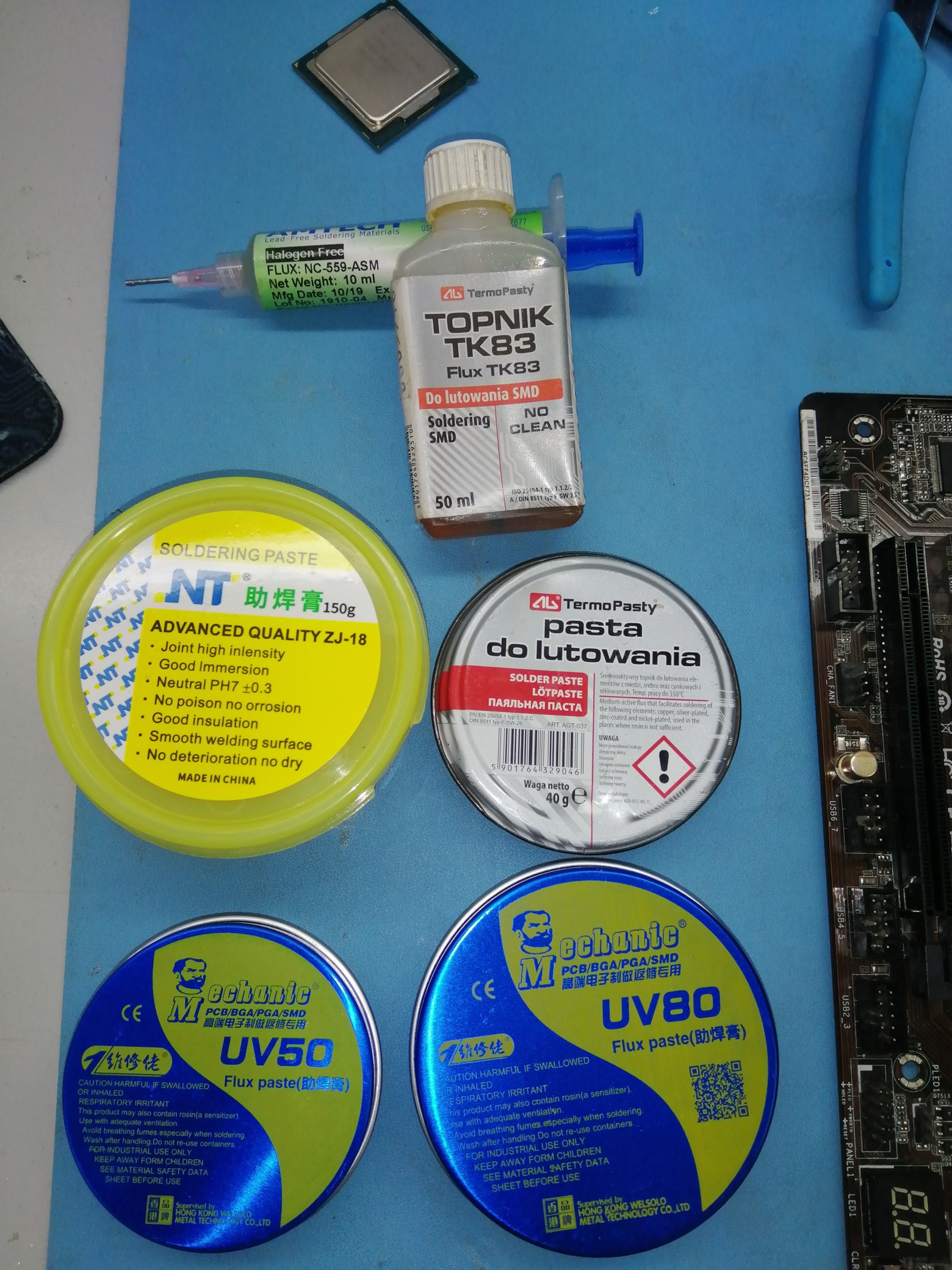

                            This is what I have available at the moment

                                @Deujevoo I don't use it for soldering, only for removing oxidation. I was initially using it for tinning my soldering iron tips (back in the days when I had crappy soldering iron), but found it works exceptionally well for removing oxidation on BGA. I always clean the area I used it on before soldering any chip even though I never had issue with leaving it on as mentioned.
                                @dicky96 Slow is better than nothing. We are at a complete stop here :/ , no postal service working due to curfew.
                                Try them on oxidised pads on scrap boards and see which works best.
