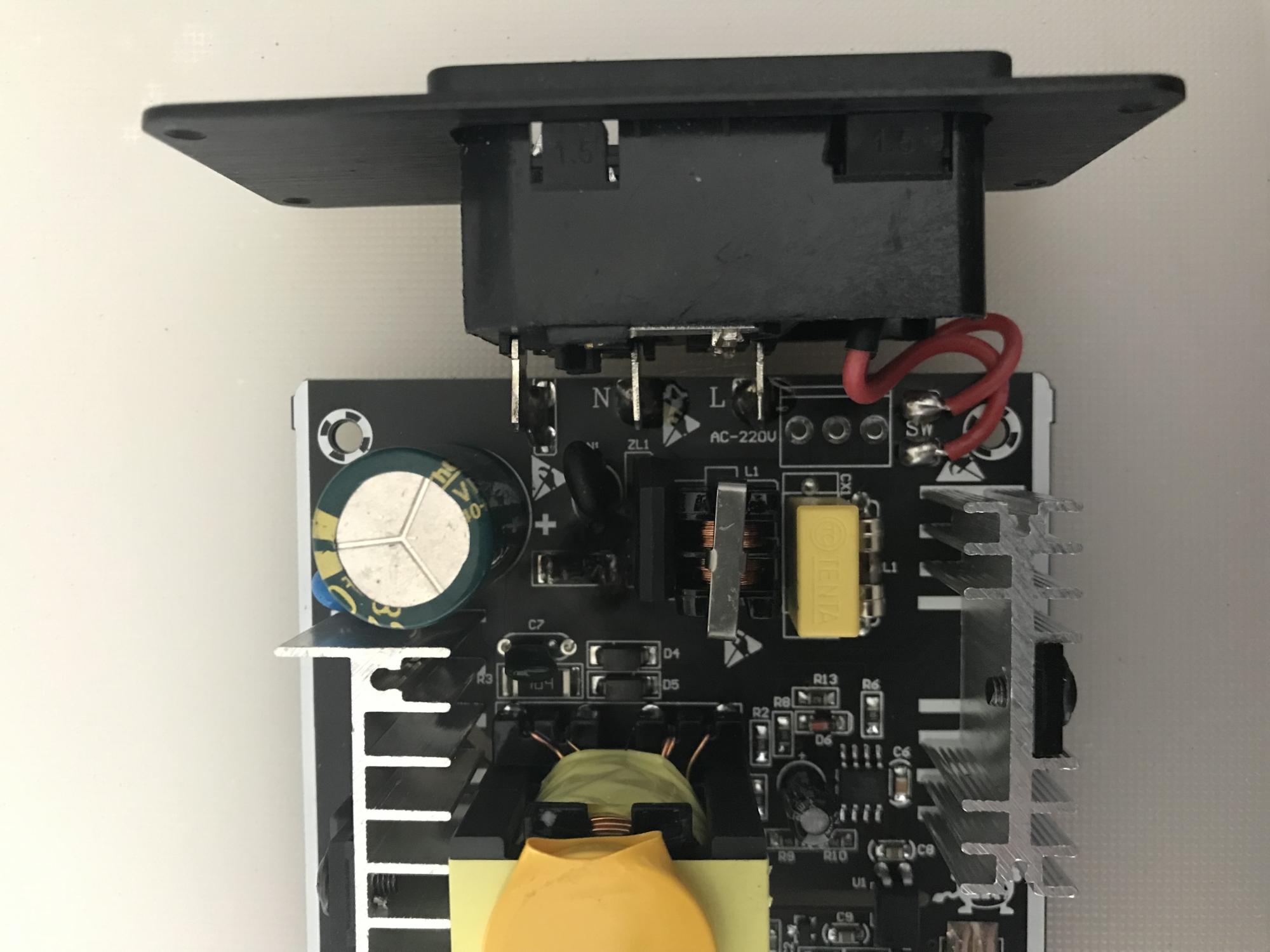

KSGER STM32 T12 soldering stations
  • redwire
    replied
    Re: KSGER STM32 T12 soldering stations
    I measure Ohms between the tip and PE ground and do not run a soldering iron if I get open-circuit.
    Another way is to measure ACV between the tip and PE ground when the PSU is on.
    Safety-wise you are never permitted to lift entry GND, so a 3-prong IEC connector ground is good to use.
    The DC jack input is usually for powering from a 19V laptop brick. Better ones are 3-prong, some with 1MEG resistor to GND.
    The Aixun T3A units seem to be too cheap in quality and the H/W, S/W design is not quite sorted out, so people are complaining about them: https://www.badcaps.net/forum/showthread.php?t=123458
    Leave a comment:
  • Jon434
    replied
    Re: KSGER STM32 T12 soldering stations
    Are you familiar with the internals of the Meanwell power supplies? I've been playing around with the idea of using RPS-120-24. RPS-200-24 or RPS-300-24 in a custom enclosure. Trying to combine all of the positives of these cheap Chinese T12 stations like the sleep function detecting when the handle is in the stand, but with a dependable power supply. They seem too likely to fail in the long term.
    Assuming a Meanwell supply is used, I've been trying to weigh up the positives and negatives of using an internal power supply vs external. I guess if it's wired properly it's safe either way? The good thing about an internal supply is it gives the unit some weight and stability on the desk. I also like the idea of being able to put the stand on top of the enclosure in space confined situations.
    My idea is something like..
    Front Panel
    - on/off switch for Display + 24V on controller board (T12 + C245)
    - display and encoder knob
    Rear Panel
    - mains power switch and IEC connector
    - 24V output for powering something like Pinecil or TS101
    - 12V input for powering C210 tips with external adapter
    - banana jack for solder stand sleep function
    - GX12 Connector for handle
    The enclosure could be used as a standalone power supply, as a soldering station or even use 2 irons at once (T12 and TS100 for example).. in an enclosure that's roughly 16-18cm X 10-12cm X 6cm if I can find something that size. RPS-300-24 (200W with passive cooling) for C245 compatibility, RPS-200-24 (140W with passive cooling) without.
    Just wondering if there any considerations or precautions that would need to be taken in terms of grounding the tip. For example, even if powering 12V C210 with a dodgy 2 prong power supply.. maybe I could use the ground from the 3 prong IEC connector? Even with the IEC power switch off, the ground would still be connected?
    Does this post describe the Y cap issue? https://electronics.stackexchange.co.../540742#540742
    Aixun T3A are good units, but I've still seen failing components on those stations as well. And it's hard to access the front panel, there's no screws and it's glued on.
    The reason I appreciate the info in this thread, is that I don't have a unit in front of me, just in a hypothetical/planning stage. I've never used a T12 or C245 style iron before, but there seems to be some advantages.
    Leave a comment:
  • redwire
    replied
    Re: KSGER STM32 T12 soldering stations
    You see the sense resistor is ending up being the power supply's fuse lol. I dislike that and would go to a 2A fuse, the PSU has a 5Ω/3A NTC inrush limiter.
    Some come with a slow-blow fuse on the PC board.
    If you power the T12 station from mains, it needs to be an earth-grounded PSU. A two-prong power supply will impose high voltage on the tip due to the Y-cap leakage current (just measure ACV between PE and the tip). 60VAC is no good for sensitive semi's. So no two-prong power sources, that is trouble.
    Laptop adapters are 3-prong but floating output (with 1MEG and Y-cap to GND) so they work OK.
    You can also use cordless drill battery packs, 12V gel-cell and boost-converter etc. to go portable.
    Leave a comment:
  • Jon434
    replied
    Re: KSGER STM32 T12 soldering stations
    Interesting thread.
    redwire, if you see this I have two questions regarding all the info you have shared here.
    You mentioned the fuse values were too high, what value for mains fuse would you recommend if trying to find an optimum value?
    Also, you mentioned the mini version needing further mods. Is there a resource somewhere that explains what those mods would be? I assume it's something to do with the differences in grounding? And a 3 pin 24V adapter would be required for this to work?
    Leave a comment:
    replied
    Re: KSGER STM32 T12 soldering stations
    get this:
    https://www.youtube.com/watch?v=26KXtHZqhMg
    Leave a comment:
  • mickelin
    replied
    Re: KSGER STM32 T12 soldering stations
    Originally posted by redwire
    That is the sense resistor for the SMPS 0.30Ω
    It means your power mosfet failed shorted. Check R6 as well, but the IC could be blown as well.
    Schematic here: https://www.eevblog.com/forum/review...36/#msg2467236
    For the time and money to repair it, I would just order a new PSU. The price of mosfet, IC, fuse, and maybe a cap or two, troubleshooting time...
    Why it blew up - it could be a failing electrolytic capacitor, shorted wand or just cheap stuff off the junk.
    Thanks for the quick reply. I think I will just power it off a 24V adapter for now, probably have one or two laying around. Thinking of getting a Pinecil instead.
    Leave a comment:
  • redwire
    replied
    Re: KSGER STM32 T12 soldering stations
    That is the sense resistor for the SMPS 0.30Ω
    It means your power mosfet failed shorted. Check R6 as well, but the IC could be blown as well.
    Schematic here: https://www.eevblog.com/forum/review...36/#msg2467236
    For the time and money to repair it, I would just order a new PSU. The price of mosfet, IC, fuse, and maybe a cap or two, troubleshooting time...
    Why it blew up - it could be a failing electrolytic capacitor, shorted wand or just cheap stuff off the junk.
    Leave a comment:
  • mickelin
    replied
    Re: KSGER STM32 T12 soldering stations
    When I turned on my KSGER today there was a loud bang. Turns out R1 is completely burned. Other components look OK. Any ideas what could cause this? Don't want to replace and have it happen again.
    Leave a comment:
  • jayjr1105
    replied
    Re: KSGER STM32 T12 soldering stations
    Originally posted by lti
    Has anyone here tried the "STC" controller (the one with an 8051 clone instead of an STM32)? I keep seeing those, and they tend to be the version with an external power supply. I'm looking at these to finally replace my $15 soldering iron, or I might go for a Weller WE1010 instead. The Weller probably won't perform as well, but it doesn't have the "unfinished hobby project" feel.
    Check out the Pinecil https://pine64.com/product/pinecil-s...oldering-iron/
    Leave a comment:
  • lti
    replied
    Re: KSGER STM32 T12 soldering stations
    I don't do much soldering anymore, and even when I did solder more, I got a decent amount of life out of that $15 iron. Because of the lack of use, that Weller is about as much as I want to spend. I'm not doing anything extremely tiny (smaller than 0402) or extremely large, but I might have an occasional motherboard repair.
    The tiny box on the version without a power supply did look annoying.
    Leave a comment:
  • redwire
    replied
    Re: KSGER STM32 T12 soldering stations
    Narrow it down a bit, how much soldering do you do and what is your budget? Small delicate work or bigger stuff?
    I much prefer Hakko and Weller stations because they are more comfy and reliable. A soldering iron is a tool you want ease of use, otherwise years of reminder that you cheaped out.
    The KSGER T12 copies are OK, quality has dropped, but what a hassle for PE grounding them, getting crappy quality tips, no decent handle grips and no decent stand exists for the handles, it will fall out onto your floor lol. They are cheap and unrefined.
    The Weller WE1010 is better quality, the tips are a bit larger and smaller selection than T12. The base lacks a primary mains fuse, not sure if that has been corrected yet.
    KSGER STM32 soldering iron controller firmware is copy-protected, I'm not sure who really owns it. It also uses an RTOS so in the end it is more expensive, as well as the MCU being more expensive but it has the code space for the OLED fonts and graphics. It's full of useless features like a real-time clock and 30 menus of nothing.
    The STC MCU is much less expensive and decent hardware, Quicko (State renamed to Quecoo) uses them a lot.
    LED one uses STC15F204EA only 4KB FLASH, 256B RAM, 10-bit ADC.
    OLED one uses STC15W408AS only 8KB FLASH, 512B RAM, 10-bit ADC.
    I would get a station with a built-in mains power supply. The mini falls off your desk, it's just silly it should be built-in to a stand so the cords don't yank it around. But people do run them with laptop 19V power bricks (45W) or mobile battery packs.
    Leave a comment:
    replied
    Re: KSGER STM32 T12 soldering stations
    the T12 is better, you can upgrade your base or pcb while keeping the handle and tips later.
    Leave a comment:
  • lti
    replied
    Re: KSGER STM32 T12 soldering stations
    Has anyone here tried the "STC" controller (the one with an 8051 clone instead of an STM32)? I keep seeing those, and they tend to be the version with an external power supply. I'm looking at these to finally replace my $15 soldering iron, or I might go for a Weller WE1010 instead. The Weller probably won't perform as well, but it doesn't have the "unfinished hobby project" feel.
    Leave a comment:
  • jayjr1105
    replied
    Re: KSGER STM32 T12 soldering stations
    I have the 7 segment display version of this iron. I like it a lot but I did have to re-wire the new handle I bought that was originally intended for the KSGER T12.
    Leave a comment:
  • Gas0r
    replied
    Re: KSGER STM32 T12 soldering stations
    Originally posted by stj
    panasonic FS 10x25 for the 1000uf 35v
    Thanks! Now the big one, please.
    Leave a comment:
    replied
    Re: KSGER STM32 T12 soldering stations
    if you drop to 68uf on the mains then chemicon EKXJ401ELL680ML25S
    https://cdn.badcaps-static.com/pdfs/...e9689636ea.pdf
    Leave a comment:
    replied
    Re: KSGER STM32 T12 soldering stations
    panasonic FS 10x25 for the 1000uf 35v
    Leave a comment:
  • redwire
    replied
    Re: KSGER STM32 T12 soldering stations
    Primary cap was 68uF 400V 16x26mm and KSGER increased to 82uF. I couldn't find any 82uF 16x26mm caps at 400V. The heatsink and Y-cap are near it, so 18mm dia. would be really tight and hit the Y-cap. One problem is the low height, maximum 27mm. It must be a laptop brick cap. I have Ltec there.
    The two 1,000uF 35V 10x20mm caps could go taller.
    I think you could barely stuff in 12.5mm dia. parts, one cap has SMT resistors nearby. I have green Sanyo there.
    Because the PSU is only under full load 3A for short periods, the caps are not highly stressed I think and ESR not so important.
    The mains fuses are way too big, so if the mosfet shorts, many parts get damaged first and better off to throw the PSU in the garbage than try fix it.
    Leave a comment:
    replied
    Re: KSGER STM32 T12 soldering stations
    for the 1000uf caps, can you fit 12.5mm diameter??
    Leave a comment:
  • Gas0r
    replied
    Re: KSGER STM32 T12 soldering stations
    Hi, I would like to replace the three capacitors of my KSGER T12's PSU. Don't trust the cheap chinese Chongx caps after hearing stories about leakage and "exploding" soldering stations after ten months use...
    - 1x ChongX VEHT, 82uF, 400V, diameter: 16mm, height: 25mm (not much room to the sides and top)
    - 2x ChongX VEHT, 1000uF, 35V, diameter: 10mm, height: 20mm
    Which ones should I use? Can't find a datasheet for ChongX caps and unsure about ESR and ripple values.
    Leave a comment:
  • mkbehbeh
    KSGER C245 Soldering station PSU 220V only?
    by mkbehbeh
    I purchased this soldering station when it was on sale at amazon. It had a slew of one star reviews, but the price was low enough that even if the controller and PSU were toast, the handle tips and stand were worth more than the price. All of the reviews mentioned that the unit was either DOA, or died on the first use. I looked on Aliexpress and the first clue was that KSGER still sold the 220V version of this station, but all of the 110V versions had been discontinued. I figured That there was a problem with the 110V on the power suppply and the controller would be fine.
    I am...
    04-17-2023, 03:11 PM
    by sam_sam_sam
    07-01-2024, 06:34 AM
  • chth96
    What soldering station should I purchase for 900M-TJ-I tip?
    by chth96
    hello.
    A few months ago,I have purchased 0.1mm Soldering Iron Tip of below aliexpress link,But I noticed that It is totally impossible to use this 0.1mm iron tip in the T12 soldering station
    https://ko.aliexpress.com/item/4001275635593.html
    Is there any good soldering station which is possible to use 900M-TJ-I tip and have inexpensive or reasonable price in aliexpress?
    Any reply would be appreciated.
    11-24-2023, 05:08 PM
  • caprider
    Recommendations of quality soldering station and (separate) hot air station
    by caprider
    Hey,
    I'm looking for some recommendations of a decent quality soldering station and a separate hot air station. I'm just a hobbyist, so even if (ultra)premium tools are not required, I still want some good tools. They should be available in Europe.
    I now have a TS100 and some soldering irons and looking for some better tools.
    1. Soldering station, budget around 200-240€
    JBC BT-2BWA seems to be a good product in the budget.
    2. Hot air station, budget around 200€
    Up to now I've found ATTEN ST-862D to be a good option....
    01-15-2022, 02:05 AM
  • Peter_1402
    Yihua 992DA+ Hot air gun and soldering rework station, burnt mark
    by Peter_1402
    Hi Everyone,
    I bought a Yihua 992DA+ hot air gun and soldering iron unit from a used market.
    1. Soldering iron works great
    2. There is a burnt mark on the hot air gun handle.
    I am a bit concern by the look of the melted plastic. I opened the hot air gun handle and took some readings with a multimeter.
    Heating element ~ 75ohm. (Similar reading taken from a spare heating element that came with the unit.)
    Thermocouple ~ 1.5ohm. (Similar reading from the spare heating element.)
    Reed switch tested ok with a magnet.
    From the above test, I can conclude...
    07-12-2025, 11:50 AM
