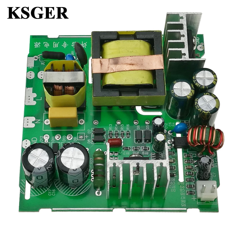

              • kkolding
                • May 2020
                • 3
                • Danmark
                Re: KSGER STM32 T12 soldering stations
                I suspect that my PSU has a faulty SG6842 I haven't been able to find it anywhere else than on ebay, I would much rather buy one from a trusted seller, does anyone know if there is other IC's that would work instead of this one?
                • redwire
                  • Dec 2010
                  • 3912
                  SG6842 included in the lawsuit between Fairchild, System General Taiwan and Power Integrations.
                  Fairchild Products Found to Infringe {injunction effective June 30, 2014}
                  "The following Fairchild products are no longer offered for sale or sold in the United States. The following products are also subject to the attached court-ordered injunction. Sales of the following products outside the United States are made with the understanding, and subject to the condition, that buyers of the products will not import any of the following products into the United States, either as individual products or within their finished goods or products, or the
                  finished goods or products of others. Customers who wish to import finished goods or products into the U.S. must not purchase or use the following products in any goods or products imported into the U.S."
                  Alternates... I didn't seen anything with exact same pinout.
                  SG6845 different pinout and DIP-8 not SOIC-8.
                  FAN6604 very close pin 3-4 needs jumper, and delete any R on old pin 4.
                  What is wrong with your power supply that makes you think it's the IC?
                  Some of these T12 24VDC PSU's are junk - unstable and run hot. Capacitors way too small.
                  • kkolding
                    • May 2020
                    • 3
                    • Danmark
                    #29
                    Thanks!
                    The PSU can't hold a steady 24V it switches between 19-30V on the output side. The red LED on the output side keeps blinking. And when I plug in the digital control board to the PSU it turns on but keeps giving me an error. As soon as I plug in a tip it can't deliver enough power and turns the display on and off.
                    I have tested the tips to check if they are shorted but they seem fine.
                    at first, I suspected that it was the power MOSFET so I replaced that with a Vishay model instead "http://www.farnell.com/datasheets/2687488.pdf".
                    Also swapped out the 400v capacitor with and Samsung brand instead.
                    With those replaced, I still have the same problem.
                    I'm a noob, so I'm just trying to mess about with the knowledge I have.

                        • redwire
                          • Dec 2010
                          • 3912
                          #32
                          It sounds like the power supply is hiccupping and going into overvoltage shutdown if you are seeing 30V output blips. It might not be the SMPS IC, but caps or opto or TL431.
                          I would not connect it to anything- they have 1k dummy load resistors and you should get about 25V output, stable.
                          Need a pic of the board to see what design it is. I would check the smaller electrolytic capacitors like 10uF or 47uF 50V and the output capacitors to see if they are low value.

                            • kkolding
                              • May 2020
                              • 3
                              • Danmark
                              #34
                              I have the first revision of the board the one that you made a schematic of.
                              I stole a TL431 from a faulty PS4 PSU, replaced it now works fine. Thanks! =)
